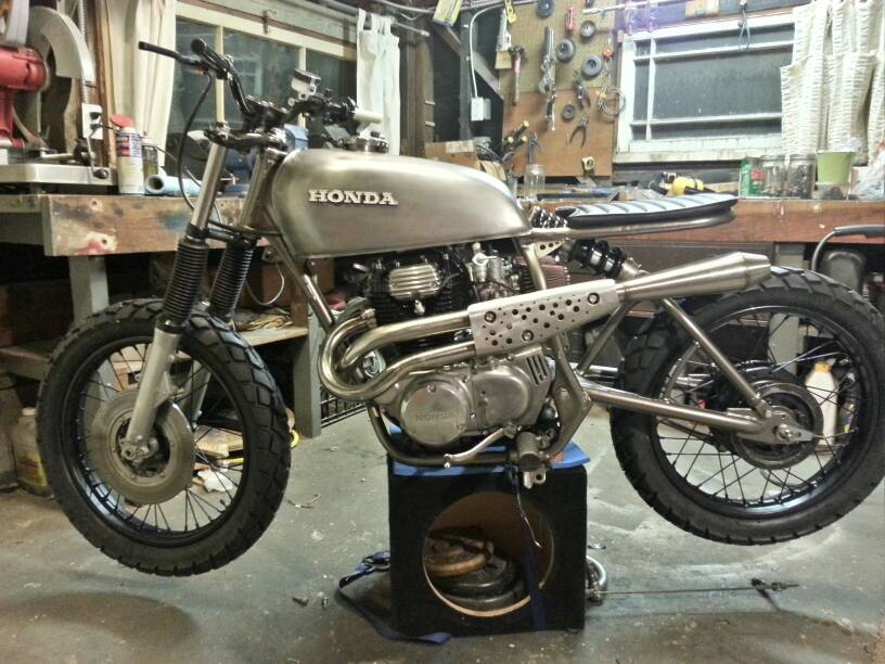

I love the leg guard - do it!
Really suits the mad scrambler look of the bike.
You might want to do more holes and a bit smaller though.
Thanks for the encouragement everyone. It took me nearly all day to finish up the leg guard but I'm pretty happy with it now. I pounded the shape a little thinner towards the end of the exhaust and countersunk the mounts. I kept wasting time in photoshop trying to mock up a hole pattern that looked cool but in the end I just started drilling until it was covered.

Thanks Mike. There was a slight method to my madess I just didn't drill straight enough. :P
