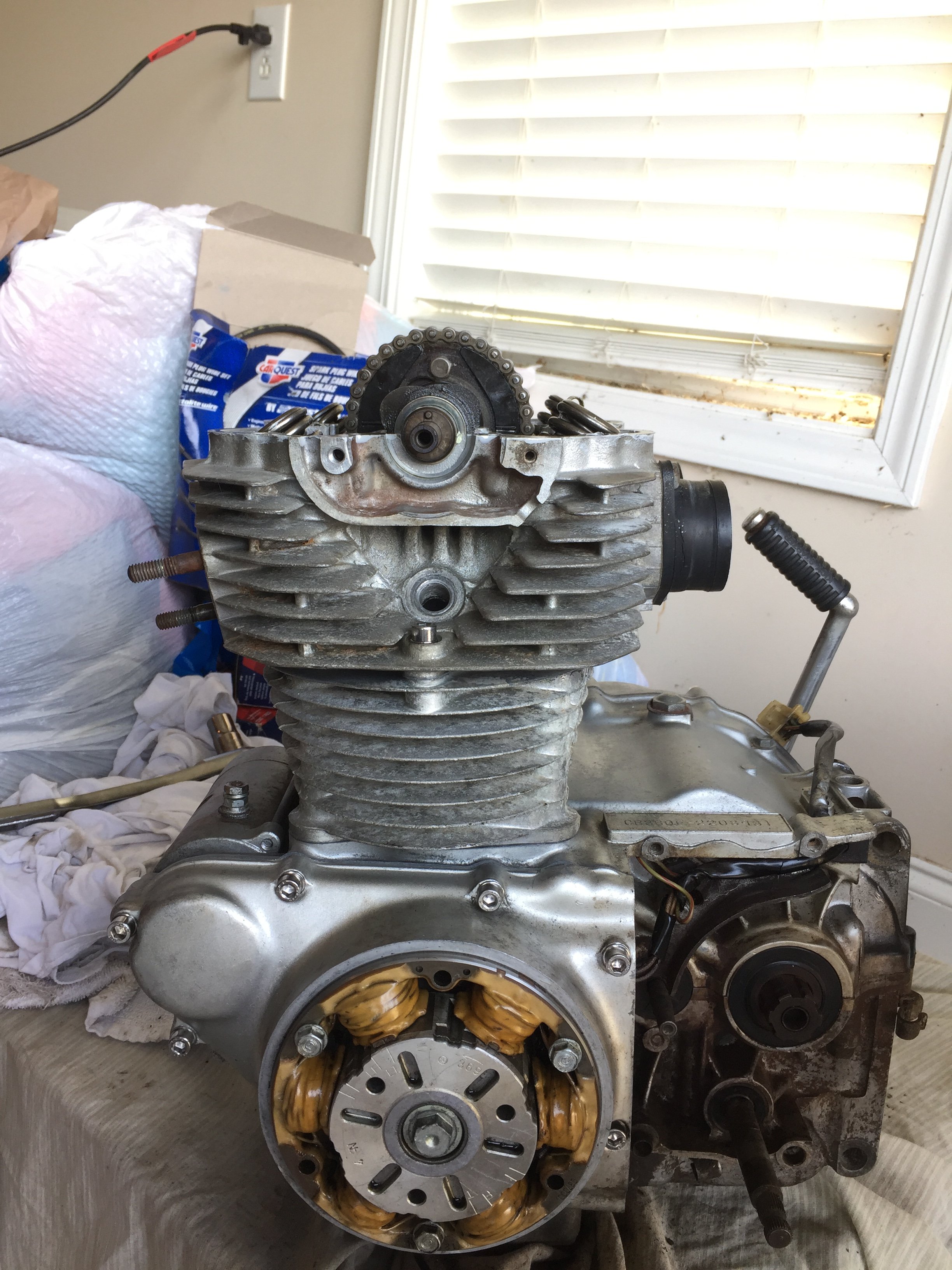

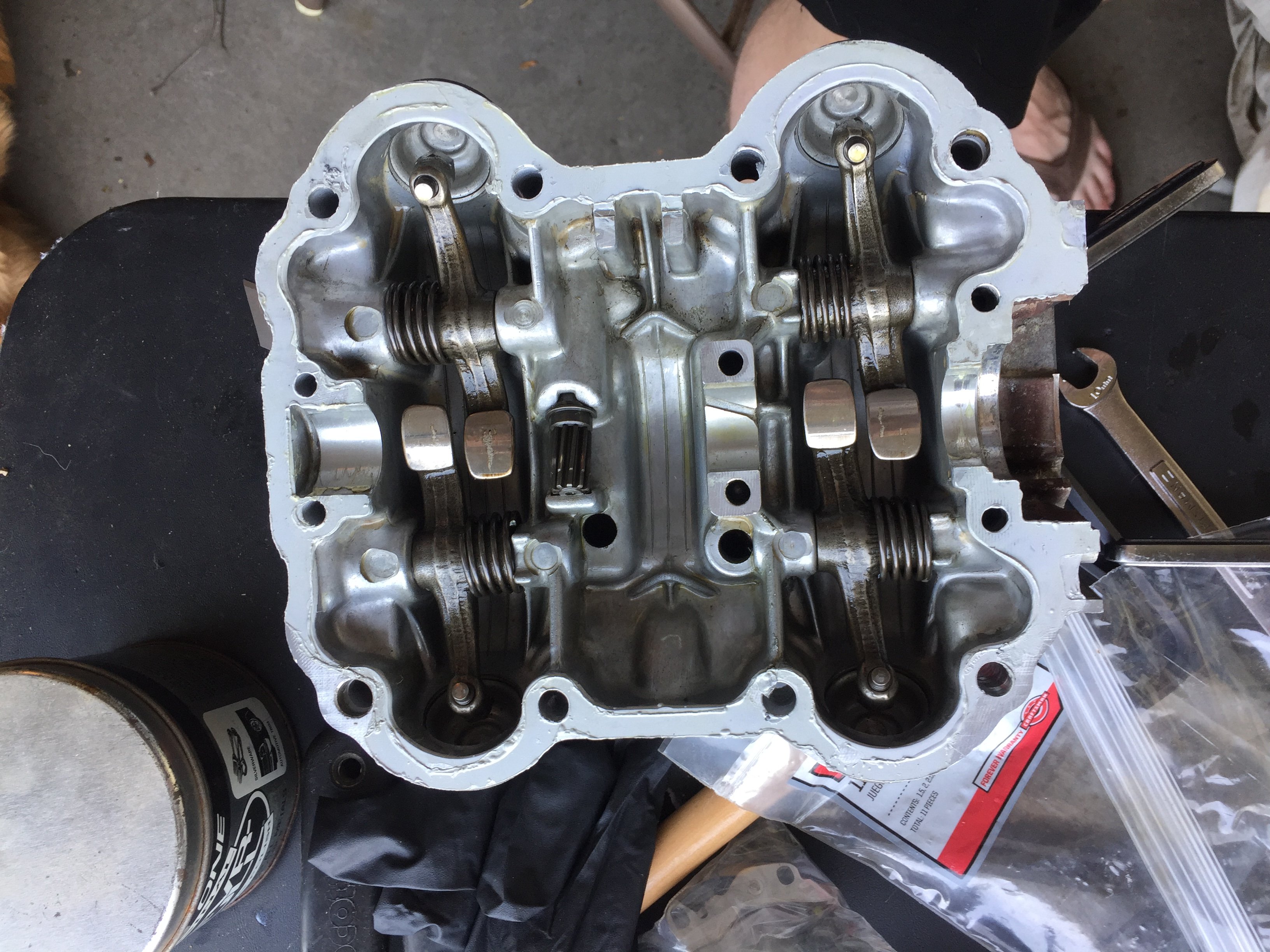

Ok. I am infact blind, because I had the thrust washer in a bag beside me even labeled. Installed it. Re positioned crank and cam timing. Here are the pictures you asked for pj
Thrust washer goes on other end of cam.Where is the tensioner top cup?Looks like you need to re-set tensioner as well, bit too much of tensioner blade sticking up.What your describing is what happens when early style blade breaks. I`m suspecting you don`t have top cup fitted?BTW, you never try to fit rocker cover without removing inspection caps and backing off adjusters.It's easier to do while taking things apart
