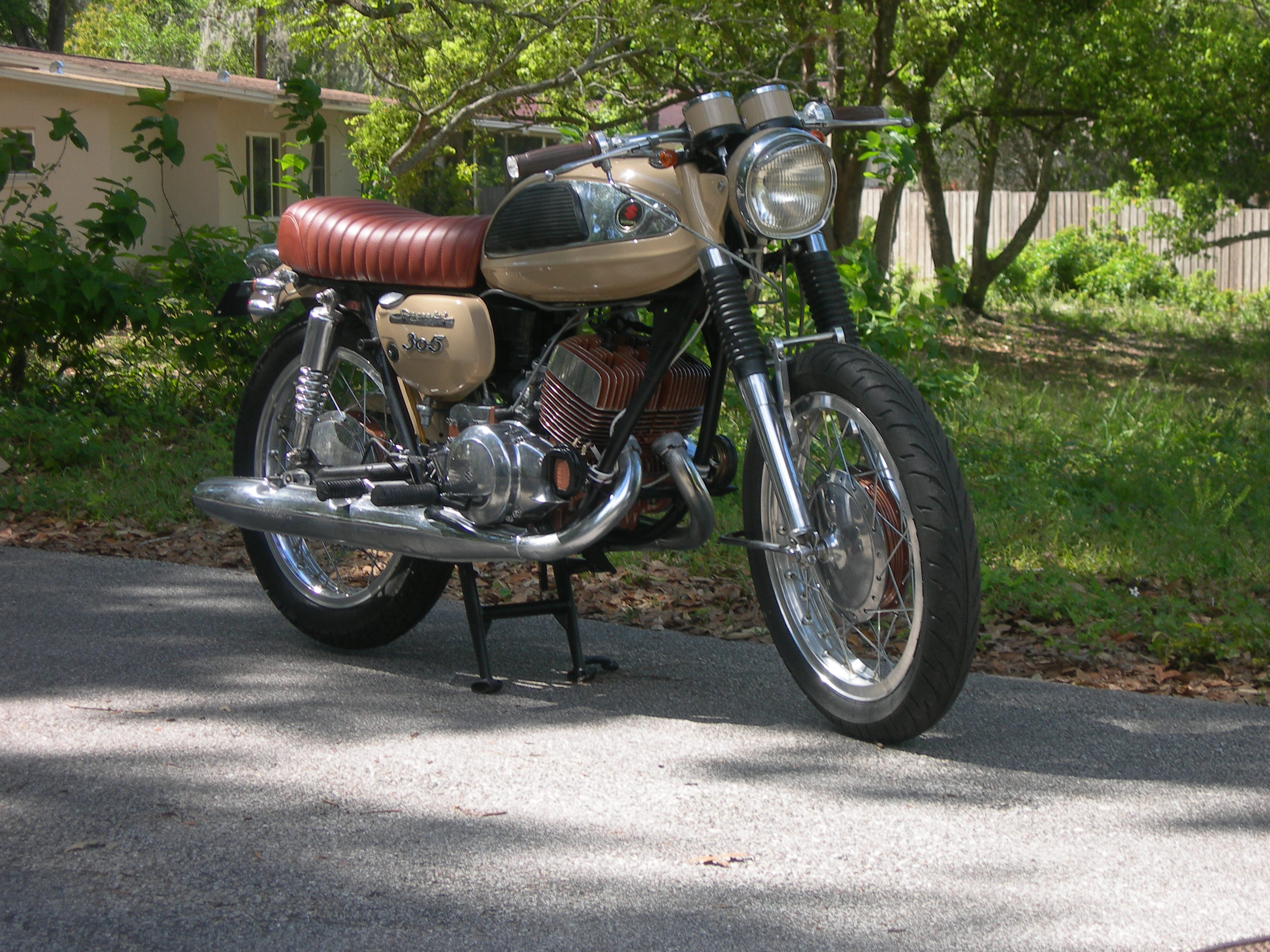

I think I mentioned I was 'playing' with a friends T305?
Took just over 3 yrs to get it finished as it was never going to be any form of restoration. Problem was, whenever I fixed one problem several others came to light. It's been 'finished' since mid/early April but I only just ' found' camera card and had time to upload to Photobucket. (he's bringing it back sometime so I can modify a fender to fit it, stock wouldn't work with brace, even if we had one)
Here's left and right 3/4 shots. I made several parts including the Egli inspired fork brace. It got one size wider rims front and rear and just about everything new (bored 0.5mm over, bearings, seals,shocks, and a re-wire with heat shield sheathing (mainly because it matched the colour scheme) Chris had seat recovered after I modified it to fit properly (cut about 4" off 'nose')
Forgot to take a close up of the bar ends I made, 6 amber LED's in polycarbonate to act as repeaters.
