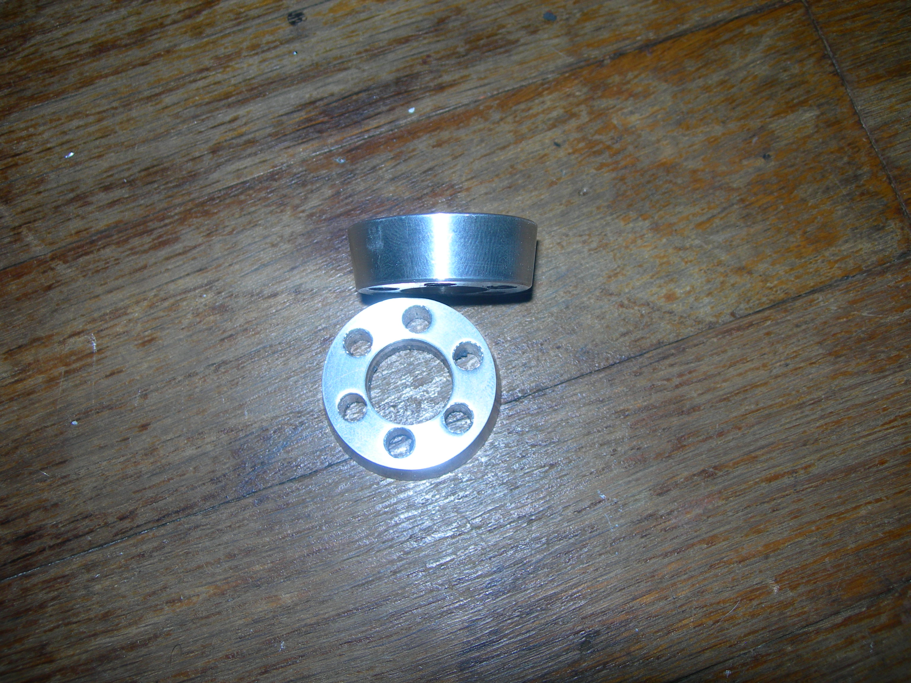

Was asked to make a couple of spacers to mount footrest hanger on swing arm pivot bolt. As usual, couldn't leave well alone so instead of basic parallel 'lump', did some math and machined some angles so they have a taper.
Took a guess at large size, small diameter is 30mm, centre hole 15mm. Haven't used small rotary table for a few years, spent some time looking for the various fasteners and fittings for it. Yes, the one on the right holes are not consistent 60 degree spacing, I didn't tighten it down properly (and forgot to check before starting drilling)
Not really important as holes can't be seen when hanger is one side and swing arm pivot on the other. Should look better than having a 2~3mm step though? Original picture I was sent
