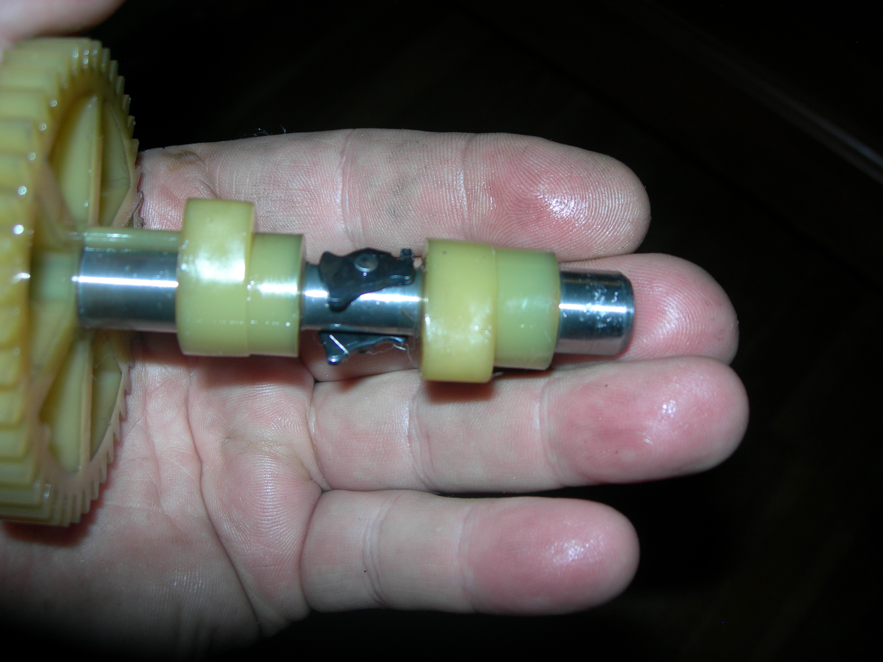

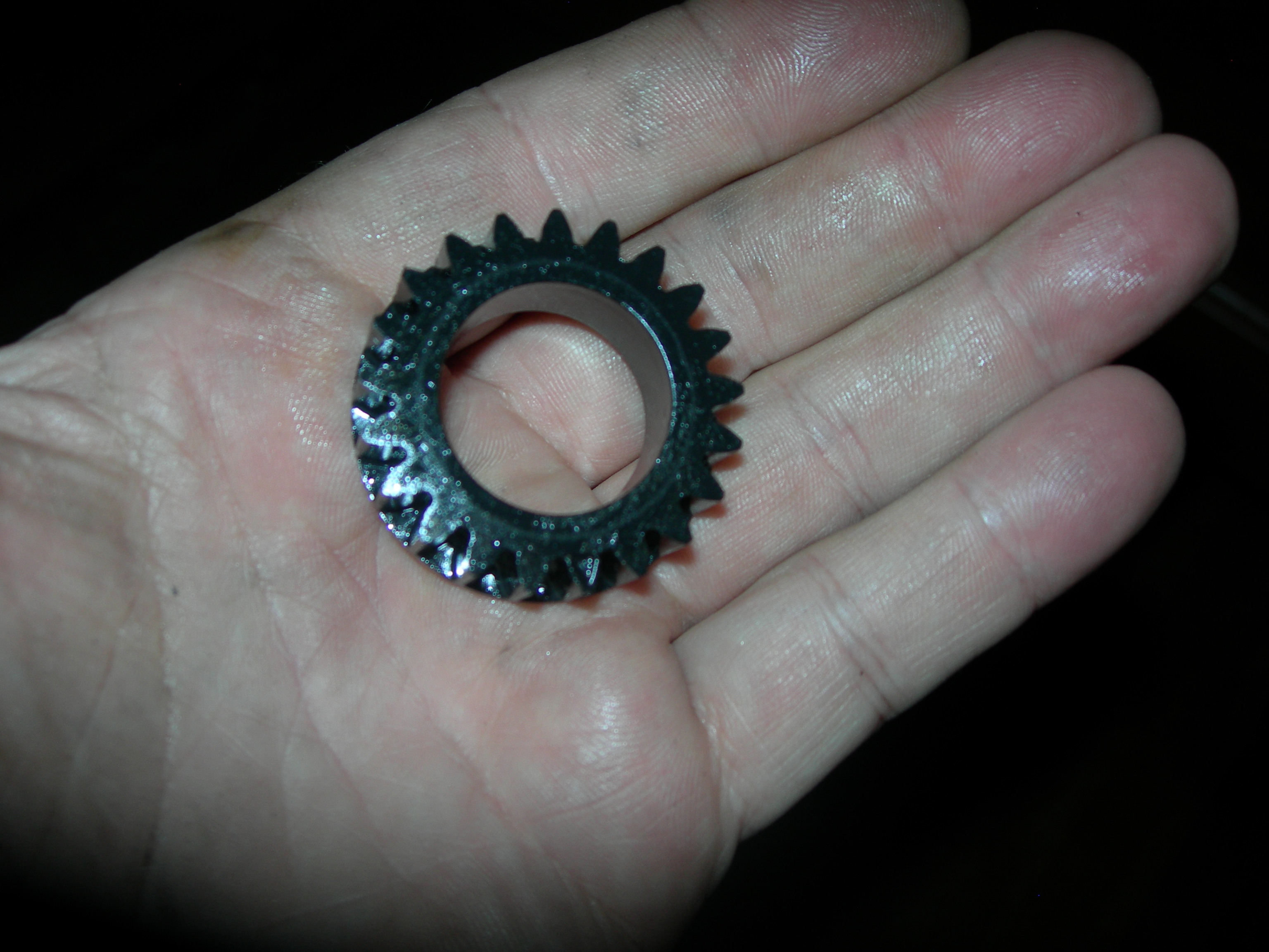

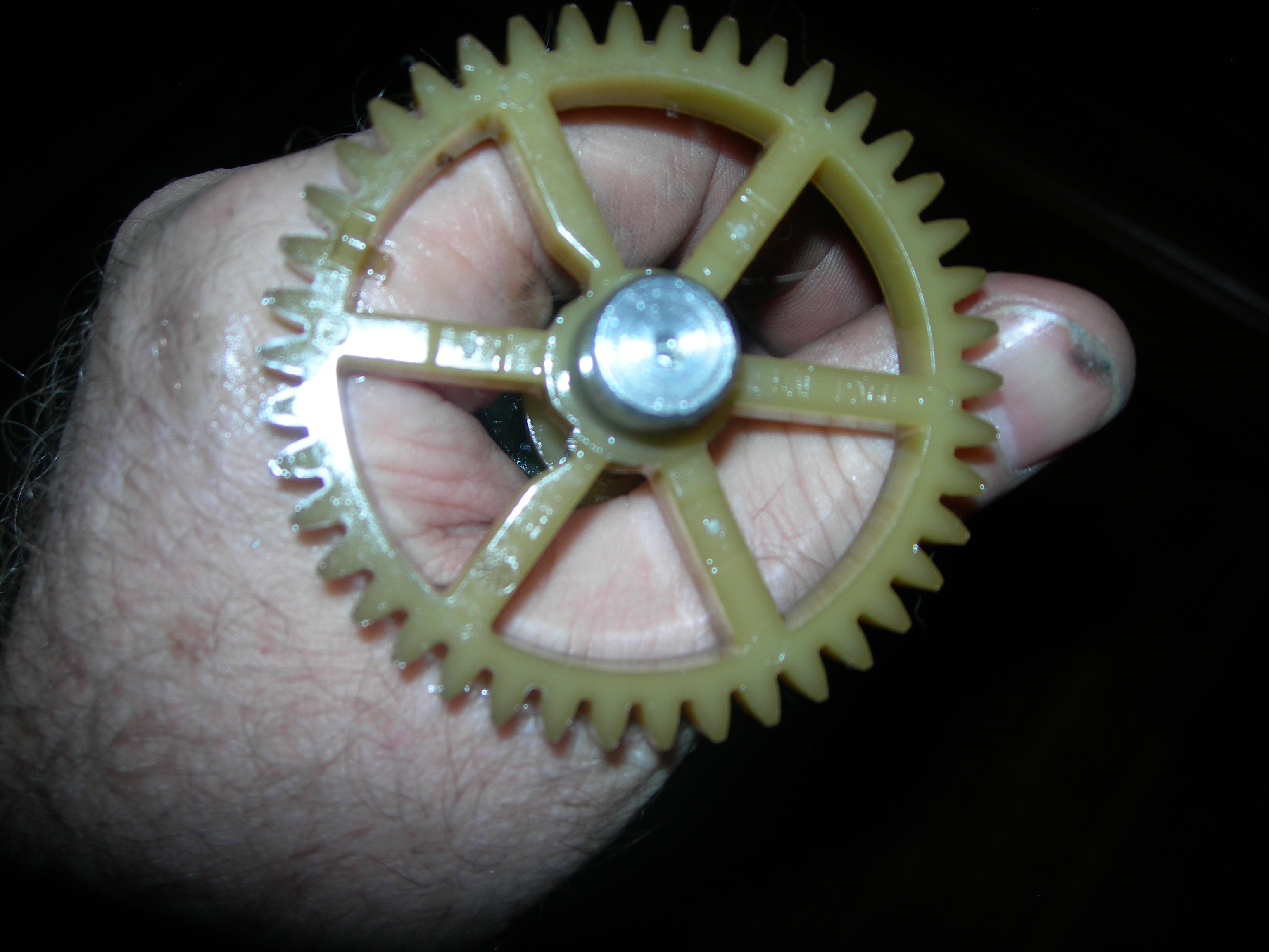

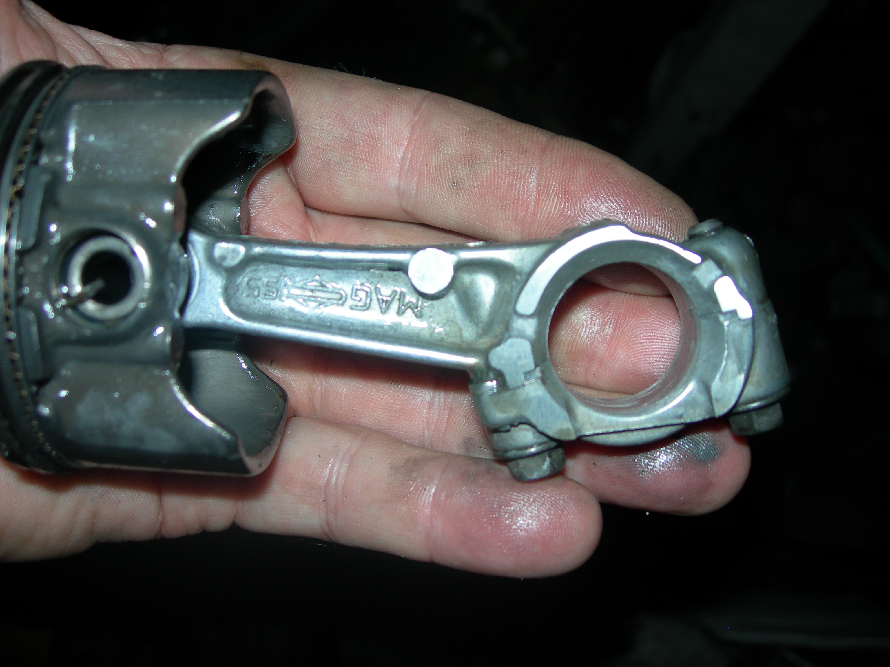

Well, been a while. I finally got all the 360 carbs sorted and shipped back to the correct owners. Latest 'project ' a 'brand new ' Briggs and Stratton 125cc lawnmower engine I was given it a few months ago. As soon as I heard it run I knew big end bolts were loose. It hadn't been used and was out of wararnty. Nothing to lose at it was free. Stripped it Sunday, as expected big end bolts loose, one tight enough to prevent rod flying apart but 'top ' one about 1/8" backed out. Obviously never torqued properly on assembly (or there was something preventing correct tightening?) Reason I'm telling 'everyone ' I couldn't believe what other stuff was inside it A forged piston ( way more expensive than cast)and then PLASTIC gears and cam pressed or moulded onto a steel shaft ??? ?? (how cheap can you get?) Some pictures, I need to re-do piston pic as it wasn't focused
Mower really is almost brand new, kinda ' I'll take it back some time ' and just forgot or maybe got too busy so started using a lawn service? Whatever it isn't ra real expensive one. I also have RGHG mower here,( CB350 cafe) it too is almost new but was stored under cover outdoors for about 2 yrs as he was working 7 days a week. Still has price sticker on it though. Picture of rod and crank as I didn't have camera handy when stripping,plus, I wanted to check threads would hold.
Cam timing is incrediby simple, arrow on black gear (at 6pm mark) lines up with mark on 'white ' gear (around 11pm)

Well that's a first.
Plastic cam. Who knew?
material science showing how far we've come I suppose.
My first full time job out of MET school after the Navy was machining pistons for Homelite. Most of those pistons went into weed whackers. That was a real blast, let me tell you.
