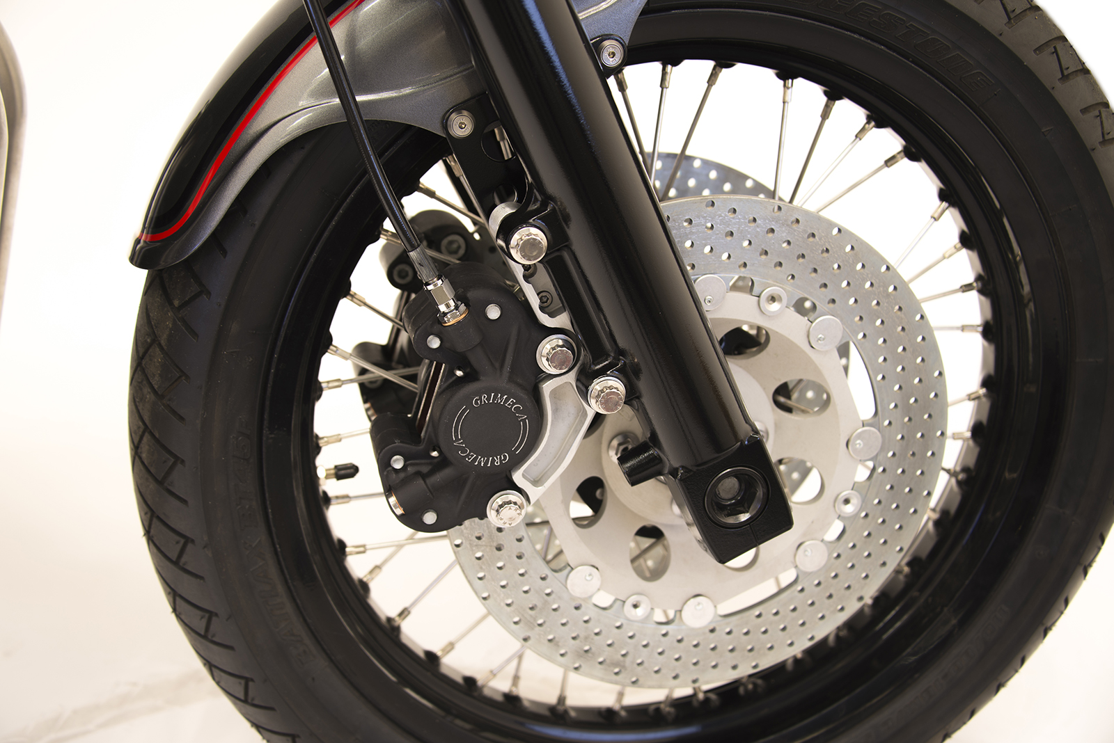

they're opposed piston calipers so there's 4 live pistons for a dual caliper setup. also the correct size is 41.3mm pistons. 16mm is the correct size as with a 41mm piston that puts the ratio at 26.7. As I said i run Grimeca copies of these calipers and have great brakes with a 16mm MC. I also run a 12mm on my single caliper brembo replica and that works well. the advantage the Brembo or Grimeca has over the Lockheed is they can accommodate a larger diameter disk. The Brembos are the nicest as far as fit and finish of the three.

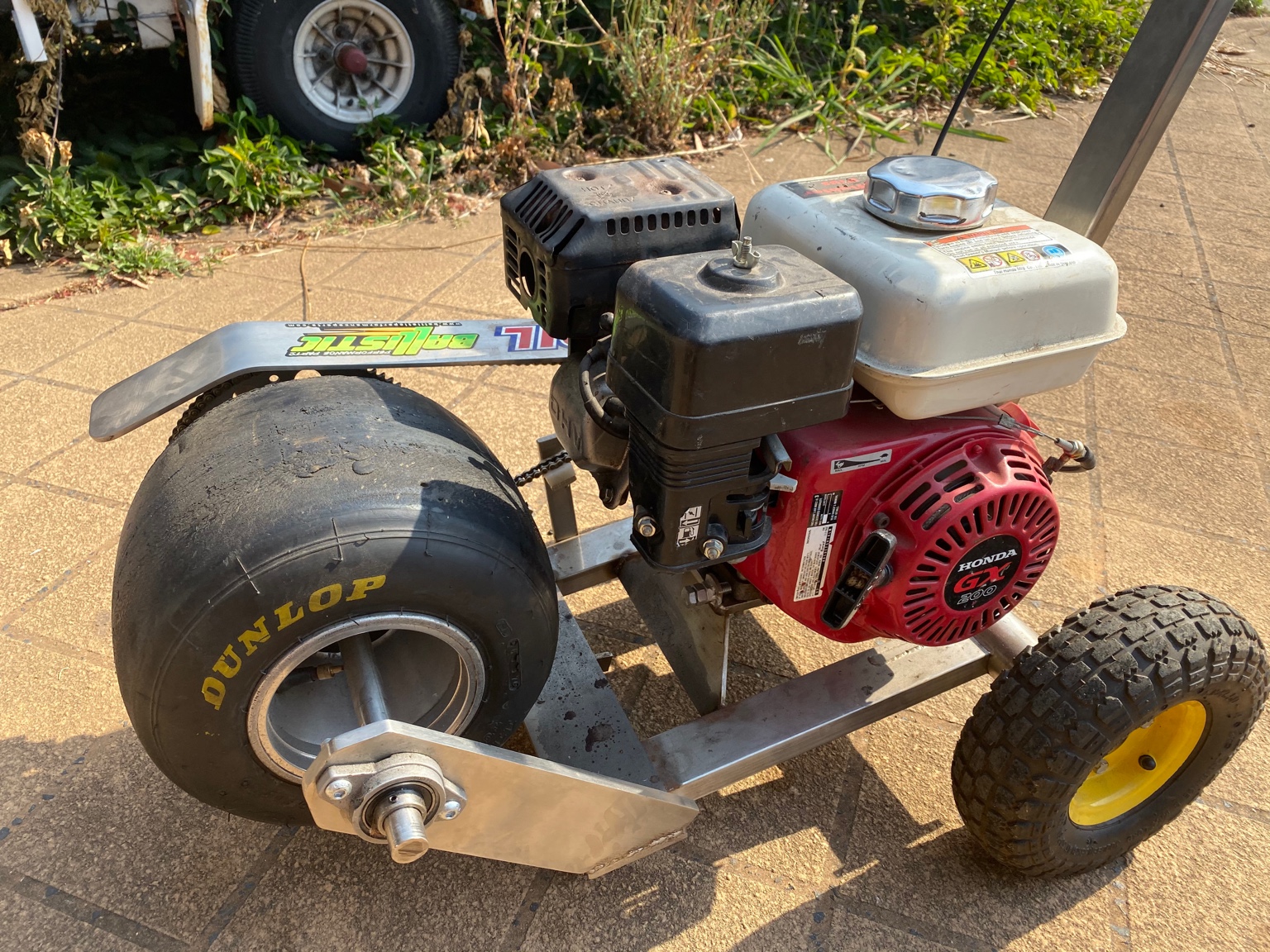

More pics Pete. Unsure about the gearbox let me know what other details you are after.

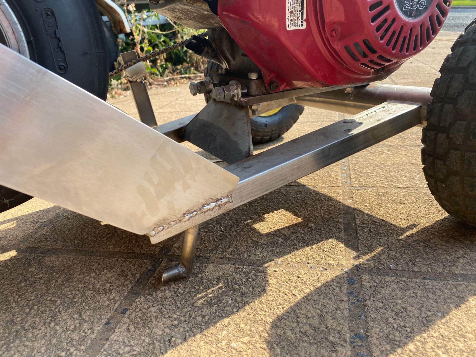

That's a bit sketchy in the welding department, but I like it. (And judging by the tyre it works, so who cares about the welds!)
I would suggest fitting a bigger sprocket on the engine though. Yes, this will slow the starter down a bit, but the chain won't have to go around such a sharp turn, massively prolonging the life of the chain and probably even freeing up the odd horsepower.
With your big slick design and the conversation on gearing, I can't help but wonder what the LSR for a 200cc starter motor is.
