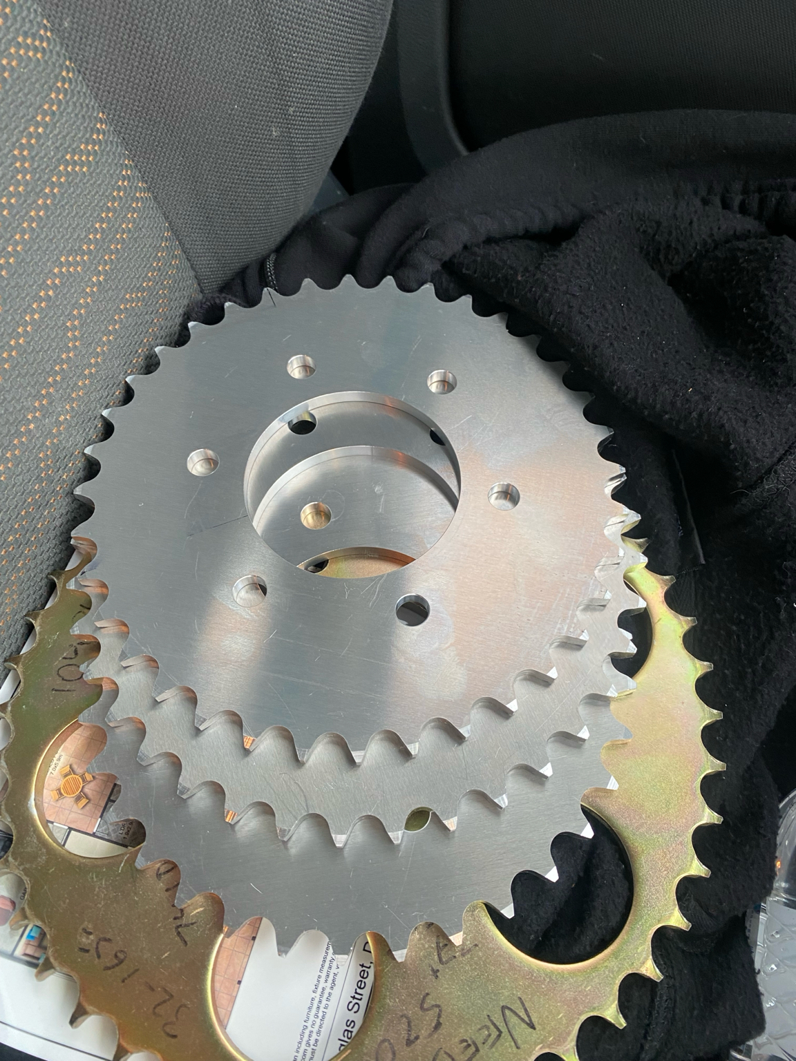

Bit more on exhaust carbs throttle brake measured spacers for new off set sprockets. The list goes on.

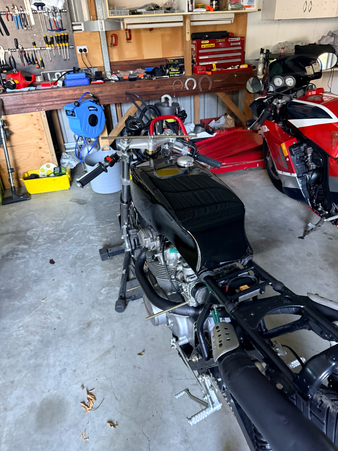

Coil mounted. (New Boyer one)
Rear wheel mounted straight and sprockets on.

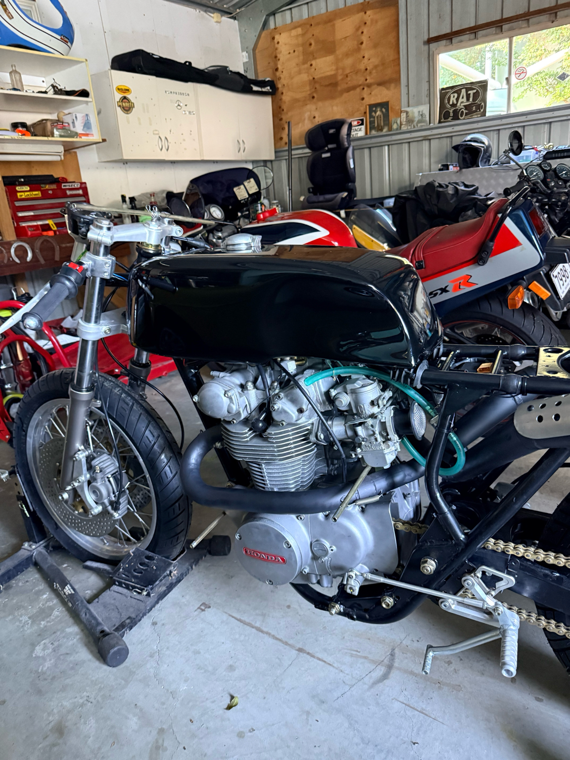

Exhaust springs on.
Heat shields on.
Just waiting for chain slider to mount chain. Brake lines to be done next.

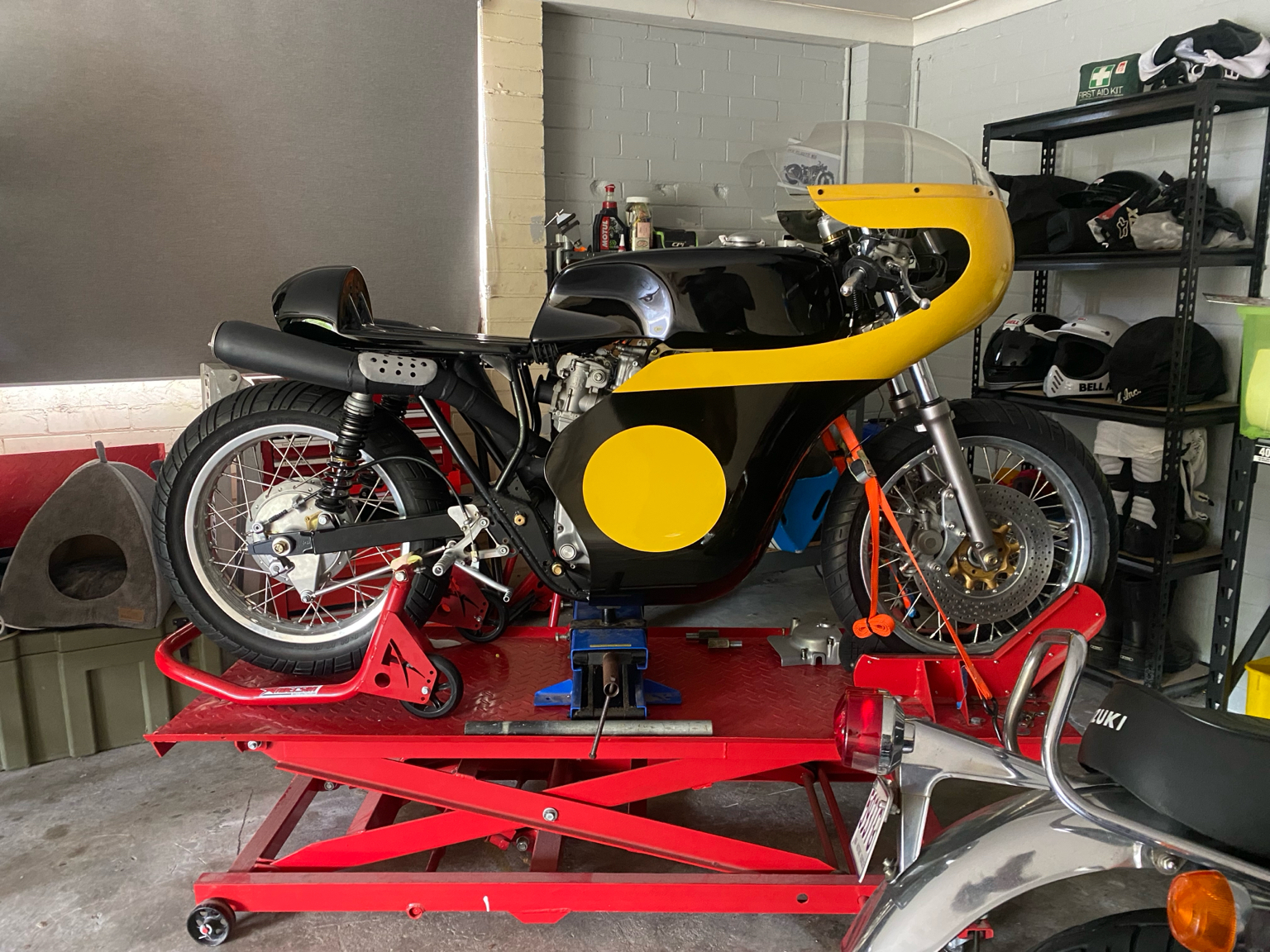

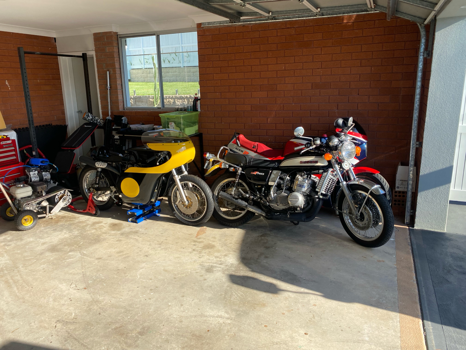

When little gems like this pop up it’s hard to say no. Yesterday I picked up this little cb450 race bike for a bargain. Apparently she was imported from England and was raced in the Isle of Man TT a while back. So I’m going to throw a lot of love into her and get her back to race ready status. Engine was rebuilt not to long ago so she just needs brakes paint and a bit of welding to get tank seat and rear sets on. Front is fzr rear is h1 ohlins shocks and strengthened frame. Fairing is too small so that will have to be changed but shape will remain the same.
Is there 2 different bikes in the pics or is it a before and after? Looks sweet!
