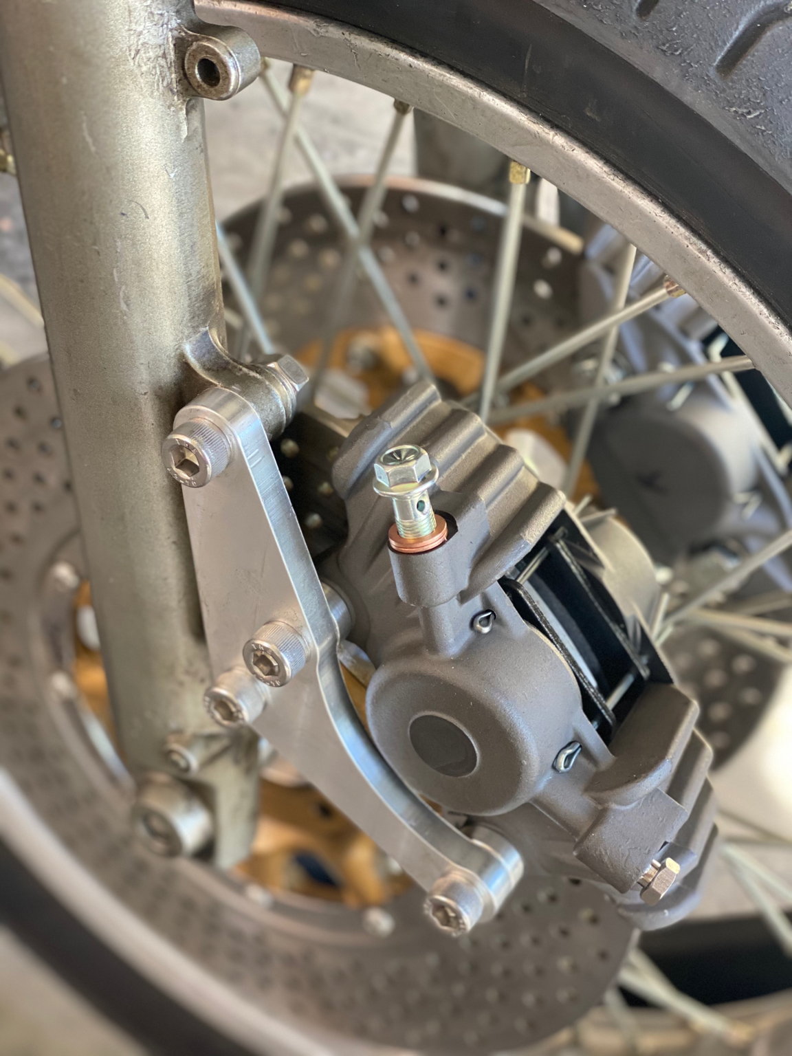

Got the wheel centred disk spacers sorted and calliper mounts cnc as well as a fork brace done.

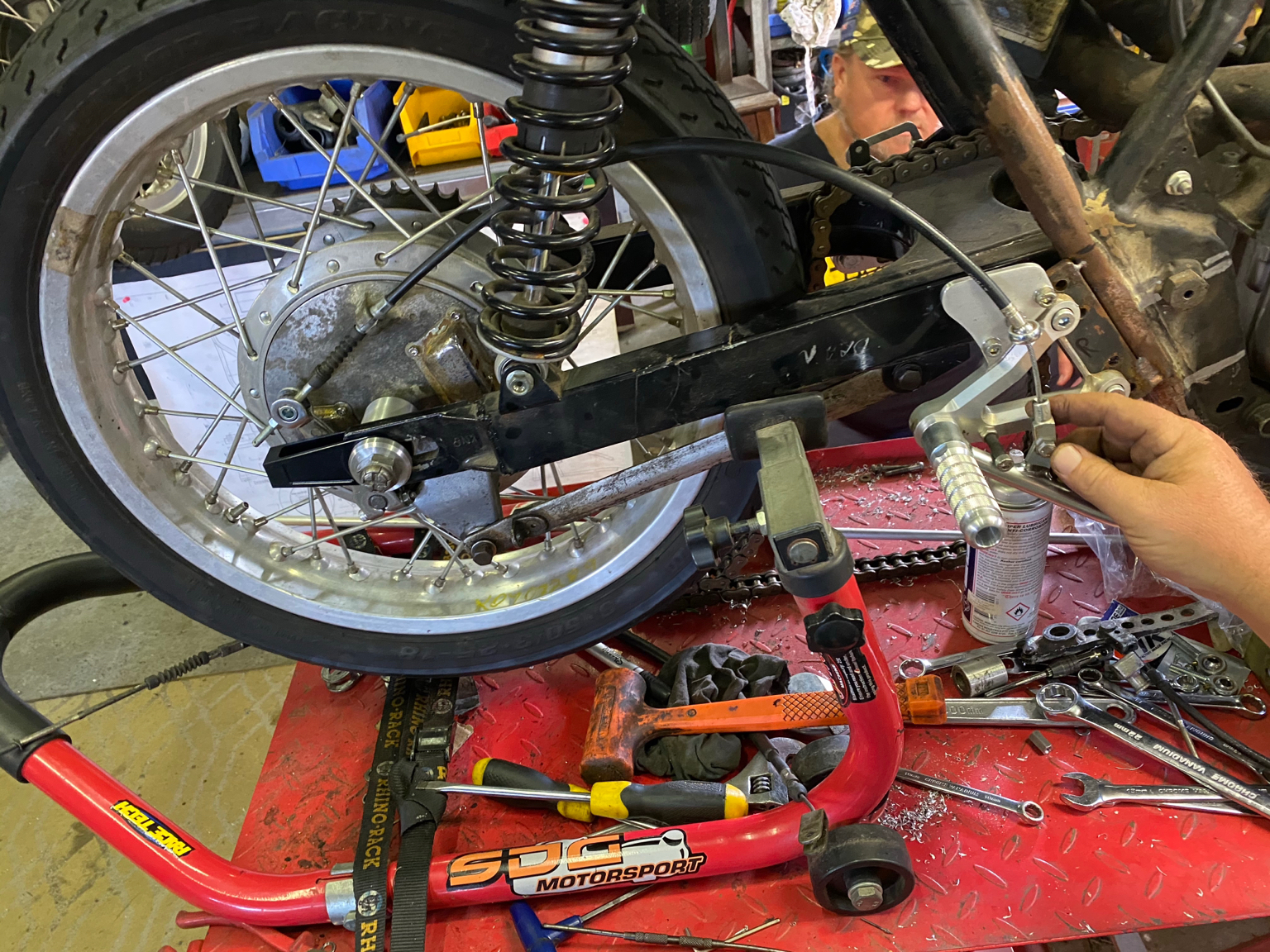

Rear set mounting progress and fab work. Slow progress with this old girl I really want to get a move on. Front end in also. New bearings ordered.
Nice rearsets, but they will drag if you don't raise them an inch or two. I like them basically in line with the swingarm to avoid digging them into the tarmac.
I have two more settings on the brackets and was going to see how these ones go before I raise them up a bit. I think they can go up 25-30mm or so.

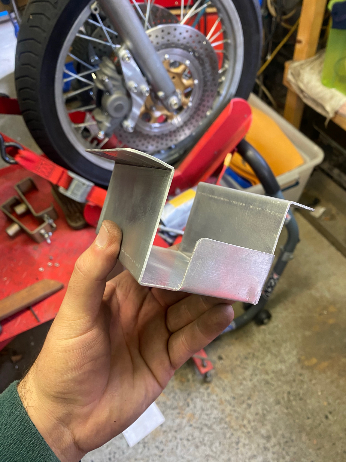

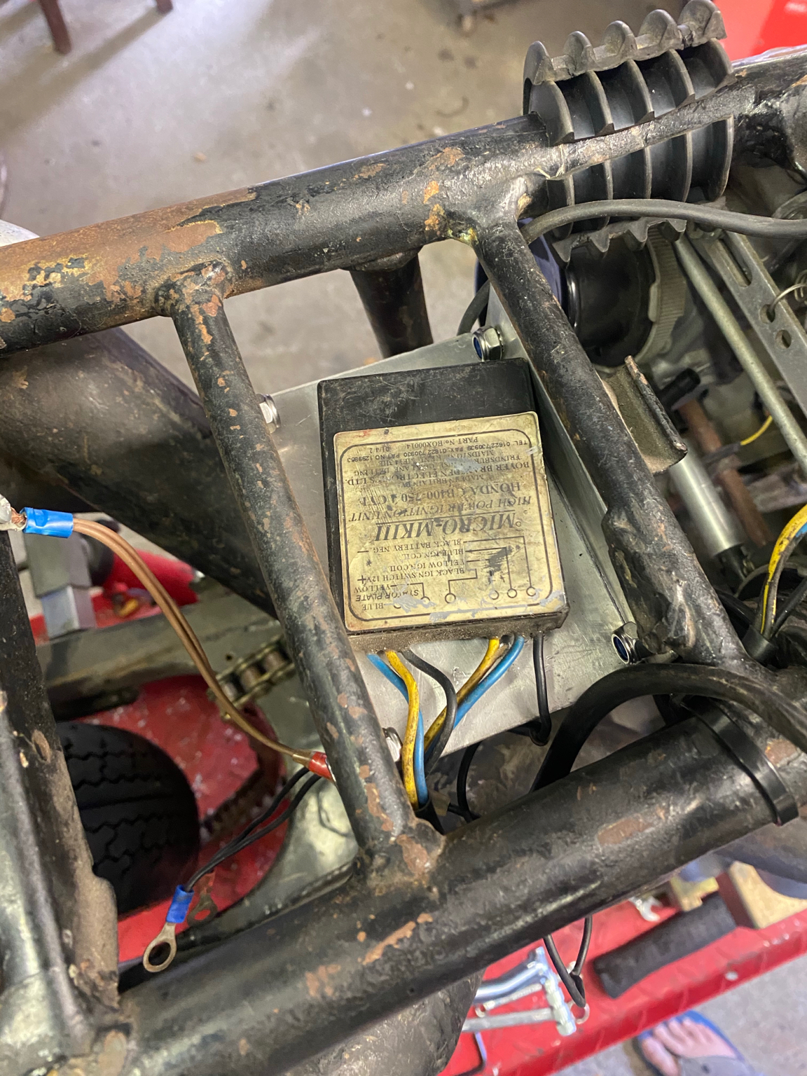

Made some larger spaces and finished the rear brake line and mounts adjustments etc. Next stop battery box and ignition box. Ordered a steering damper too.

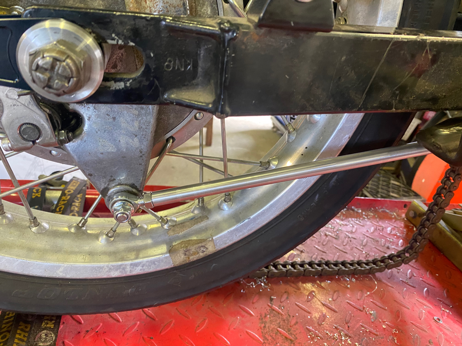

Nice battery tray and that brake torque arm is the dog's bollocks. Is the rear brake plate fully floating? That will be much more effective that way if it is. I usually float the rear brake plate but if truth were known I don't use the rear brake much on the track.
Hahahahaha its just a lot neater and half the weight of the old steel one. Not floating. It’s off an old H1 I think. What do you mean by float it? Any pics of how you did that?

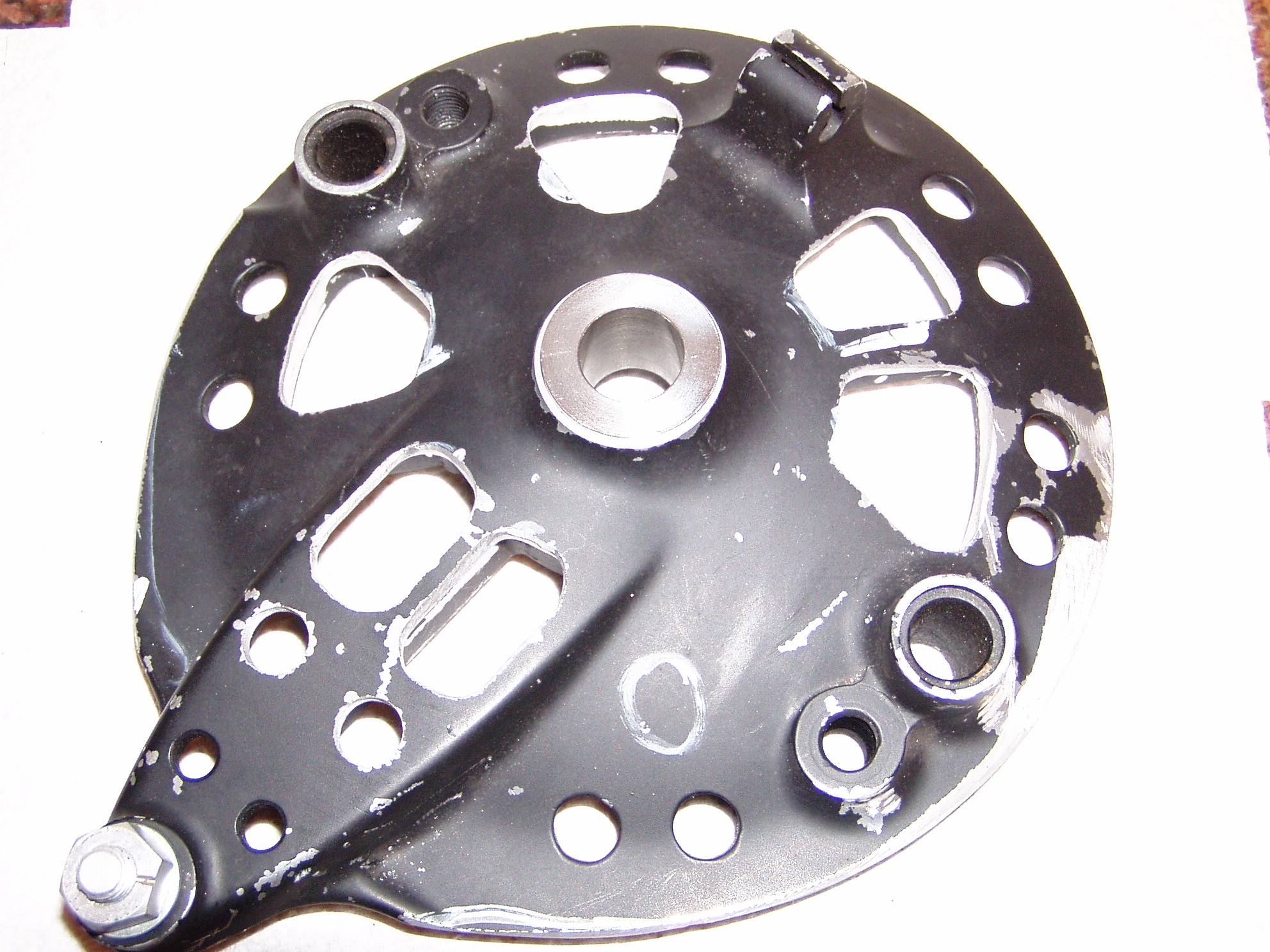

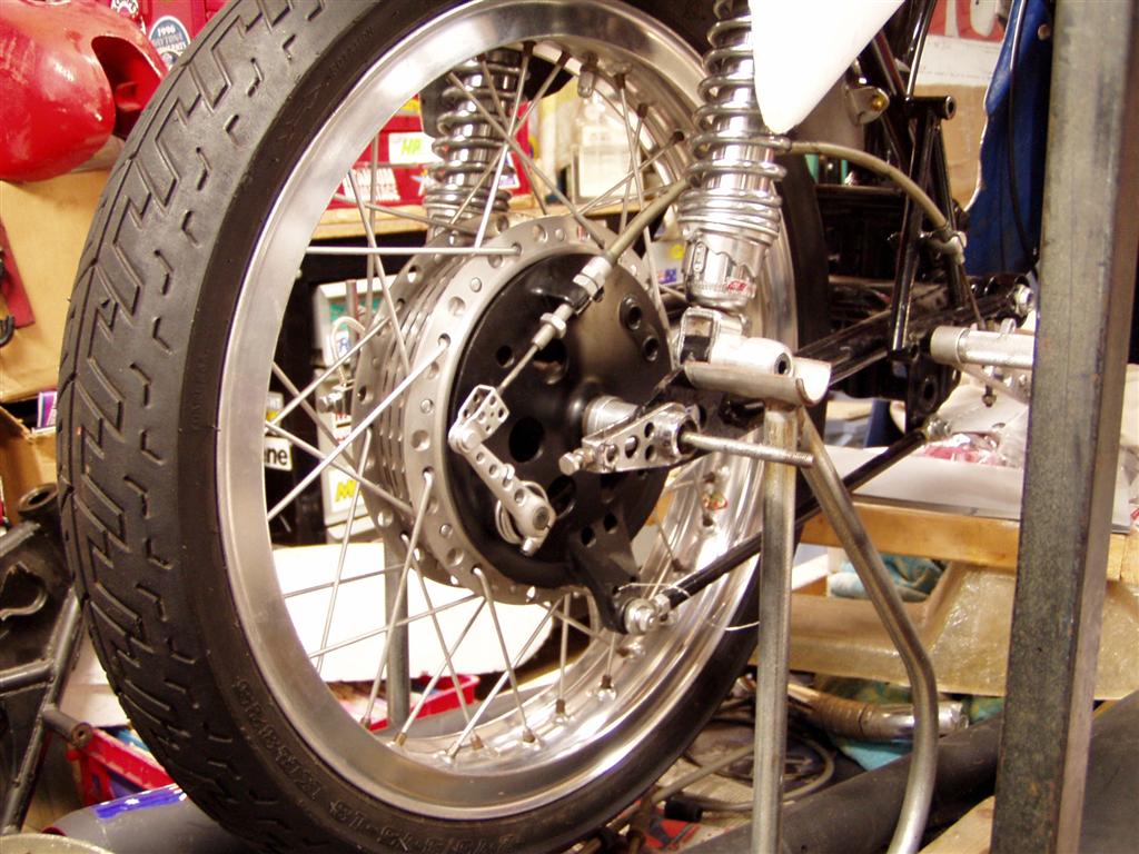

The idea is to allow the backing plate to rotate, so, the center has to be bored out and a spacer/center is slipped onto the axle with enough clearance to allow it to move freely. The torque arm is then tied to the frame rather than the swingarm.
As the rear brake is applied, the braking force creates a downward force at the rear end which helps to keep the back end down and braking.
It doesn't do much if the rear end is in the air, but right up to the pint of a stoppie, it helps. It's not easy to see but if you look carefully, you can see a steel spacer between the brake plate and the alloy spacer. That's a sleeve inside the backing plate and allows the plate a small enough movement to pivot easily and it also allows it to self center.
The first picture is on a CB160 racer and the other two are a CB77 350 race bike. Same idea though. That sleeve can be straight (without the end flange) if it's large enough, but if teh wheel spacer OD is much larger than the backing plate center, a top hat works better.

Love the rearsets and linkages. You running reverse shift pattern by the looks of it? I have never tried this, I wonder how hard it is to break the current muscle memory pattern! I really like the rear brake cable set up as well - that is something I should have done for my build and may look into in the future.
Great looking bike!
Thanks mate. I know it will be a bit odd, we will have to see how we go. It’s a new one for me.
