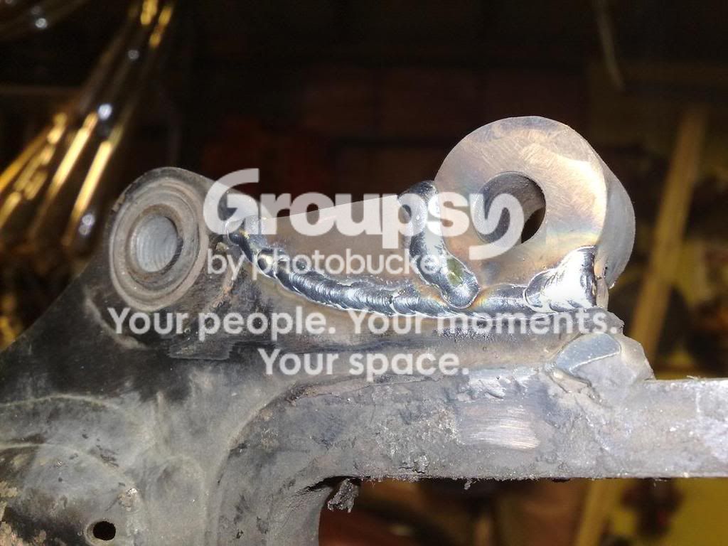

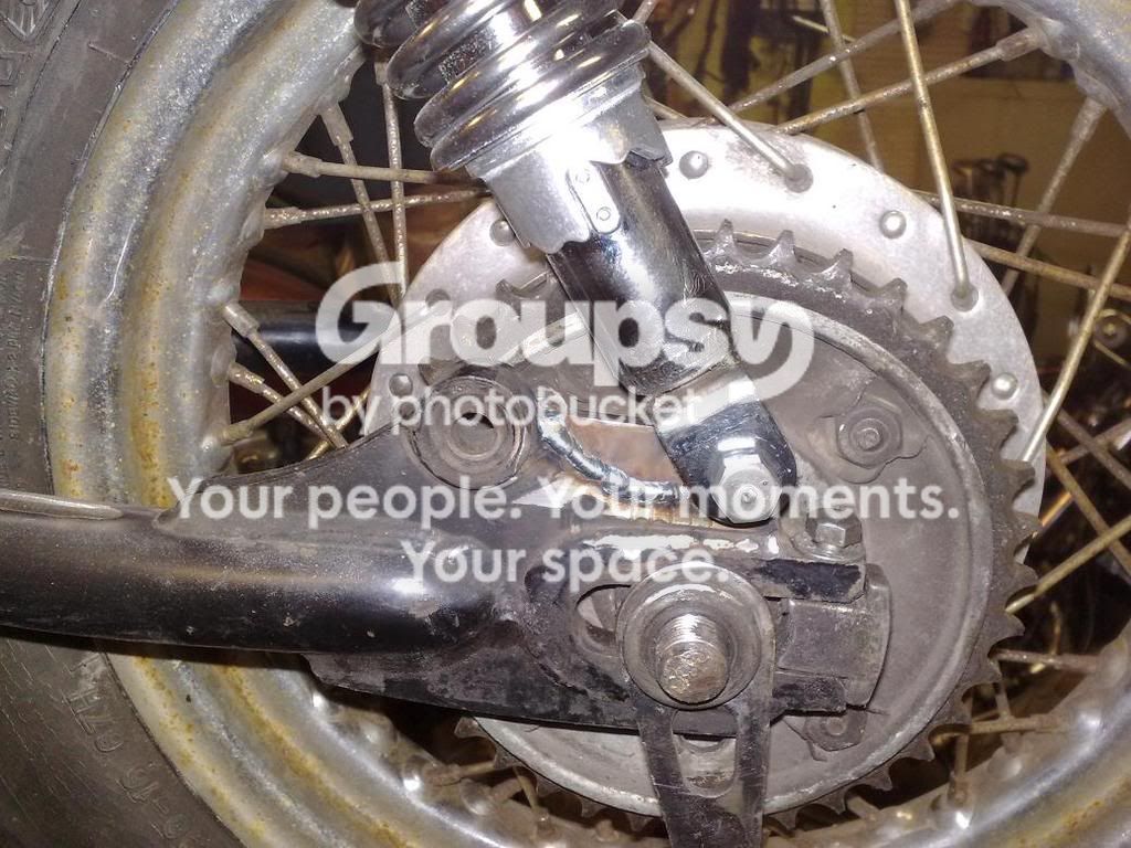

Made some huge progress tonight. Cut off all the tabs, ground down the old welds, set up the new shocks in their new mounting positions with my newly designed mounts. 11" shocks in the original lower mount was 25 3/4" from the floor to the top eye. In the new position it dropped 1 3/4" to exactly 24". ;D

The before stance with 11"
My new mount
Tacked in
With support brace
Re: CB550 bobber/brat
That does look a lot better. Well done on that. That's going to make the ride a lot softer, though you could always wind up the preload. That should help.
But why didn't you shave off the old mount?
--Chris
Babies woke up so I didnt finish.
