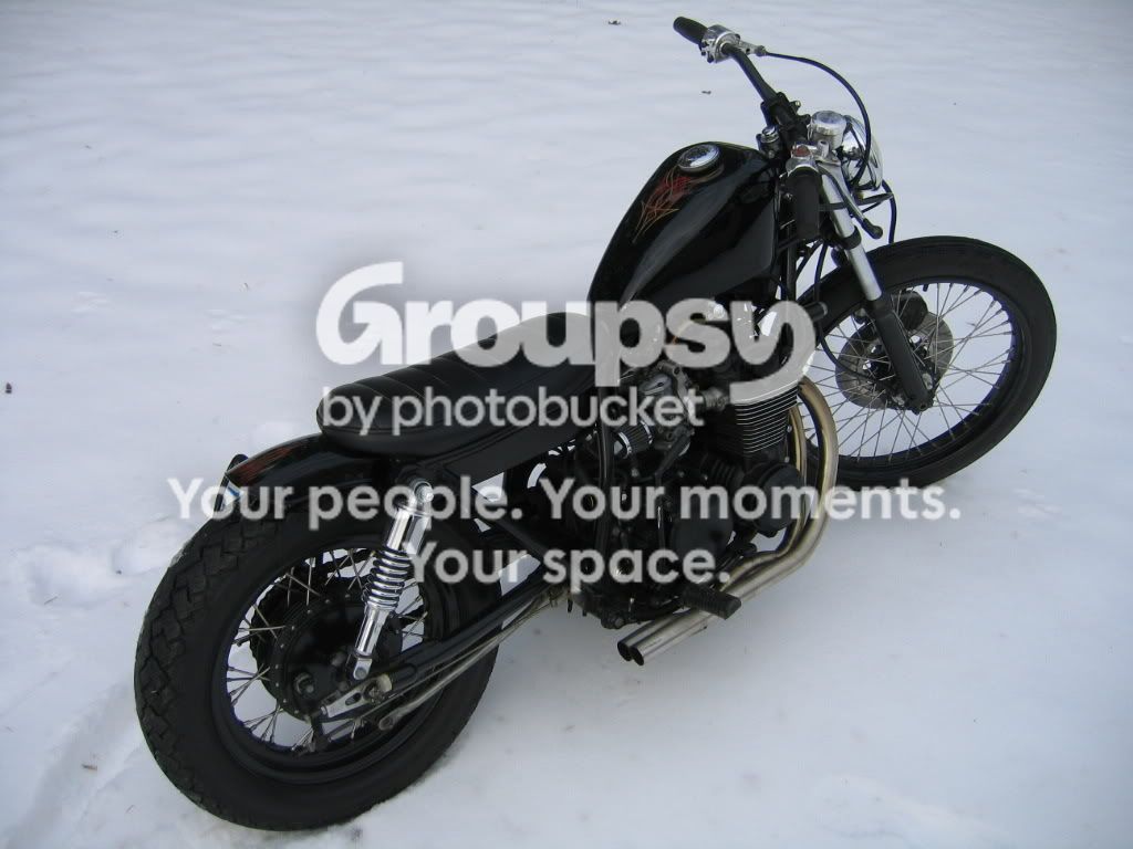

So i took some pics today of the bike, beaten and worn by the weather since it sat outside all summer with no cover...rain, sun have dulled the finishes and rusted some bolts but it still looks pretty good.
hey man,
looks pretty sweet.
it is a real shame to heir how it was treated though.
i wish i was the owner of it.
might build one yet though, this is a big insperation for me, to me the best bike one the forum.
definate feb bike of the month, for me.
