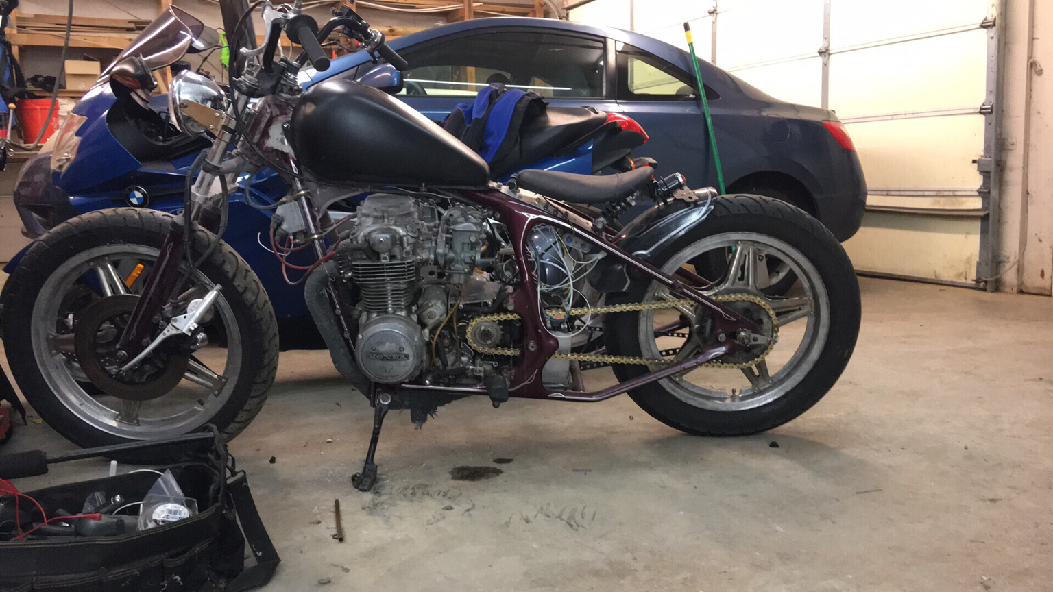

I think I found a better tank
As much as I like the smoothed look of the frame I think some of that’s gonna have to get sanded off so I can find a good spot to put tank mounts.

Be a shame.... could you do something like the coil mounts on the down tubes?
stance looks good but if mine Id lift the rear of the tank a tad...but thats me and everyone around here says I have bad taste :D

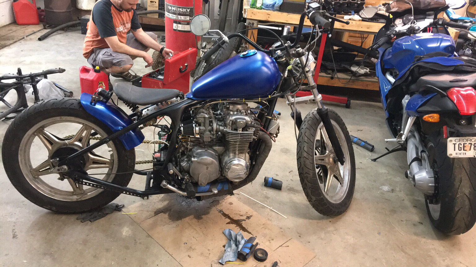

Been putting in a little work. Mounted the new tank. The stock mounts on the new tank were too long so I cut them and drilled a 1/4 hole in each one. I drilled a hole through the frame, ran a tube through it. A piece of 1/4-28 threaded rod then slides through the tank mount and the frame. An acorn nut on either side keeps it secure. I cut down the rear mount tab on the tank and drilled a hole that fits over what was the forward seat mount stud. I’ll have to drill another hole and relocate the seat hinge just a little aft.
I cut down my headlight ears. They aren’t perfect but they’ll work for now. I stuck the gauge on the tree opposite of the choke cable. I don’t really like it being off center, there was just a convenient mount hole for the moment.
I still need a front brake hose and then I think I can give it a test ride. It’s 10 days until the Meltdown in Hendersonville. Between now and then I need to finish up odds and ends, strip it, clean it and throw some paint on it. Sprint to the finish!

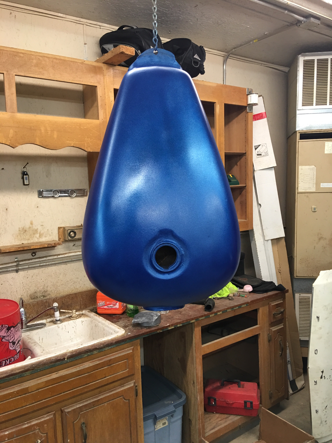

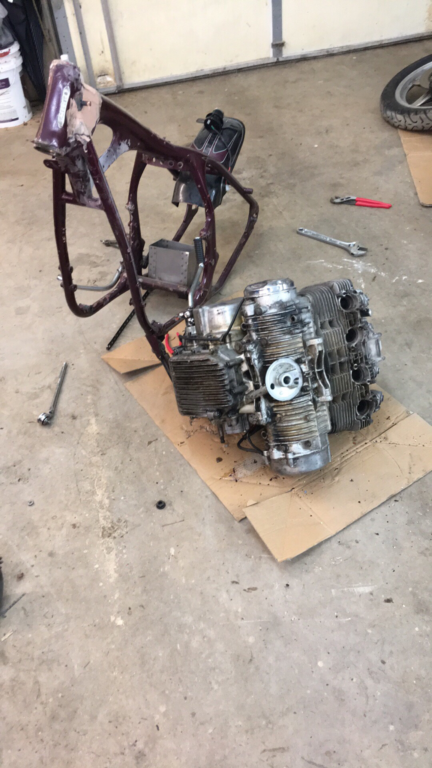

Burned some midnight oil last night. Took her apart to paint. It’s just gonna be a quickie paint job for now because I want to ride. Found a blue with a little metal flake in it for the tank, the frame will be black. It’s always a wrestling match getting the engine out of the frame on my own but I got that out. Smoothed our the bondo on the frame. Tomorrow I prep that for paint.

Maritime said:
Nice. Duplicolor? I used the metal flake on my GL. It really pops once you clear it.
It is duplicolor. I had to go look at the can. I didn’t pay attention to brand when I bought it. I just saw a color I liked with metal flake in it.

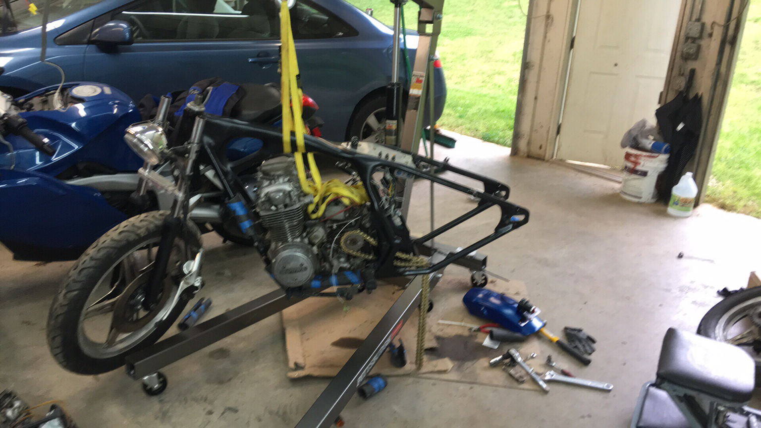

Got the engine back in the frame last night. That always seems to take a lot more wrestling than I’m prepared for. Sprayed a some clear on the tank and fender. I’m actually pretty happy with how they came out.
I painted the fork legs last night and left them to dry. This evening I should be able to put it all back together. Fingers crossed.
