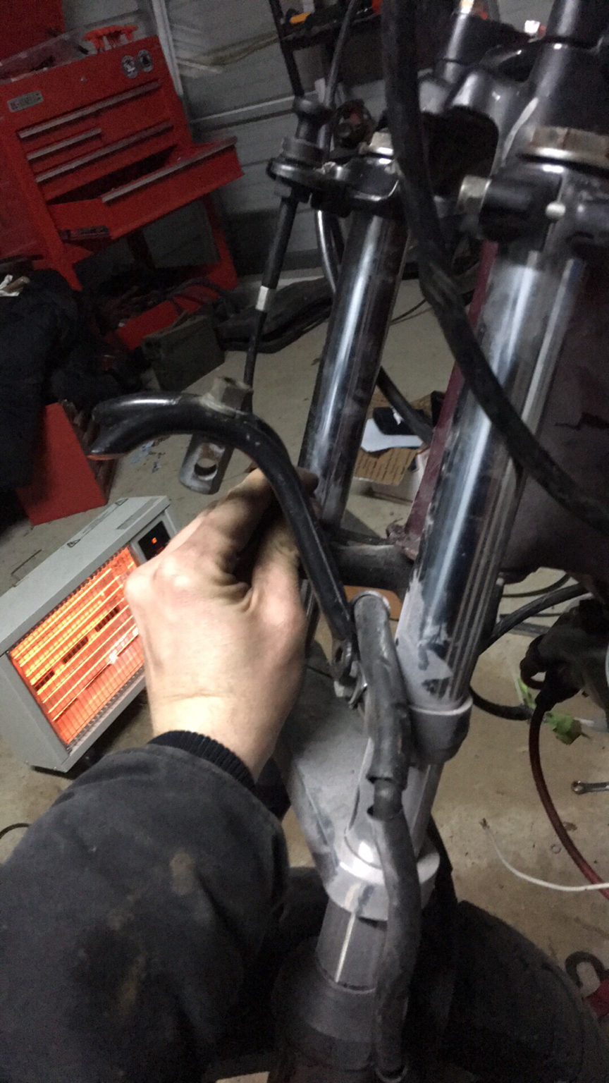

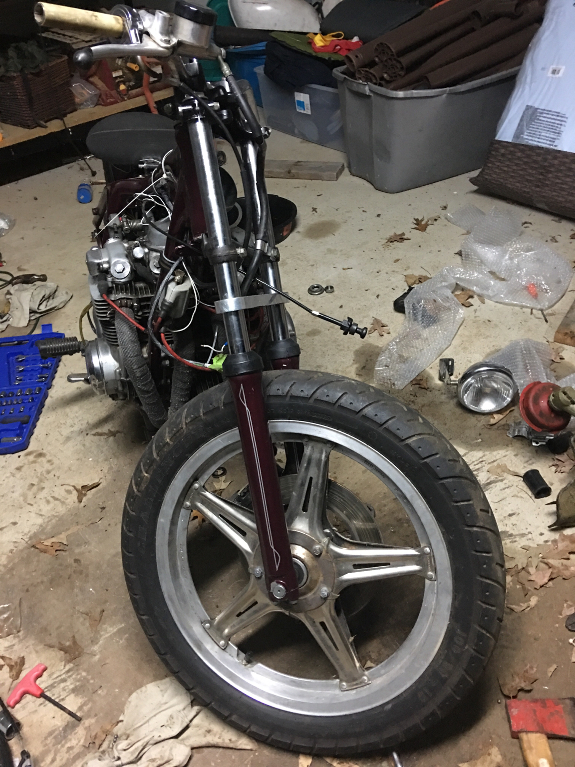

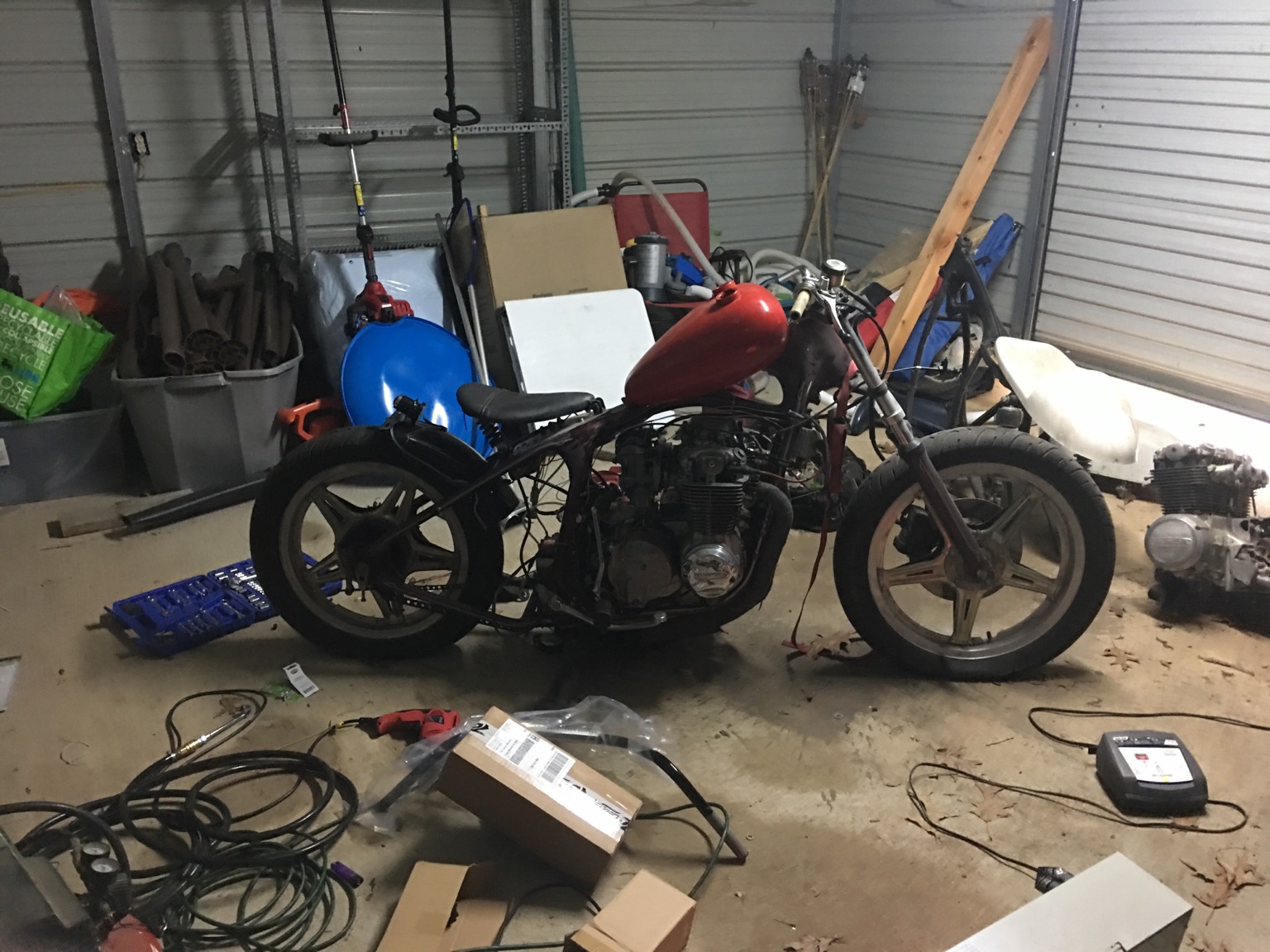

Long time no update. I’ve been slowly doing a few things. Ordered some parts and finally got them in. Picked this little tail light and mounted it on the fender. I’m not 100% sold on the look of these bars but the feel comfortable to me which is important. I can always change them later anyways. The headlight ears I bought are way too long. I’ve got this mount for a bottom lug headlight that came with the bike so I may get a bottom mount headlight, not sure yet. The rear tire wouldn’t hold air, turned out to be the tube leaking so I had that replaced. Still plugging along and hope to do more this weekend.

You can trim and redrill those ears pretty easy, but you'll want to paint or plastidip them after or they'll rust.
john i have a gazillion cx500 fork ears they have signal stalks that hang over the lower triple
but a zip disc makes them fall off quick or you can have the street light sized honda turn signals to
