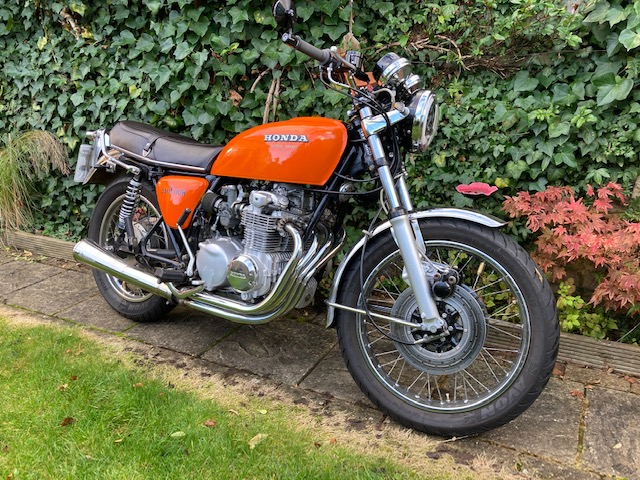

Hello boys and girls
it’s been a while so i thought you might appreciate a Scruffy update !
Scruffy is fan-bloody-tastic !
the remaining niggle for a while has been the front suspension being very harsh.
i’ve tried every oil grade, hagon springs, yss emulators and finally All Balls low friction fork seals - Hallelujah!
the low friction seals really make a difference, maybe 20-30% better plushness
the 600cc conversion, and a one tooth bigger front sprocket, allows Scruffy to cruise nicely at any reasonable speed …. and he has plenty of torque/power from 5k for the fun stuff. handling on the Road Riders and Hagons is really good and the double disk setup provides decent braking. He’s a blast to ride.
here’s how Scruffy is looking after a few thousand miles of fun use, mainly in the rain it seems !
steve

Nope, still not scruffy ;)
Another positive example of fender use. Congrats! But, I must agree with Jimbo that the moniker should change to something like "classy racer".
