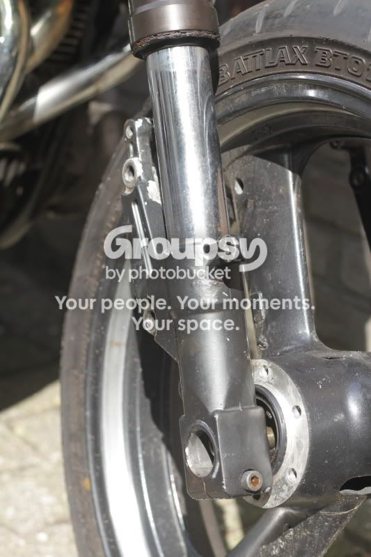

I hope someone can help me identify the year of the forks, because they came without axle. Front wheel is present so axle and spacers are all i need.
PO bought the forks for streetfighter project years ago and had no idea about the year and exact model. All i know it's from an YZF 750.
Problem is most YZF axles are 22mm in the thin part, 28mm on the thick part and 245mm wide total. Mine needs to be at least 2cm longer. (265mm)
the shorter one seems to be for the R series (R1/R6 and such..)
Here are some pics, please help me find out wich axle i need. Already managed to find the right steeringtube-bearings, and wheel bearings also to get my CB hub in with dual 6 caliper brakes :)
Ive got my CB axle in it now and no spacers (just for the mock-up, so no worries about wheelies hehe), so the wheel is not "nicely alligned" :P Here some pics:
and yes, the fork needs service on the oil restrictor right-side :P First want it all to fit, then blast and coat it.
This one looks about right btw:
Managed to find the right axle. 5bucks YEAY!

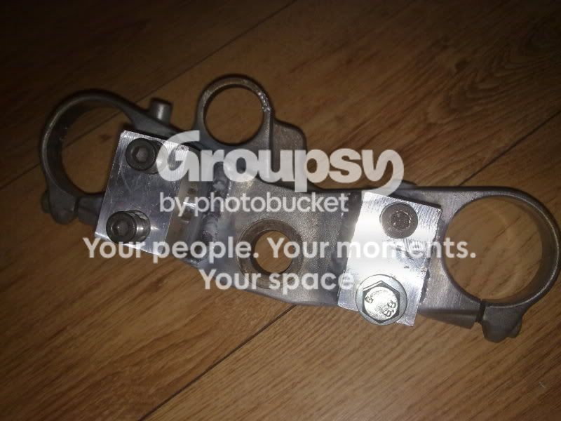

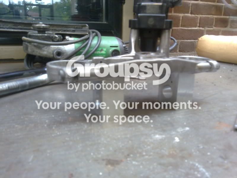

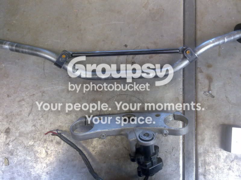

So, i've got my wheel bearings in, looking good. Also ordered the needle bearing steerer kit, and due to a 26mm bearing id and 25 od fork, used a 0.5mm shim from a bike store (apperantly they shim seatposts in frames with them..) wich needed a little tapping. Bearings are both in and working properly. Next is some risers on the steererplate (dont know the correct name). Planning on drilling two 8mm holes and fit the cb200 type risers on the steerer plate, with big-arse shims underneath. Maybe weld them on, i don't know yet.

Problem:
Solution:

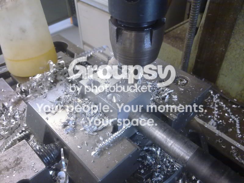

Undersides needed to be milled 7 degrees to fit the yoke.
Countersunk so 8mm 8.8 allen heads fit right in :)

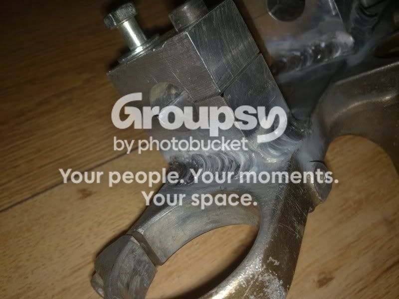

Jig for welding:
Welding comes tomorrow - gonna clean the yoke tomorrow before welding and put the whole thing in the oven for about 1 hour to heat up so welding goed better.
And i was out of allen bolts so thats why there's one normal metric bolt for welding.
Already happy with how the risers turned out, hope the yoke will stay straight under all those filthy amps tomorrow *crossed fingers*

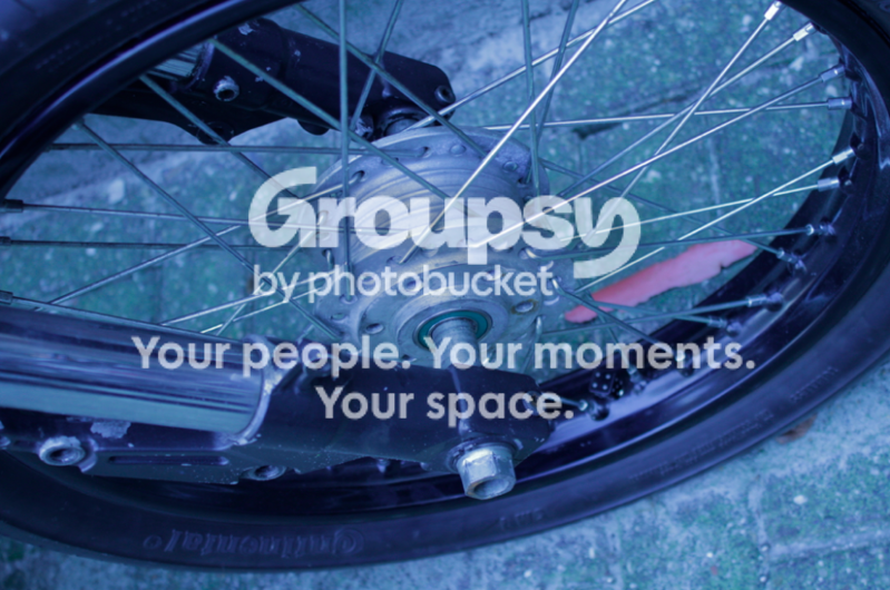

I installed the original front wheel today,with the unicycle bearings. Also machined a spacer between the bearings inside the hub. Everything fitted perfect and it was a less than 5 minute job. Sweet.

update pics. (Colors are a bit funky cause i forgot to put my 7D in nerd-mode after music-video wich needed this config)
Not sure if i want to make the welds smooth or leave em this way. Like the DIY factor a lot..

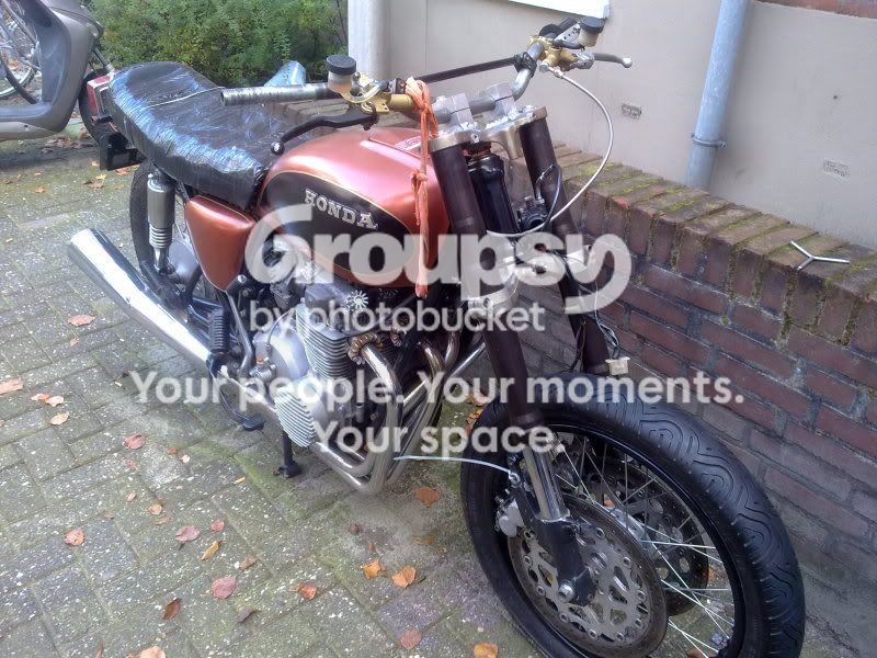

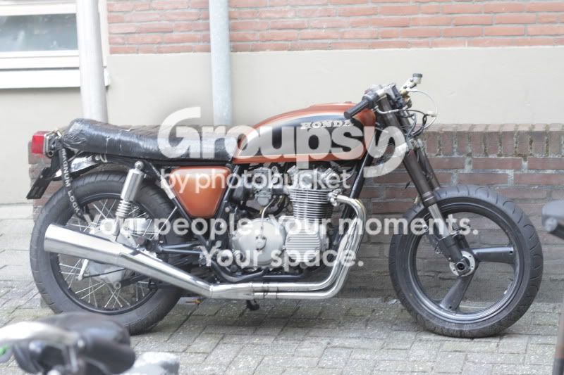

yeah yeah, i know... 30 days blabla..

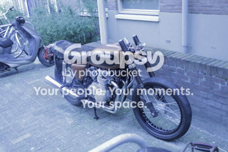

here are some pics of what it looks like right now. No big updates as i am in my final year and need to study a shitload.
