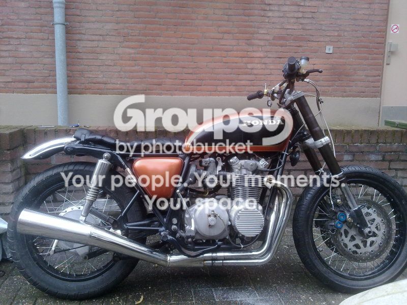

CB550f 1976 back from the dead project.
Back in business!

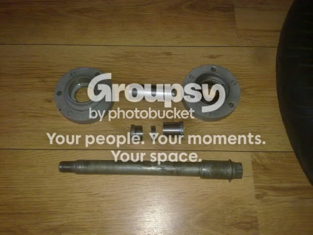

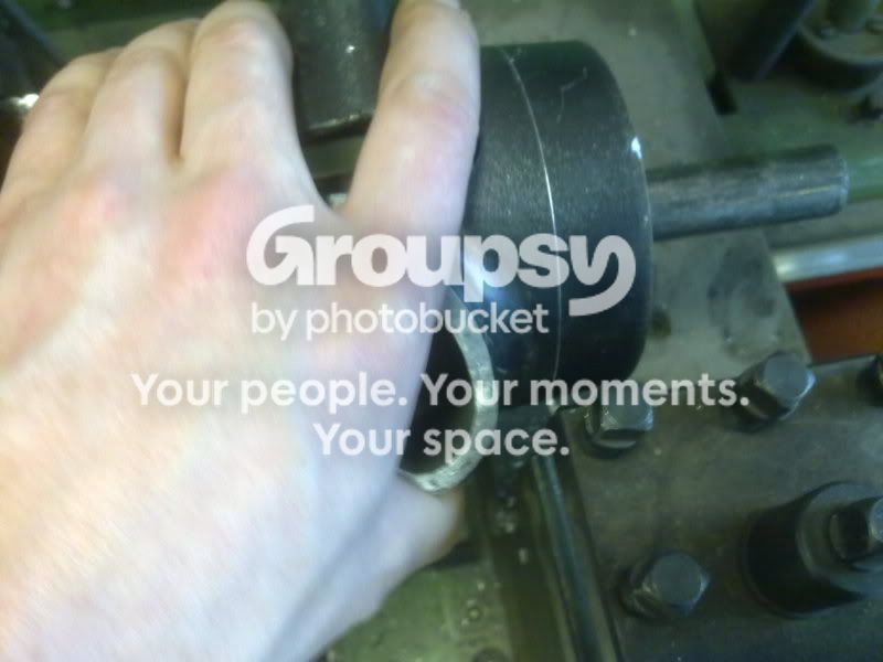

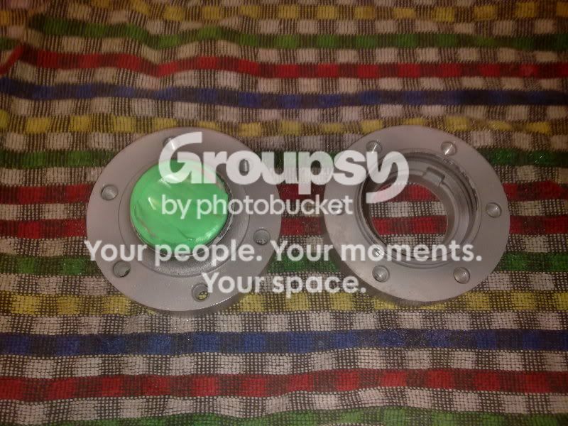

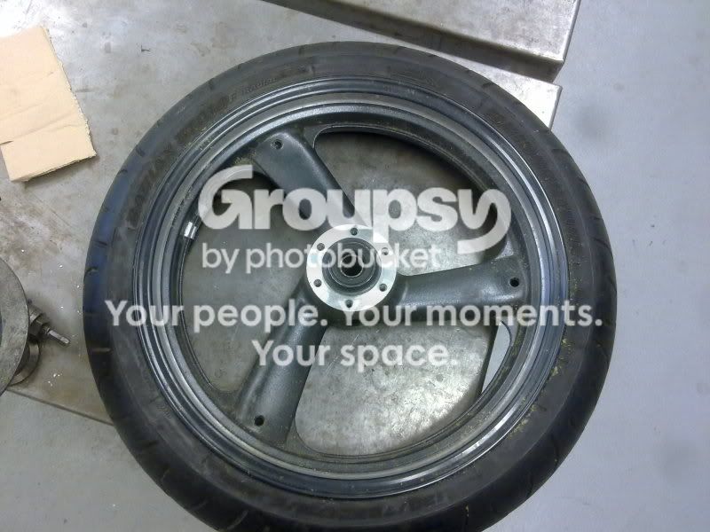

The Honda hub is smaller then the YZF hub and therefor i needed to make adapters to make the brakes fit.
Didn't have alumium or funds, but found the perfect adapters. in the YZF wheel i did not sell eventualy hehe..
Don't think explainations are needed, it's pretty straight-forward machining.
I felt smart when i discovered the adapters being in my workshop all month :P
Eureka!

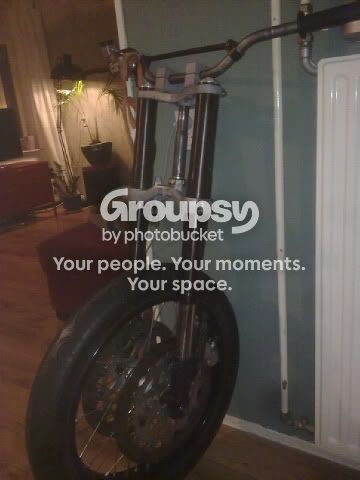

140mm - check!
bits 'n pieces

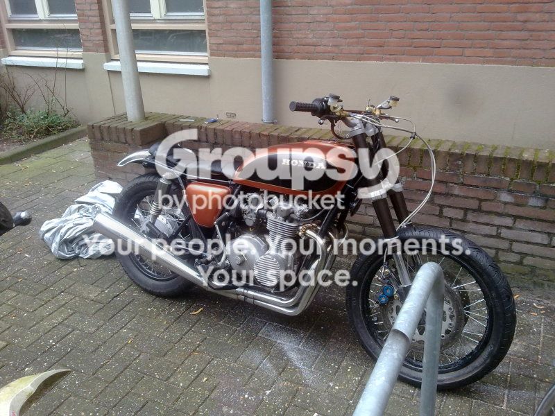

she's so pretty, she can sleep indoors
bolted up
need to trim the bolts a little bit
sexy ;)
I'm so goddamn happy this job is done. Took forever and was a royal PITA.

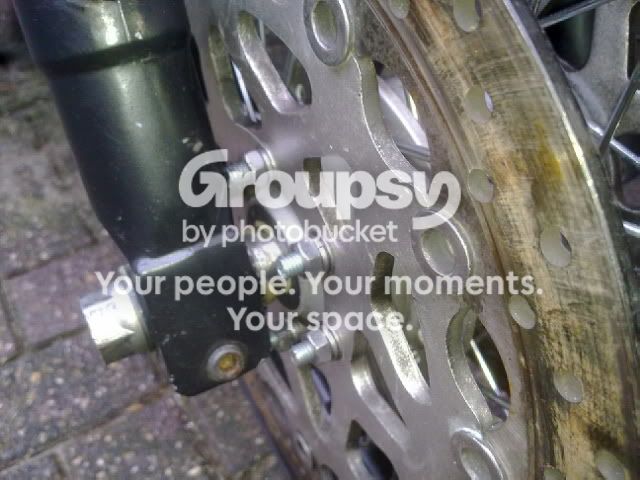

there;s one thing i need your (all of you) opinion about. funjimmy's adapters have rings to fit in the hub. for allignment and stiffness and such. i dont on one side. the 6 8mm 8.8 bolts are everything holding hub and bearing together. There's a little edge, about 3 or 4 mm that centers the adapter though. i hope it's clear, cant explain it any better.
are the 6 bolts strong enough?

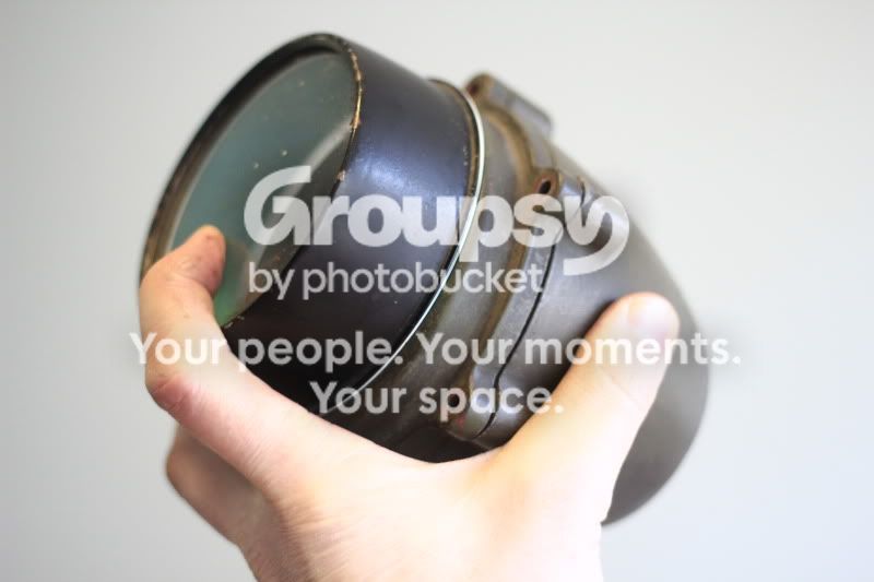

Did a little tinkering on a taillight i bought. I think it's to big for a taillight. Instead, i'm going to use the housing to accomodate my speedometer and ignition lock. Odds are they are EXACTLY the same in diameter!
Removed all the little bits 'n pieces. Just speedometer, oil and neutral lights. No tacho either.
the lighter is in there to keep the meter straight...
Going to take care of the inside of this thing on the lathe, so it will become a ring to lock up the speedometer.
end result (planned), without the ring on it obviously.
next to being a perfect fit it's a rigid lump of metal, so ideal for my ignition lock and wiring shizzle.

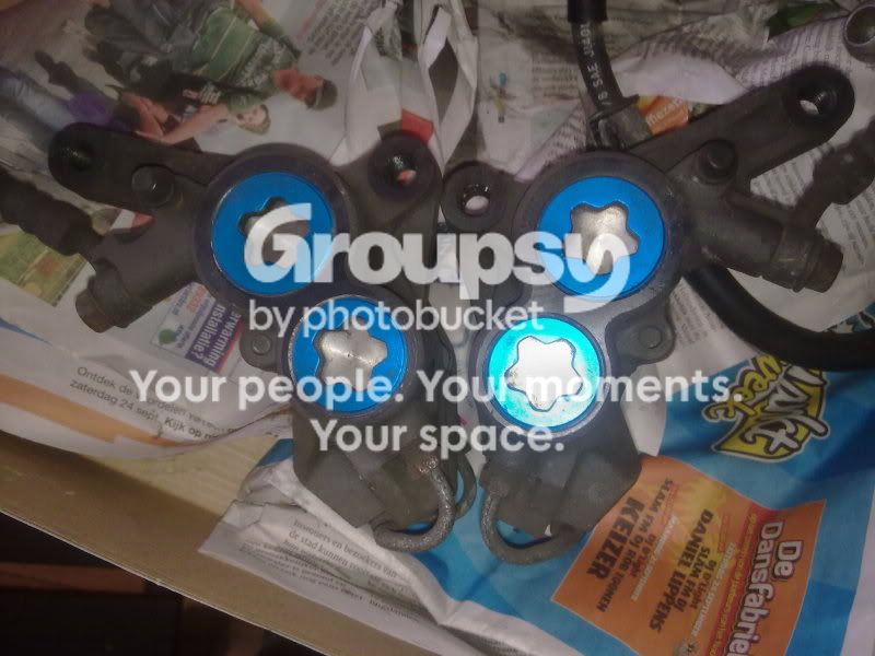

just bought myself some sweet bluespot 4 piston calipers cause the costs were even between that or revision kits and such.
Gonna look killer :)

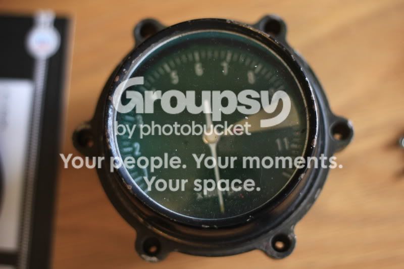

I also found out i can still use the original tacho cause i used the "original hub" part. Have to check the speed though and adapt the tacho plate with the numbers. Easy,i have that open already. life's gooooood!
Anybody know where i can find info regarding the scale on the tacho without using a GPS and marker alongside?
Some formula or both the rev numbers from the cables? YZF750 94' vs cb550f '76

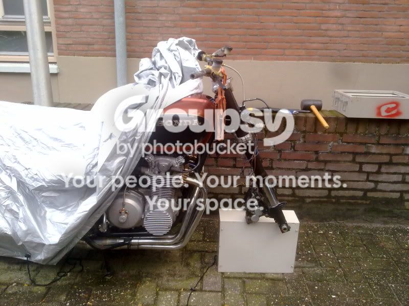

gonna slap em on this afternoon. Heard somewhere they won't fit without modifing the fork legs?
Mounted the calipers today. Forks needed to be filed (not sure about if that's the correct word..) but it's all good now. they clear the spokes by about 2mm. Enough :)

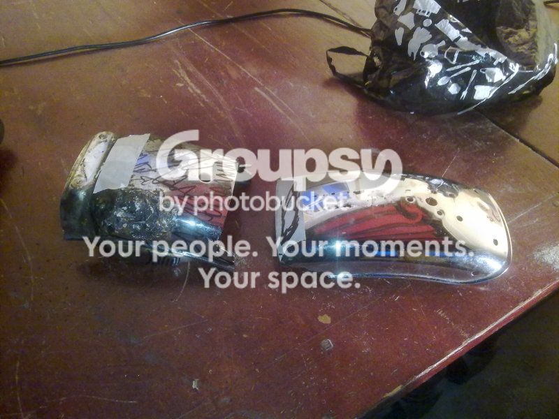

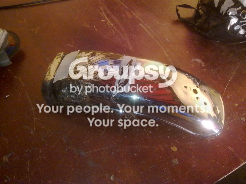

used FunJimmy's idea on the fender. The mounting part got chopped and i removed a large piece from between the fender. Then welded them together again. Will get some resin over it to smooth it out.

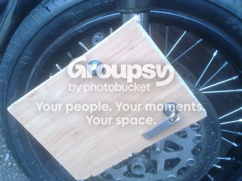

Pics:

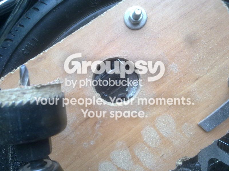

Wood? wtf?
Determing center:
Skwweekkkk skwweeeek skweeek (you know, when a tool made for wood is used on aluminium ;))
Swing!
