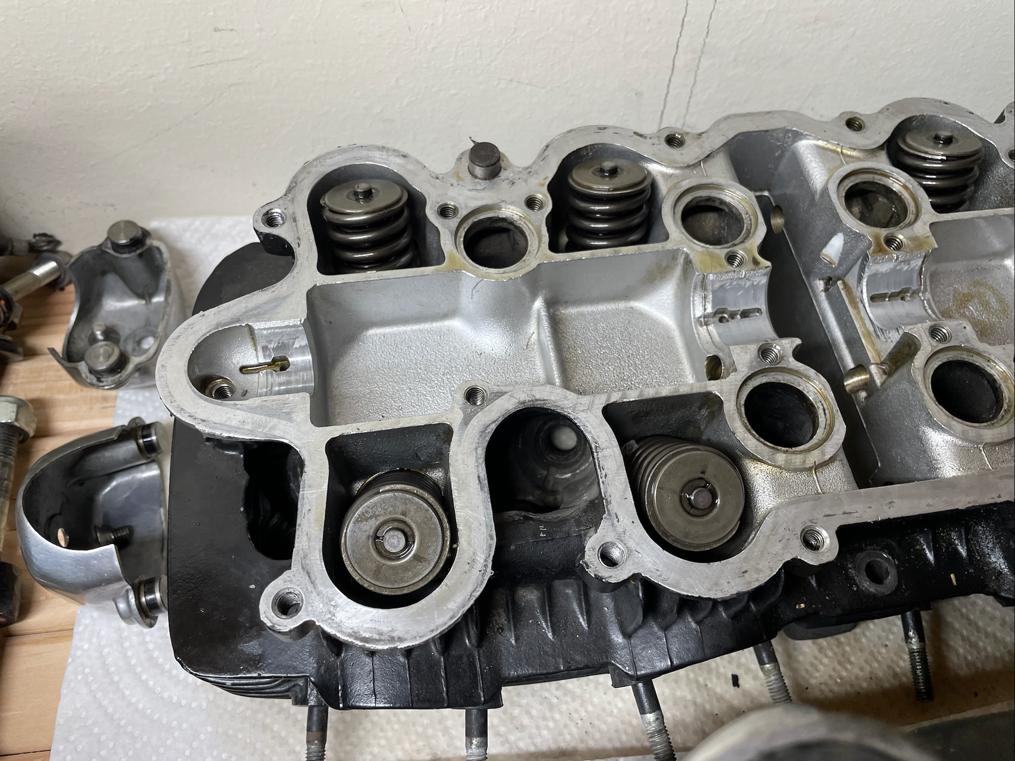

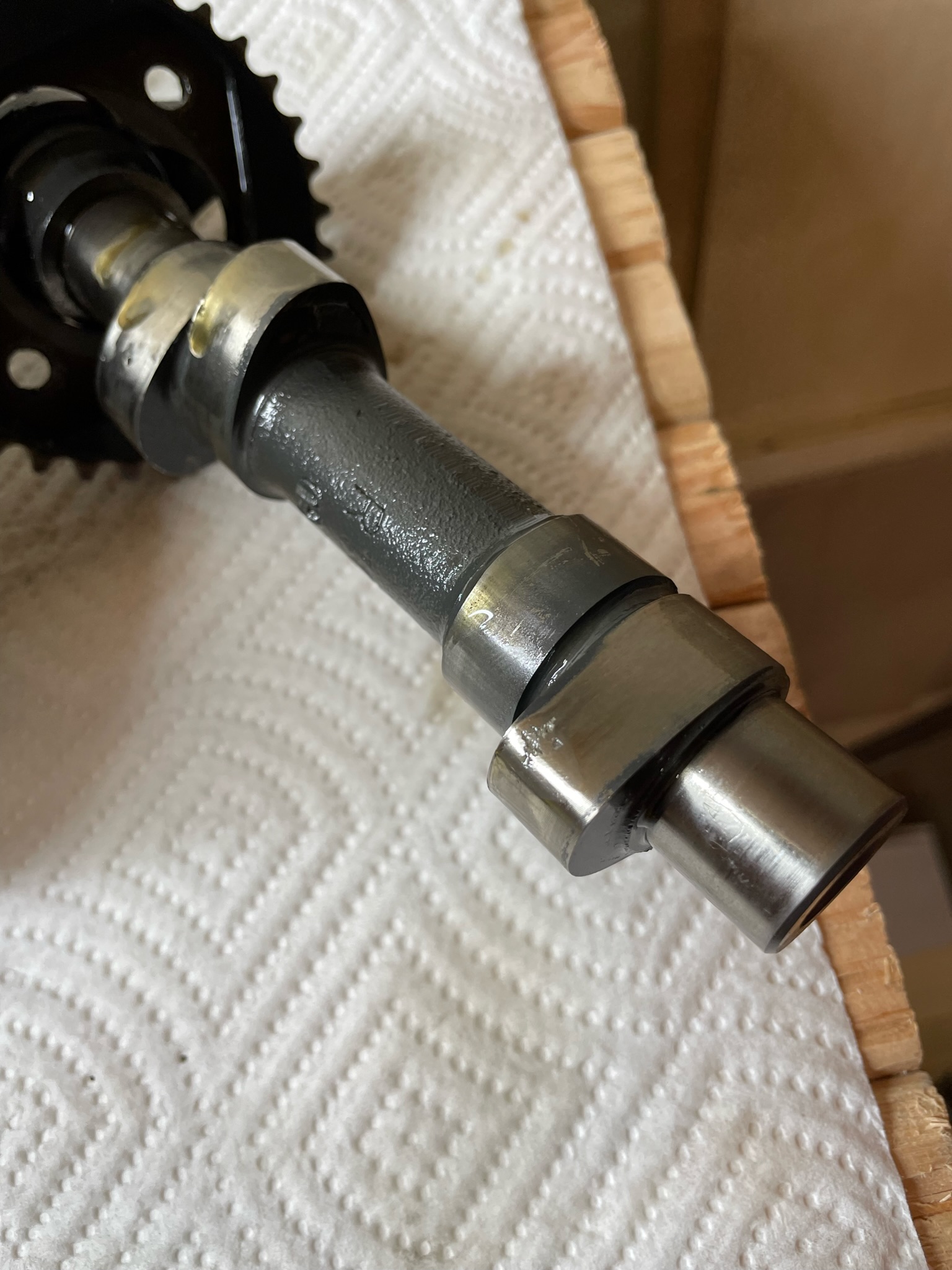

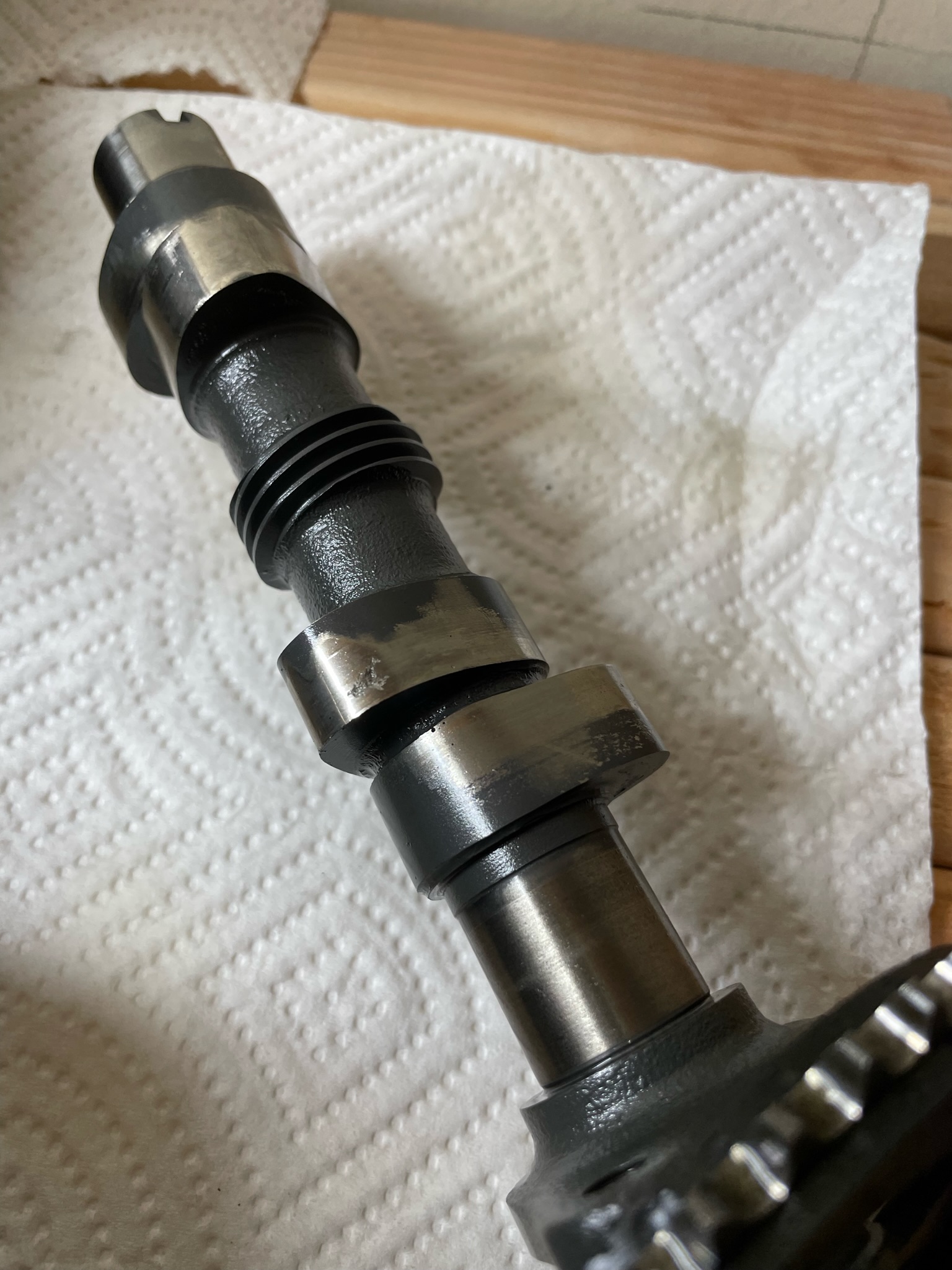

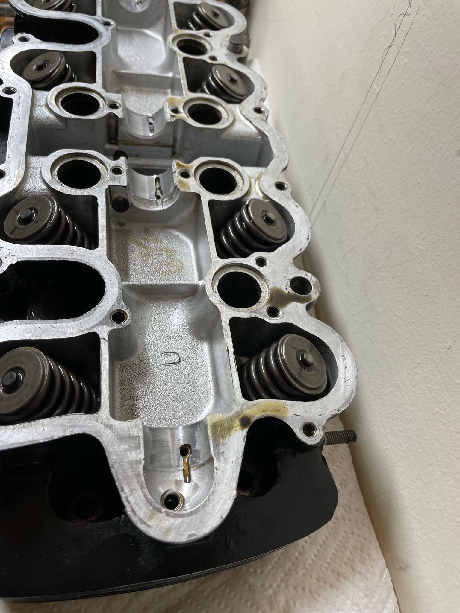

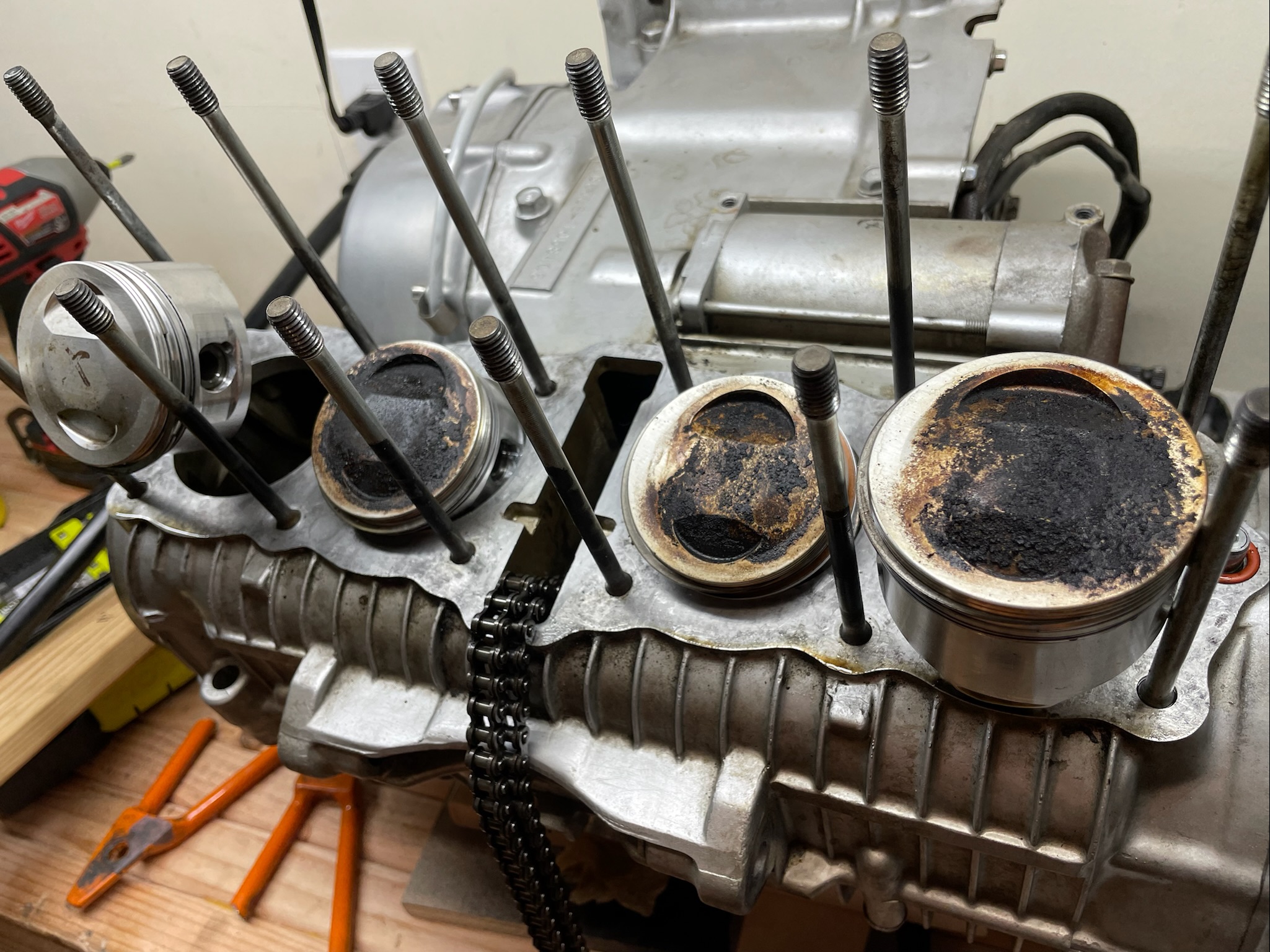

So, shortly after I received the bike, I bore-scoped the cylinders and found oil in all cylinders. After I took it down to the frame and removed the engine, I pulled the head and jugs…and had to walk away from this project for about a month because it just became much more expensive.
When we overhauled this engine a decade ago, we didn’t replace the rockers, as they looked almost mint. Well, it seems they weren’t, and they’ve ruined our nice hot Webcam. Two of the cam journals in the head are scored as well. There also appears to be rust pitting in one cylinder wall. F*ck. They’re already bored to the max.
As for the oil in the cylinders that I was originally worried about, I assume it’s coming from leaky valve guides/seals. Least of my worries now!
I’m a little demoralized by all this. There’s probably less than 1000 miles on this engine rebuild. But ultimately I guess that’s why I bought this bike back-to fix all the corners I cut when I was young and dumb. (I’m still dumb, just less young)

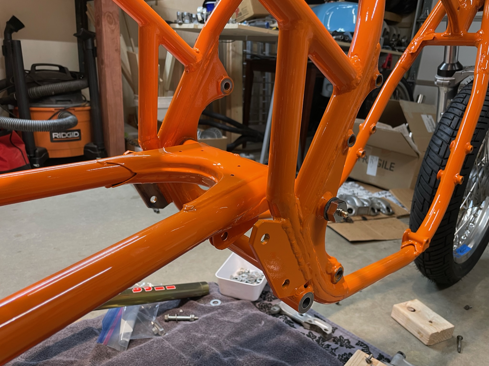

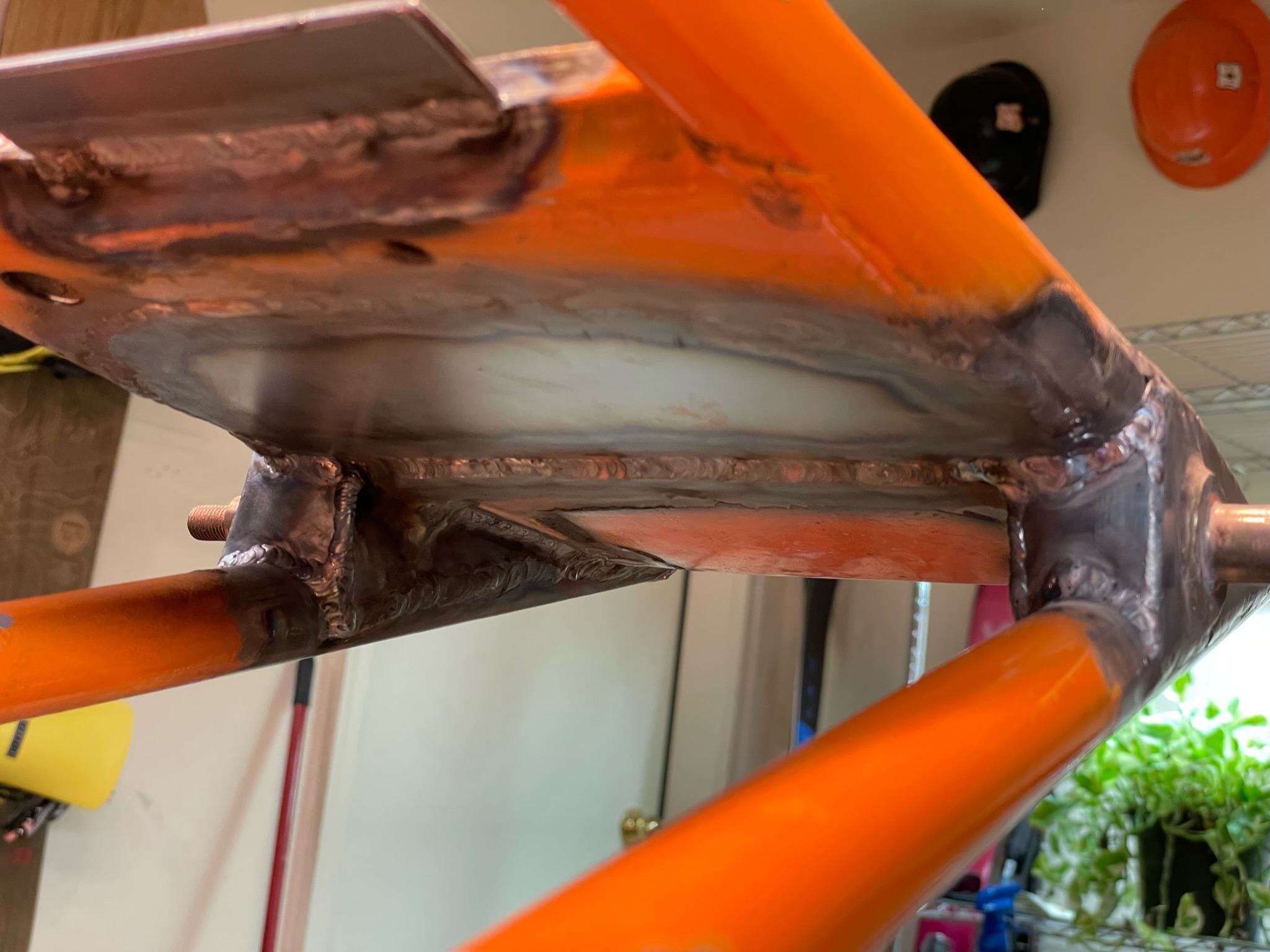

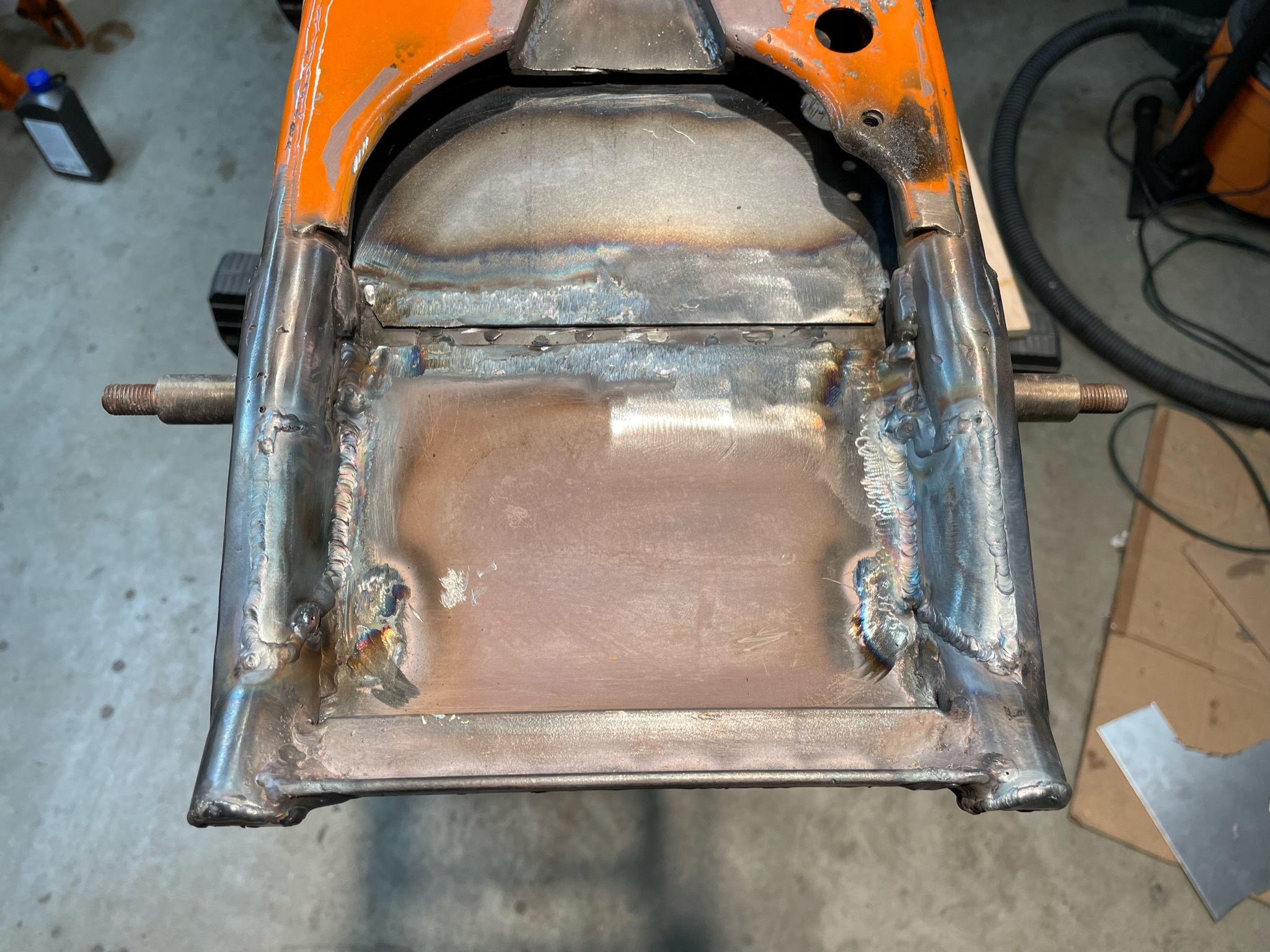

In other news, I’m almost done redoing the all the shitty frame welds I did originally. It’s slow going since TIG is the only welding process I’m set up for now, and arguably the wrong process for welding dirty metal that can’t be properly cleaned. Nevertheless, I’m ok with the results I’m getting.

Pistons are bore look fine from here. The crowns will clean up ok and that minor rust pit in the liners is low enough to make very little difference - unless you are thinking of going larger bore anyway. If you go much larger on the bore you may have to consider a 650 top end to get enough air in.
But unless that's where you want to go, try to use what you have. Shops like my guy in Australia 2 decades ago or Pete Fischer at Powroll ( I think that he may have crossed the rainbow bridge too) those guys used to be set up to line bore the head and cover to take split bronze bushes. See if there's anyone that can do that.
The cam and bearings don't look too bad depending on your planned next steps. They show wear and rust pitting and so on but are probably usable without losing much power or longevity. Of course it would be better with all new parts, but you might be surprised how worn parts can be before they absolutely have to be replaced. That's why I tell people not to pull a crank out if the bike is running just fine. Once you see wear and pitting, you cannot unsee it. If you want to replace/repair parts and have the budget or a good source of cheap replacements, don't be too much of a perfectionist.
If parts are way out of round or lost oil pressure or compression is low, that's different. Oil seals on the guides? Go for it. Wear in the guides? measure it and see if it's still in spec. I like everything in a race motor or a bike I am selling to be first class, but there are limits for a reason....
Irk knows what bits go together on those motors and might have some ideas.

Hey teazer! Thanks for talking a little sense into me. No plans to increase the bore, I think I’m pretty much at the limit already and I’d hate to turn those nice pistons into paperweights. Would you do anything on those pitted lobes to prevent trashing the new rockers? Carefully taking some rough edges down maybe? I know this isn’t the right answer, but what do you think about TIG welding the pits with some hard facing filler, A73 rod maybe?
I have limited time to devote to this thing, this winter, so I snagged a nice head, cam, cover w/rockers and spare set of NOS rockers. I think I’ll install the stock cam and the better of the two heads this winter, and set aside the NOS rockers, webcam, and other head for a full rebuild + light porting…maybe.
Those split bronze bushes you’re talking about, I like the sound of that! Probably going to be a next year thing with the rebuilt head. But those would be slick…hah.

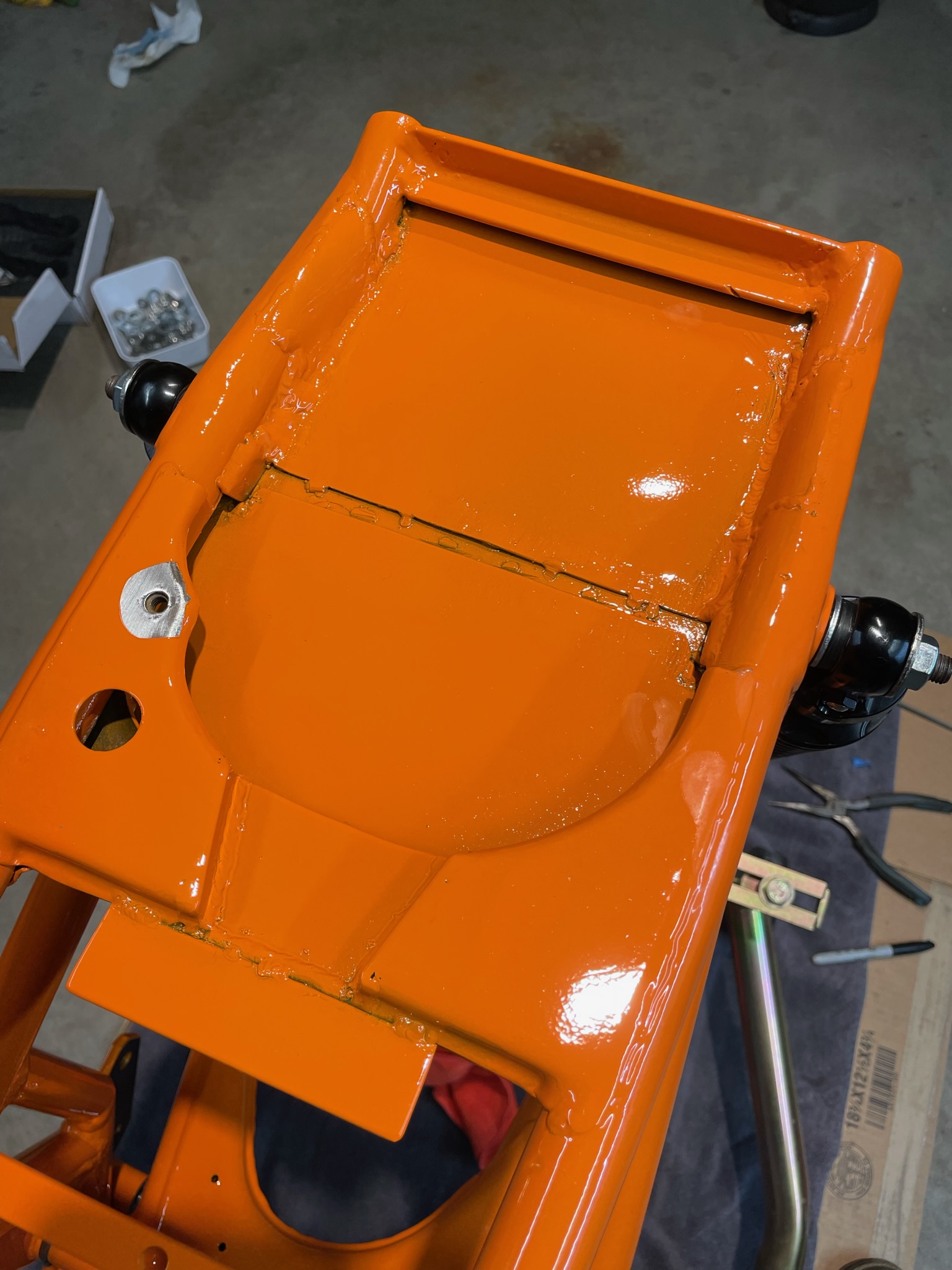

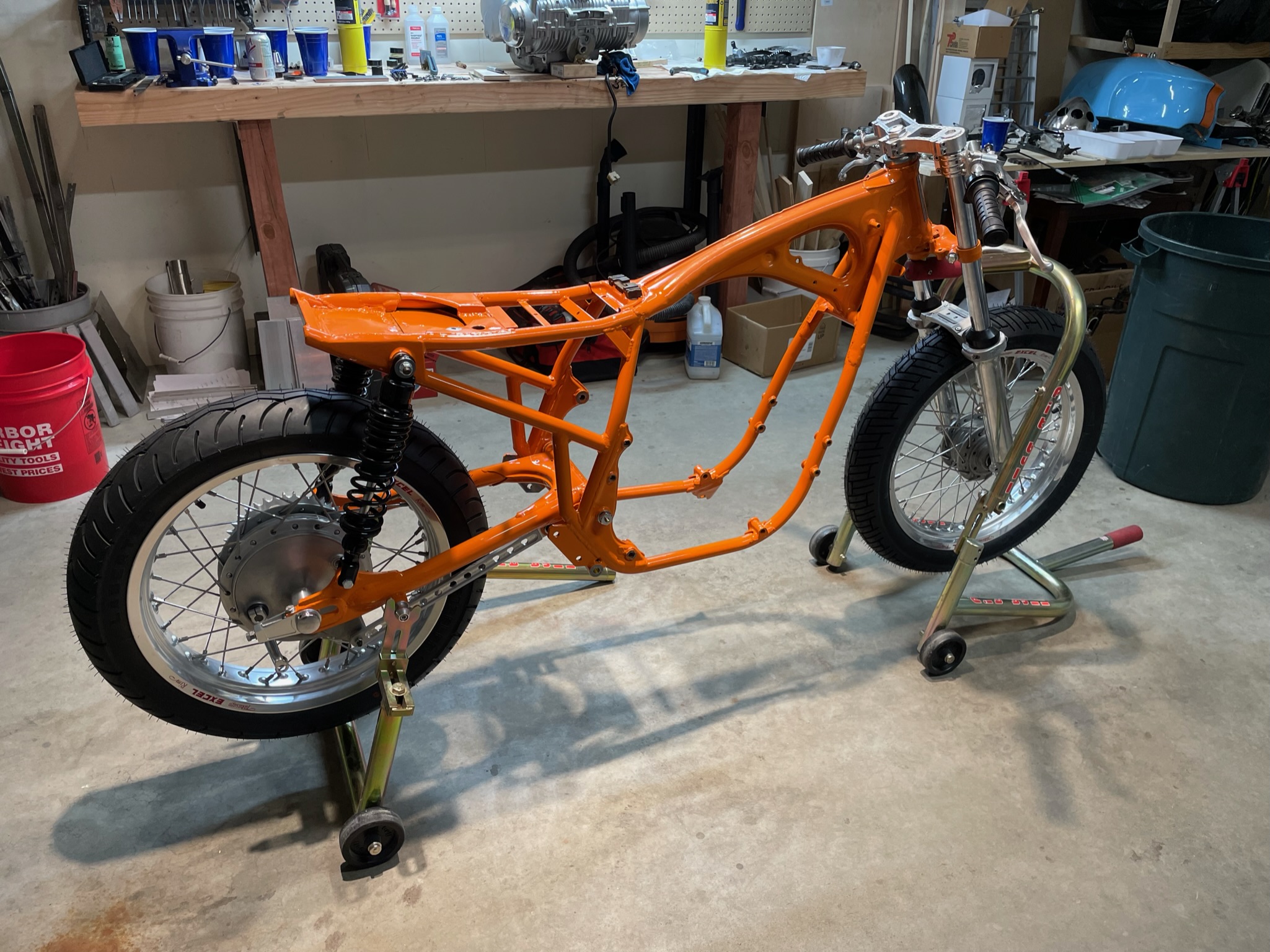

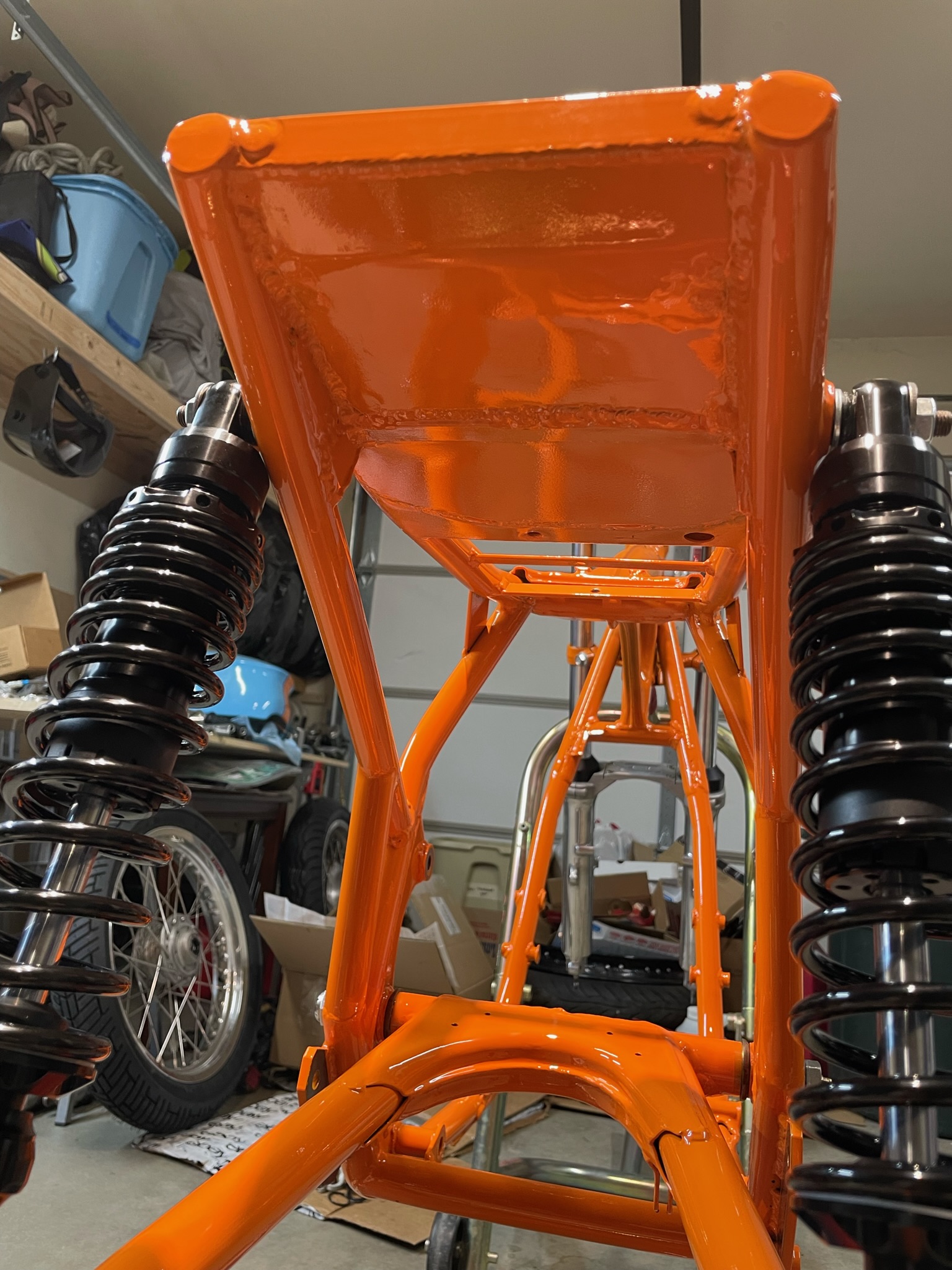

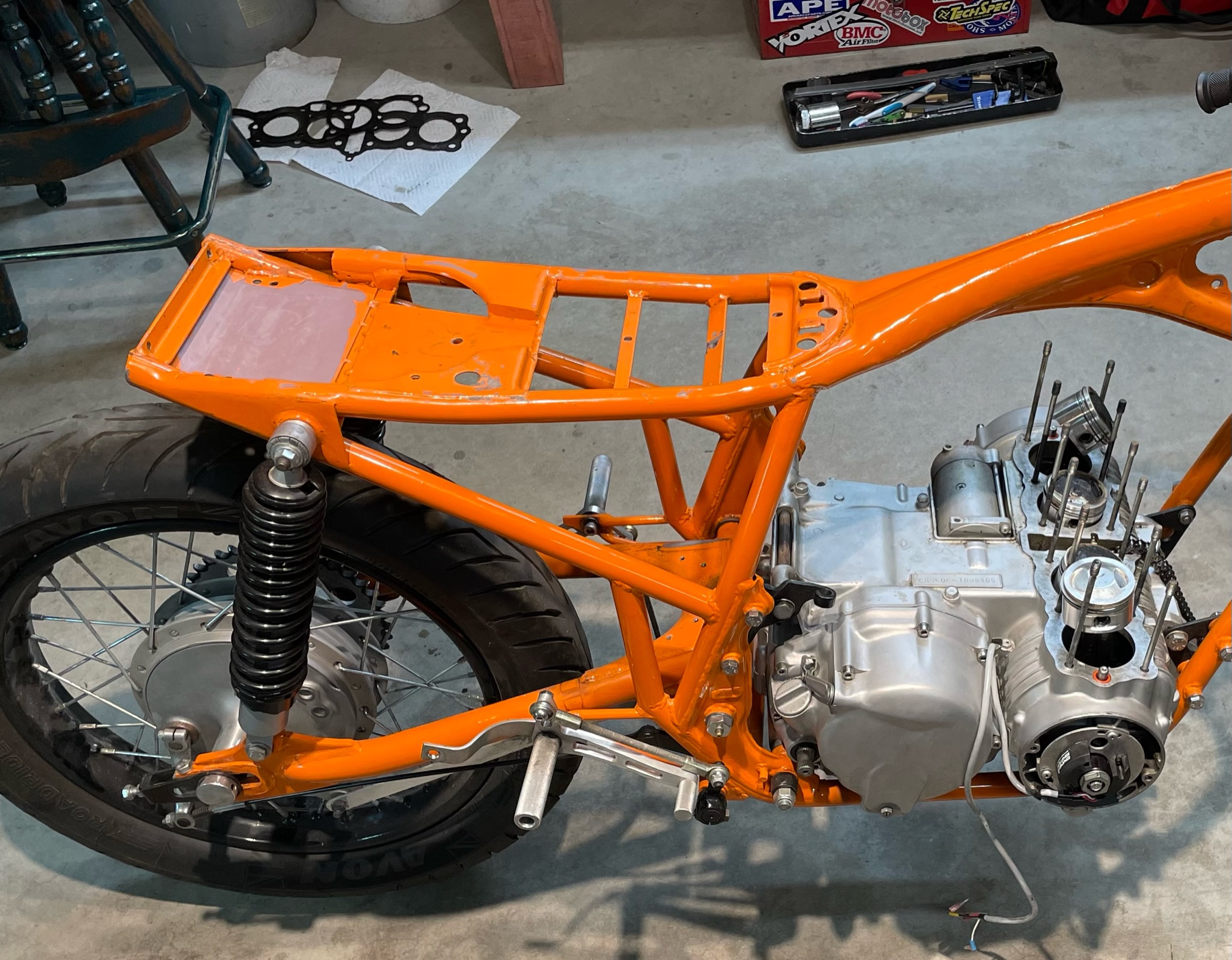

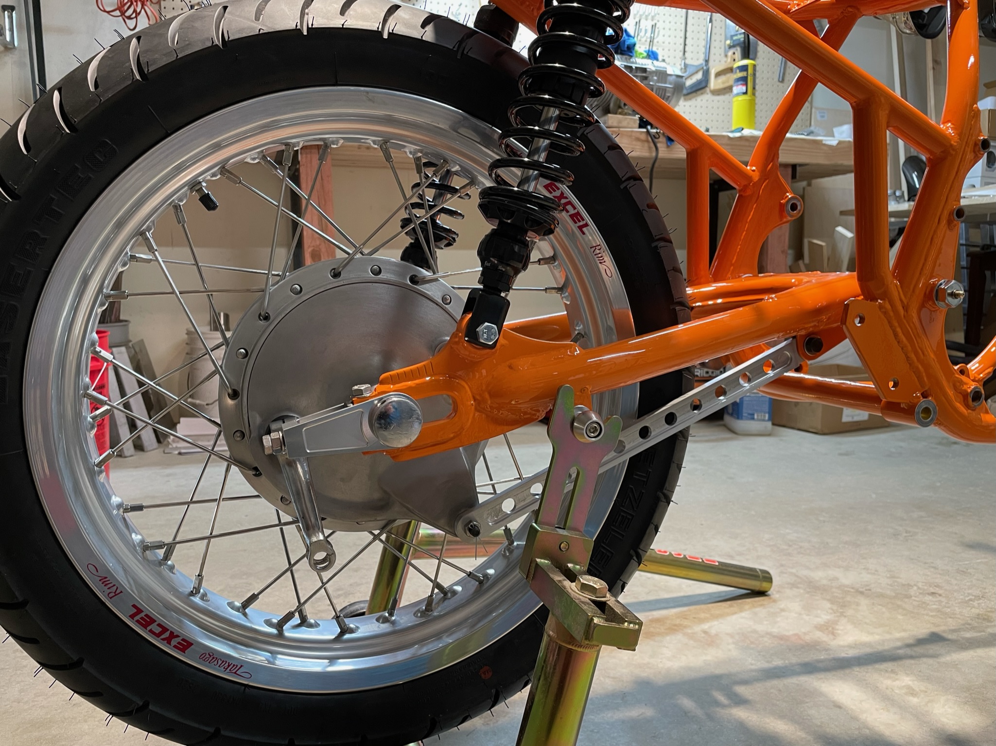

Some progress lately. All of the frame welding is finished. On the first go around, I left everything very unfinished in places that were covered by the seat. This time, I completed the job by boxing in everything that was open, reinforcing (or redoing) welds and adding the top gussets, footpeg bracket mounts, and swingarm spool mounts.
The engine is coming along. The old head and cam are packed away until I decide what to do with them. The new ones cleaned up nicely; I stripped the head, blasted it, lapped the valves and fitted new guide seals. The new cam was stored with the old; I found a cb650 cam in great condition, so at least I don’t have to go back to a stock 550.

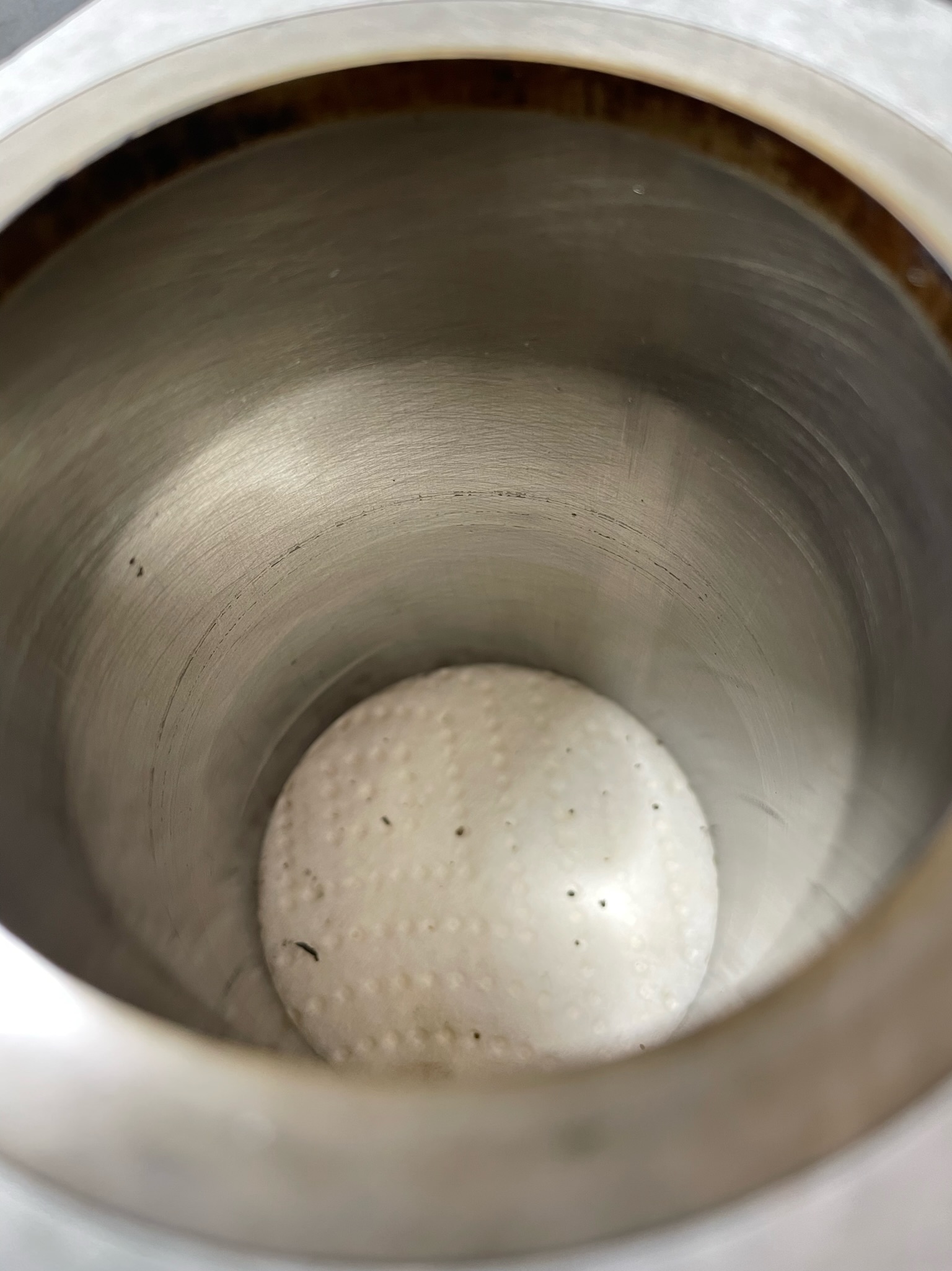

So part of my larger plan to chase oil leaks includes HD cylinder studs, and of course I sheared off the very first stud I tried removing. Heat, penetrant, double nuts, vice grips…nothing. Locally I cant find a stud extractor for studs under 1/4” so I’ll have to find something online. Any recommendations??

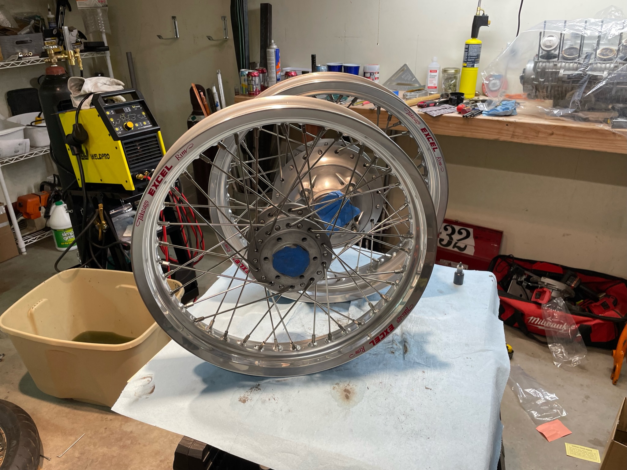

For rims, I went with 2.5” and 3.5” both 18” dia. Metzeler Lazertecs we’re absolute bears to spoon on.

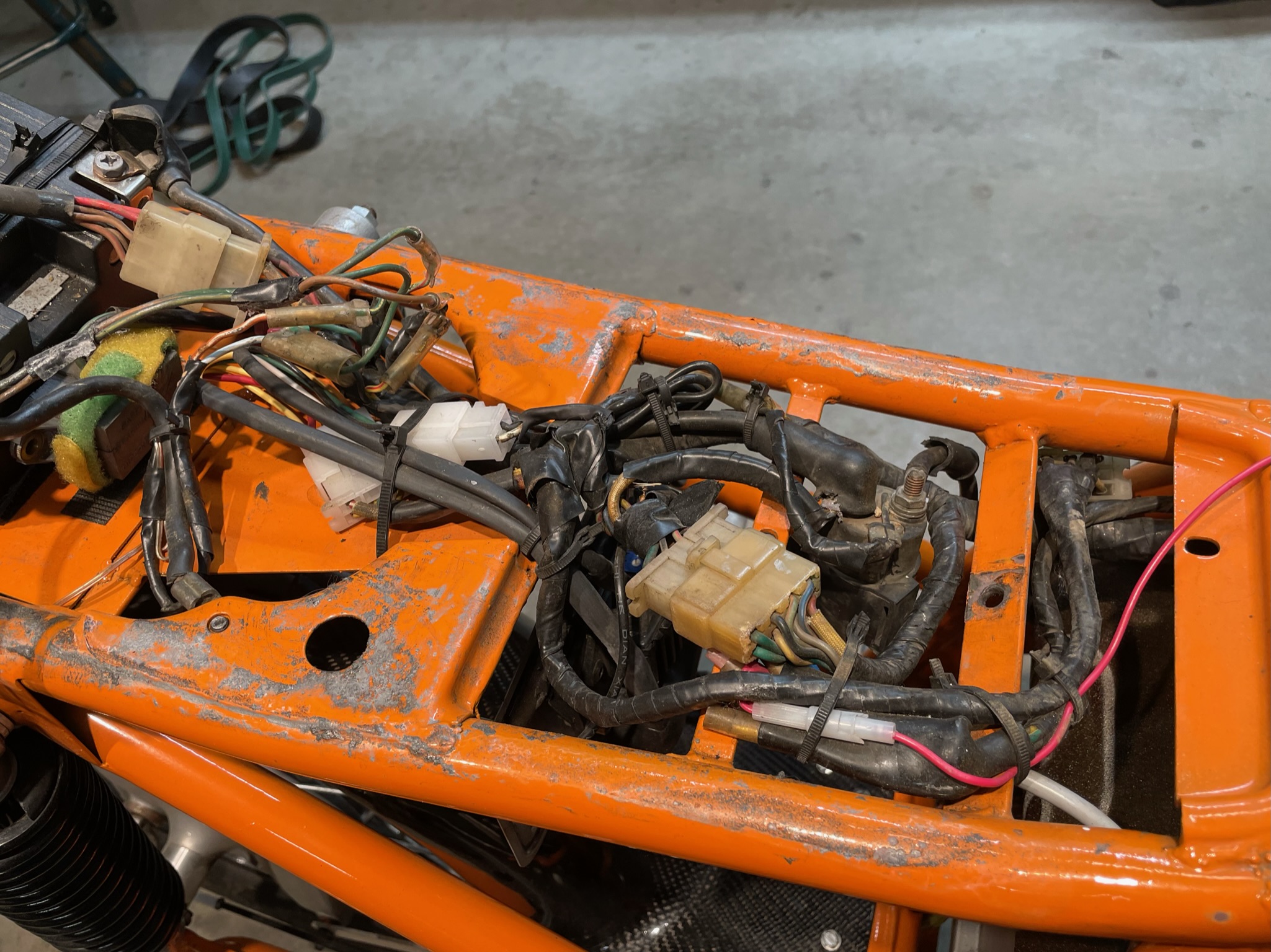

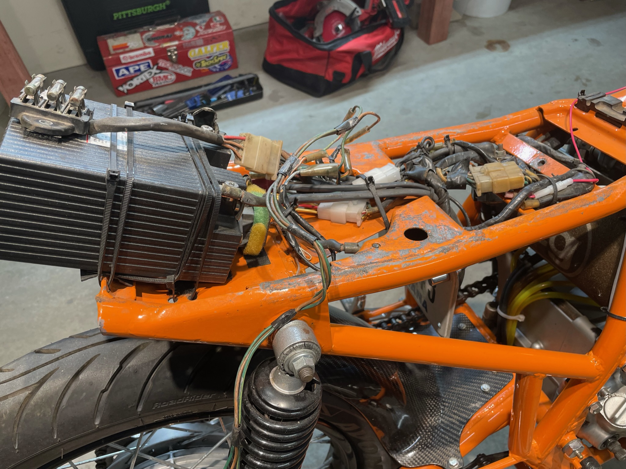

Couple more pics. And some of the original rats nest that prompted all this welding…
