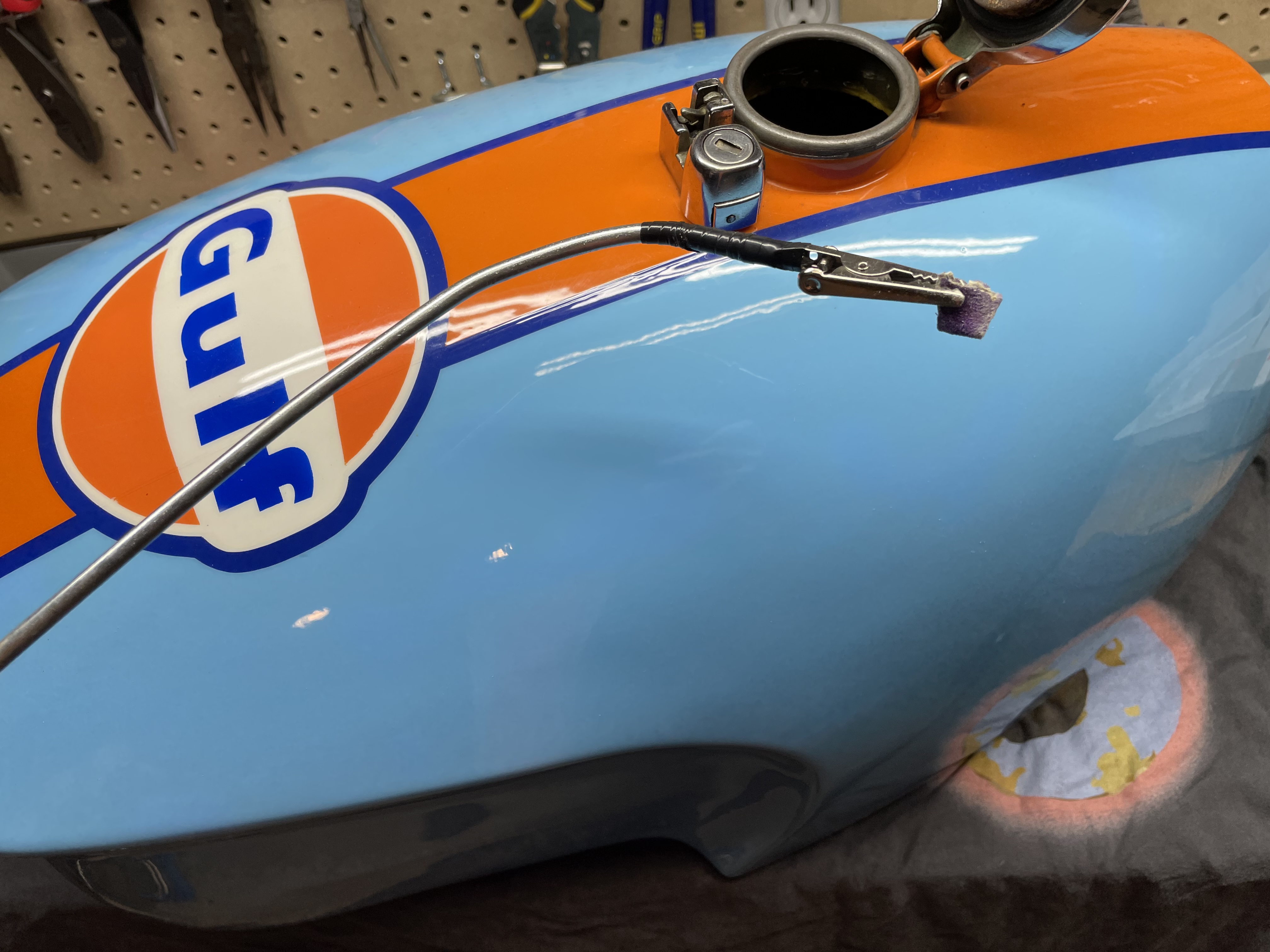

When I got the bike back there was some discoloration/yellowing in places in the clear coat, but one area was different. It’s darker, deeper looking, and has a bumpy texture. Since it’s at a joint on the tank, my first thought was a pinhole leak. I stuck a camera in there and of course couldn’t see anything, but it does look like there was some weirdness going on there when I joined the tank halves originally. I had to get creative sanding the area inside the tank around the leak because I didn’t want to do a full tank coat since I cheaped out and bought the smallest amount Caswell sells. But it worked.
About the rest of the yellowing. It was tough to tell what it was at first, but I’m pretty sure it’s just yellowing in the clear coat. I’d post a photo, but have you noticed it in the blue paint in the rest of the pics? It just doesn’t show on camera. I’m not sure what even caused it, as it has a ”splotchy” appearance. I was told the bike was garage kept and the base and clear coat are urethane anyway, so I don’t know. Maybe it’ll come out with a polish.

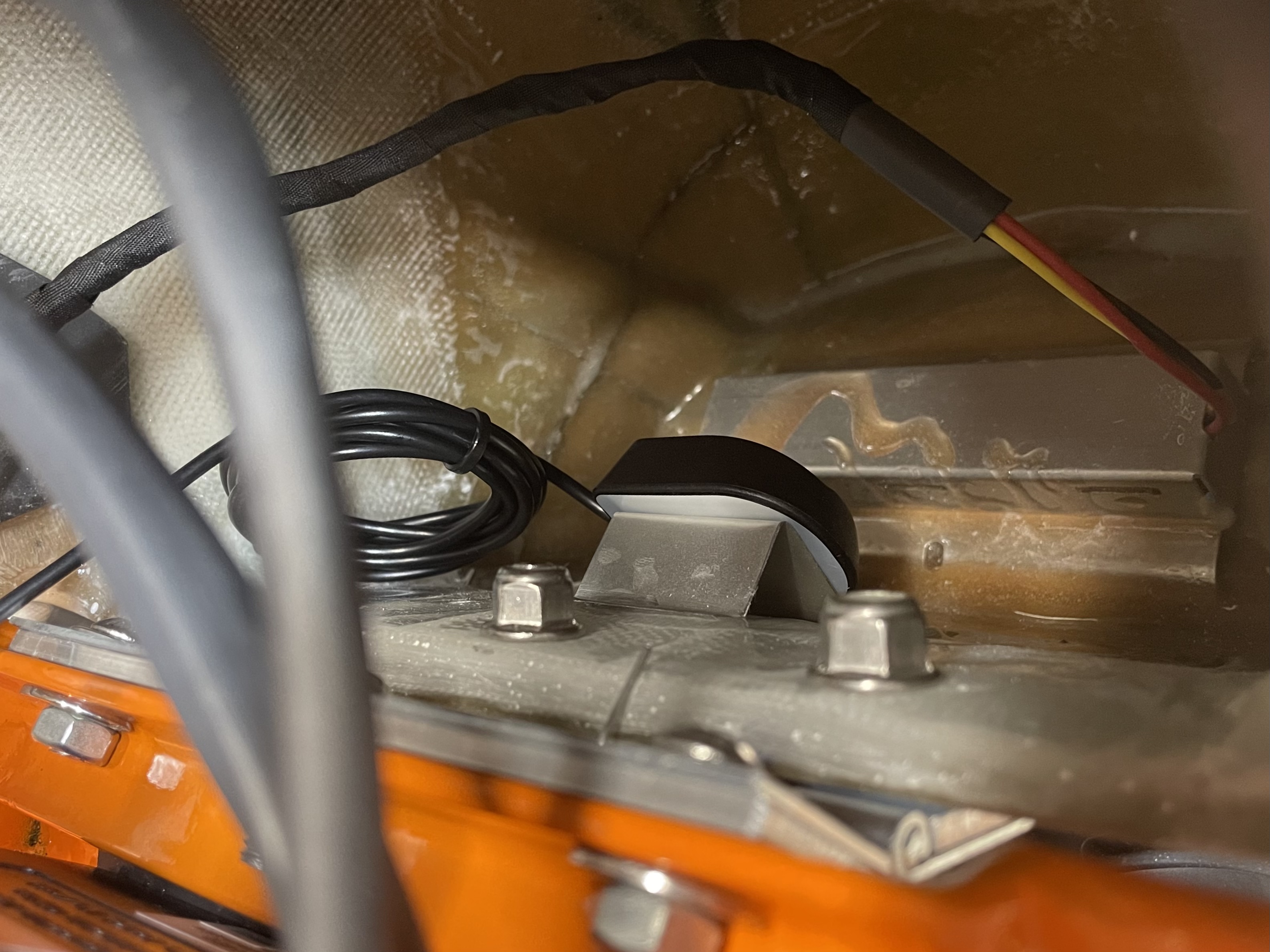

Next I needed a place with a clear view of the sky for the speedometer’s gps receiver. It’s magnetically mounted so I epoxied a thin steel sheet in place in the tail for it to sit on. It came with some adhesive pads so I could have just stuck it to the bottom in front of the tail light, but historically, permanent mounting solutions have been some of my worst ideas. See the tail light there, epoxied in place? Really excited for the day that thing fails. So, magnets.

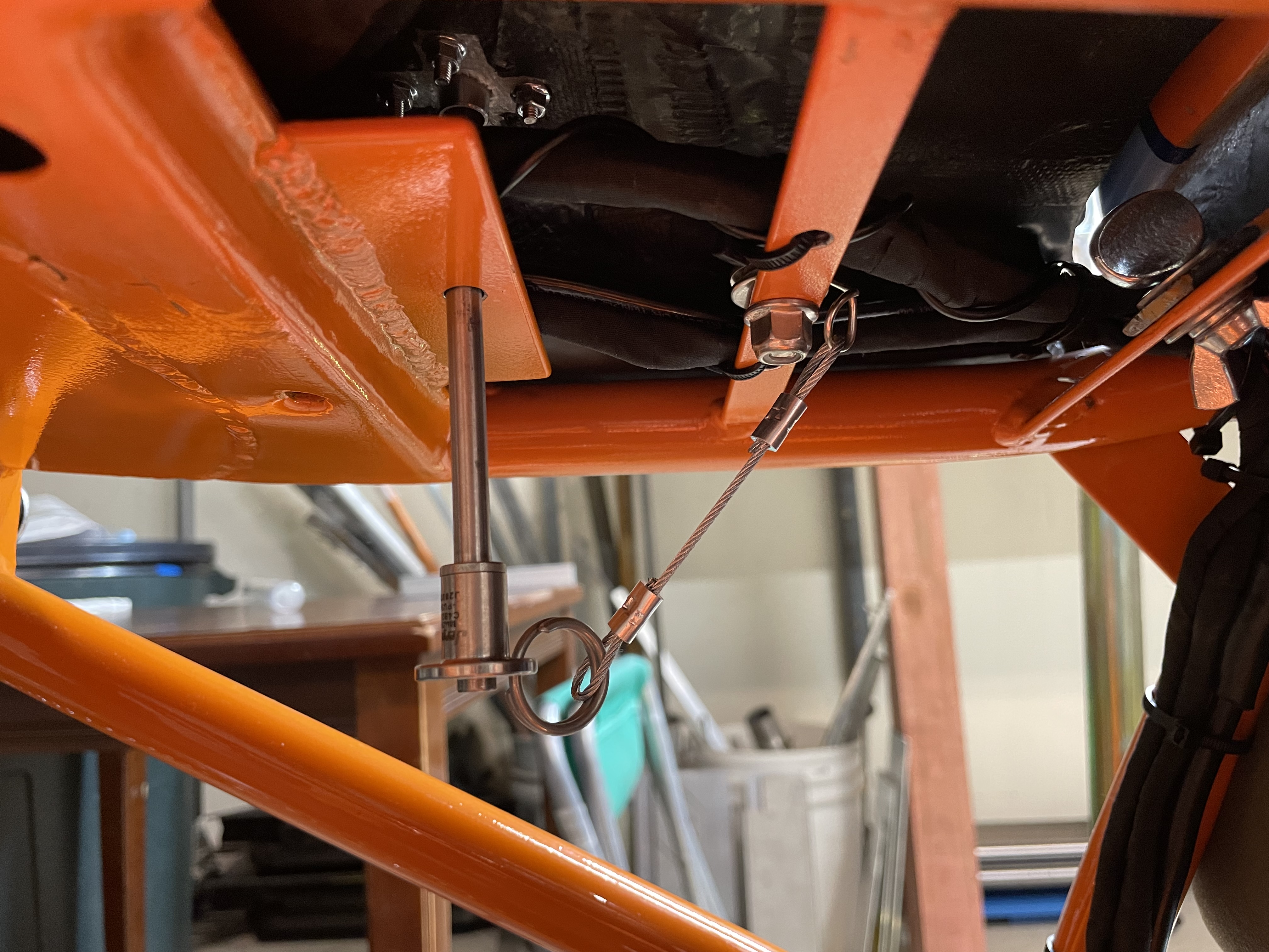

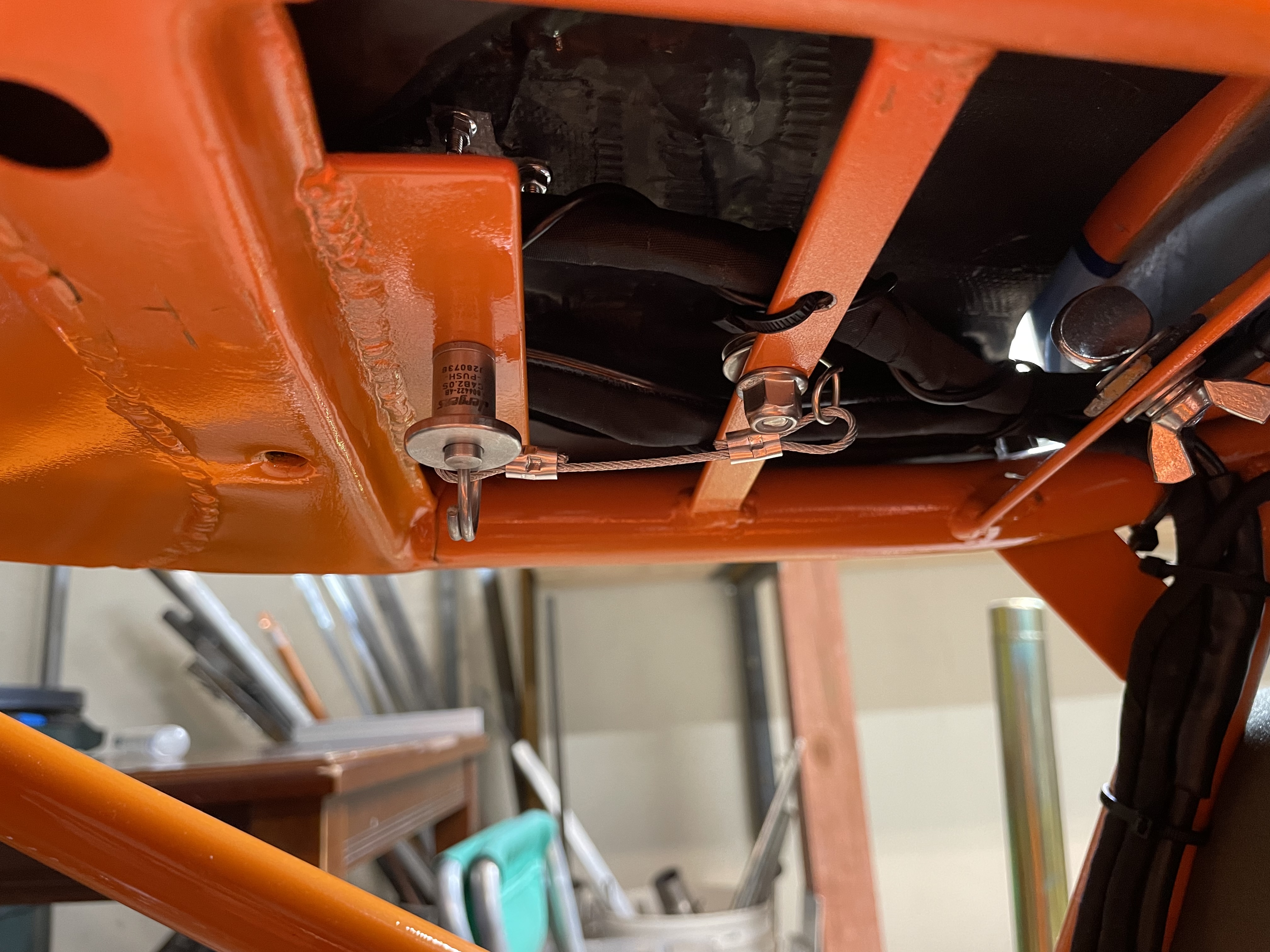

Other than that I made a cable to keep from losing the seat pin. It doesn’t fall through the lower hole unless the button remains pressed, but other people do ride this bike pretty regularly and don’t know all the quirks.

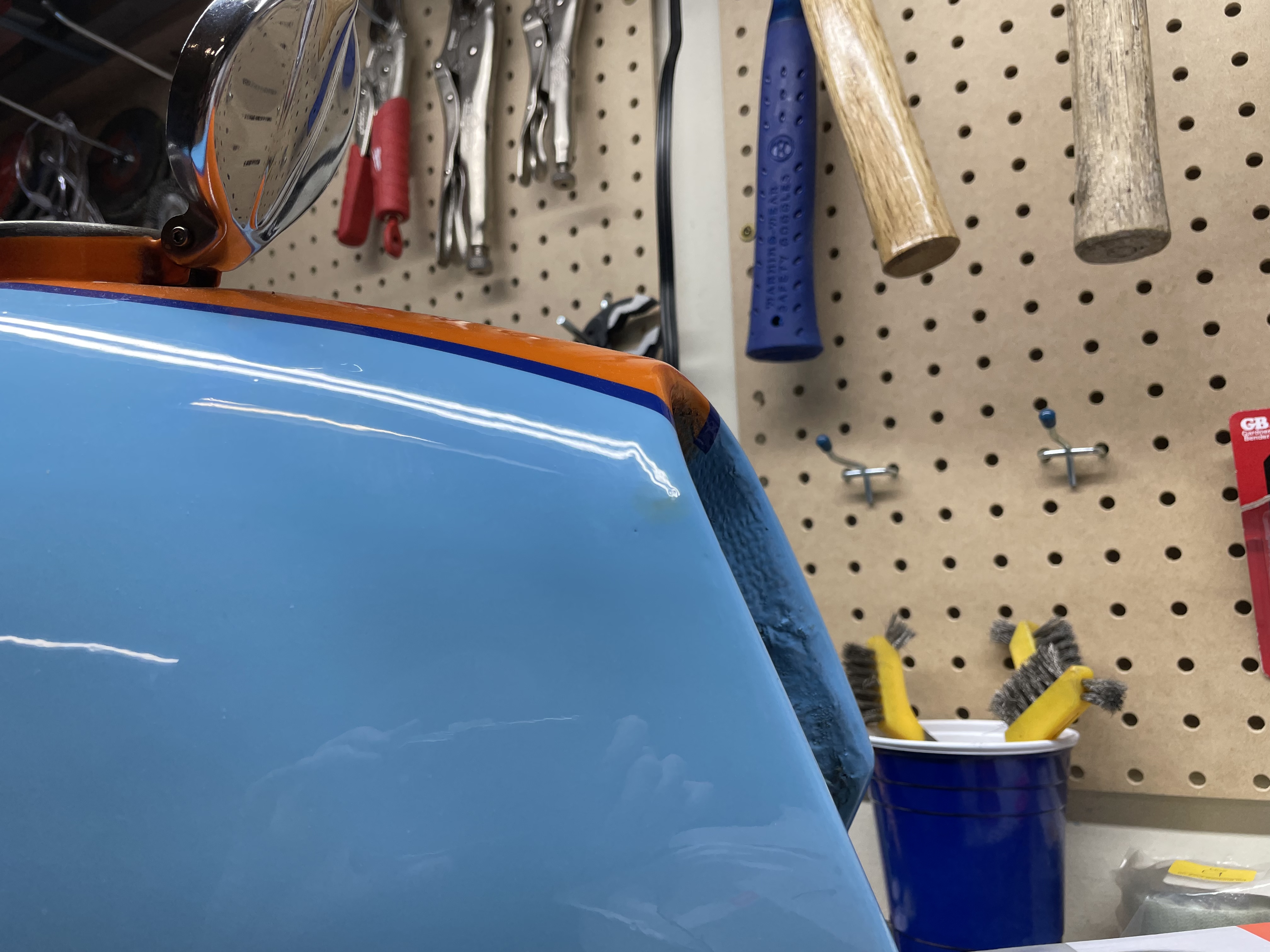

I also got a good pic of the paint discoloration, after a 2000grit wet sand. Still very much there, so I’ll likely just ignore it for the time being as it’s just cosmetic. I’d still like to know the “why” though. Where’s t71ford when you need him??

in regards to the paint - are you sure the clear isnt yellowing and what you are seeing is a thicker layer of the clear? it looks yellow over the whole tank where you sanded it. did you use a gel coat on the composite?

As for the paint, yes the clear is all yellowed. The discoloration that caught my eye is actually small blob-like shapes that are not yellowed at all! The clear is uniform, no gel coat, but I used marine-grade epoxy resin.
It looks like it sat out in the sun for a decade- the clear coat is uniformly yellow, with the exception of the spots, and where the tank badges were (both areas look the same). It may just be a mystery.

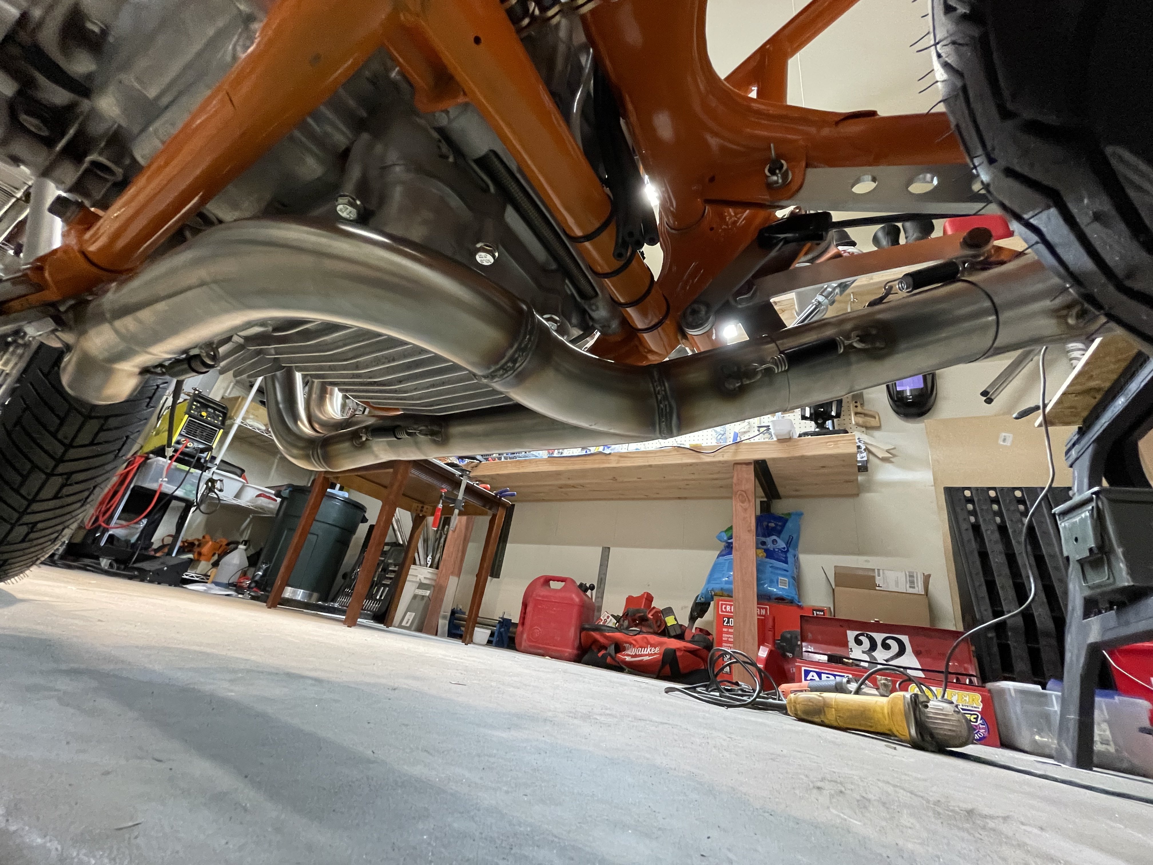

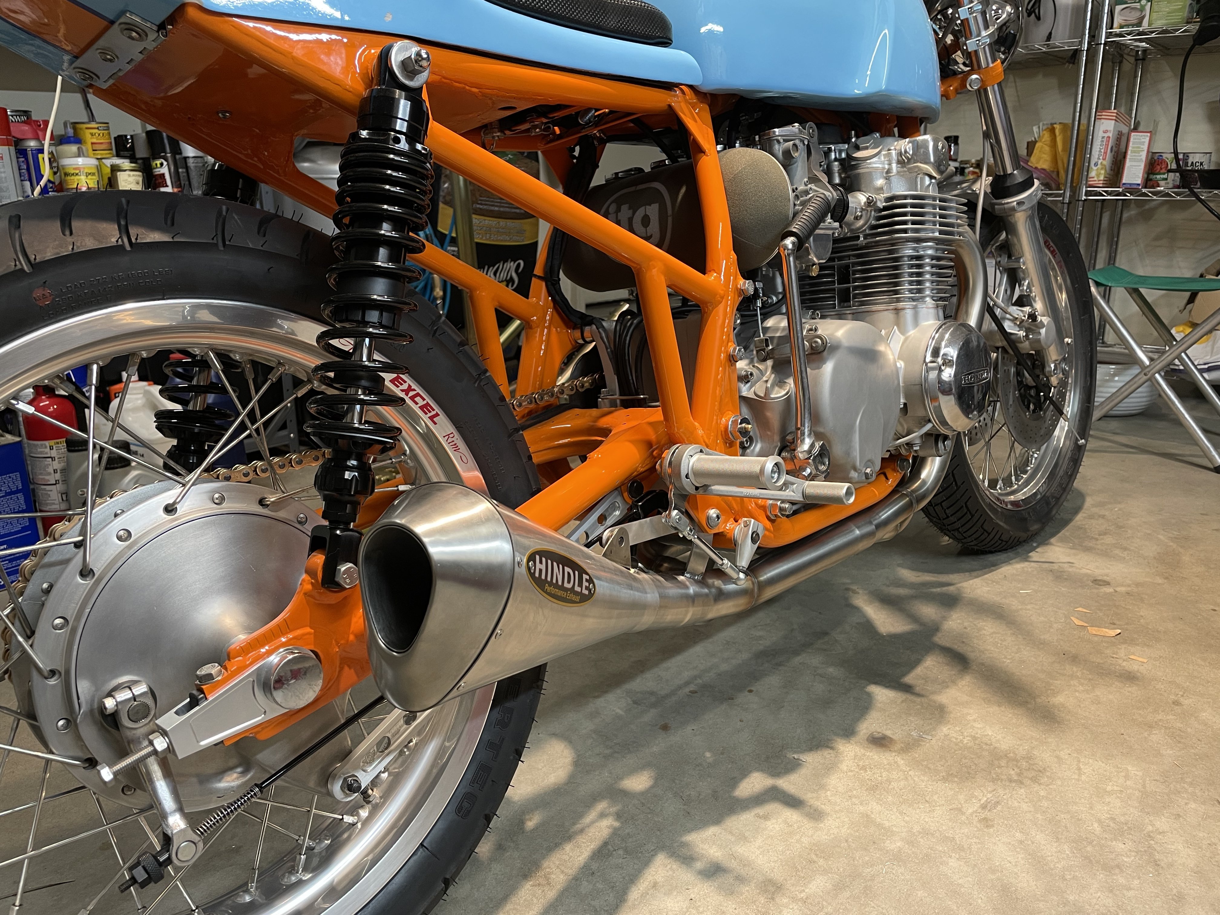

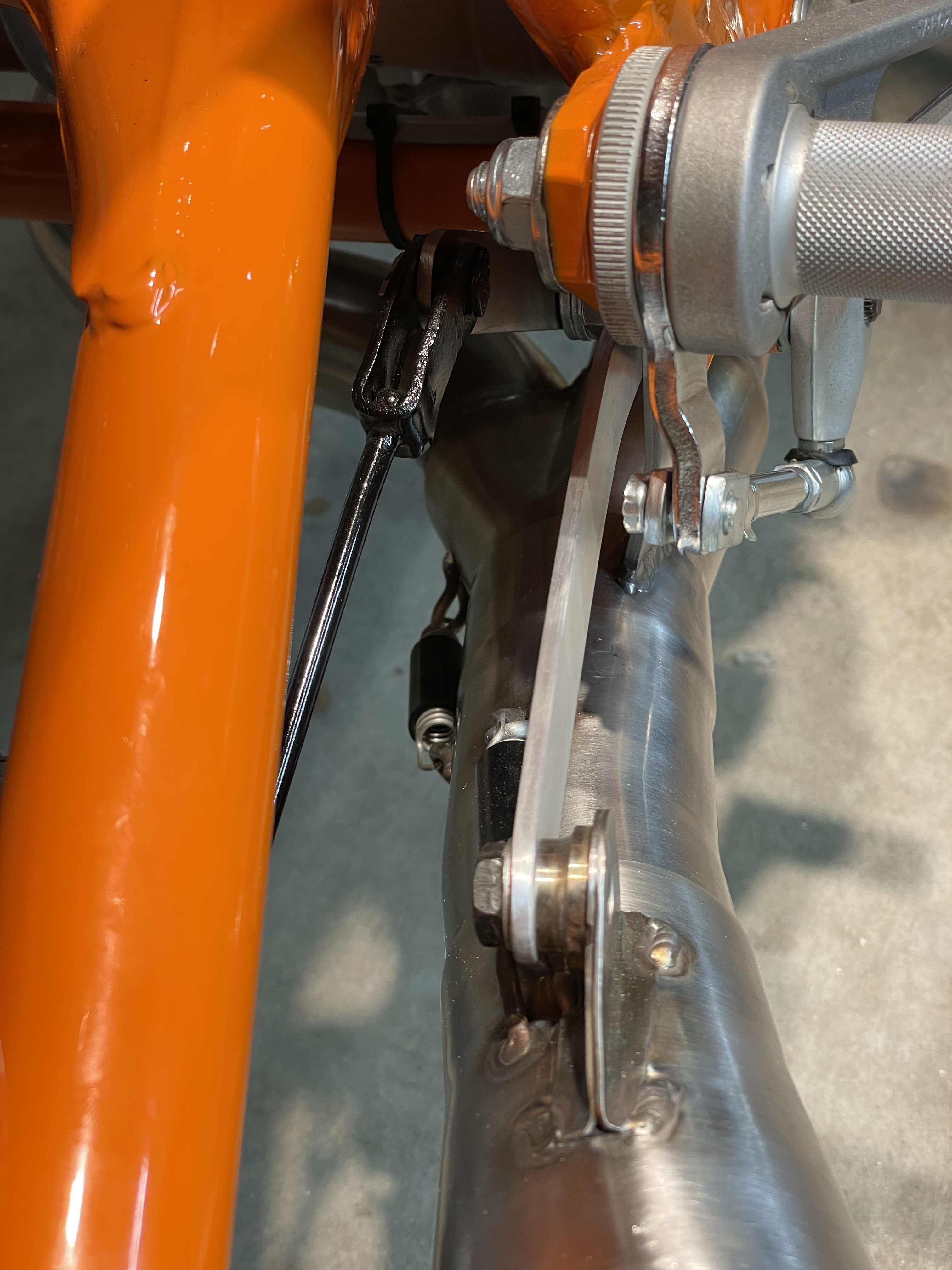

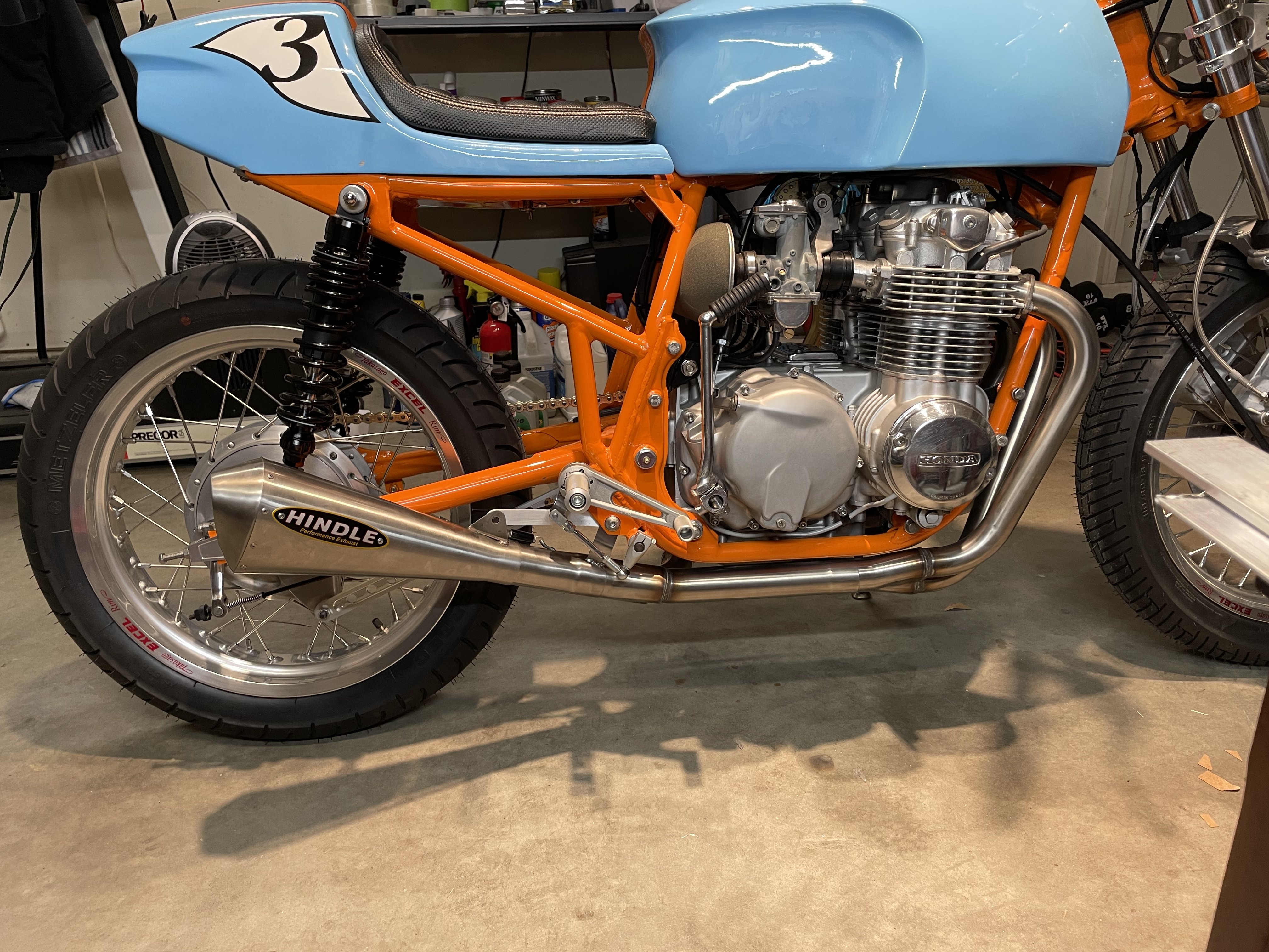

I did get the exhaust done. The Hindle system needed some modification. I moved most of the spring hangers, and adapted a portion from I believe a ninja 300 to get the final angle right. The muffler now clears the swing arm stand spools, and matches the tail angle. I’m happy with it, and looking forward to hearing the sound with unequal primary AND secondary pipes.
Still working out the gauge cluster. I don’t really like what I’ve come up with. I might just cut some holes for the gauges in the plate to mount them and worry about the mini fairing bit later. Or just shelve everything for next winter.
I also adapted a 530 countershaft sprocket to fit a 520 chain. Don’t ask and I won’t tell. I’ve been trying to get sprocket specialists to make one for two years now and they keep using “supply chain issues” as an excuse, when they bother to respond at all. Pretty well done with that outfit, but nobody else makes one, so, yeah.
Anywho the bike’s oiled up and rideable now, minus the gauges. Oh and license plate mount, no idea what to do there. Probably won’t run a plate this year, but I doubt it’ll get more than a half dozen rides, and I know the local cops so…*shrugs*.

The 520 sprocket from a 79-81 XL500S will work on the CB550. The difference, besides width, is that the outer diameter of the spline on the XL is 22mm and on the CB is 21MM. The XL sprocket will work on the CB but sometimes not the other way around. I have used the XL sprocket on many of my Honda racebikes to convert to 520. The JT Sprockets catalog gives all of their sprocket dimensions.
Much appreciated! The issue I found is in wanting an 18 tooth sprocket. I found many 520 sprockets that will fit, mostly from early 80s 500/600cc dirt bikes, but most top out at 16 teeth; possibly 17 on rare occasions, I can’t recall.
With the 40 tooth rear, 18 teeth in front is the sweet spot for road use, I feel. But my main reason is 18/40 keeps the swingarm safe from chain rub with shocks of this length.
That does sound like a problem in search of a custom solution. Is there an issue with the 530 sprocket thinned to 520 dimensions? 530 sprockets are easy and cheap to find. Fortunately, I have never needed larger than a 16T 520 for any of my race bikes.
I don’t think there will be an issue, but I can’t say for sure. Ideally I’d want to do it on a lathe, but I don’t have one. I used an arbor bit in a drill press and ground it down, cooling it with water occasionally to minimize losing the temper if there was one. If it was case hardened, it lost it on one face.

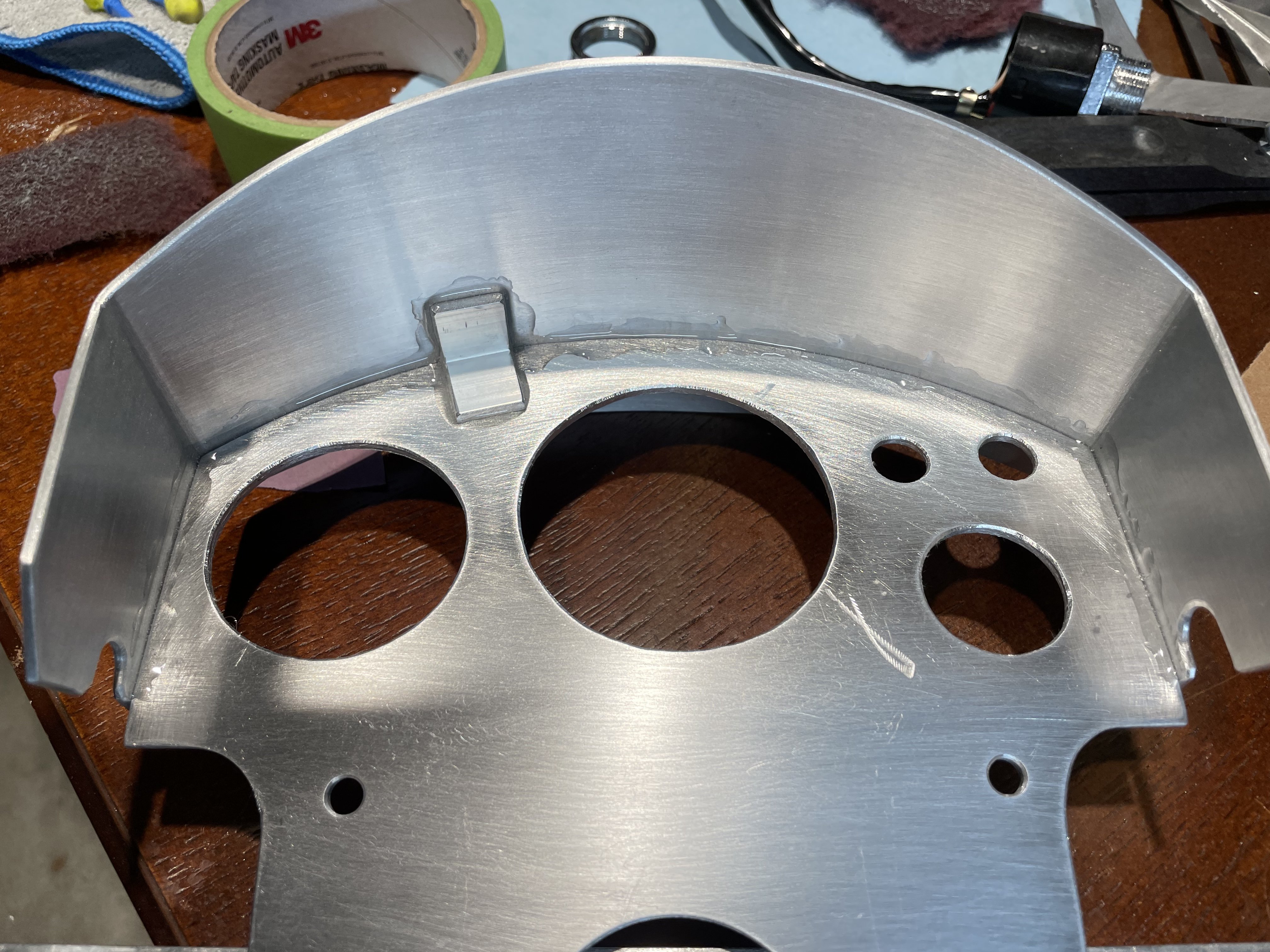

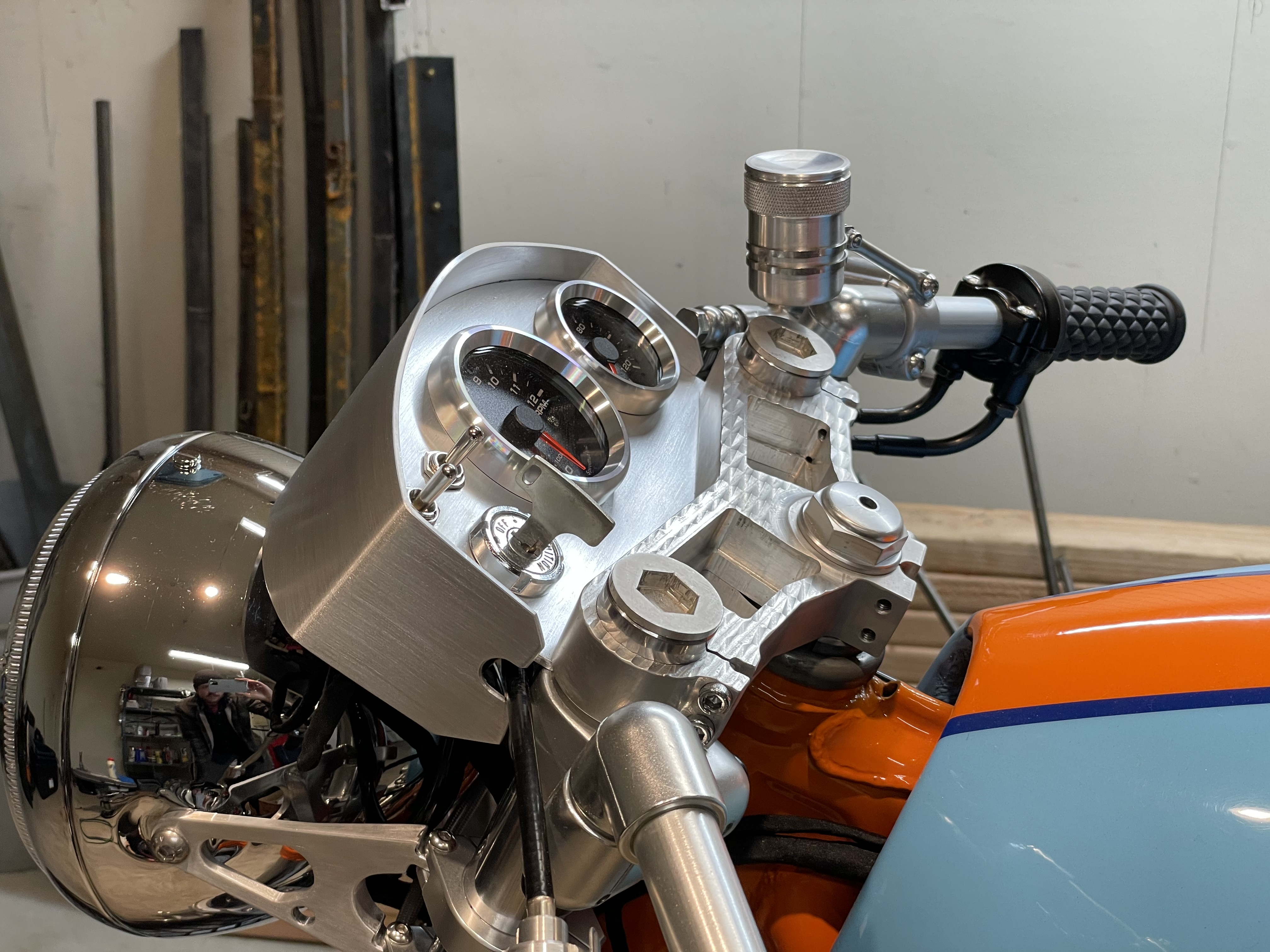

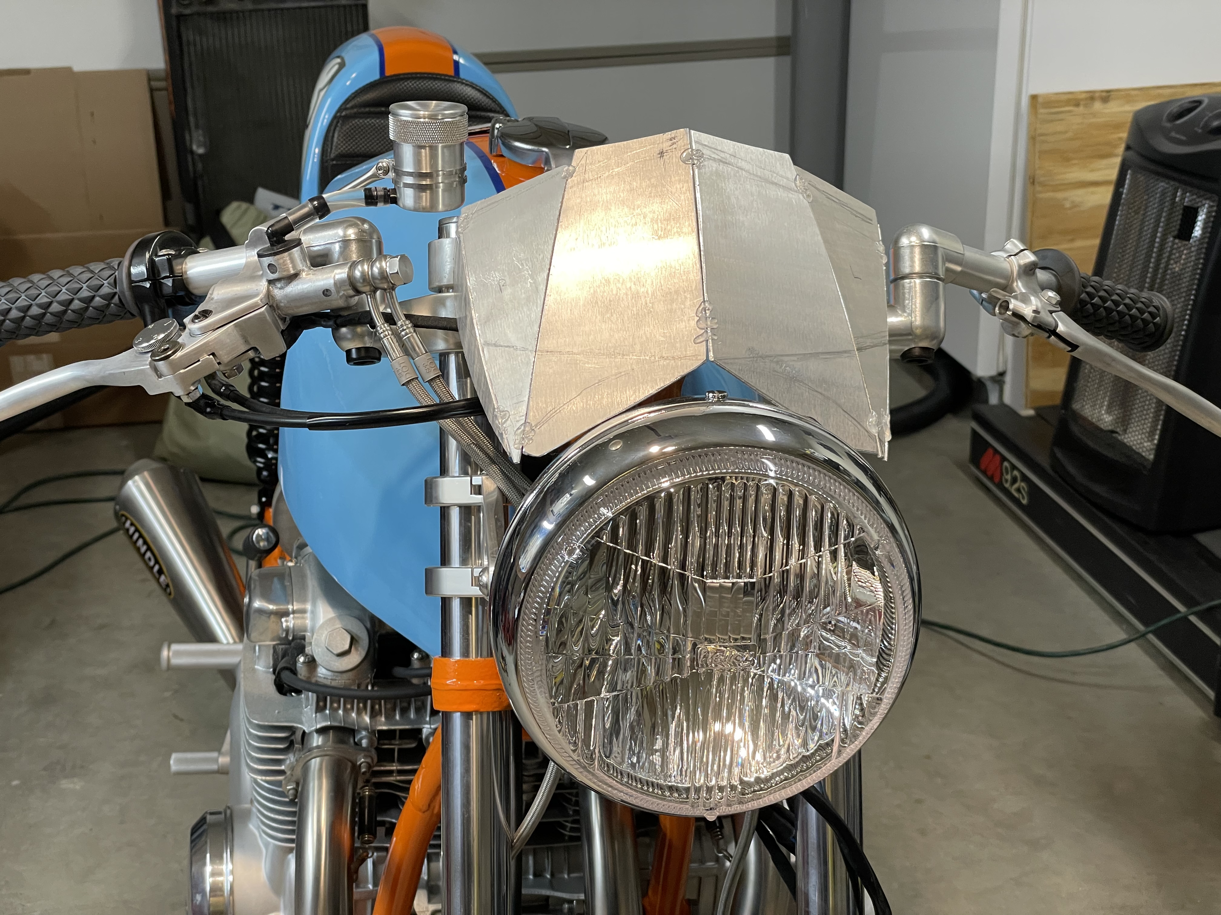

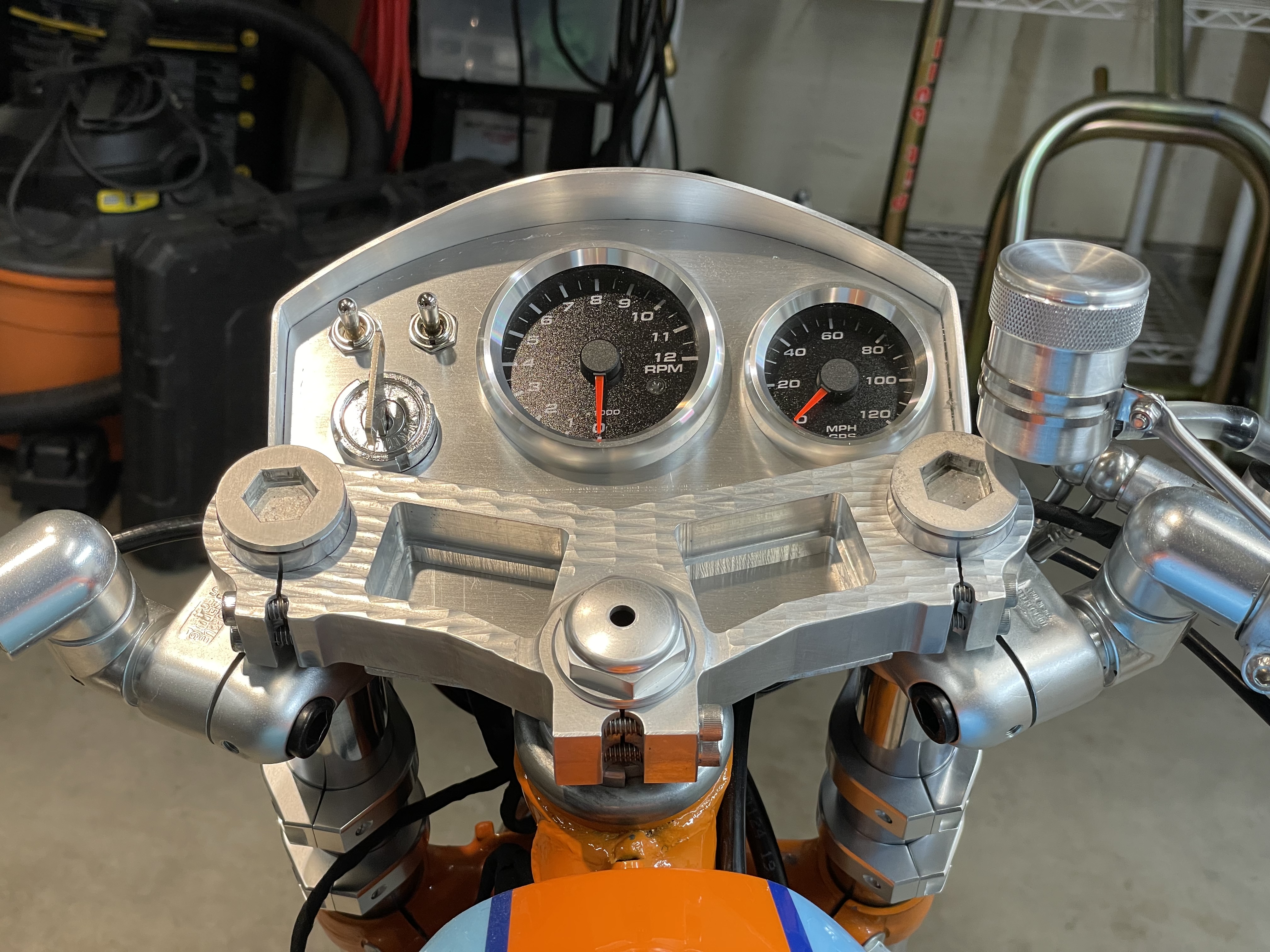

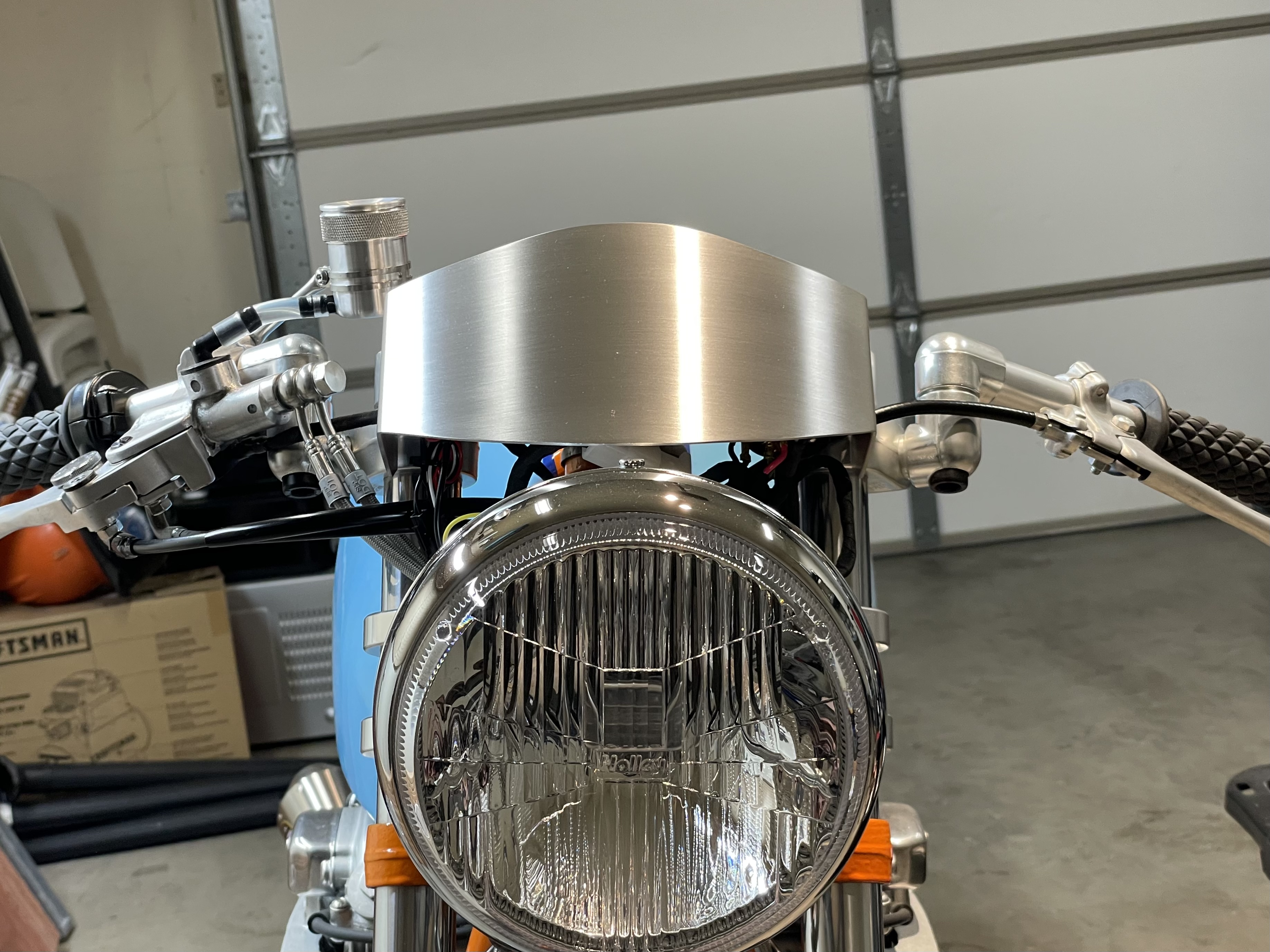

I came up with a dash design I like, for the most part. First photo is the final mock up. Initially I was going to weld both pieces together, but I spent a fair amount of time welding similar pieces in a tee joint to see if I could pull it off, and I couldn’t. The gauge plate is .125”, while the bug/aero cover is .090”. I couldn’t get enough heat into the thicker material without occasionally fully penetrating the thinner material. I never actually broke through, but I got some ugly bulges on the outside, and if you look at the finished pic of the front, that would be a lot of work to blend in and not have it stand out.
So I hung my head and chose epoxy. I used hot glue to temporarily secure it and seal the gaps so the epoxy wouldn’t drip through.

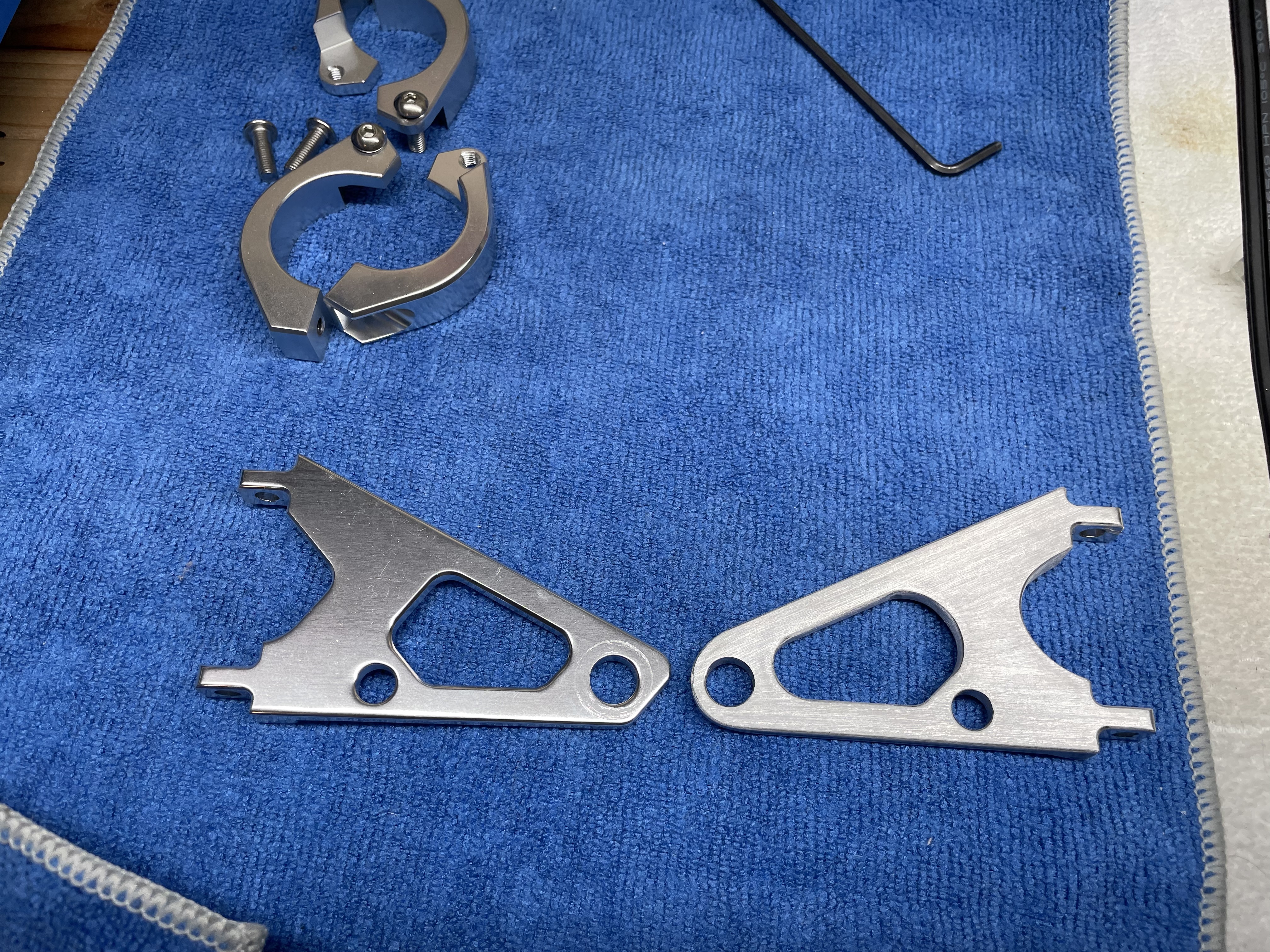

It’s mounted to the bottom of the triple clamp with two screws so far. I’m going to make two small plates that sit in the recesses of the triple against that lower lip, then basically sandwich the triple between those plates and the gauge plate to fully secure it.
I did away with the push button start too. I found a neat three-position switch to incorporate it though; the switch on the right acts as a kill switch and starter switch. Bottom: kill / middle: run / top (momentary): start. The left switch controls the headlight.
Don’t mind the wiring rats nest—I still can’t touch the cluster without leaving permanent fingerprints. It’s not oxidizing nearly as fast as the other aluminum bits that got a brushed finish, so I’m just leaving it be for now. I kind of think I might have to coat it with something, or just polish it.

That’s very clean looking. I like it. I used a very similar toggle set up for a start switch on my 550 bobber.

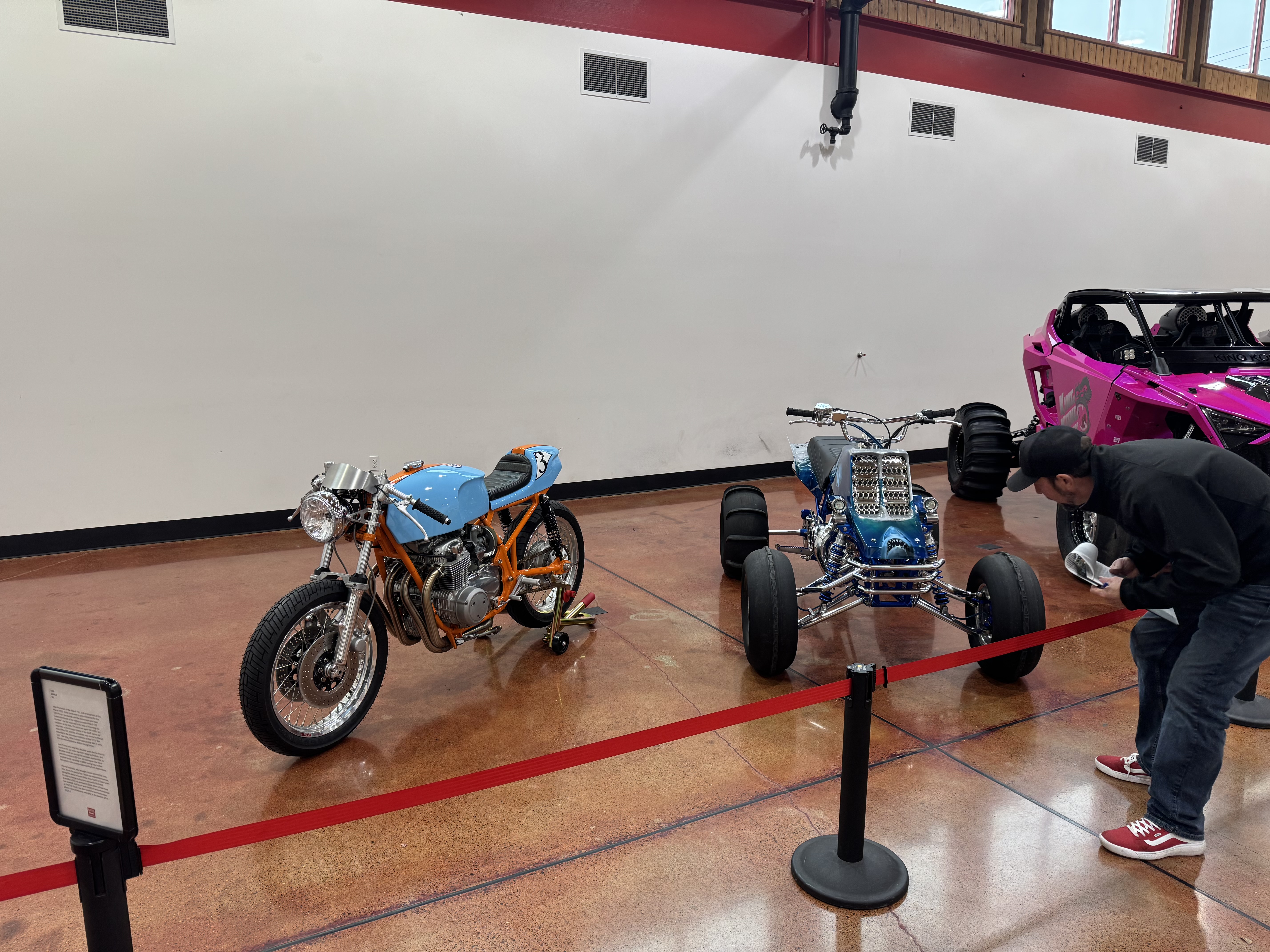

Hey y’all if you’re in the Tacoma area, come check out the bike in person at Griots Garage the month of December. Kicks off this Saturday.
Unfortunately I won’t be there—the bike is on loan to my buddy who lives near Tacoma, this was his idea.
