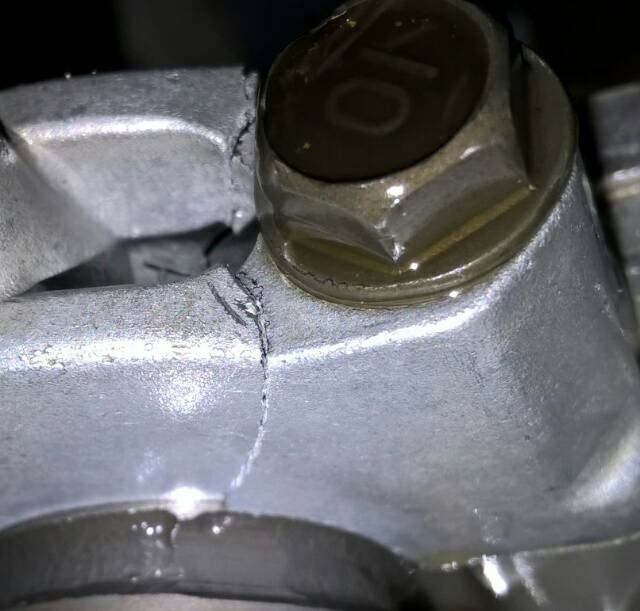

Then, while digging out the RTV from the head I noticed something that I had not seen before. Right end intake cam holder is broken. This thing just keeps getting worse! Anyway, found a full set on eBay for $40 and ordered them.

"L" cam holder is broken pretty badly. Could have been over-torqued, but I really suspect they just rammed in a too-long screw for the valve cover (only had a couple proper valve cover bolts when I bought it). Also, this is not the first holder to need replaced. As I looked at the others to see if they were damaged, I found a J in position for an F (far left end of intake cam). And yes, there is a J in the J position. Guess this one need to be Plastigage checked and also check oil hole alignment, too.

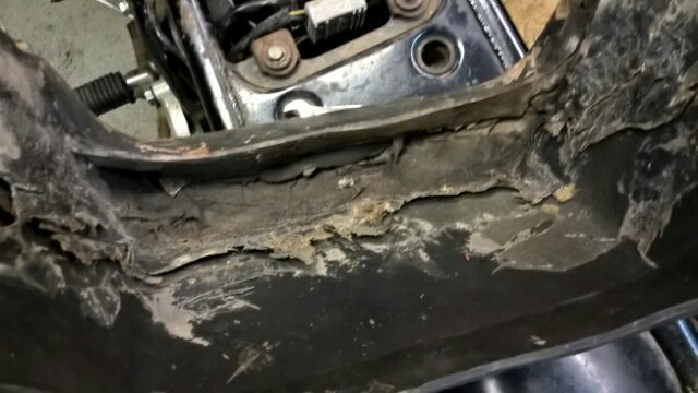

I was going to see what I could do to fix up the tail section on the seat as it seemed to have a lot of repair fiberglass under it. Turns out, almost the entire tail is packed with Bondo and fiberglass, which is all separating from the remaining ABS part which is the top part. Need to figure out what to do with it. I could just glue it back together with ABS cement, but it weights 3.4 pounds with all of this Bondo packed in it! Think I'll check forums and ebay for another. Cracked/broken doesn't matter as I can always glue with ABS cement and reinforce from below with fiberglass cloth, but all of the bottom/back of this one is missing.

Just like that tail...It would have been less work for them to fix it properly, than do all the shit work they did.
Now its up to you to completely un-fuck it.
