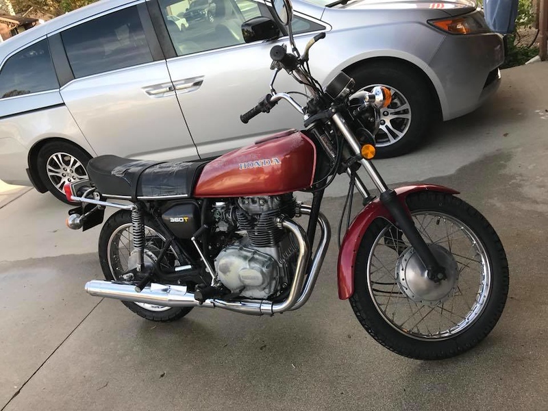

Anyway, here's the bike as it was when I picked it up.
It looked decent, but had been lightly crashed, had a head gasket leak, and frozen carbs from sitting for several years ...the tank was ruined from rust as well.

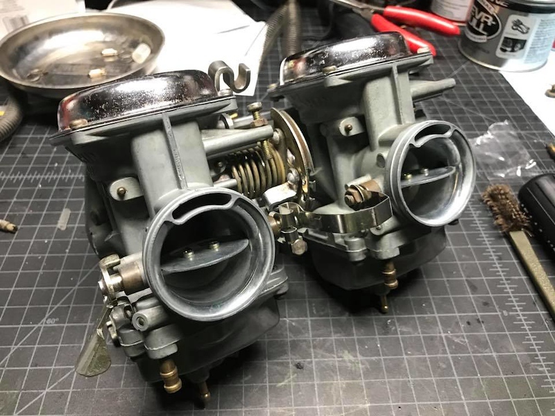

First things first, I bought a rebuild kit for the carbs and tore into them. I was fortunate that the diaphragms were both in excellent shape, so it was just a matter of cleaning everything out and replacing O-rings, etc. ...almost as good as new.

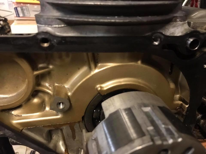

My plan for the bike involves painting the engine rather than polishing the covers, and I'm shooting for HRC gold, but getting the color right can be a trick. ...until I removed the stator cover and found that the upper half of the crank-case is, for some inexplicable reason, factory painted that color inside ...and it looks AMAZING in person. Now I KNOW I'm going to paint the engine this color! :)
I have no idea why it's painted that color, I've seen several of these torn down and never seen one that wasn't just silver (bare aluminum) ...has anyone else? Seeing it in person, it's clear this isn't some old rattle-can job that wore off on the outside, it's really stunning.

I have no idea about the coating under the stator cover, but perhaps it has something to do with the fact that oil sits in that area.

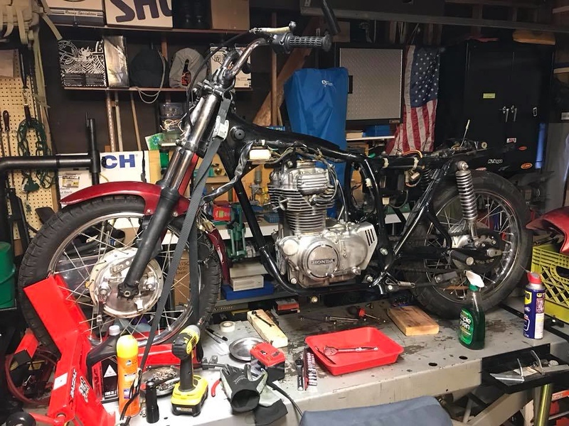

I made a little bit of progress tonight; managed to get the engine out of the bike and began the tear down.
Overall the engine looks good so far, though I'm not thrilled at these cam-followers; I'm not sure what caused this scoring, but I'm thinking I should polish it out or look for replacements.
At least the cam lobes look clean. ...there is some minor wear on the bearing surface, but I can't feel it with my fingernail, so I'm hoping it's nothing to worry about.
I won't get to pulling the cam out until Sunday at the earliest, so I don't know what the journals look like. If the valve cover is an indication, I think we'll be in decent shape.
Last thing, to take a break from getting covered in oil, I cut down the front fender (with it's broken bracket) to see how it looks. Not sure if I'll use the stock fender or not (I can weld the bracket / brace) as the CJ has a creased fender that may not work with the softer lines of the CB tank. ...we'll see.

My upper case on my cb is that same burnt oil golden color too, found it odd as well the first moment I saw it. As for the head bolt, man that's strange I don't remember mine being inaccessible at all, but they are now all socket bolts, so I can't check clearance. A good quality 10mm open end should work, cheap ones can be out of tolerance and round the ends

Only the top case is painted, hot oil make silver paint change colour.
