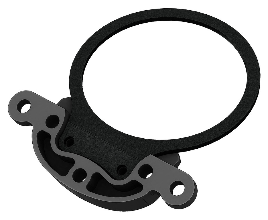

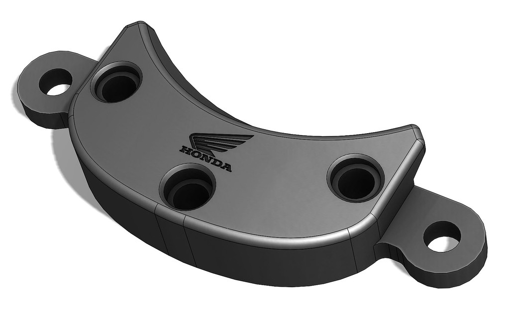

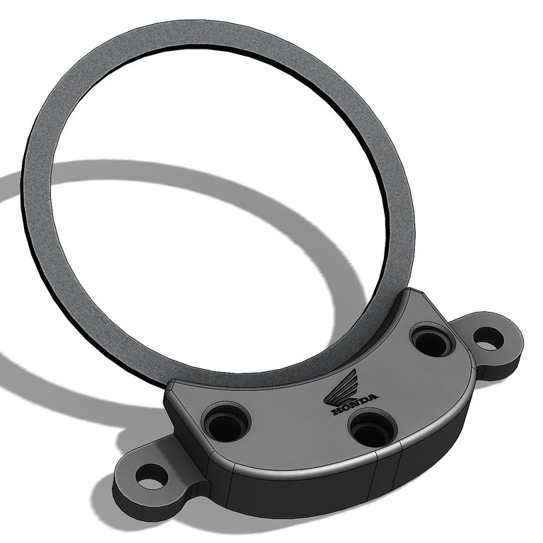

My parts are still out for powder coating, but I've been working on cleaning up the frame, and designing an aluminum bracket to hold the Cognito-Moto GPS speedometer and some indicator lights (L & R turn + high-beam). Cognito supplies a mounting ring, so I just had to draw something up to mate it to the OE triple clamp. ...the little Honda wing won't be part of the NC program (way too small), instead, I've ordered a factory Honda wing badge that is perfect, so I will machine in a small recess for it. ...I remembered my VFR1200 had that logo emblem and found it on Partzilla for $2.95; that should help keep things looking "factory". :)
This is what I've got, though I'll wait until I get the indicator lights to finalize those 3 holes then I'll prototype it on the 3D printer. If all fits as it should, I'll have on machined from billet then have it powder-coated with the next batch.
Here's the VFR clamp so you can see what that badge will look like.

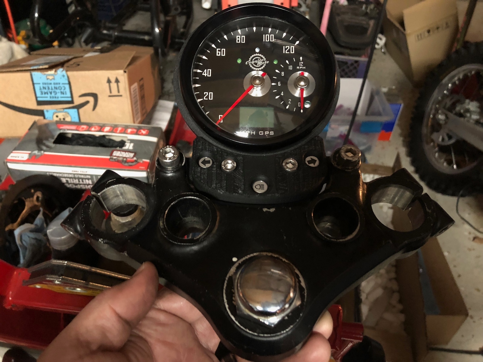

Pulled the part of the 3D printer today and test fit everything; looks like it will get the job done. ...next step for this portion is to get the part quoted for CNC and black anodizing. I think it will look sharp when it's all done (I'll probably make sure the turn signal indicators are straight when I do final assembly though). ;)

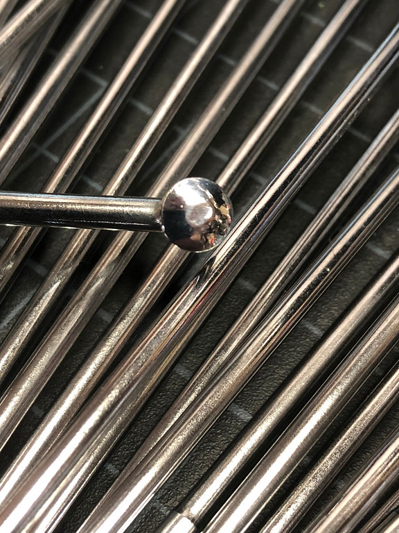

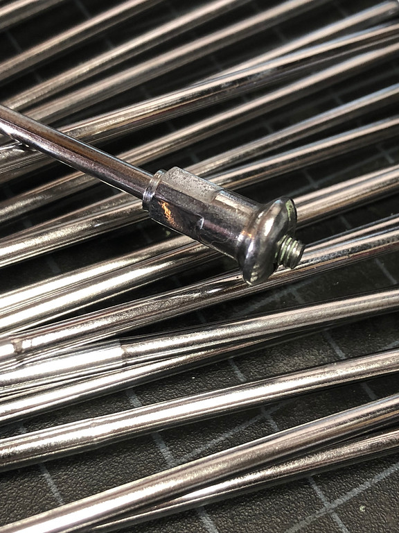

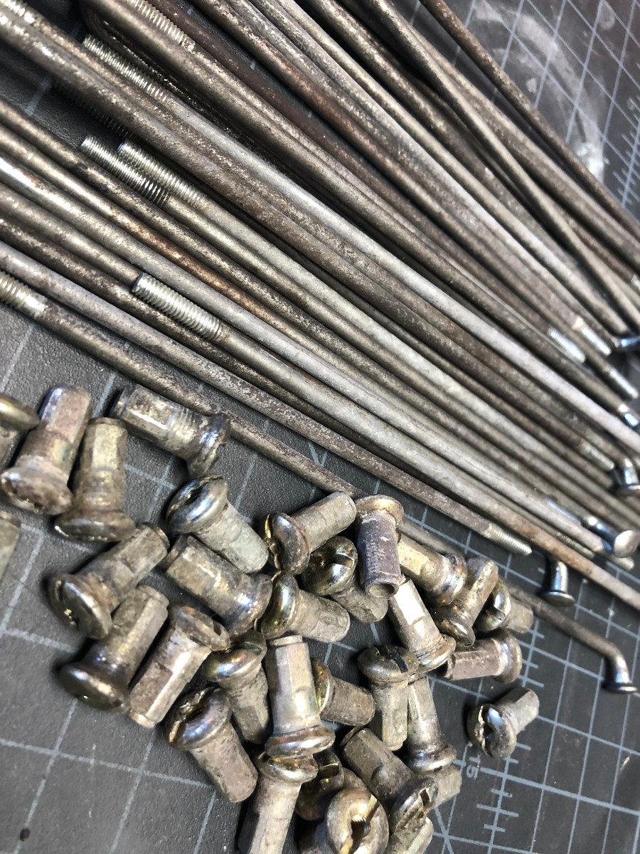

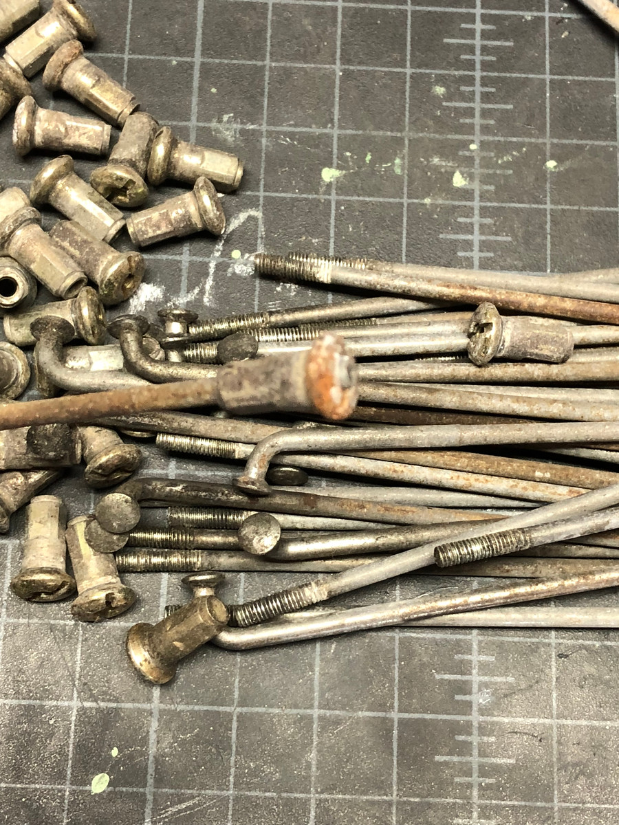

Finally got some bits back from powder; the hubs I got a while ago, then sent wheels out for lacing. Before doing that I needed to clean up the original spokes, as I planned to reuse them.
They turned out pretty good, but it was a fair amount of work ...totally worth it.
I went from this pile of rust and corrosion...
to this shiny mass of polished beauty.

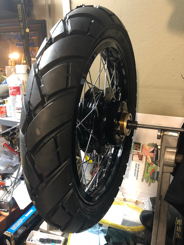

The wheels came out beautifully, though my wheel guy had to adjust the nipple angle to make the stock spokes work with the rims I'd purchased. ...I'm still working on mounting the rear tire, as you can see.

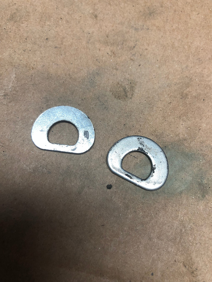

Here's a question for the hive mind. ...anyone know where these go? lol They were in a bag marked (by me) "Rear Brake Cover" meaning the drum cover for the rear wheel. ...but I'm puzzled as to where I actually got them.
Obviously they came off the bike ...at the rear brake. Looking through the service manual and the online parts catalog I don't see anything like them, and don't see a place they obviously fit.
OTOH, we finally had a hot day, so I was able to get this tire soft enough to mount without damaging my new aluminum rims. :)
They probably need straightening out? Here's pic of where one probably fits. Larger hole will be shim under operating cam. I took too quick a glance, they are D shaped for a drum front brake, similar positions for TLS
