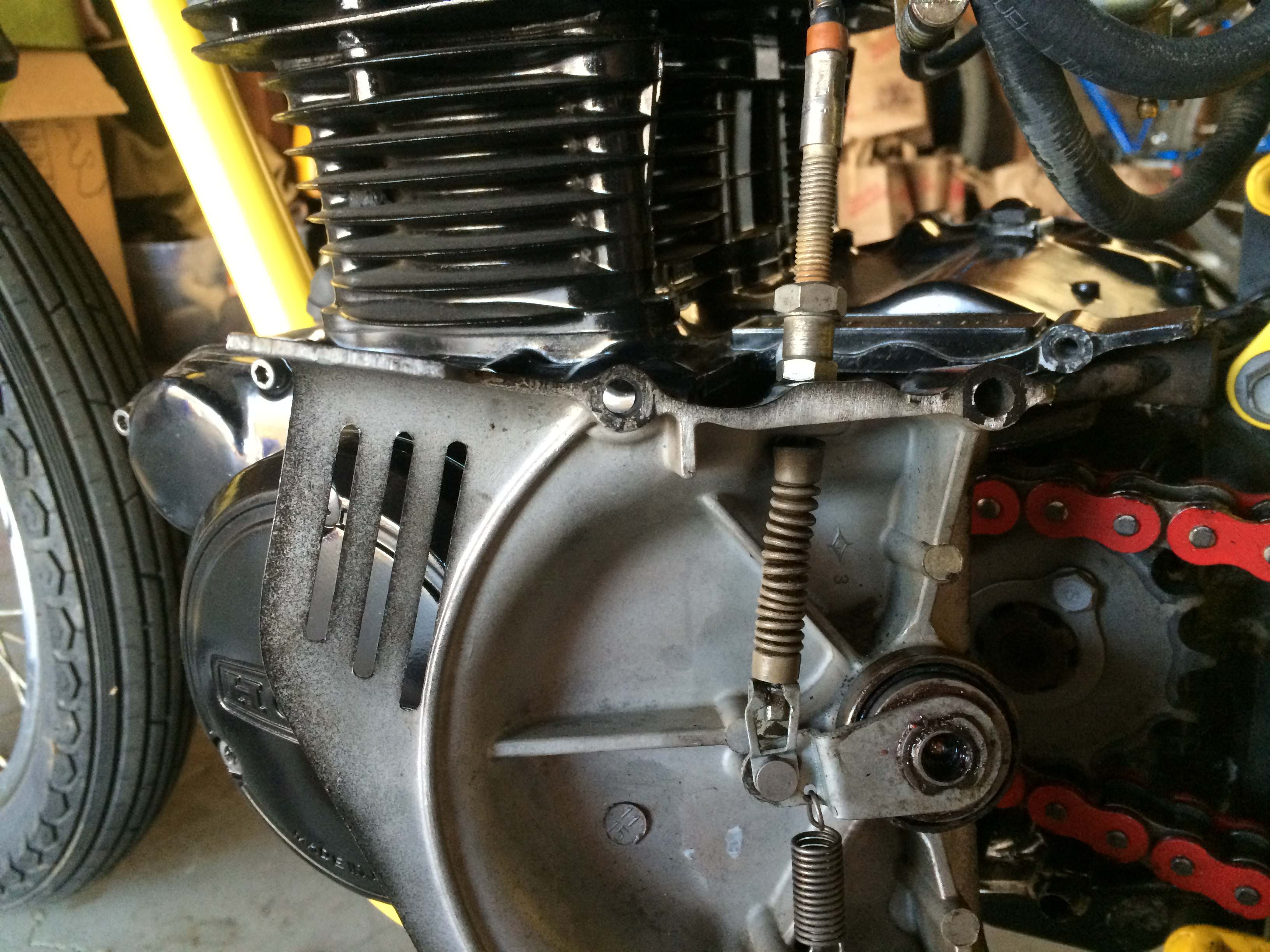

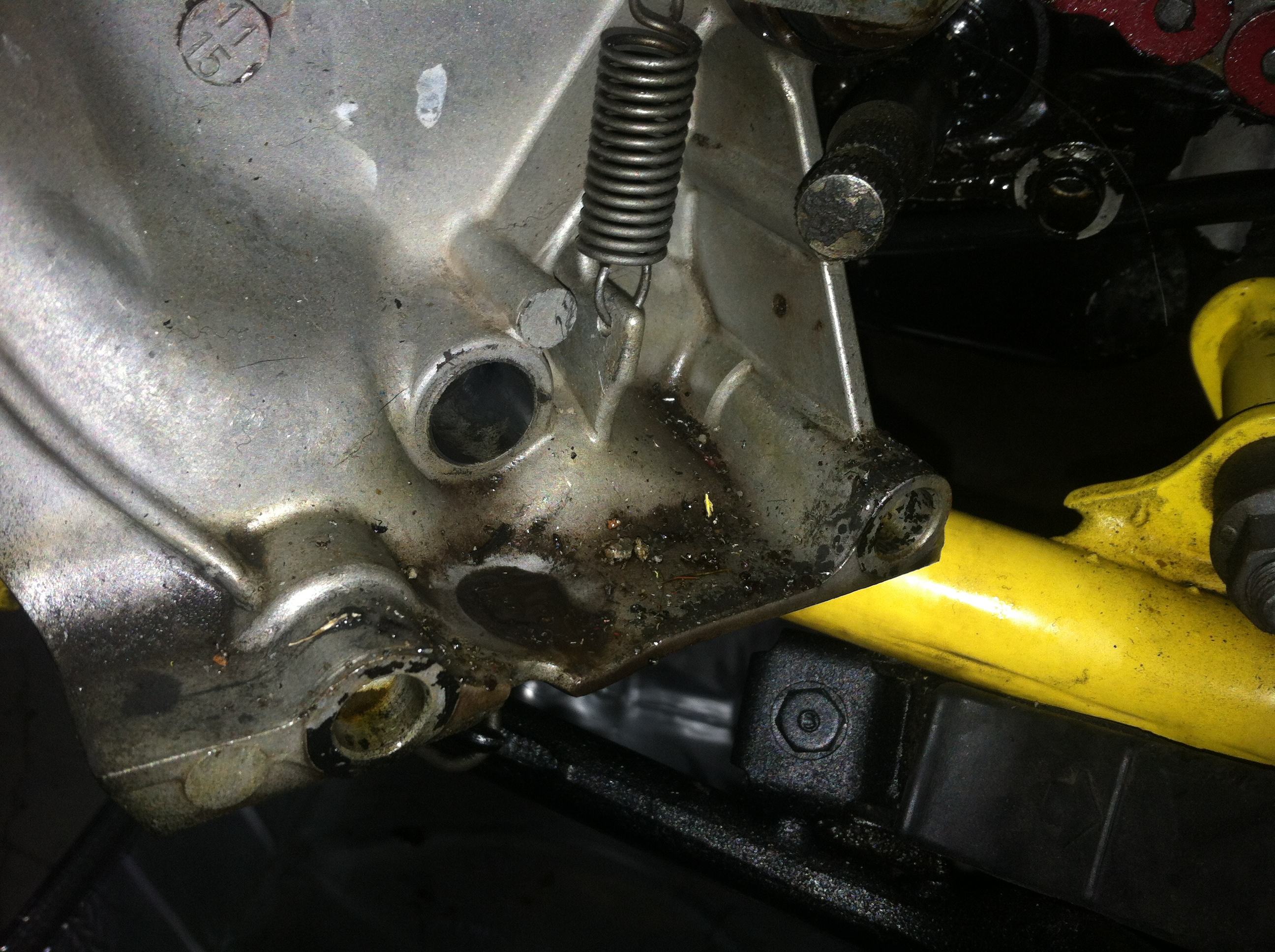

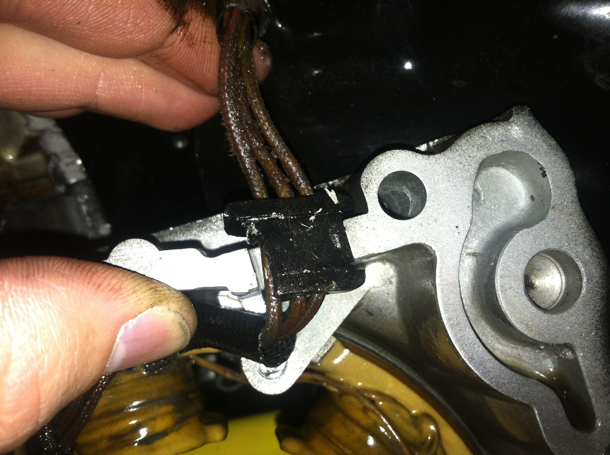

Ok so here are the pics I have, sorry one is so blurry but you can see all the dirt and gunk that was behind the sprocket cover. And the wire grommet that is broken that might be leaking oil. Then after that the spacer thing I found that I can't figure out where it goes. It is nicked and chipped so maybe that was the source of the metal shavings I found since everything looks good. Maybe it got dropped in there and bounced around.

Now that I know it isn't a part that belongs there I think I know what it goes to. The seat is a custom piece and the guy used four wing nuts with spacers to connect it to the bike. I think it was one of those that fell off and disappeared and he just made another one. Thanks. How about the sprocket cover having all of that gunk in it and the little pool of oil under the hole where the shift shaft comes out. I have only put about 45 miles on the bike all on road, could it accumulate that much dirt in that little time? And the little pool of oil is that normal or does it mean I have a seal out? Could the oil have come out of the wire plug and leaked down inside the sprocket cover and then leaked out, could I just use liquid gasket to seal it? And last question when I replace the gasket with the new one I have on order do I use a sealant or just put the gasket on as is, thanks.
If oil was leaking into there, the dirt would accumulate very quickly, yes.
Some RTV or Threebond should help seal it up. That particular seal is a huge pain in the ass to change, otherwise I would recommend a replacement.

Ok so I got the gasket and installed it and...still leaks in the same exact spot. I did not use the RTV or any sealant on the gasket for the little plug that the wires go through. Any ideas? Thanks.

If its a leak at the rubber seal on the wires. I would use acetone to clean and make certain all aluminum gasket surfaces were dry as a bone. I would use a BRAKE cleaner to clean the rubber seal up as best as absolutley possible. So the rubber is nice and DRY. put a small bead of Permatex Ultra Black around the rubber seal. Not so much as to squeeze out a glob inside the engine.
Kinda loosely assemble. (Not loose but not so tight enough to squeeze out ALL the fresh Permatex). Give it about 10 minutes then torque the cover to spec.
And yes the gasket and machine gasket surfaces should be bone dry.
Then let it sit for a day or two. To make sure the silicone is fully cured before running the engine.
You dont want to use carb cleaner for this kinda stuff, carb cleaner contains lubricants. Brake cleaner is the cleaner of choice. It dries dry.
