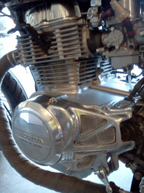

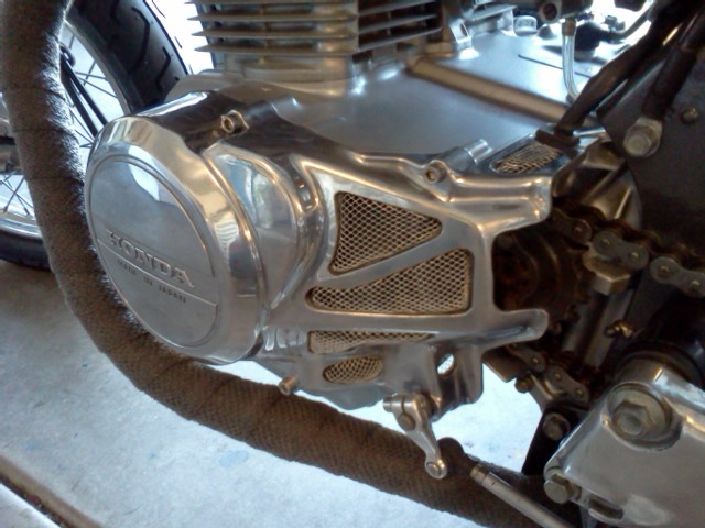

SOO close ....but don't want to post finished pics until the weather is right and have the carbs & Seat Upholstered. But here are a few more teaser details.
Aluminum "Modelers Mesh"

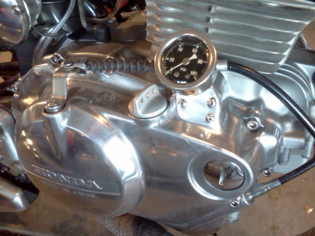

Oil Preasure Gauge....

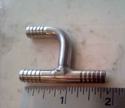

I picked up this cool Stainless "T" or "Y" necessary for the fuel supply

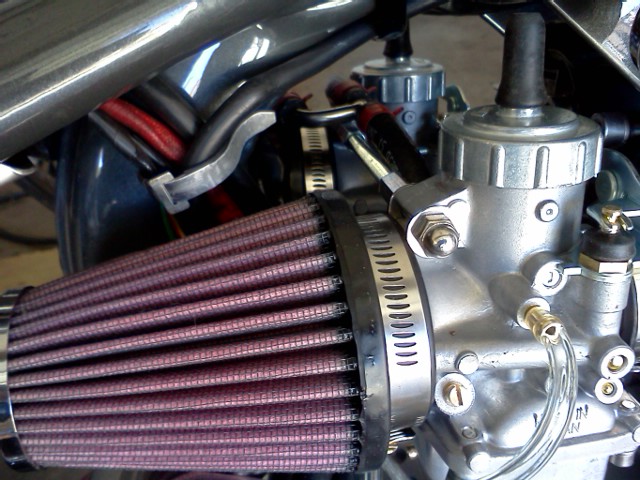

My kit did not come with VM30 Mounting Flanges . I'm not sure I would have used them anyway to be honest. The VM30 Spigots are 40mm and the OEM Carb Spigots/Flange openings are 43mm. The VM30 Flange Mounting Hole Center to Center Distance is 60mm. the Head Stud Distance is 67mm
I like that the flange throat on the OEM mounts are effectively matched to the head port, and while I have no scientific basis, I also liked the idea that the "expansion" will occur right after the smaller spigot of the VM30 Carbs, vs after the VM30 Flange.
So I decided to fit the Carbs to the flange instead of the flanges to the head. I bought a small bicycle tube and cut 2 bands out of it about 1/2 wide then slipped them over the VM spigot and then trimmed to the edge with a razor blade. The "Rubber Band" made them fit just snug enough that I needed to put a little oil on the bands to slip them into the flange without them moving/bunching.
The "Bands" seemed to take up the 3mm difference very well. Even though with the bands the Carbs were snugly mounted the method concerned me "down the road". I decided to utilize the Carb mounts. I "Racked" them so to speak, with a piece of 1/4" all thread rod, 2 1/4" Coupling Nuts w washers (on inside of carbs) and 2 Stainless Cap Nuts with washers (on the outside). REALLY stiffened things up & I like the added security and kinda finishes the look IMO.
I too lost the 6 dangling pink "Spider Leg" vent lines". Since I don't really have an accent color I went with clear. I ran the 4 vent & 2 bowl overflow lines all the way down as the original overflow lines did. I also moved the 4 Vent Tabs/Holders (The things mounted with the bowl screws). I moved them to the back sides of the carbs to facilitate running the vent lines with the bowl overflow lines.
I was feeling a little apprehensive about the "Universal" Dual throttle that appears to have come with both are "Kits"> I like the quality of the aluminum splitter but did not like the idea of Finishing the ends of the 3 cables. Then I lost the little bag of the ends (@!#&%!) so I ordered a Parts Unlimited VM30 "Finished" Dual Throttle Cable, (Part #922).
I am hoping I can maybe use the Universal Splitter to make a Choke Cable later on. The VM30 Carbs Only come in a "Left" mount type with choke and adjustment on left side of carb.
The Special "T" I bought worked slick as hell, Hard to explain, I will post pics soon.

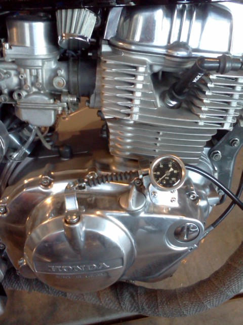

Pics as promised.
