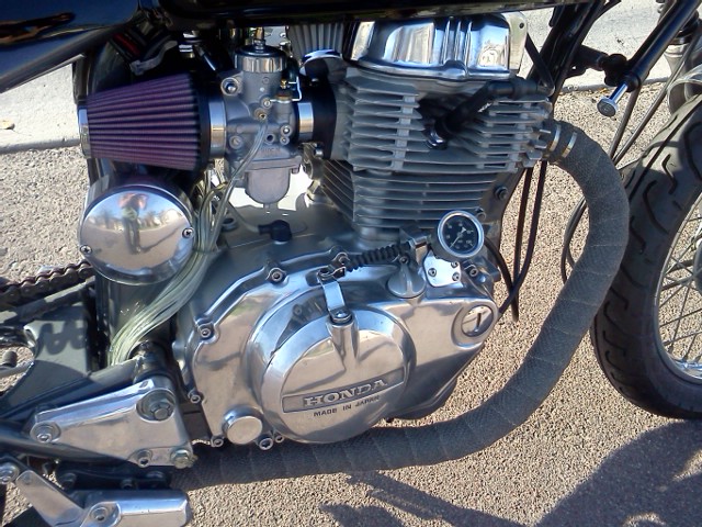

First, what an inspiring thread you have here! I have a question or two regarding the carbs. I think I am going to take the plunge into getting the VM30's from DCC for my '78 CB400Tii build. I am tired of messing around with the factory ones.
Did you keep the factory throttle tube and utilize just the pull function of it?
Am I correct in thinking that your factory carbs and mine are the same? I ask because you had to do something with the fittment into the factory size intake boots.
And when is the video of this bad boy running with the new carbs?!
Also, I have found a simple solution to the right side carb choke.
http://youtu.be/EesID_WiLcc?t=51s
Again, amazing build! And thank you for any input regarding my questions.
Re: My CM400T Cafe Build - HOME STRETCH
First, what an inspiring thread you have here! Thank you very much
I have a question or two regarding the carbs. I think I am going to take the plunge into getting the VM30's from DCC for my '78 CB400Tii build. I am tired of messing around with the factory ones. . I Have been really happy with DCC Too, Don't forget that they offer a 10% Discount to DTT. See thier first thread in the "friends of DTT" section
Did you keep the factory throttle tube and utilize just the pull function of it? Yes I was only using the pull cable before anyways.
Am I correct in thinking that your factory carbs and mine are the same? I believe the CB400Ti's had diff carbs but probably same Spigot and flange opening size as the CM's. I ask because you had to do something with the fittment into the factory size intake boots.
From top of page 14
"My kit did not come with VM30 Mounting Flanges . I'm not sure I would have used them anyway to be honest. The VM30 Spigots are 40mm and the OEM Carb Spigots/Flange openings are 43mm. The VM30 Flange Mounting Hole Center to Center Distance is 60mm. the Head Stud Distance is 67mm
I like that the flange throat on the OEM mounts are effectively matched to the head port, and while I have no scientific basis, I also liked the idea that the "expansion" will occur right after the smaller spigot of the VM30 Carbs, vs after the VM30 Flange.
So I decided to fit the Carbs to the flange instead of the flanges to the head. I bought a small bicycle tube and cut 2 bands out of it about 1/2 wide then slipped them over the VM spigot and then trimmed to the edge with a razor blade. The "Rubber Band" made them fit just snug enough that I needed to put a little oil on the bands to slip them into the flange without them moving/bunching.
"The "Bands" seemed to take up the 3mm difference very well. Even though with the bands the Carbs were snugly mounted the method concerned me "down the road". I decided to utilize the Carb mounts. I "Racked" them so to speak, with a piece of 1/4" all thread rod, 2 1/4" Coupling Nuts w washers (on inside of carbs) and 2 Stainless Cap Nuts with washers (on the outside). REALLY stiffened things up & I like the added security and kinda finishes the look IMO."
And when is the video of this bad boy running with the new carbs?! I have some sorting and tuning to do before the bike is finished, I also need to have the seat upholstered. When it's all done ......
I had thought about that too, also thought about just bending the tab to the right . it would change the up/dwn choke if I did though. the reality is, I probably will very seldom even need a choke, remember I'm in Arizona. I may ultimately convert to cable actuated choke.
Again, amazing build! Thank you again...
And thank you for any input regarding my questions. I hope I have answered your questions.

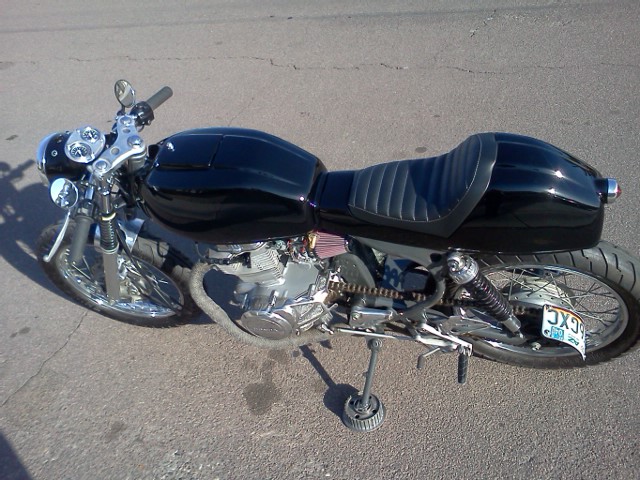

Well I got the last "Visual" piece installed today, the seat I had made. So I guess it is basically done. Still a little sorting like Rear brake Switch, Polish the Hubs and re-polish some of the other pieces and Fine tune the VM30's. Are they really ever Done?...

What the heck ...I worked hard on this....a few more
