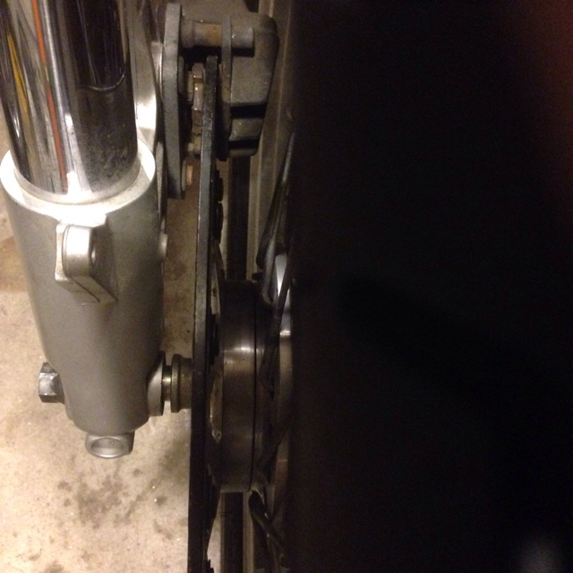

There's more than one way to do this. I did a GL1000 front end with the stock wheel. I machined the hub to accept a larger OD/ID bearing to match the VZ axle. I was fortunate to find a modern 300mm rotor to match the GL bolt pattern (95/96 YZF600R). So all I needed was the spacer. A used a template from the rotor to plot and drill the spacer. Because the rotors have a larger ID than the hub face, I machined it with a lip...
index.php
Here's the finished product with 99 - 02 SV650 calipers...
The BMW is clocked, and with the same lip as the GL. A cool thing about the BMWs is they have a metal piece installed on the outside of the rotor that covers the holes, so it looks clean. I used that same piece to pattern from. There are online resources for drawing templates, if you don't have the software already...
