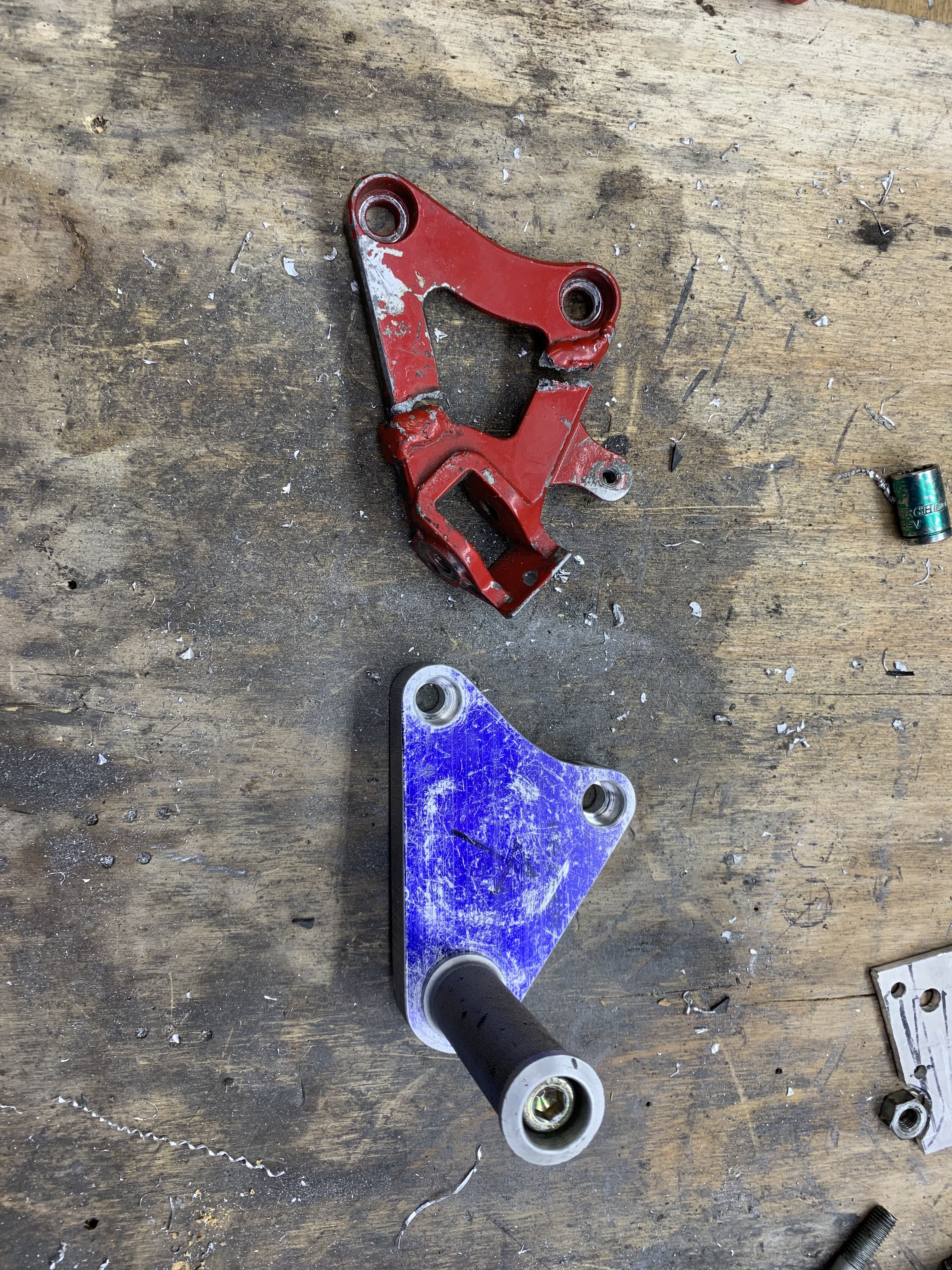

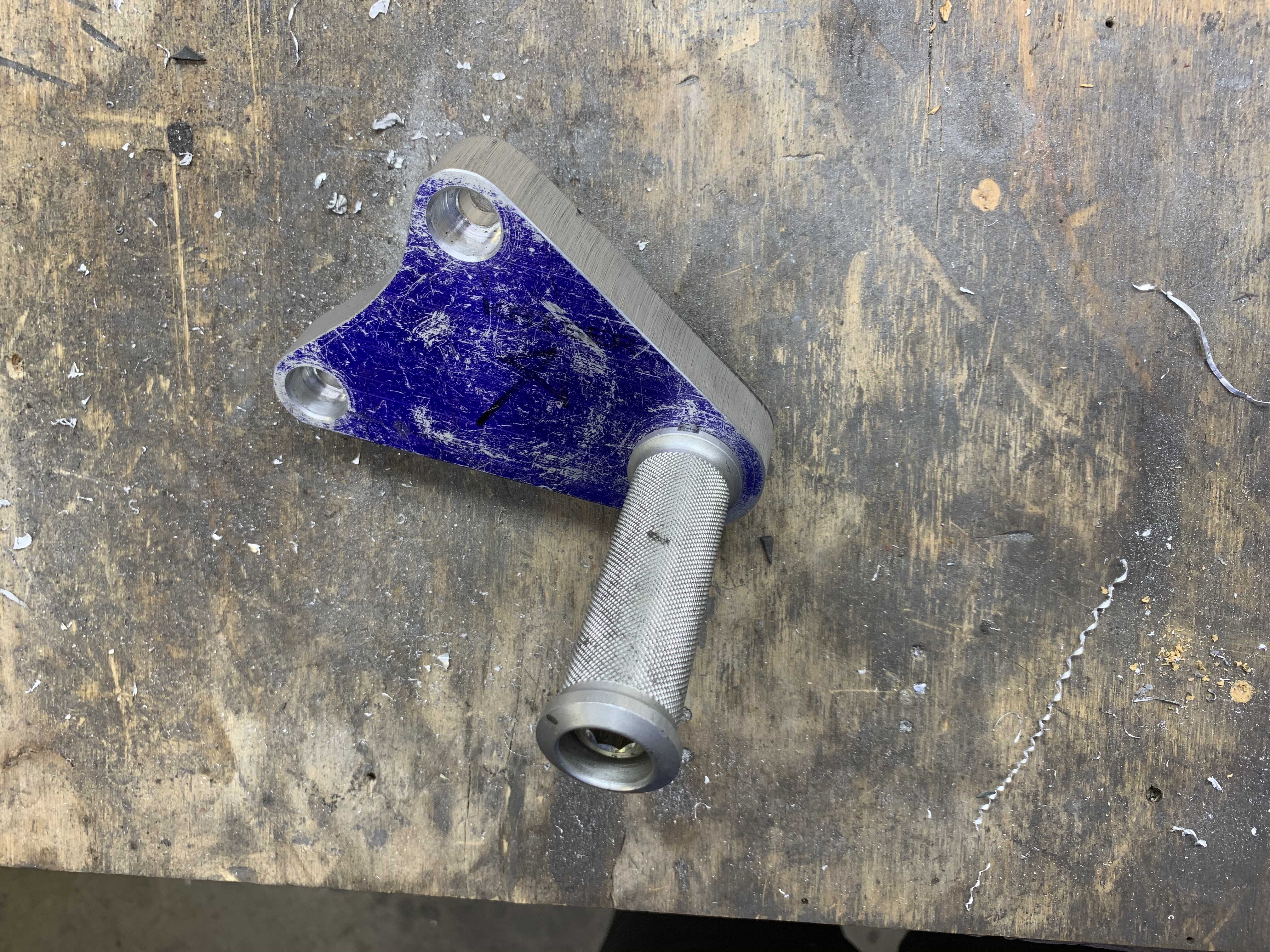

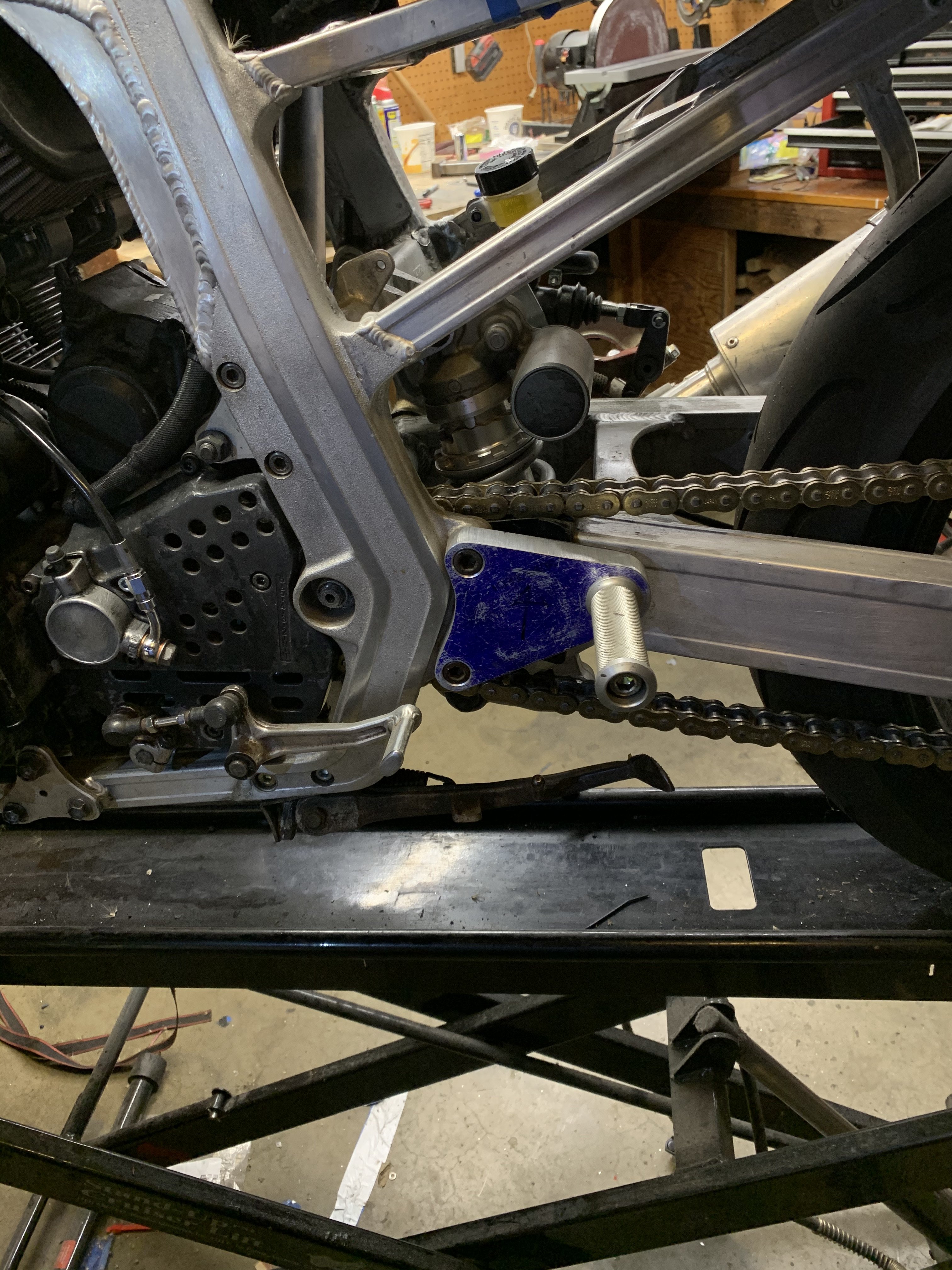

The left foot-peg had some questionable booger welds on the mounting plate so I jumped on it to do a stress test and it immediately broke. I couldnt find a replacement so I whipped this up this new mount using an Tarozzi foot peg I had leftover from another project and some aluminum scrap. I left it chunky right now while I figure out what I'm doing for a heel guard and then I will whittle it down.

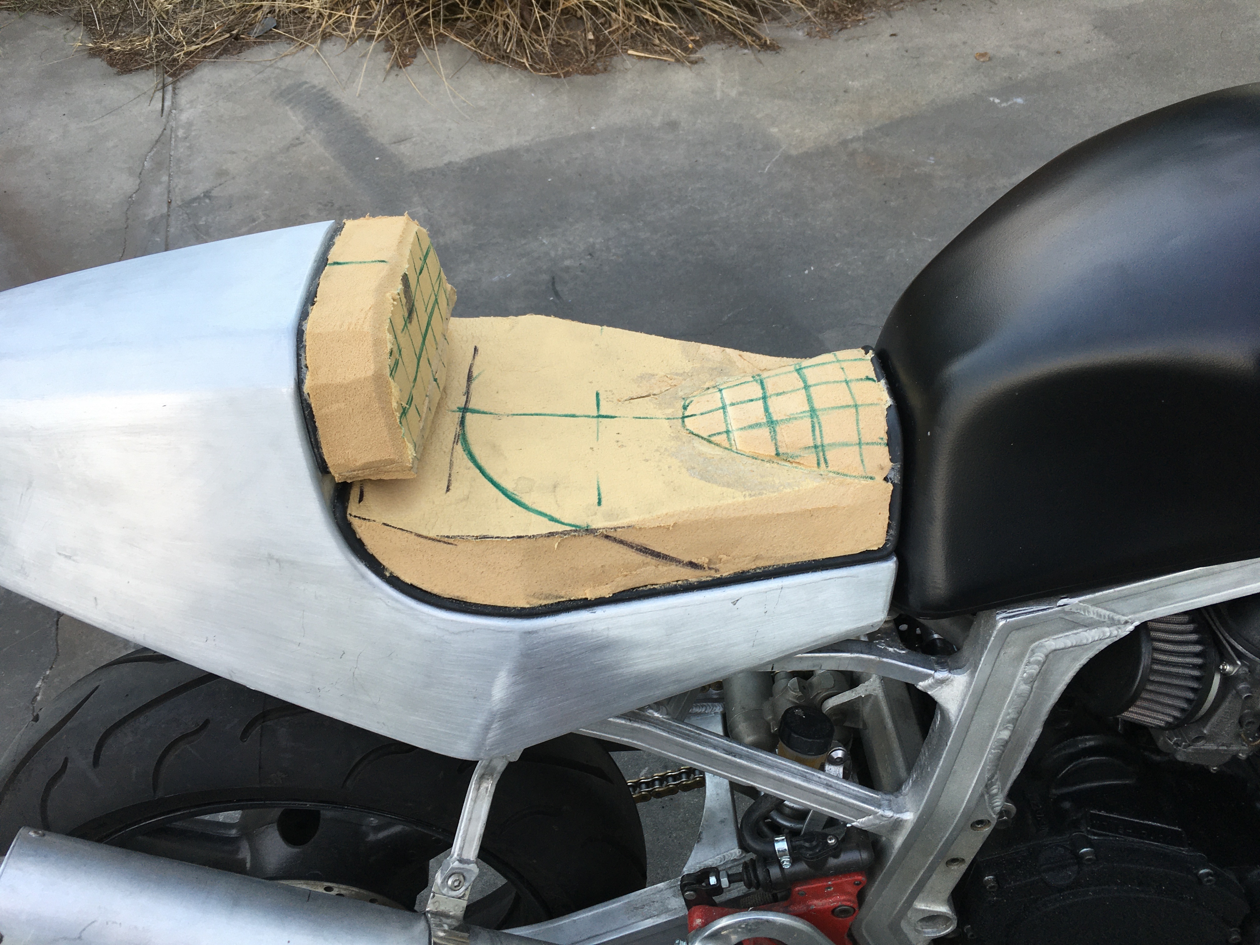

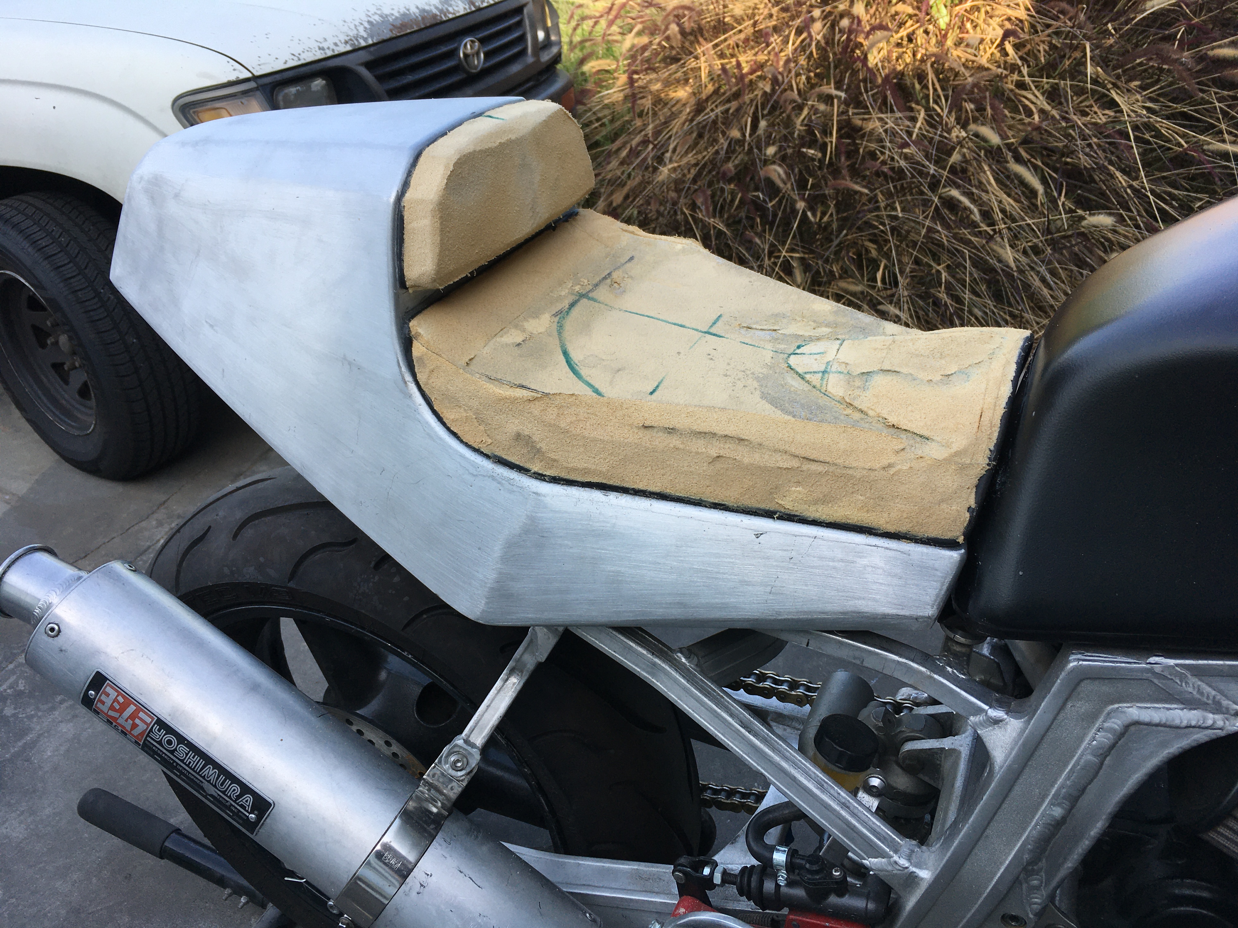

I had some seat foam left over from a previous project so I glued it down and started sculpting it. After looking at it without a seat for so long my first impression with the foam is it looks chunky as hell. I need to refine it more. I did ride it around the block and the clutch does not appear to be slipping but a high gear pull will show if thats true. getting close!
Stretching upholstery over that density foam will knock it down, too. Though I could see taking that back piece down a bunch, at least.
you beat me to it. I took the bum stop down by half, and domed it slightly. I slo refined the seat shape and added some foam on the front part so it mimics the tank shape better. I also picked up the vinyl - All i can say is "The Eighties are back, baby!"

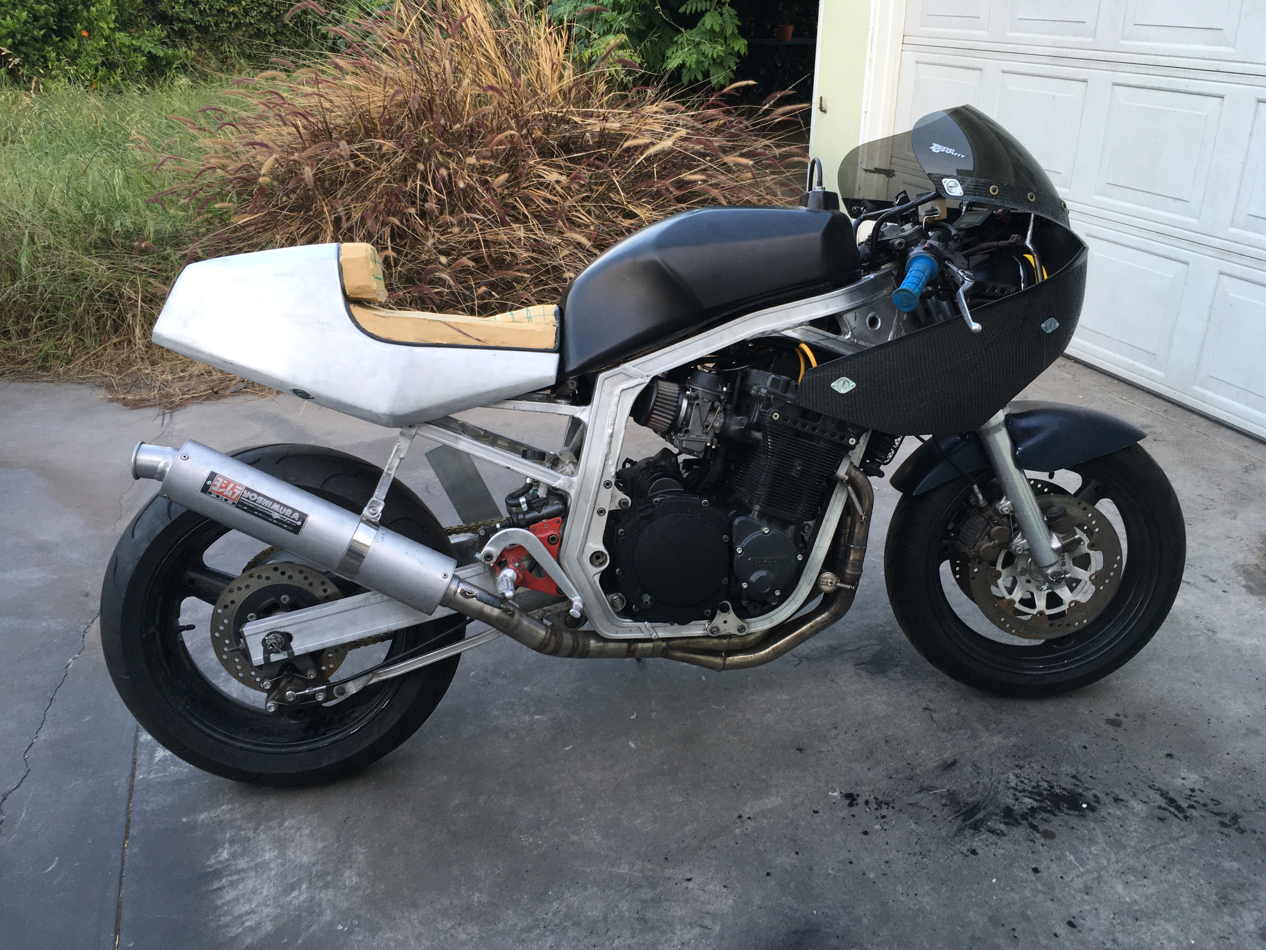

After the clutch debacle and shelling out $300 for OEM parts (may still need fiber plates) I needed something to make me feel better. The solution was to spend more money! Seat upholstery by JP custom seats out of Los Angeles. Its so retro and awesome i almost can't handle it.

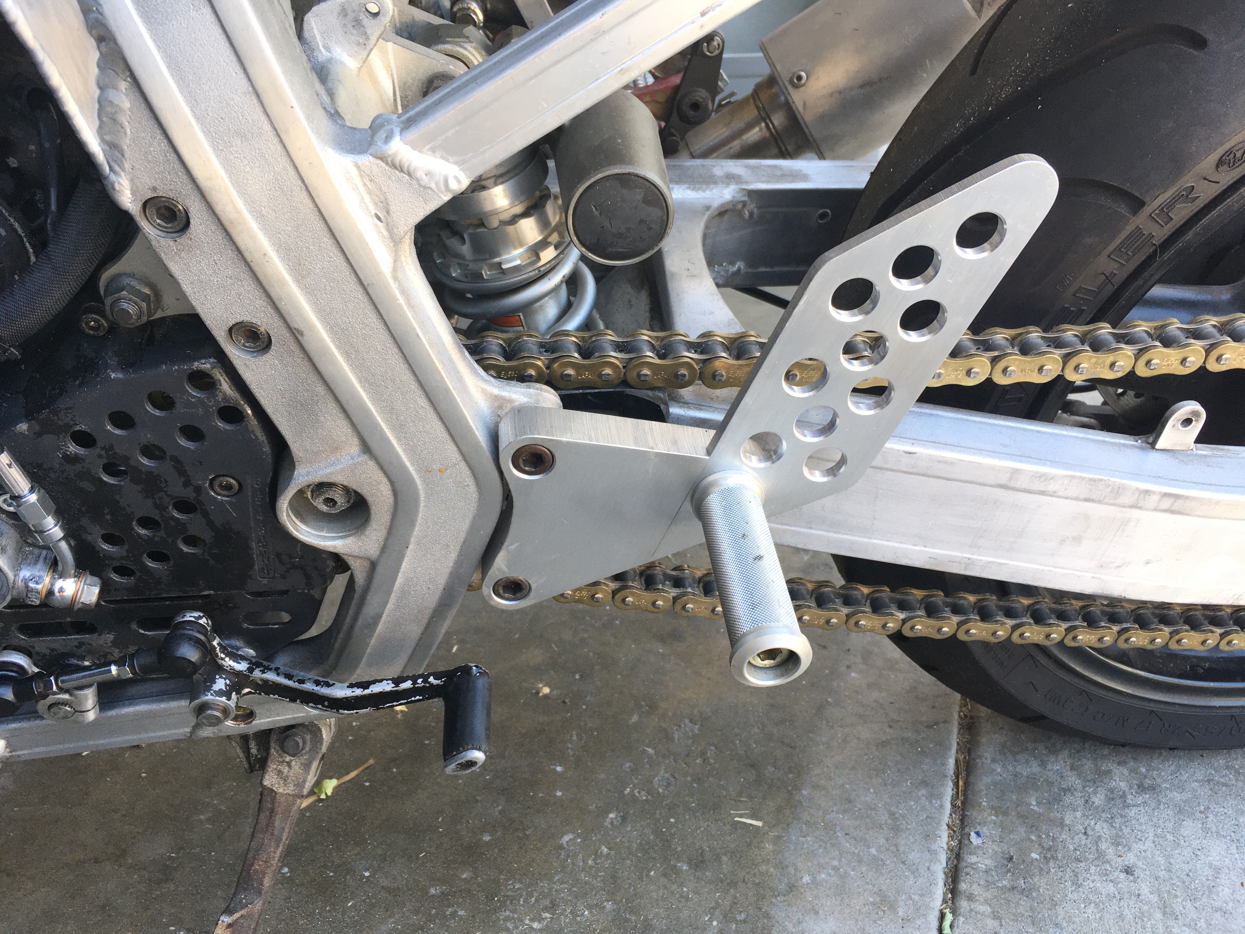

I also fixed a ton of small things that you don't really notice but make the bike complete and road worthy such as fixing oil leaks, new relay flasher, cleaned up the wiring, breather tube, finished footpeg and heel guard, polished taillight lens sides, fitted acrylic screen to keep crap off the carbs, and perfected shifter action with a new stainless bushing for the lever to take out the slop.
Gonna be a fun summer! There are some things I would still like to do; USD fork swap, braced swing-arm, tire hugger, etc... but for now im just going to ride it and enjoy.
thanks guys. I just realized i never got a shot of the final footpeg/heelguard design.
