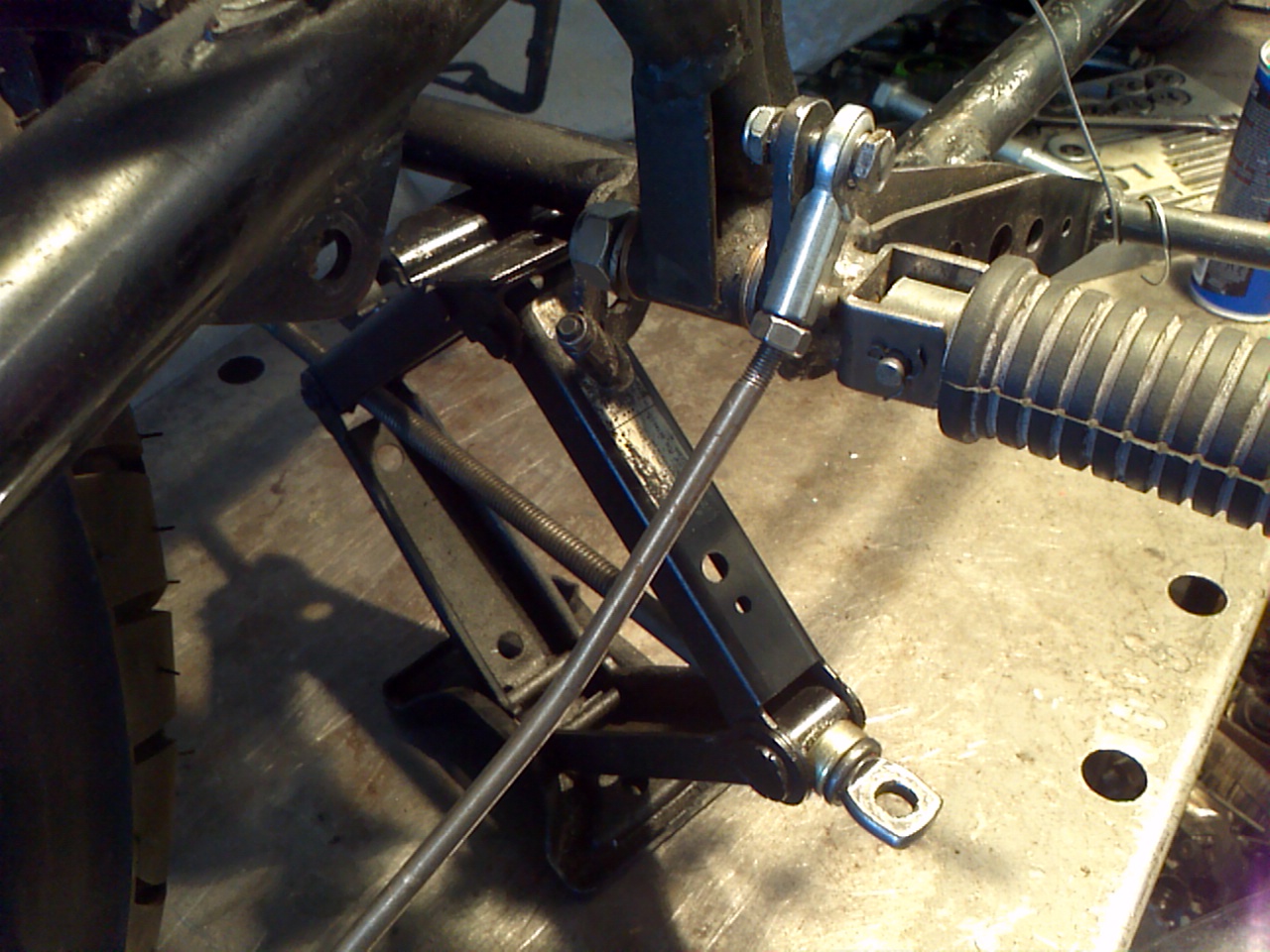

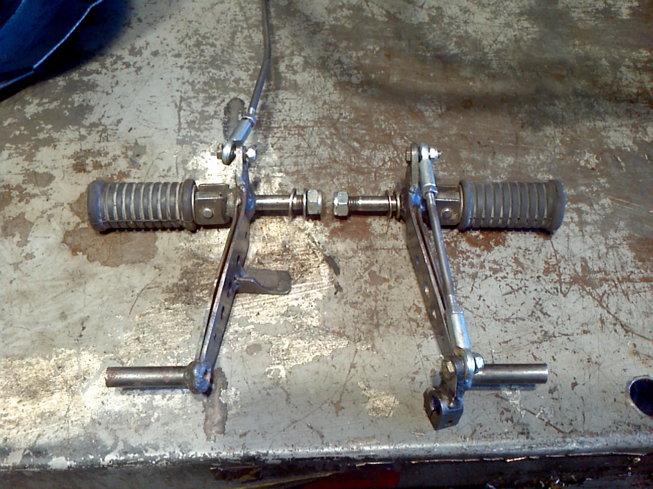

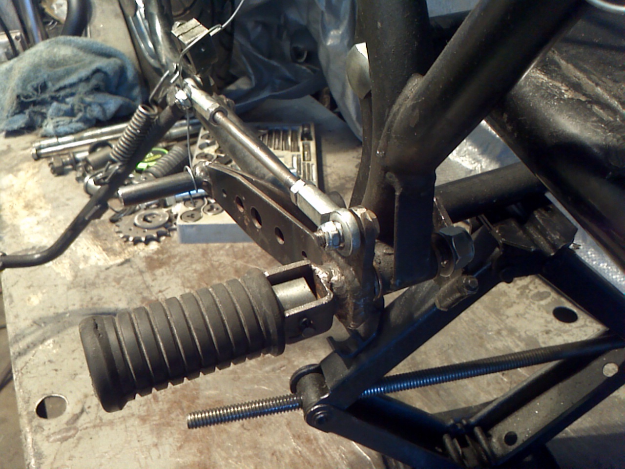

I usually buy the cheapest set of GSXR/R1/whatever set off ebay and make up mounts to suit. All I need are levers and pegs basically and then fab up a mount.

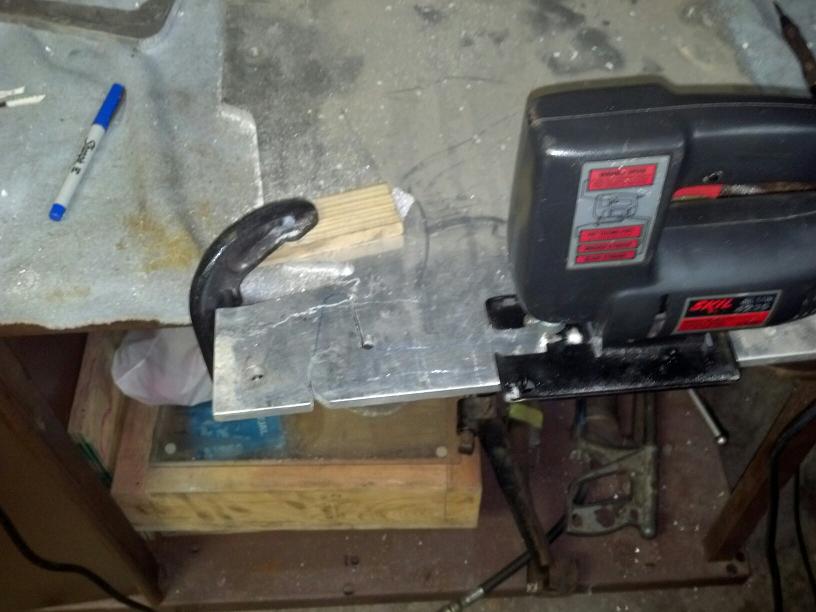

Huh...Guess no one told me. I did mine with a hand sabre saw, bench top drill, and finished with a drum sander chucked up in the drill. ;) Haven't finished them, but drilling speed holes is easy enough and if you want the sloted shapes just cut out the meat between two adjacent holes.

Was going to use a seat of BMX pegs but wanted something that folds Wound up finding a set of these polished aluminum bits at the local Honda Dealership on the Bargin table for $20
Took off the arch tube mounts and the mounting bolt passes through the double bronze bushings of my levers. Wound up using the funky step down washers on my exhaust hangers. ;)
