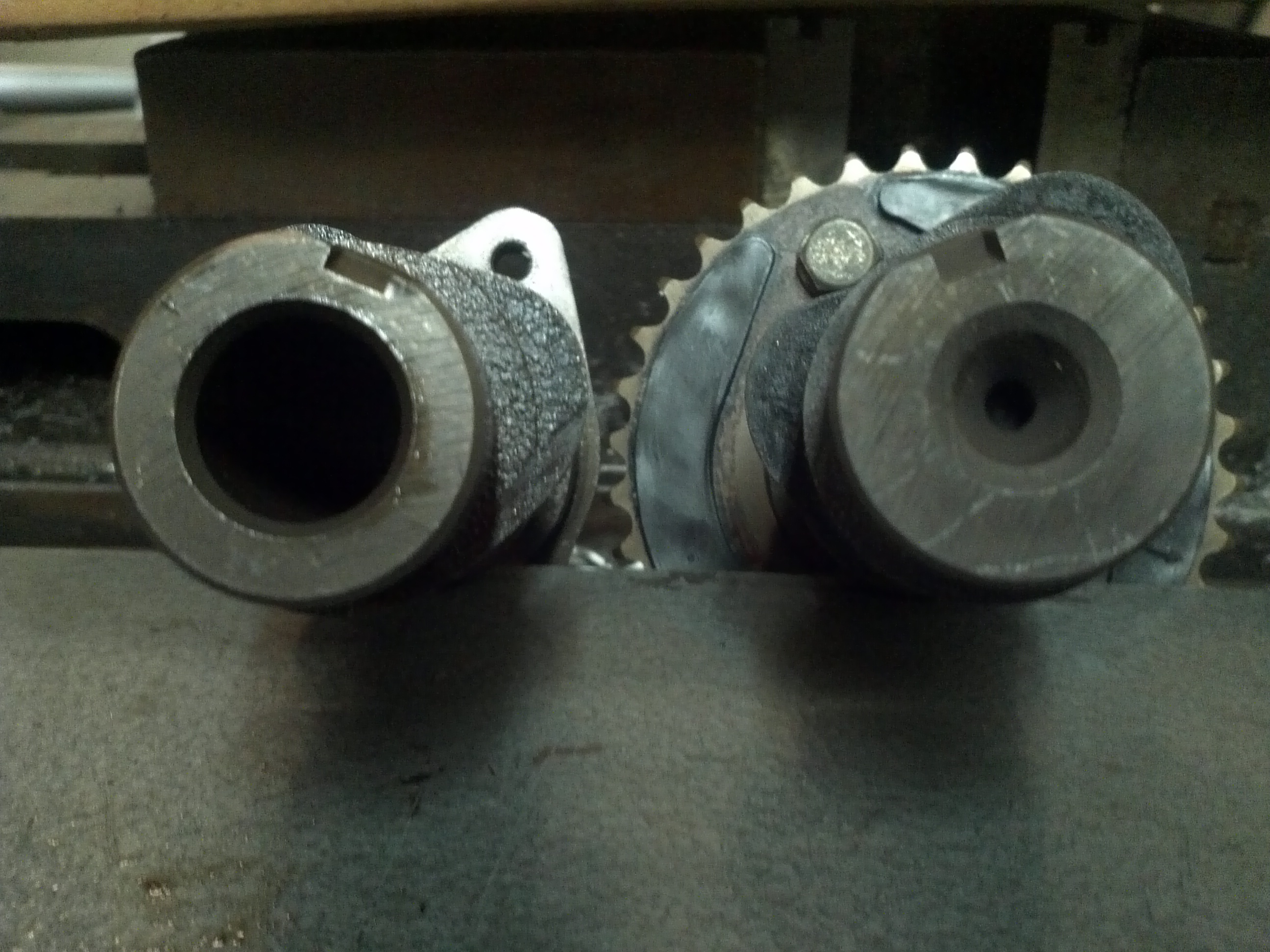

2] Modified a cam sprocket. If anybody is looking to have one machined just contact me.

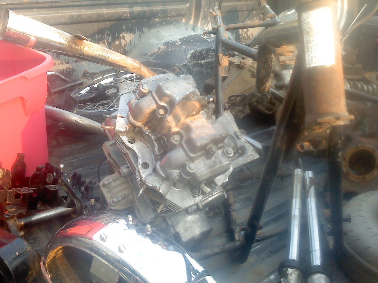

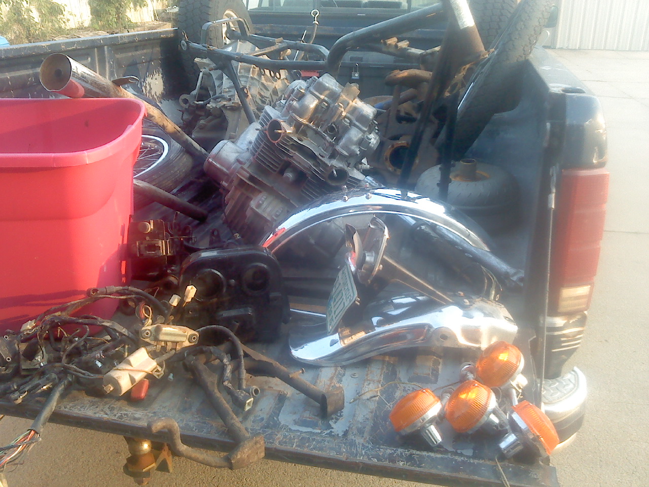

Picked up some KZ400 parts. I have almost a whole bike. Basically missing the tank, seat, side covers, carbs, tach and headlight.
No title with a 3-74 build date. 2445th bike built with a 2418 engine number. Odometer shows under 7100 miles. Engine has compression.
Going to check engine over with a compression test and then flip the cam sprocket. Plan is to punch it out to 67.5mm, port the head
and some cam work.

I evil bayed another one. All the cams I've seen for the KZ400/440 have been forged steel.
The new one is cast iron. So I'm going to weld up the original cam from the engine and use
the cast iron one for a stock reference. I'll post up some pics this weekend.
Here are some pics of the piston with a KZ440 piston on the left and KZ400 on the right.
My guess is the dome volume is 9-10 cc compared to the stock pistons.
Also the two different cams, hollow forged and cast iron.
