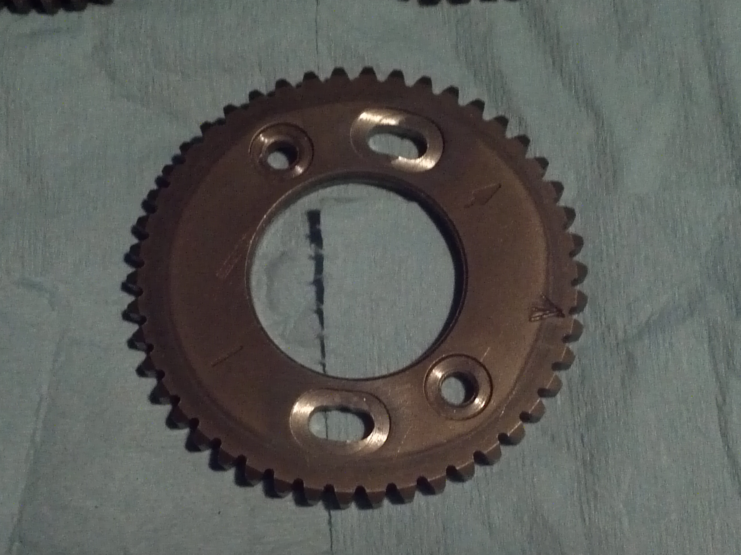

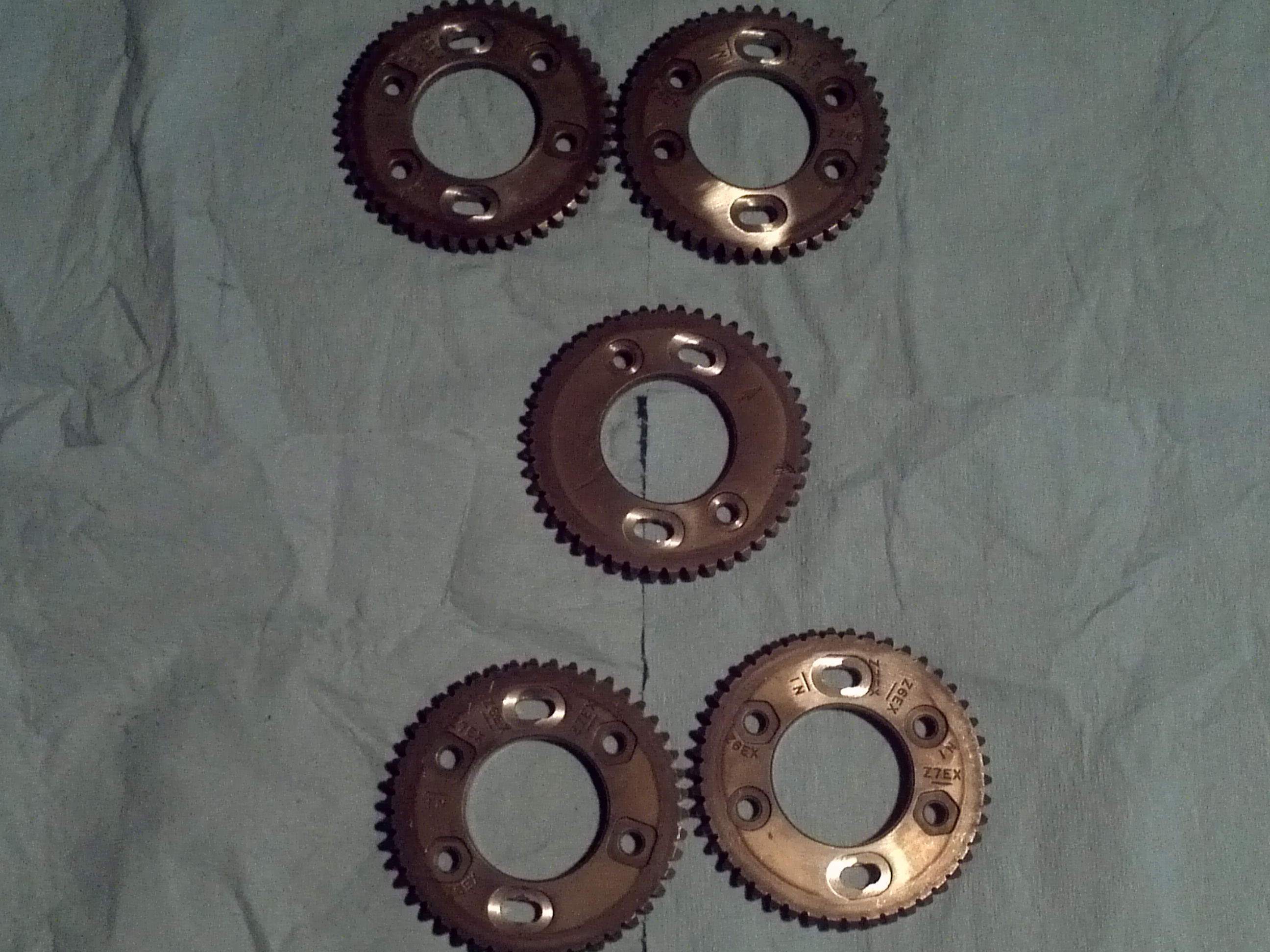

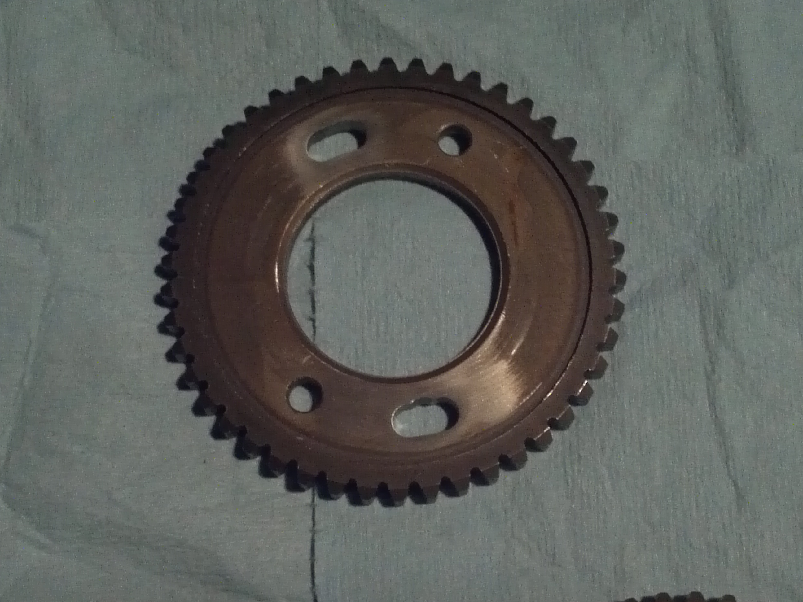

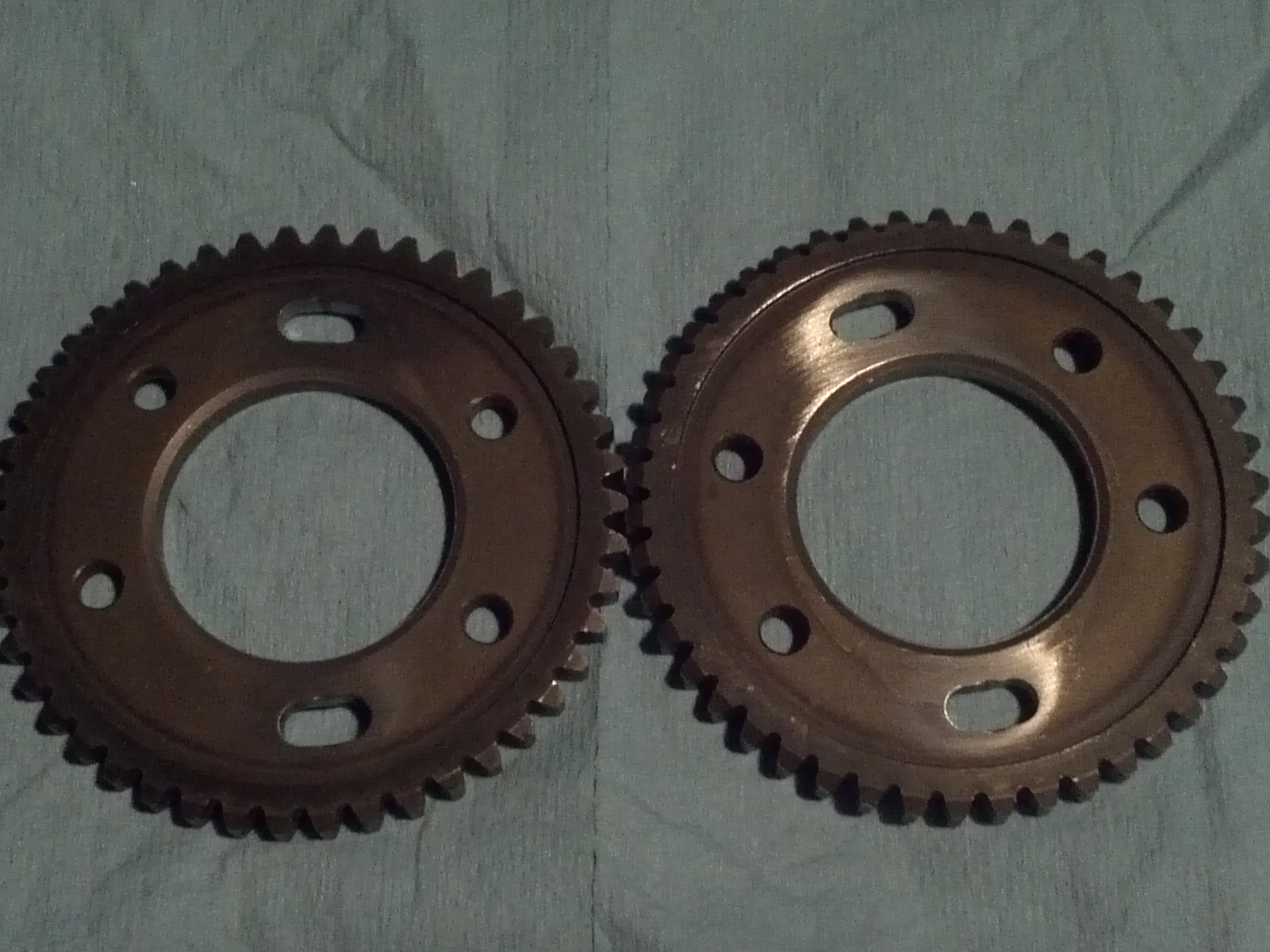

A member on KZRider needed some slots milled for adjustable sprockets.
Nobody makes them for the KZ/GPz750. So I offered my services and machined
a set for him along with another set and one for a KZ440. The extras I put up on
evil-bay to see if anyone is interested.
Here are some pics....

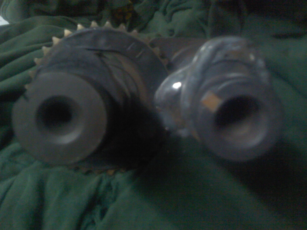

Here are pics of a welded cam compared to a stock unit.
No need to, the welded area is harder than the base metal.
That is why I had to make the tooling to start with.
A file would not touch the weld but leave a mark on the base metal.
