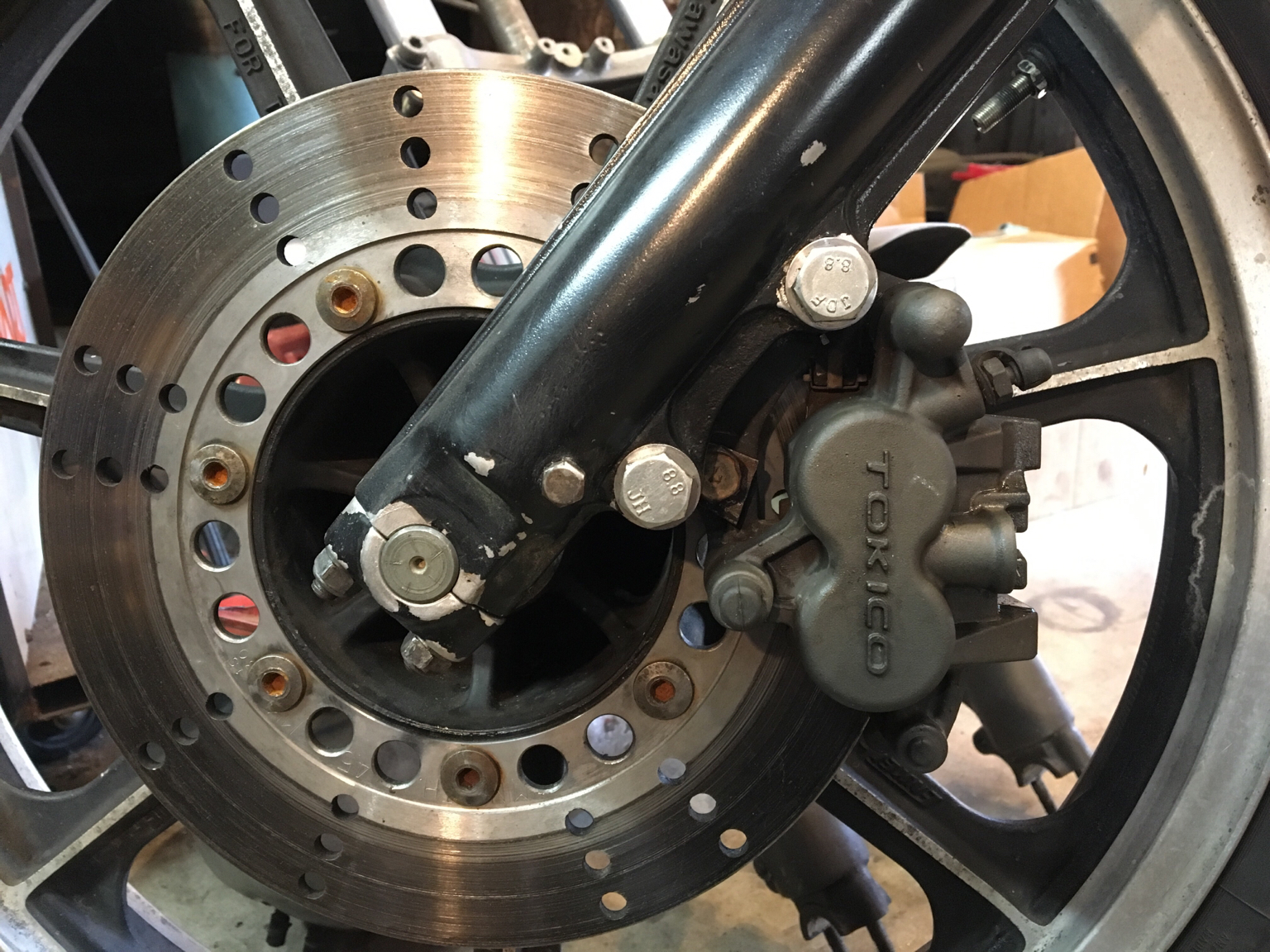

Front caliper sorted with a Tokico that came off an EX650. The 750f fork mounts were within an inch from the caliper mounts, so it just required a small bracket to move the bottom hole, while still using the top hole. Then two spacers were machined to match the offset.

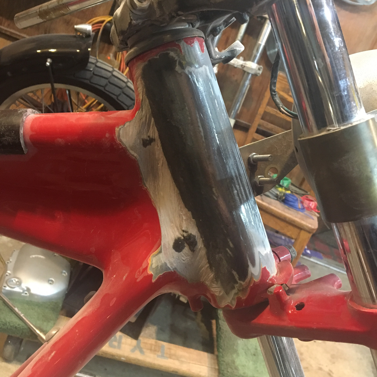

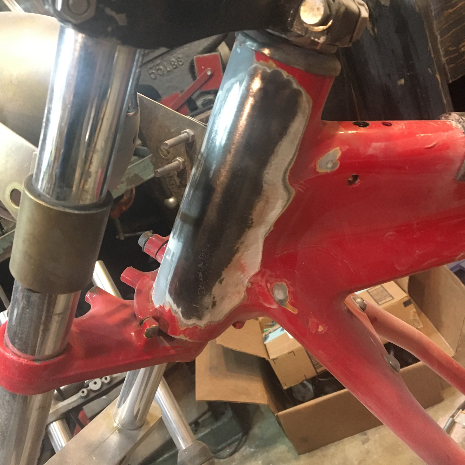

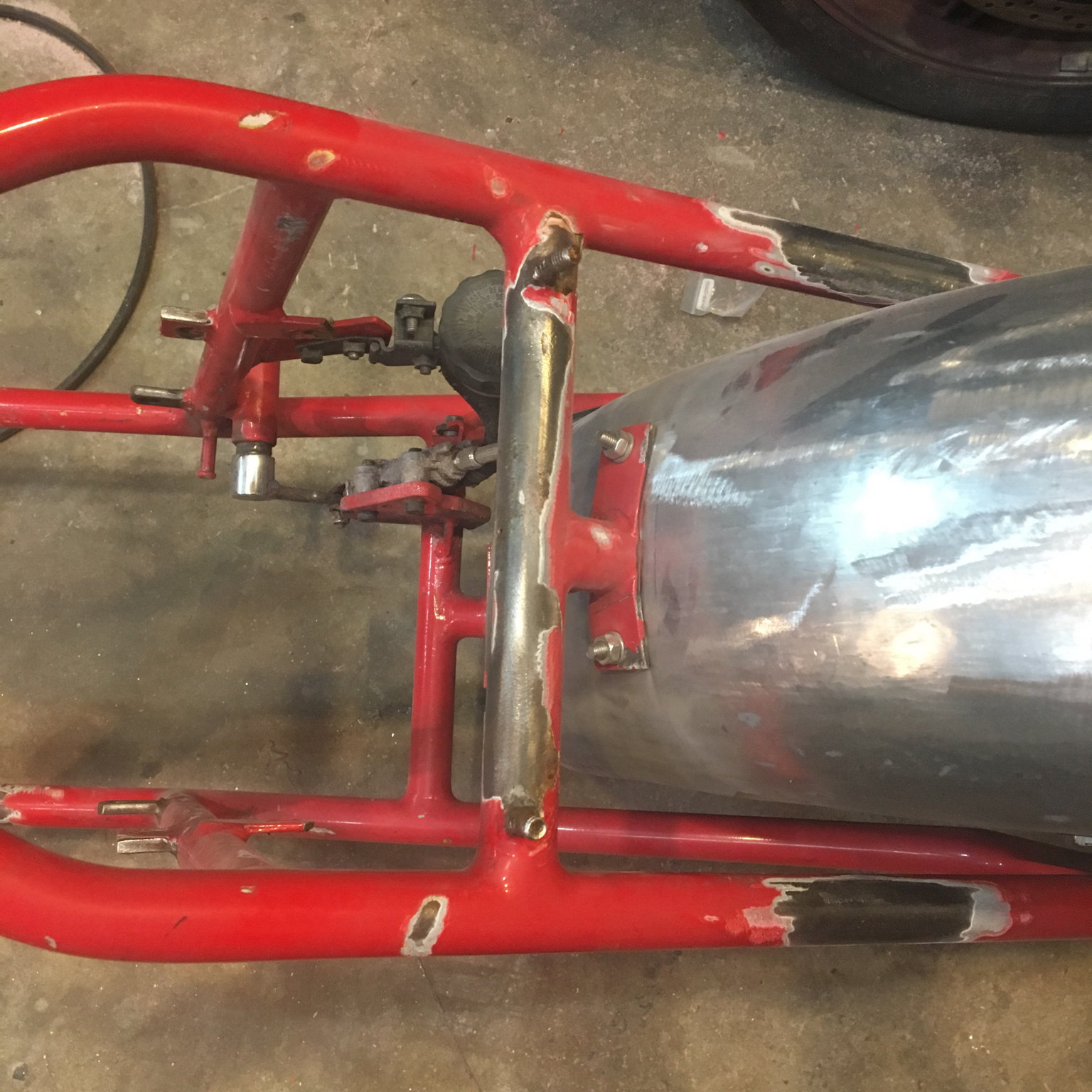

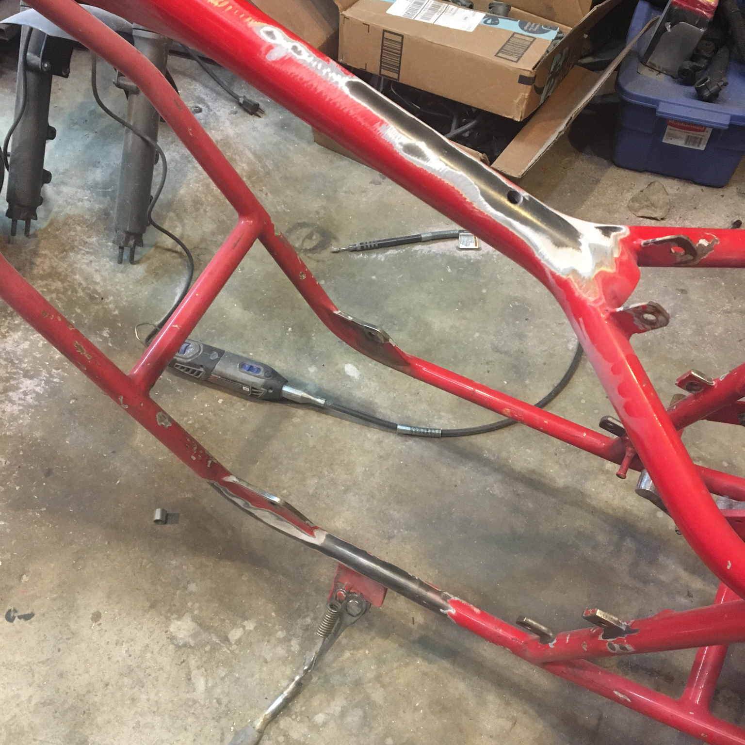

I had a blast with the wire wheel digging through all the bondo on a smoothed out 70s chopper frame in all the usual spots, only to find no numbers. Looks like we’ll do it by the engine number...

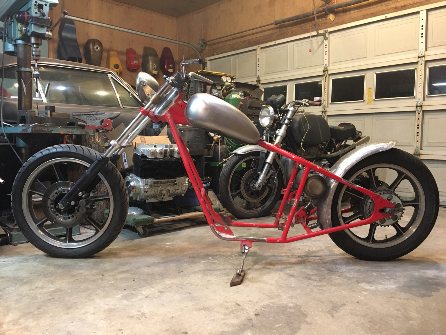

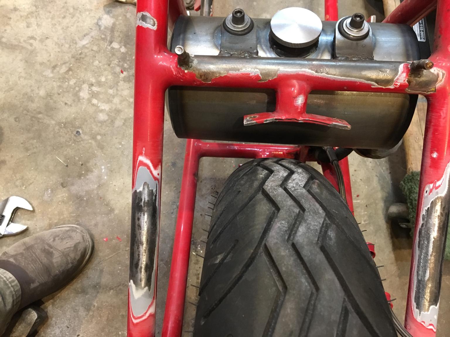

I changed my mind and decided to run a dimpled tank. Anything in front of the down tubes runs the likelihood of interfering with carbs/air filters.
