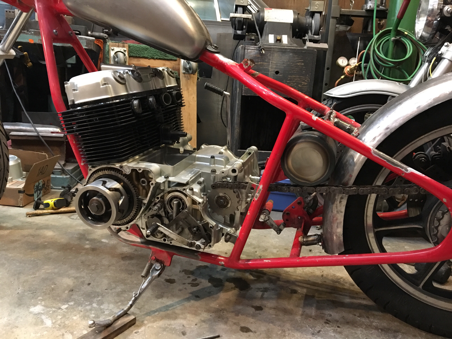

Looks great, nice stance and good ground clearance. Be sure to check chain interference with the oil tank.
If i did my measuring right, I should have 1.25" from the top of the chain as it passes under the tank. What I'm not sure of is how much it needs to cover the bounce. I also have 1/2" clearance to move the tank up.
pidjones said:
Will there be a rear upper motor mount?
Yes. I have to either make or get them made.
Amen frames were supposed to have them, but mine are missing:
The curse of the missing motor mount plates! Fortunately they are easy to make. Somewhere I have a pattern pulled from an OG set if you need it. At one time a couple of people were making them. Maybe White Line Creations in North Carolina! He also makes an AMEN replacement oil tank. White Line is on facebook and was a regular on the Hondachoppers.com board.
