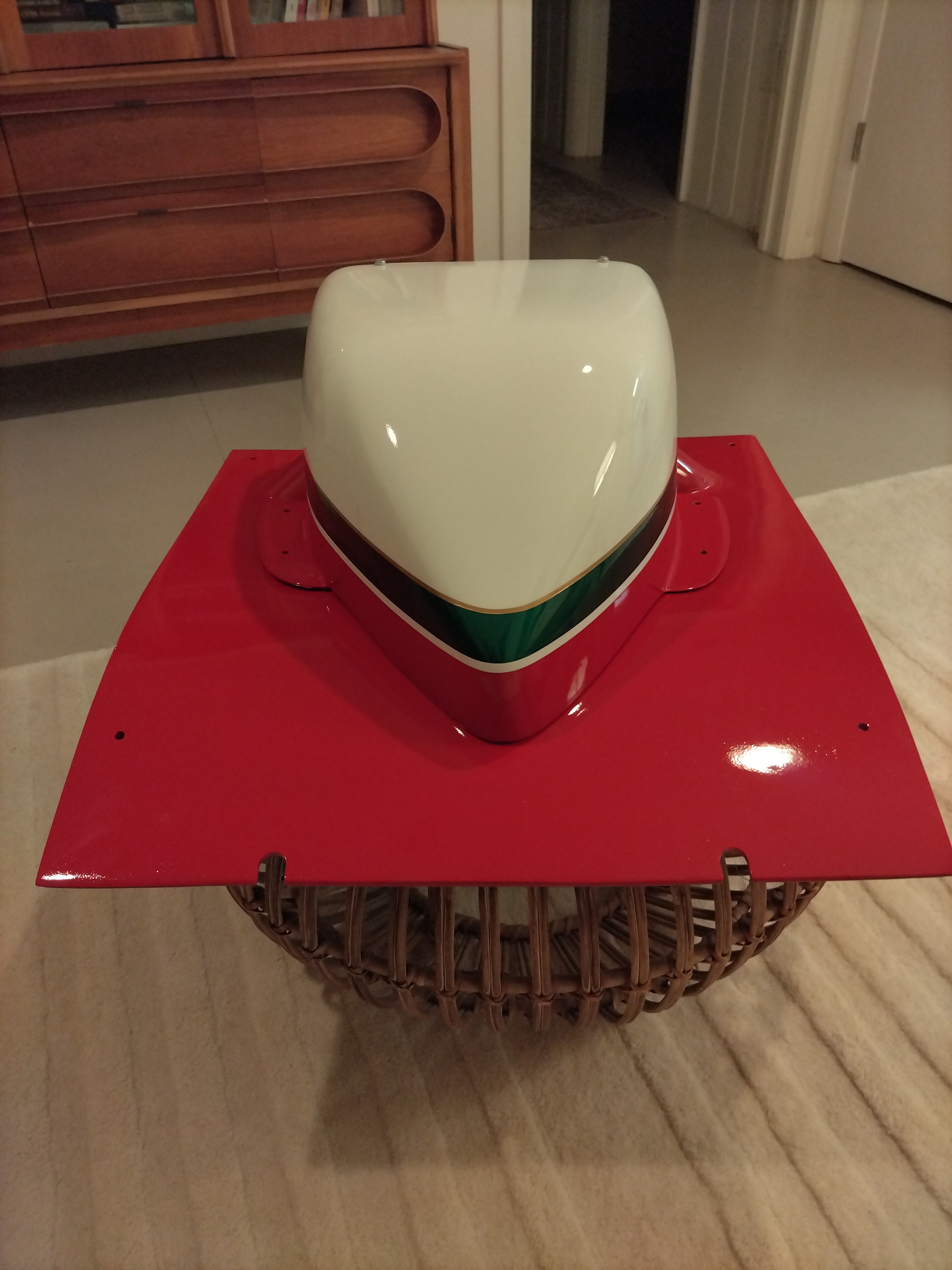

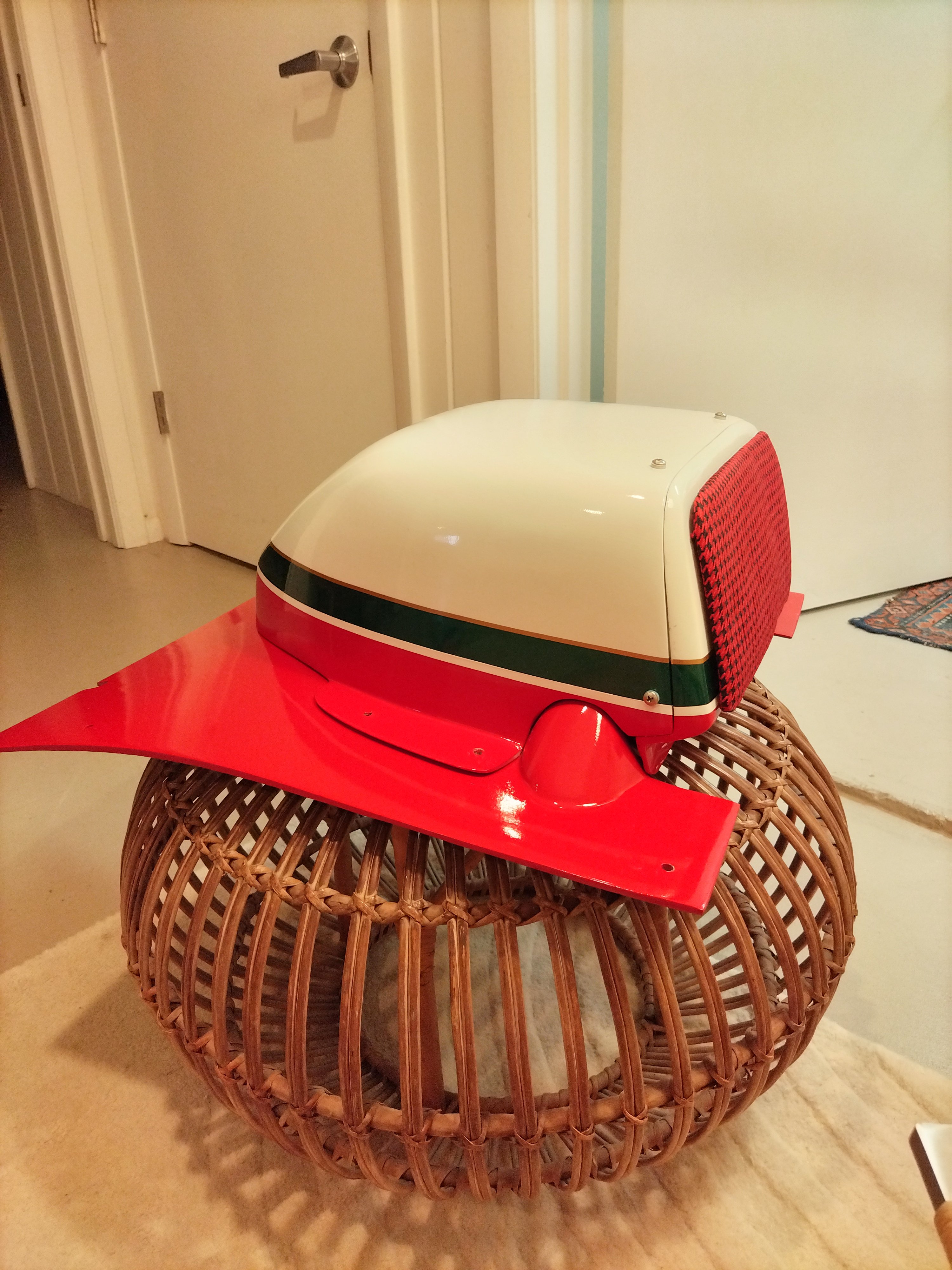

Well the carb cover/headrest, and filler panels have been a real pain!!! Carb cover and deck lid done. 4 filler panels left! Since the carb cover/head rest is oversized I thought I would borrow the theme of the stripes on Nickie laudas 312t because of its oversized air inlet. Not sure I like it but will decide one it's all together.

This is by far one of the most crazy cool projects ever documented on the site - thanks for sharing it in such detail.

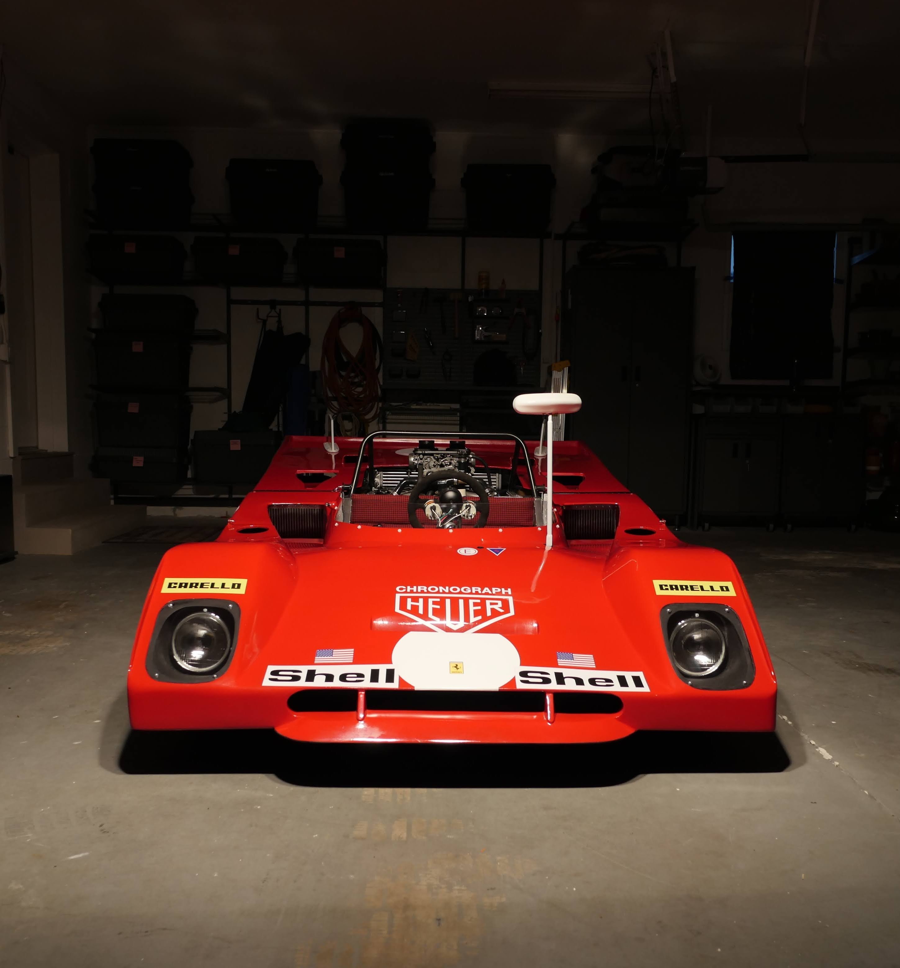

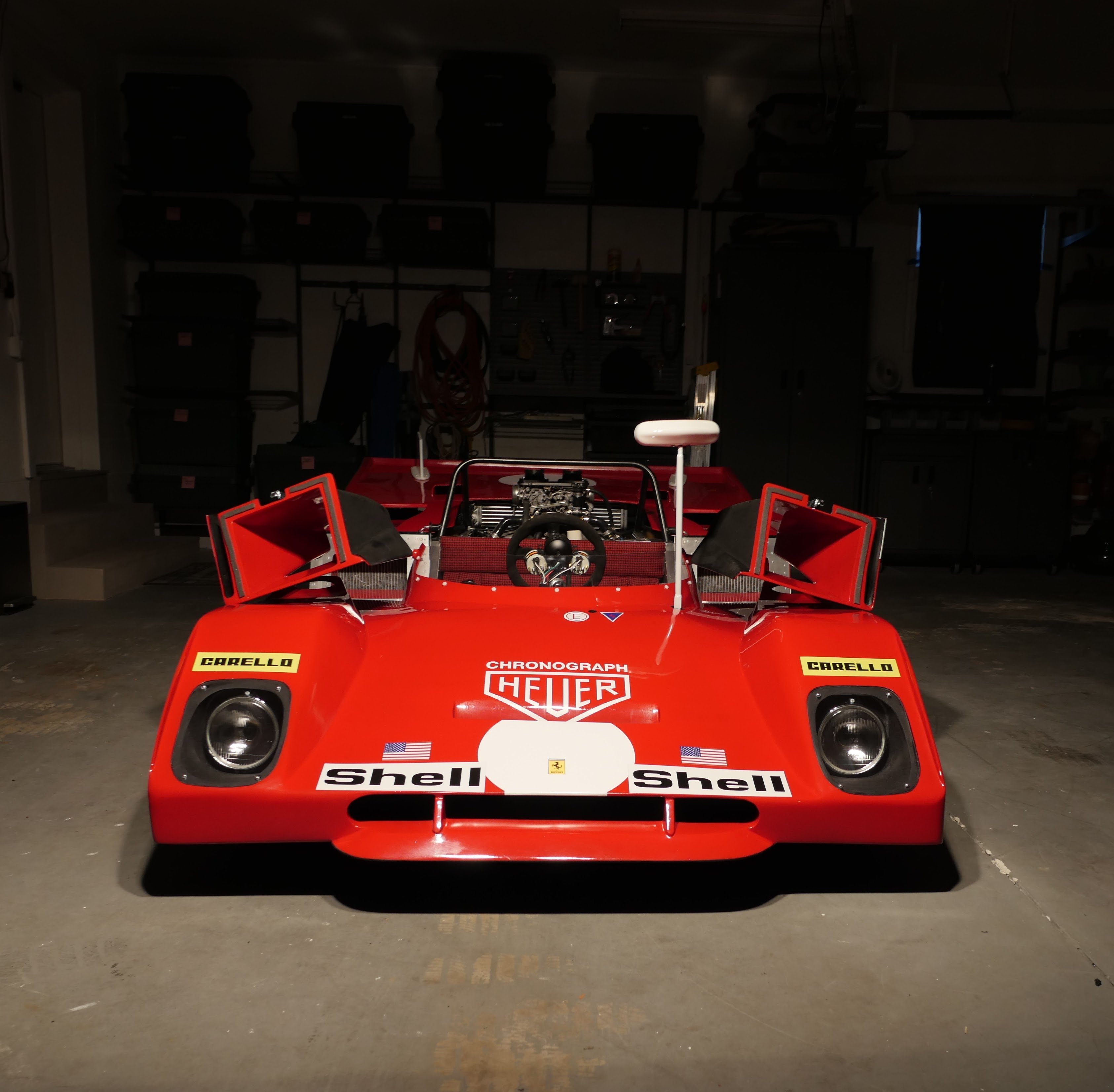

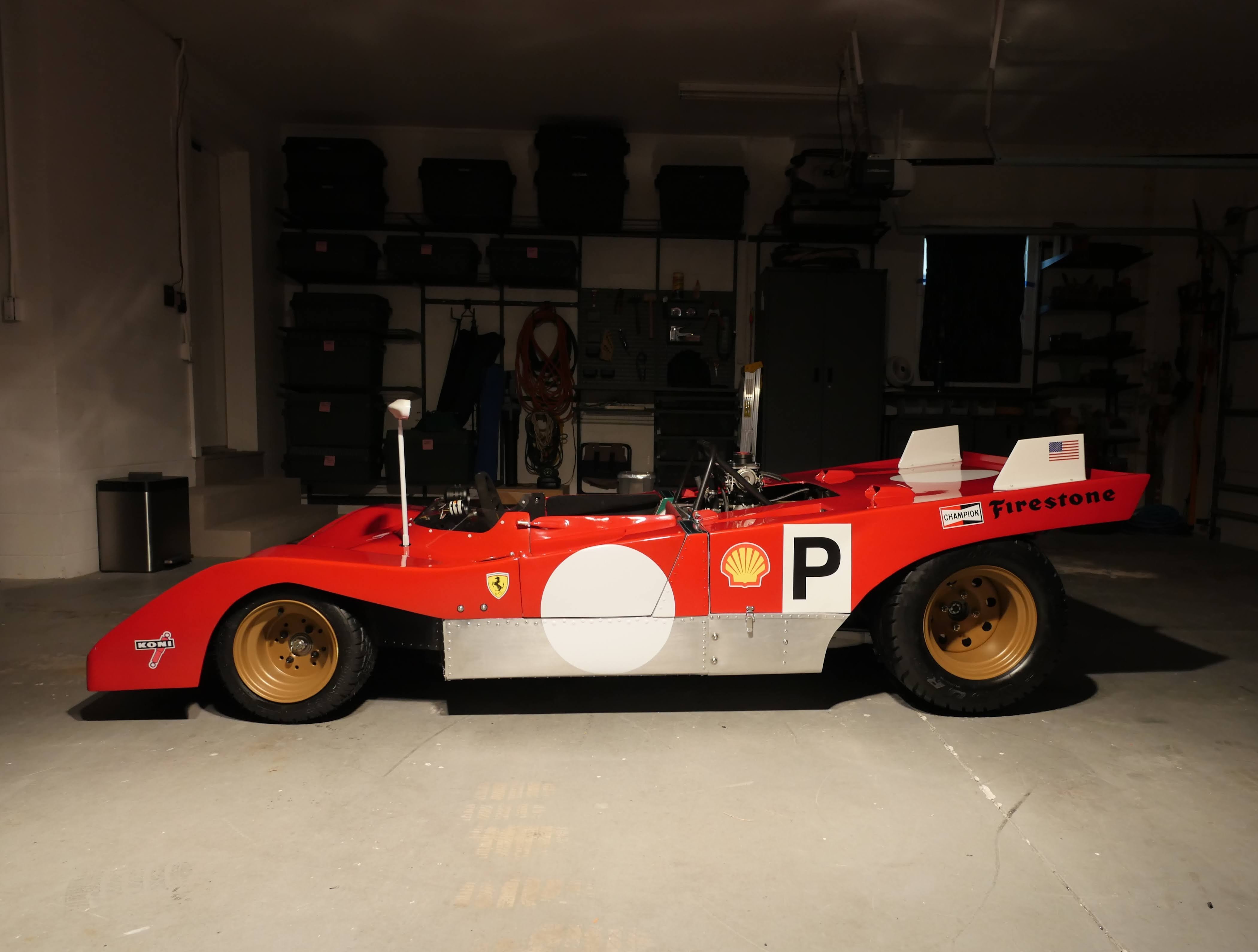

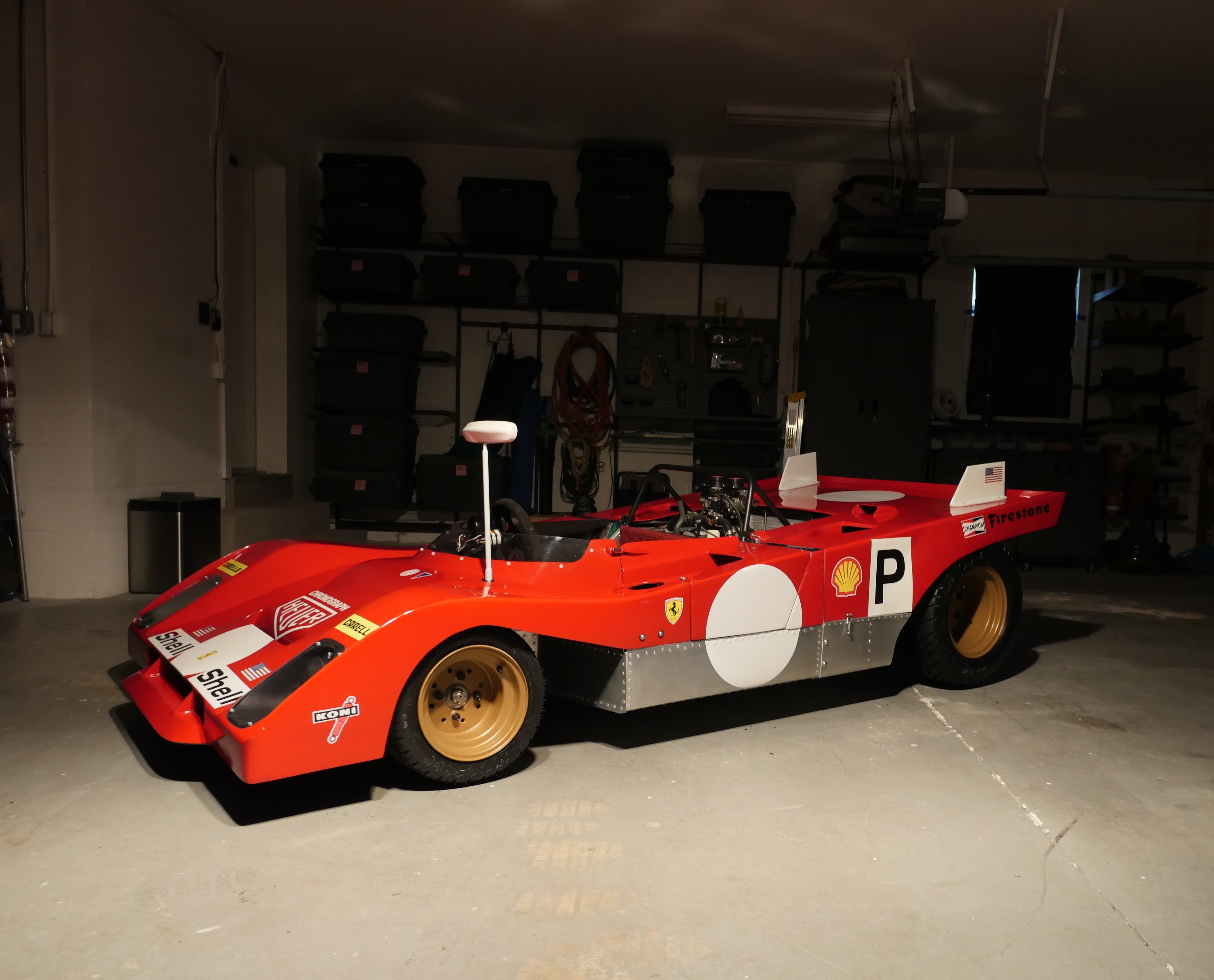

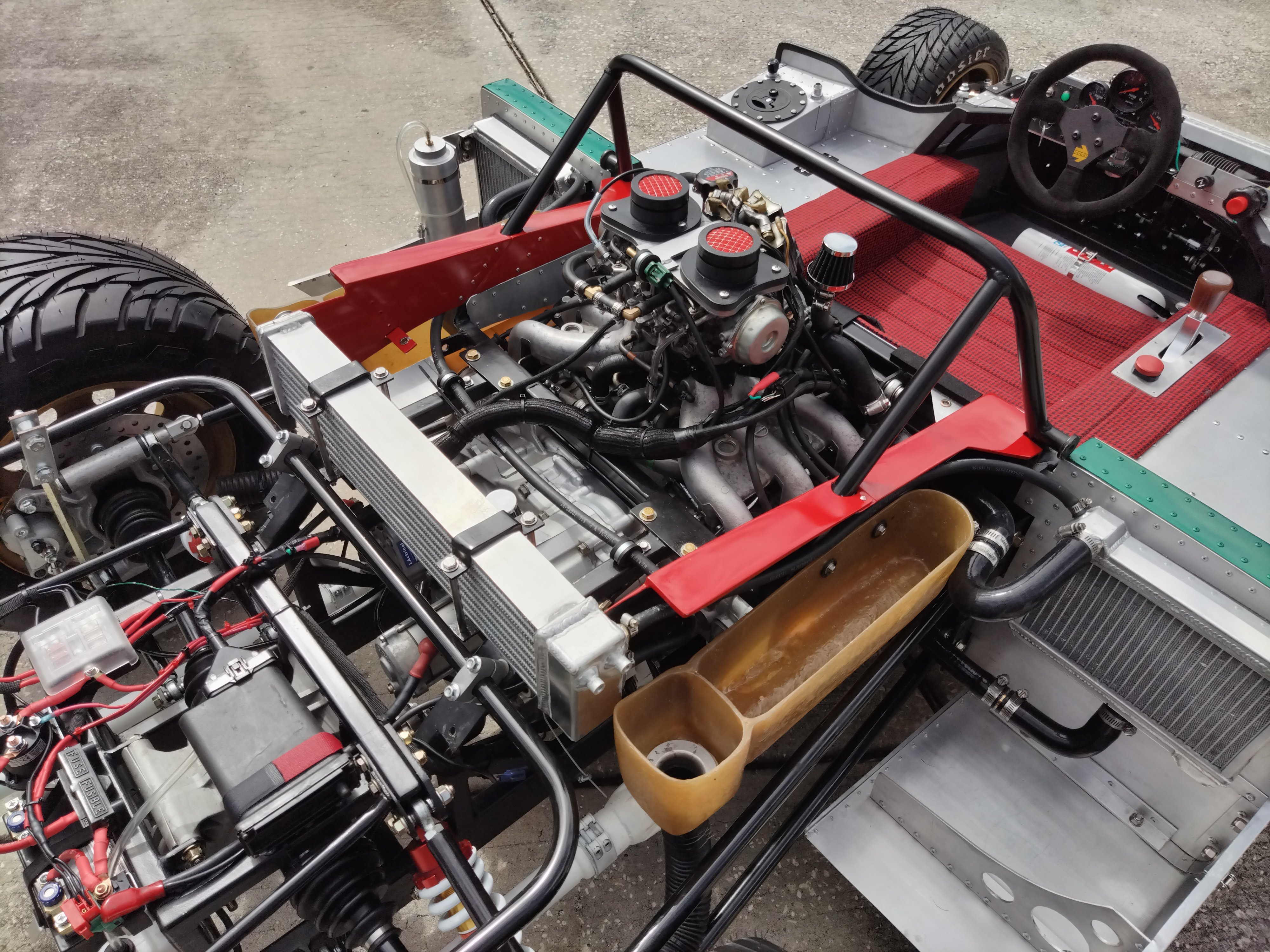

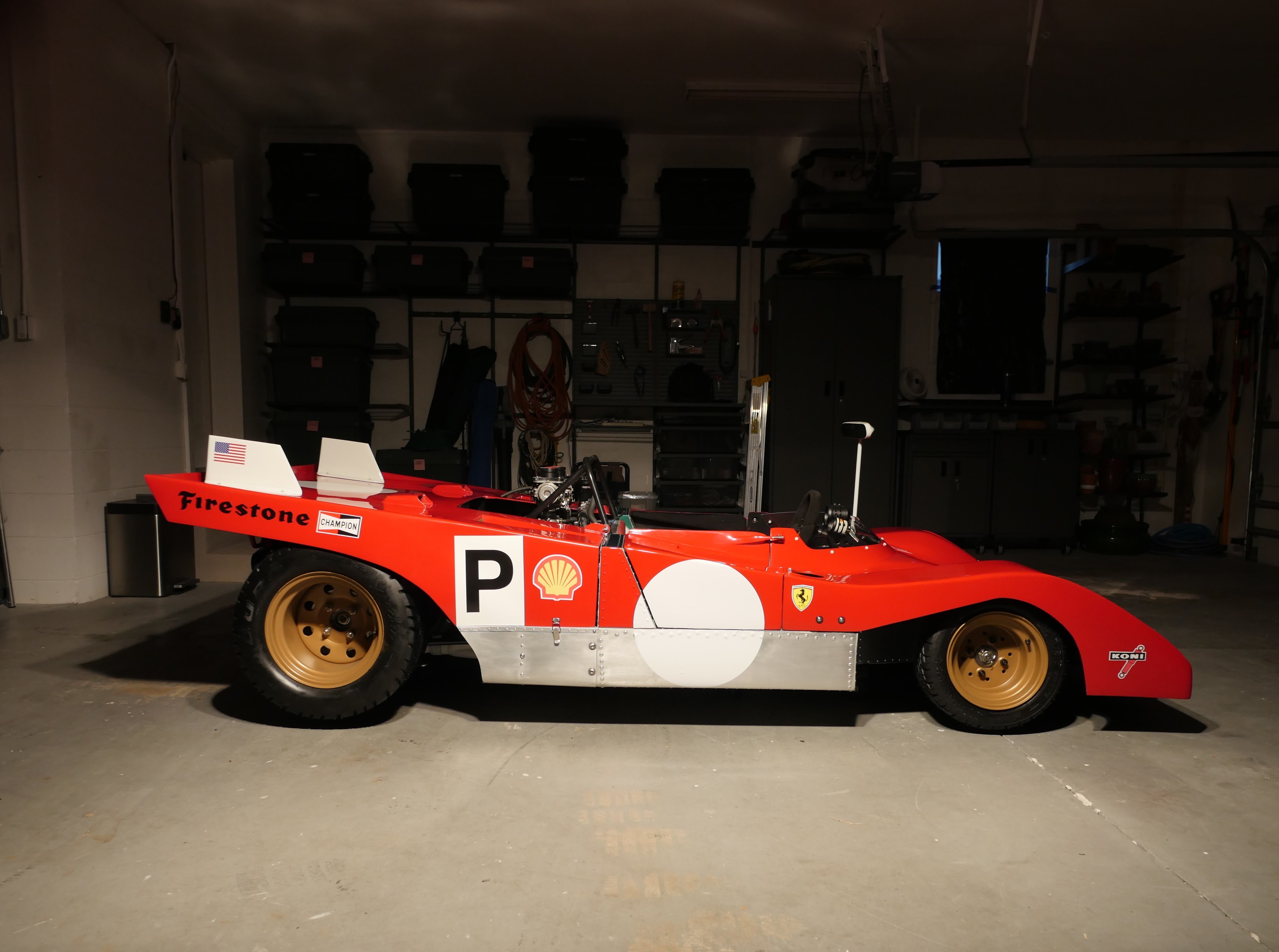

It is done! All wiring, sift linkage, fuel lines, all fabrication done, and brakes and clutch bled! All I need to do is clean it up and put the body work on tomorrow!!! I drove it out of the garage into the driveway yesterday!!! That was rewarding enough. Trying to find a trailer to rent to get it somewhere to really drive it. Put it next to my station wagon just for kicks.
Ya need to hire somebody to rob a bank or start a riot on the opposite side of town to keep the police busy and then just cruise around your 'hood for a bit. :rolleyes:
The problem is I have been building it in my mother-in-laws garage and she lives on a busy road, good news is it has to be out next weekend so she can paint the floors. I will have a video up next Friday!!! I can't wait!!
Test drive#3. Had to remove air cleaners the where blocking flow to some circuits, luckily 2 strainers from the grocery store with the handles lopped off bolted right on!
you should be able to find some foam for those if you are going to be driving in any dusty situations. The screens will support it and keep it from plugging up ports/jets.
