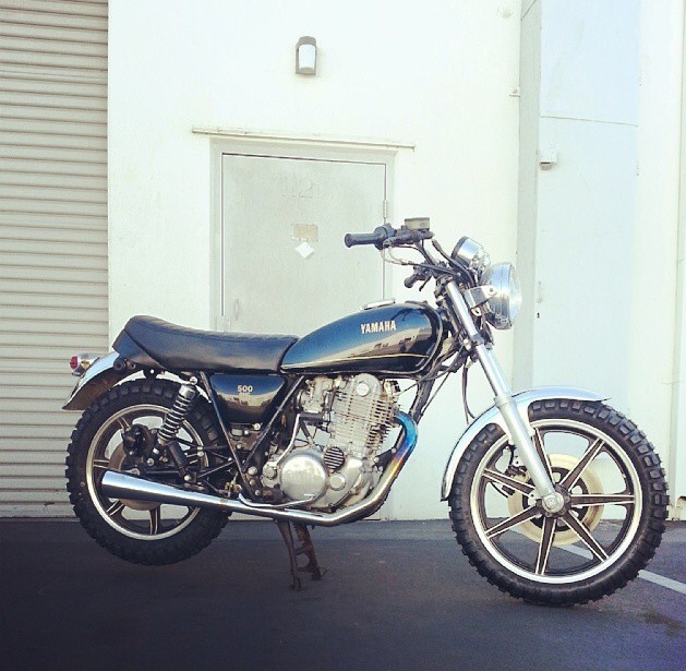

I was pleasantly surprised to find the bike has a K and N filter already on it.
also worth mentioning, the side covers need some love if they are going to fit properly.

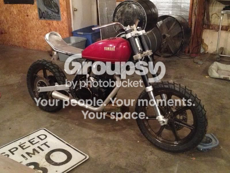

And on the other extreme the ground clearence on my tt
