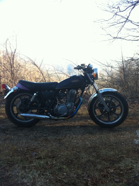

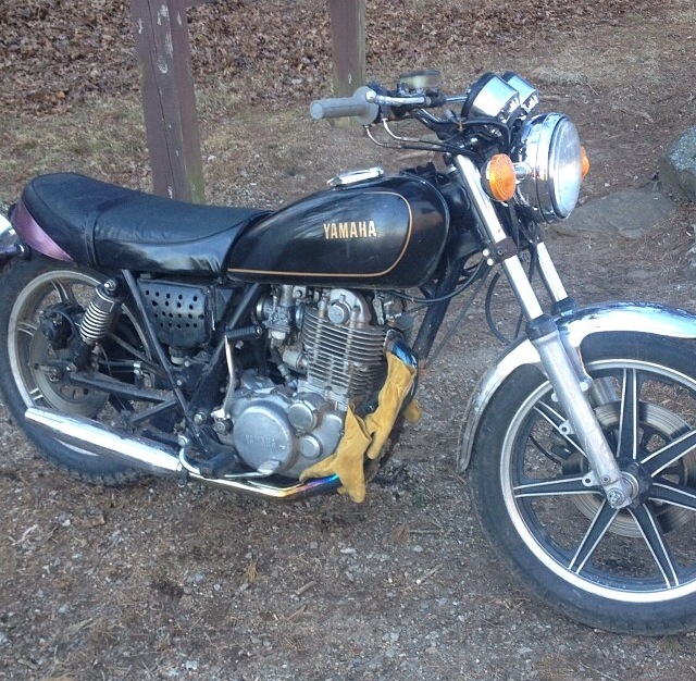

She did well. no breakdowns. But my shocks are toast! check out the pics!

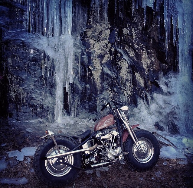

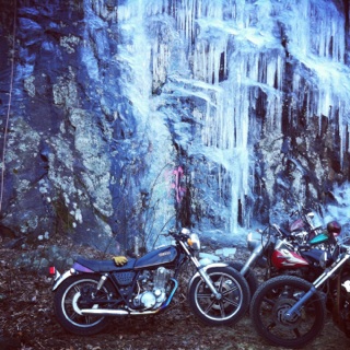

Here are some more pictures, of the other gnarly bikes!
The knuckle head is Phil's, and the black shovel head is Ben's.
Also, if you are on instagram, check out the #choppercross for many other pictures.
