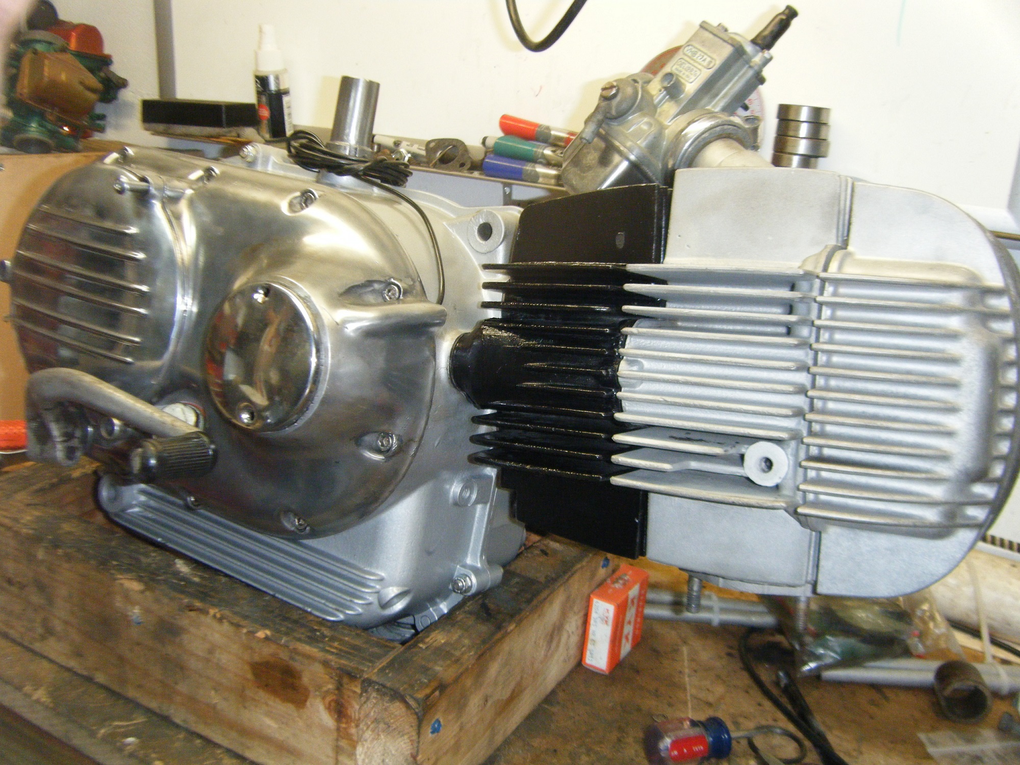

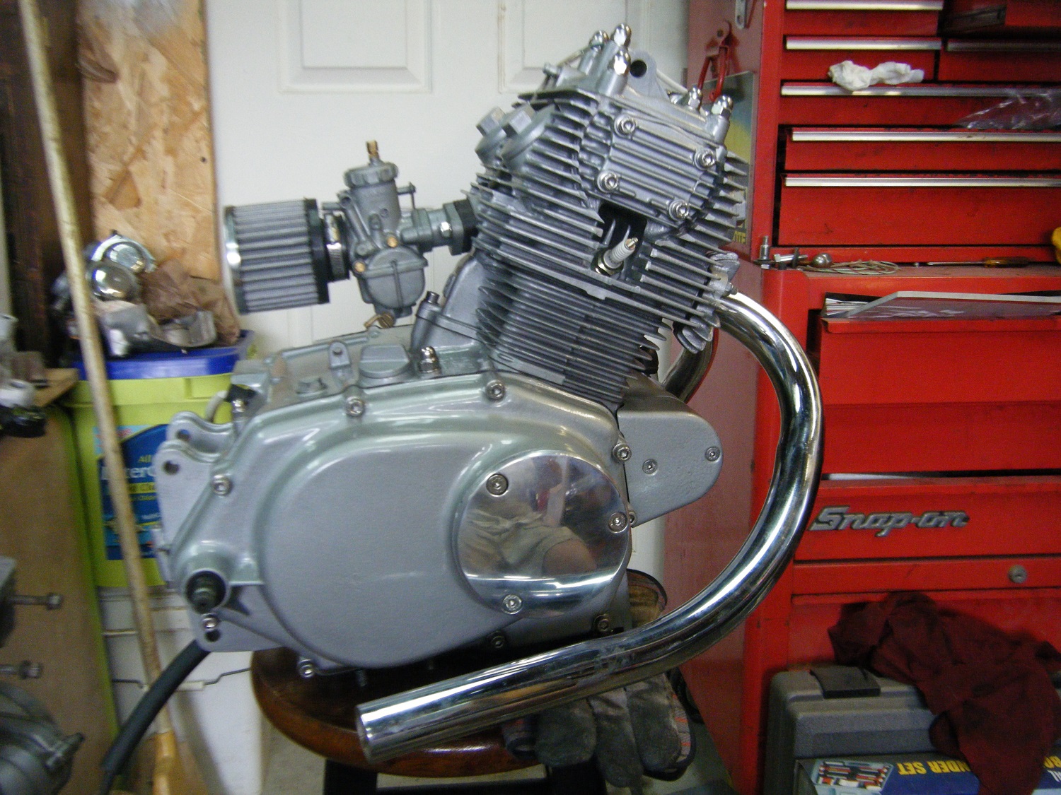

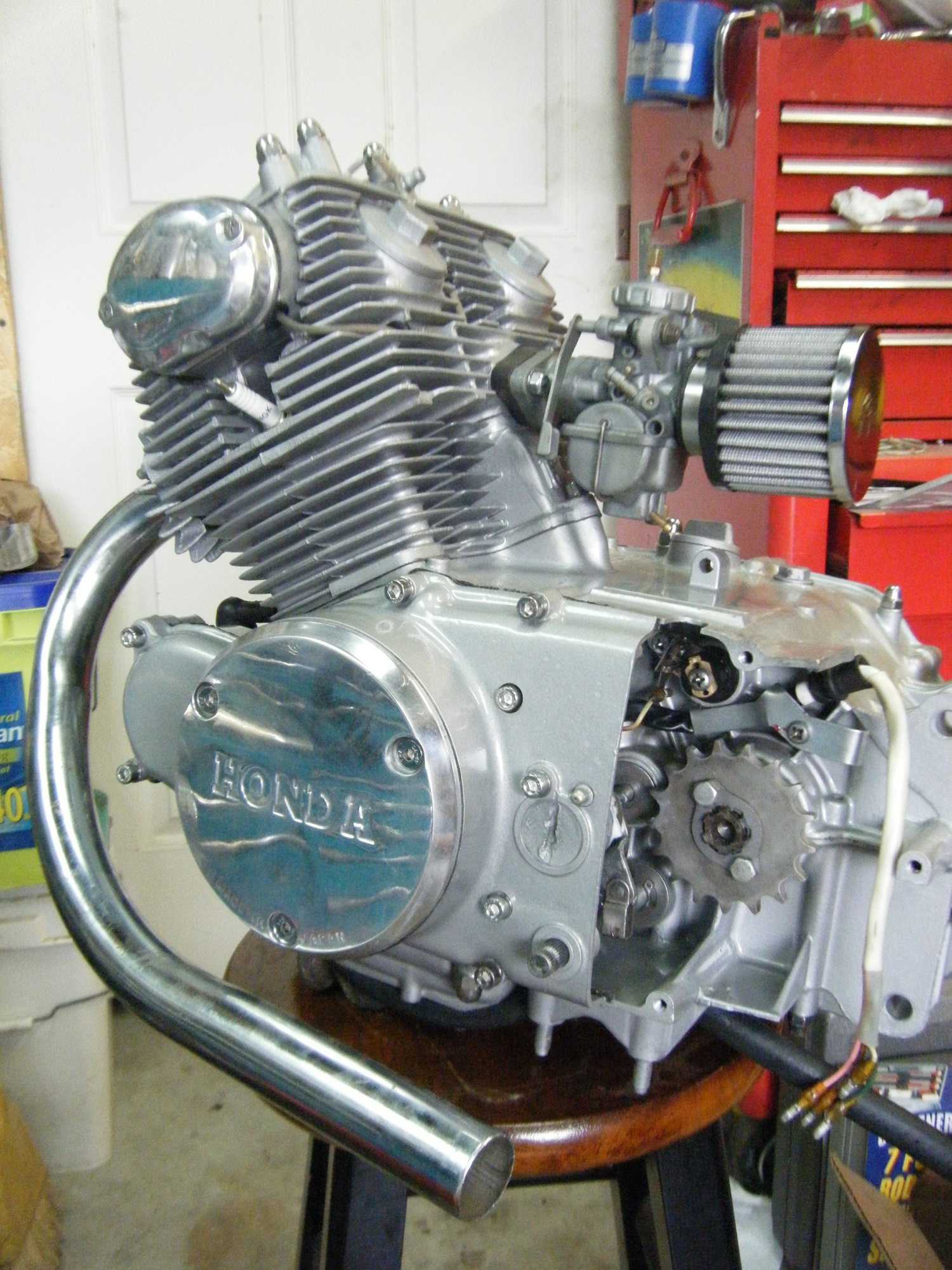

Here are a couple of my engines using the Eastwood ceramic paint in universal Al. Sorry these aren't "haul the ton" engines~
The first and Aermacchi 350 the next CA160 engines. Hope you like em.
Larz
