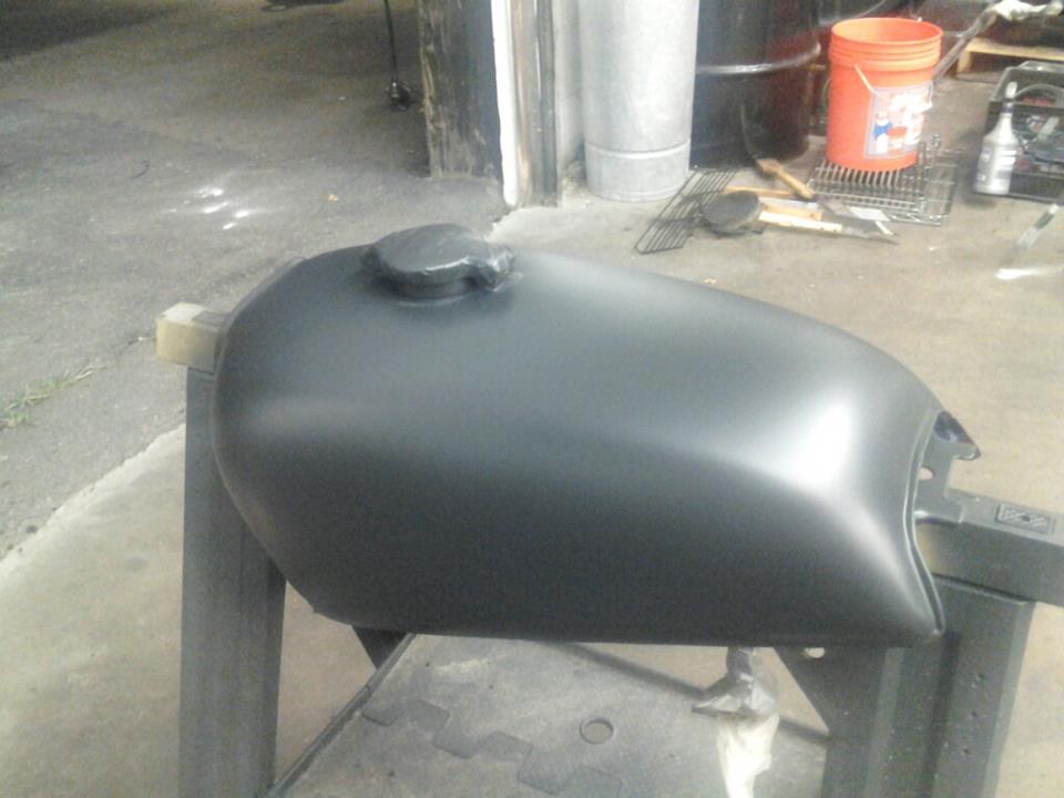

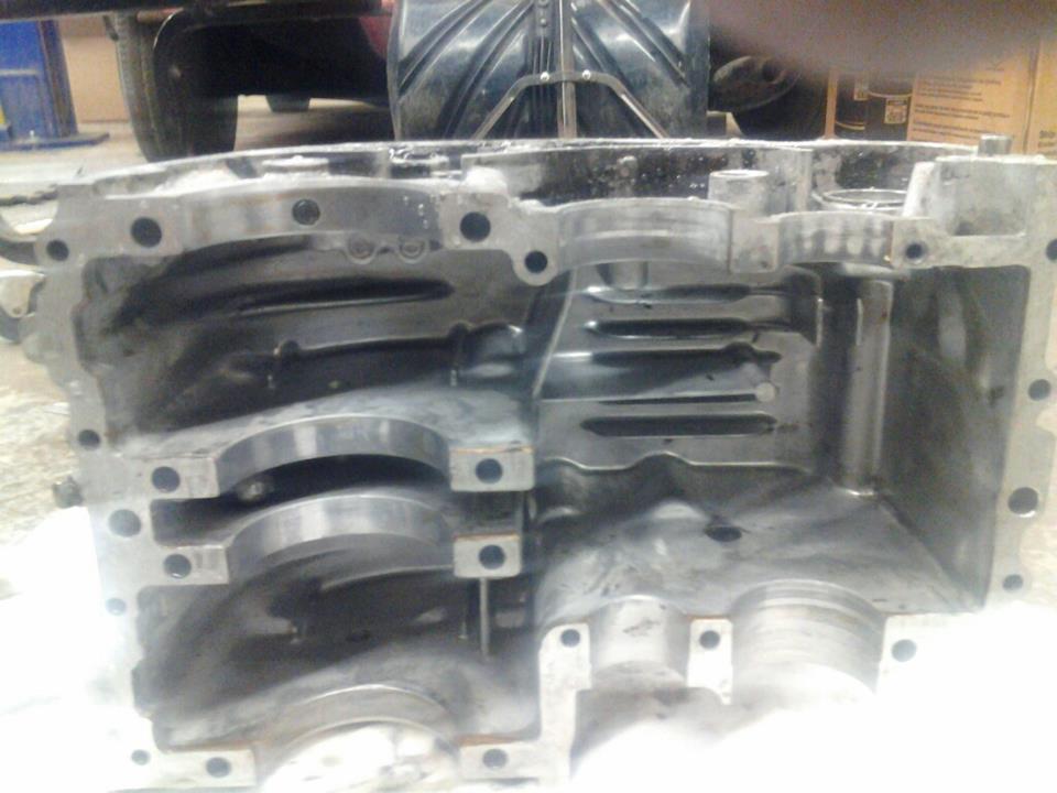

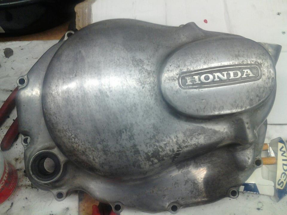

So the guy that gave it to me said it needs an ignition and air filters. I am doing all the work I am capable of on this build but my cousin is a mechanic/welder/autobody guy who owns a shop with all the tools! He is doing work I am not capable of and helping me with the rest. So got the ignition and some k&n style filters. We got it fired up but something was wrong with the kickstarter mechanism. So my cousin decided to pull the engine which excited me because I wanted to get to polishing! So I need a new "ratchet guide plate" and now of course new seals and gaskets. This is where I am at now. Started wetsanding the crankcase and clutch cover. Scraped out 1" of goop in the bottom end. Also rattle-canned the terrible purple tank flat black. Just for now I haven't decided on a color scheme yet.

Bottom end clean but needs some love to clean up. Crankcase and clutch cover after wetsand before polish.

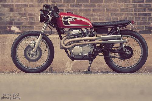

This is what I am going for. I am however going to do a 3" ext on the swingarm and a tail hoop/frame ext (dime city). I will get to the pipes and I love the scrambler style but I want to do the shotgun style wrapped. I am thinking tracker or euro bars. Going to get rid of stock tach/speedo and get the speedo on the front fork from cycle x. I got a gel battery and am going to remove the original tool box and put the battery as low as possible. Also fabricate somekind of side covers not really there yet. I have a long way to go and this build will probably take a while due to not having shit tons of money all at once. So next up is fix the ratchet guide plate and put the motor back in and get it running proper than tear down and do the swingarm and seat than paint and all the rest.....I think I am not sure the order of what to do. Any thoughts are definitely welcome.

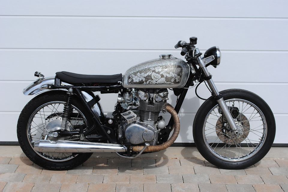

I've always liked the look of this one
I think I need to find a CL tank ;D
Re: First build 75 cb360 tracker style bratish.
Pj that is a sexy bike! Solo seat is not for me though. Whats that container-ish thing under the seat. Battery electric box?

I presume it is?
it's a pic I saw on the net a few years ago
I think it may be a modified 100 tank, it looks smaller than CL

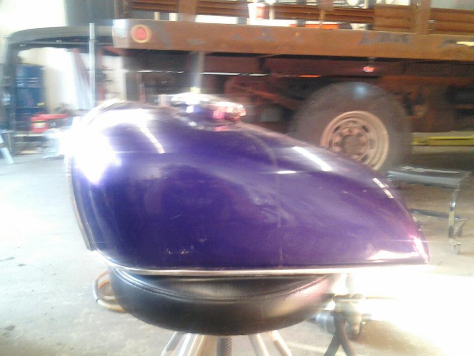

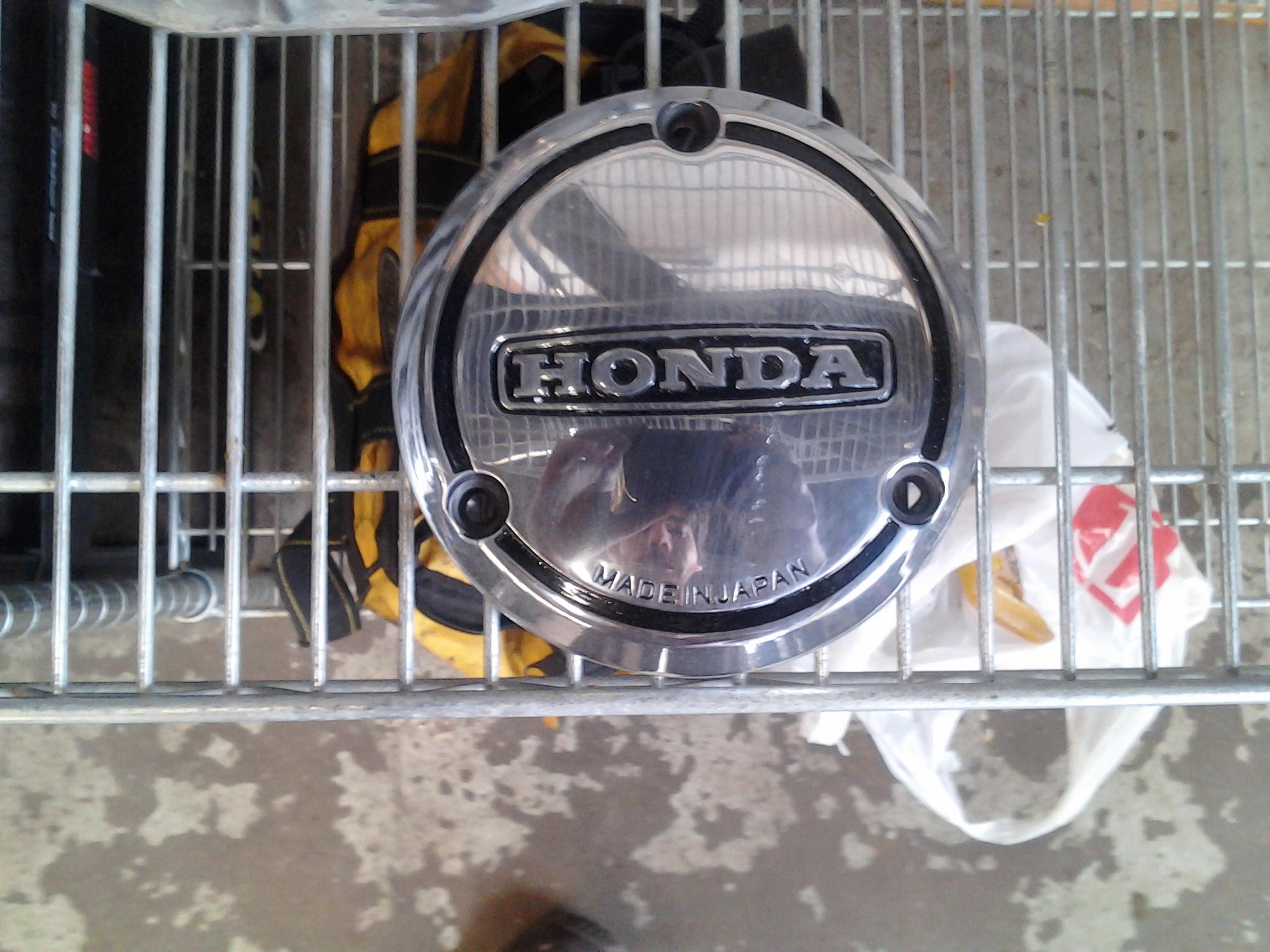

So this build is going to be on hold til the riding season is over. I had to get rid of the purple. Painted the tail light bracket and front fender flat black. Rattle can! Polished the covers to the best of my ability. Fixed the kickstarter problem and put new gaskets and seals on the bottom end. Going to degrease and douche the frame than she'll be put back only to completely torn do wn this winter. I will post more pics when she is together and running.
