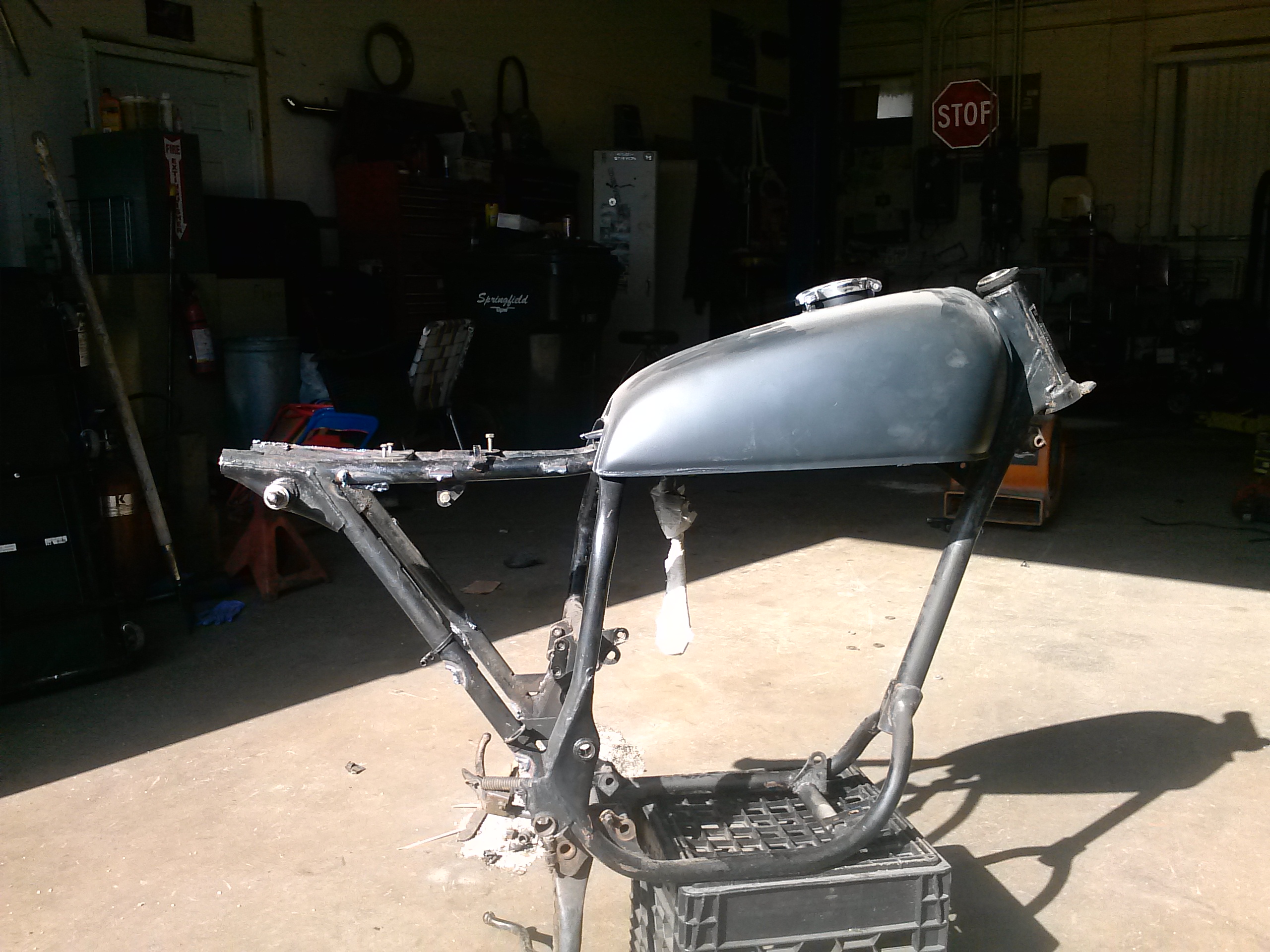

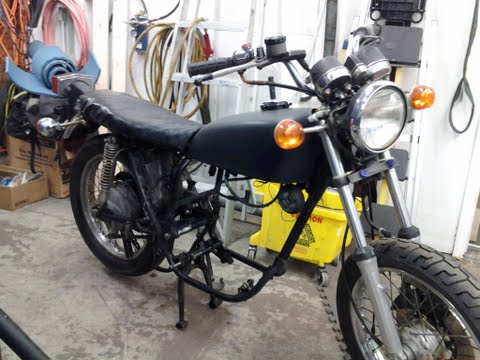

So got up today with good intentions of getting the legal stuff done on this bike. Went to the registry to get my permit and there was a 2 hour wait in which case I would not make it to Maine to get my title situated. So I left and drove up north only to find out that Maine will not title a bike older than 25 years. So my plan is to have my cousin register and insure it in Maine and just drive it here (in MA) for the summer than have him give me a bill of sale and the registration to switch it over to my name and state. So essentially I accomplished nothing. >:(
After that I felt like I had to do something so I ripped the leather and foam off of the very worn stock seatpan got some sleeping bag mat foam and went to the shop. The seat needs to be tightened up a bit but here is a pic with the tank and seat mock up. Nothing is bolted so it may appear a little askew. This is not where my final build will end up this is just to get me through the summer and than a complete tear down and rebuild will commence.
Here she is as she sits now.

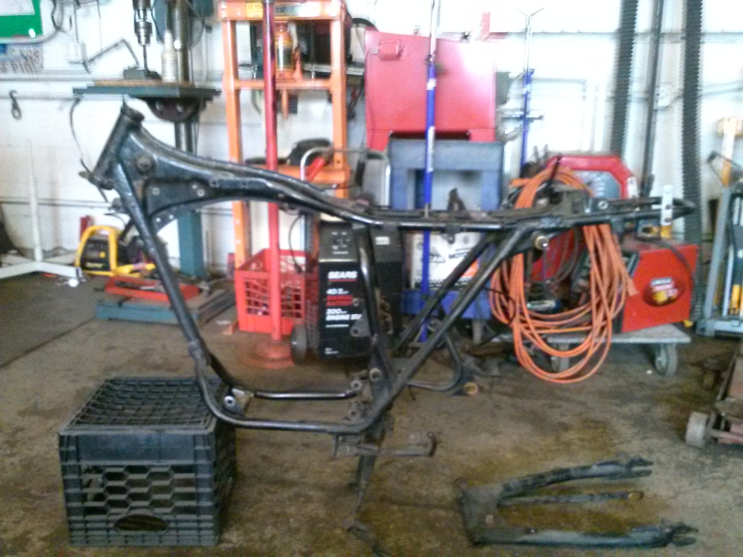

Finally getting somewhere.....de tabbing swingarm ext and rear hoop up next.

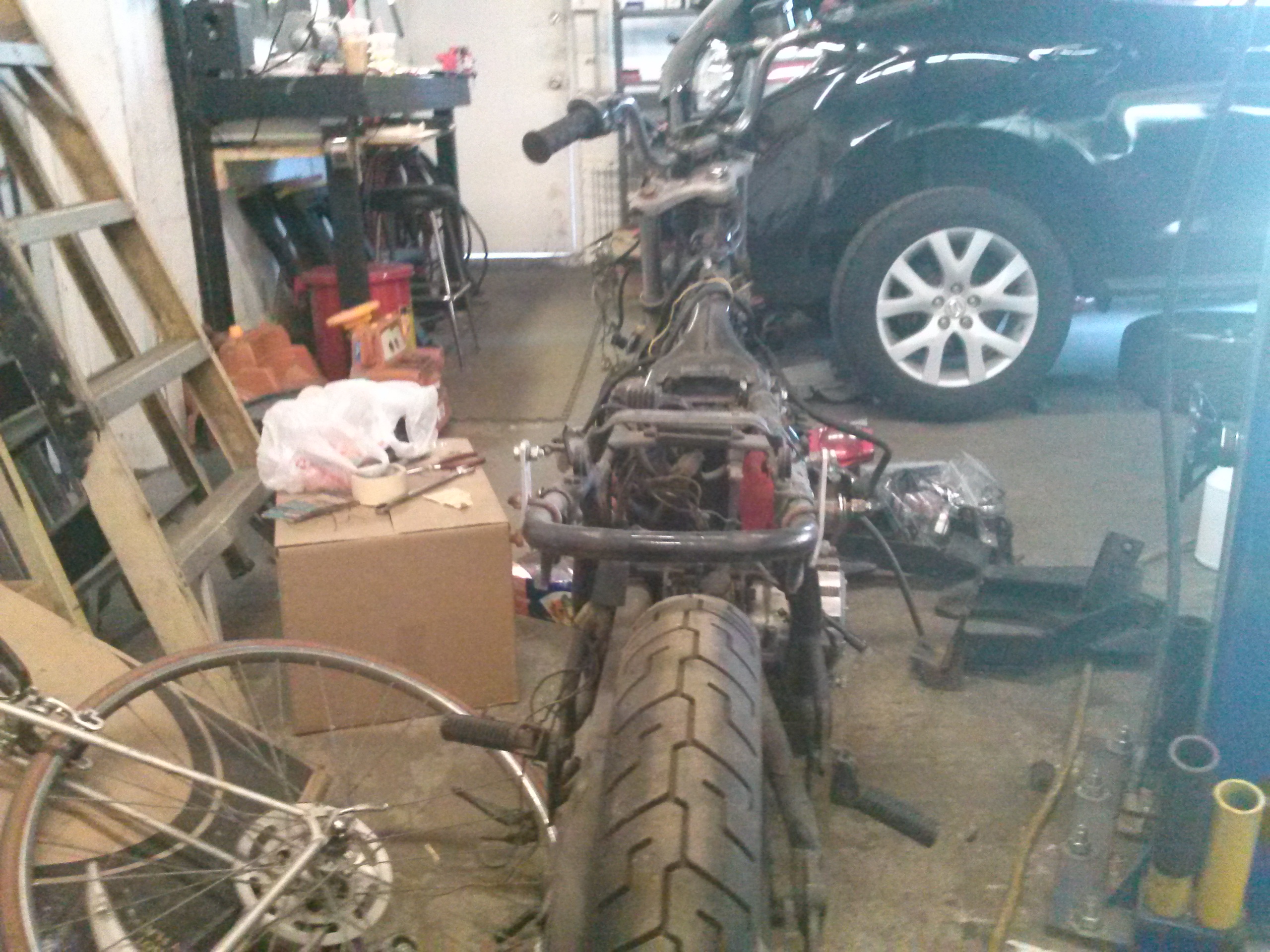

Slowly making progress. Detabbed the fram some. Cut off the footpeg mounts. Going to put a rear upswept hoop on after i finish up some grinding. Here is how she sits.

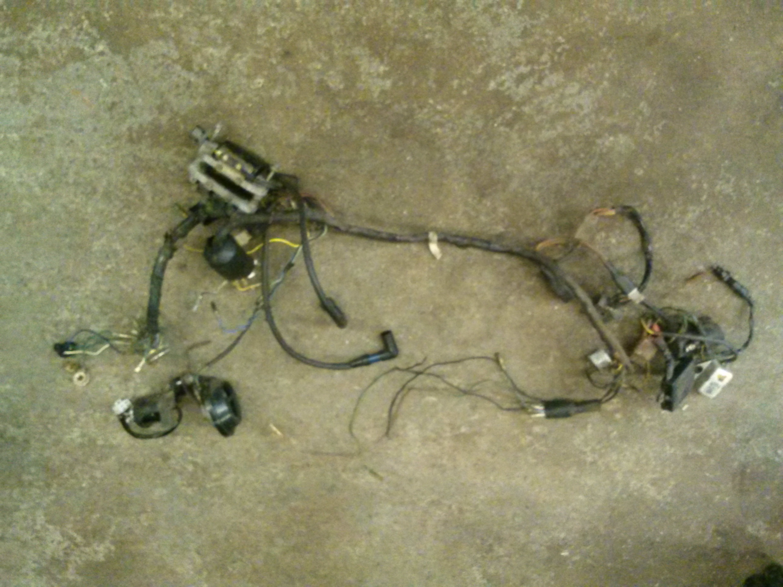

Wondering if I could get some electrical advice or help from you awesome peoples!? So I have the wiring harness from the bike but I want to have a kick start only with just the bare essentials, head/tail light and directionals. Can't think of what else I might need. I have never rewired anything. Would it be better to make a whole new harness or use the existing one? What type of battery would I need? Condensers/relays etc.....pretend like you are explaining this to a retarded person. I literally have no idea but I want to build a small box under the seat pan to put everything I might need.
Thanks in advance
Jim
I would make a new harness, it's actually easier then modifying the existing one.
I use 7amp hour battery with kickstart and a newer regulator rectifier (1980's CB400T) unit wired into all 3 generator outputs, use standard Honda colours to wire it in)
You need points, condensers, coils, and whatever lights/switches your using but only a single 15A fuse
Red up to ign switch, black back down to power everything (it will also need connecting into brown IGN wire)
