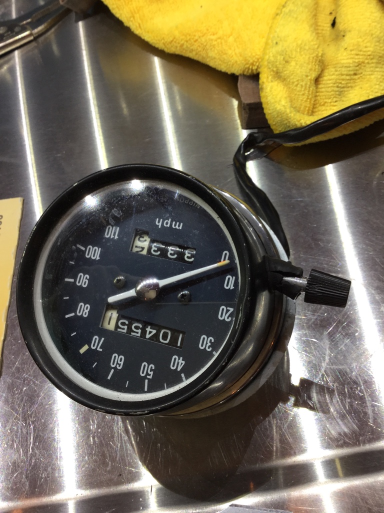

New problem: I'm disassembling my gauges to clean them up and replace the faces. My issue is that I can't seem to get the trip-meter reset knob off. I read that it's reverse threaded, but turning in either direction hasn't yielded any results. There is no set-screw. Is it press-fit?
Unrelated to recent posts, but my knob was press-fit and HAD to be cut off. Sometimes you have to get out the tools of destruction.
I'll plan to figure out how to source / commission a machined brass knob.
