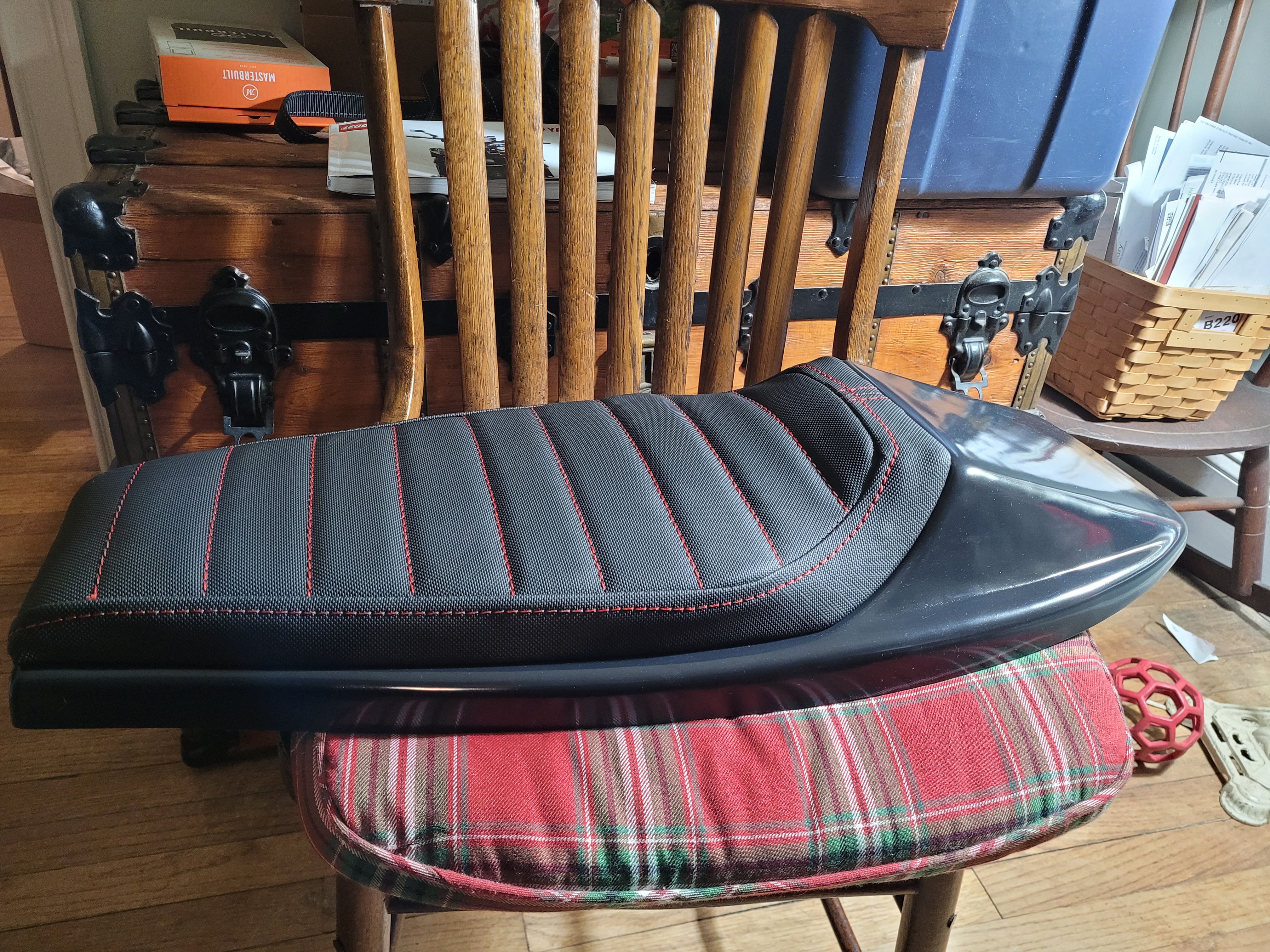

My seat got delivered today. I thought it was a British company but it actually was from Greece. It's a nice piece. I've bought a lot of motorcycle stuff from Europe and it's always been successful. I think I've officially moved on from a cafe racer build to a tracker.

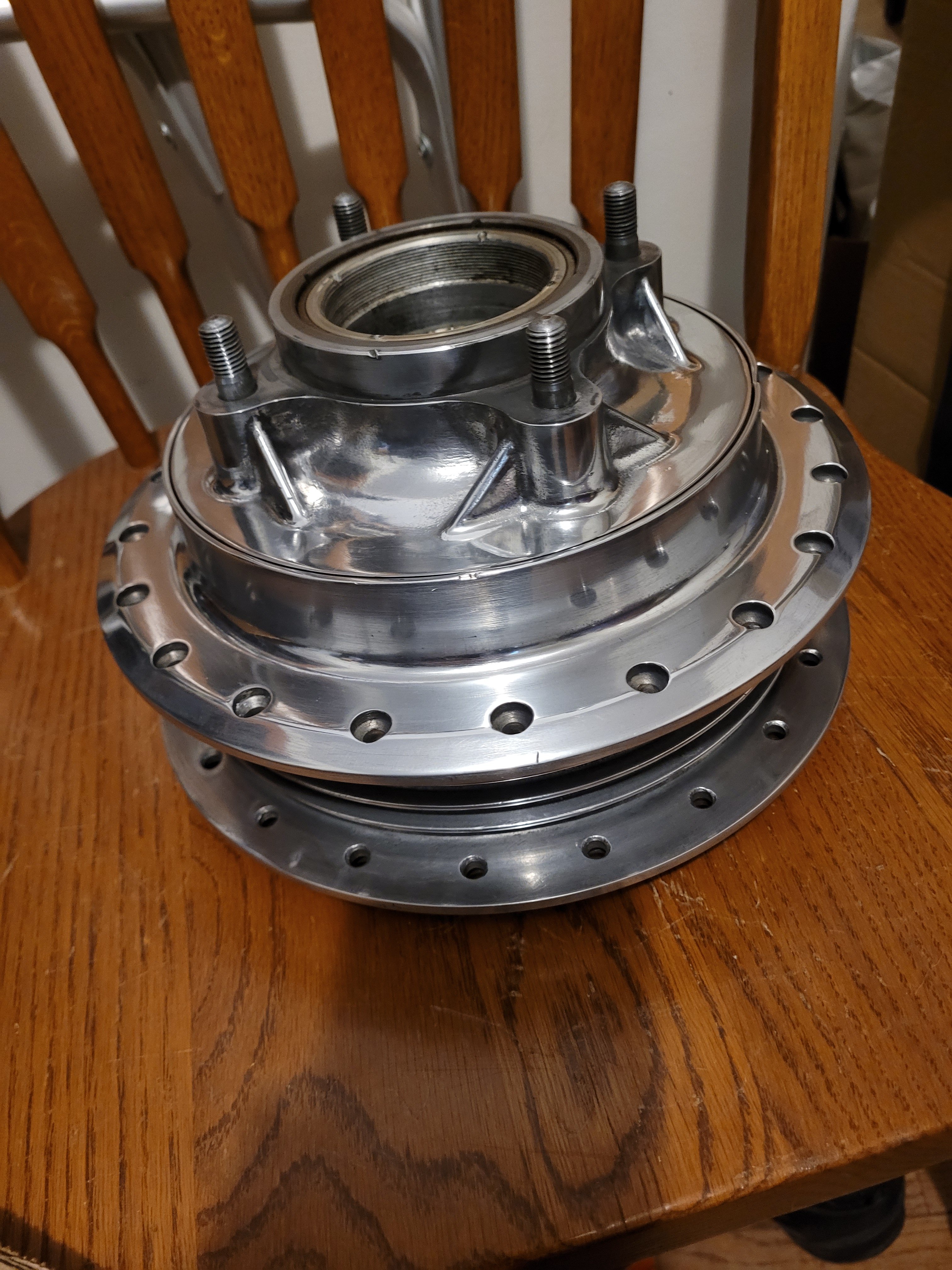

3 Saturdays and 2 Sundays of work to get the rear hub sanded and polished. Most of the cafe racer builds I see have the hubs painted black. If I was willing to paint it black I could have finished it in a couple of hours. I still have to do the plate with the brake in it but it's just 1 surface so not an ordeal like the hub. I have new aluminum rims, bearings, sprocket and brake shoes. About $200 worth of parts to build the rear wheel.
I didn't take a picture of it in the original condition but a couple of progress pictures and finished one.

You did a nice job on the hub. How well did the special tool work? Did you get it from Carpy? I've been looking at it as a single item replacement for multiple tools. I suspect the average wheel (spokes, bearings, rim, tire/tube and lacing/truing (If the owner can't do it) costs about $400 each wheel. Added fasteners, sprockets and other bits will push the price higher. Polishing, paint, powder adds more cost and time.
Thanks. The special tool worked well after I struggled for an hour with no success. THEN, I decided to look at the shop manual to see if it was a left hand thread. It makes it a lot easier. I got it from common Motor. Carpy is a cool guy but IMO his shipping costs are insane. I'm not paying anyone except for the powder coat, paint, and a friend who is a welding artisan.
After 3 weekends, I got the brake plate polished and am done with the rear hub. It sure is a lot of work polishing out aluminum parts. Some how I lost the new wheel bearings and had to buy another new set. The brake shoes & sprocket are new. They came in and I also bought a truing stand. I've been working on motorcycles since I was a kid and I guess it's time to learn how to true wheels.
