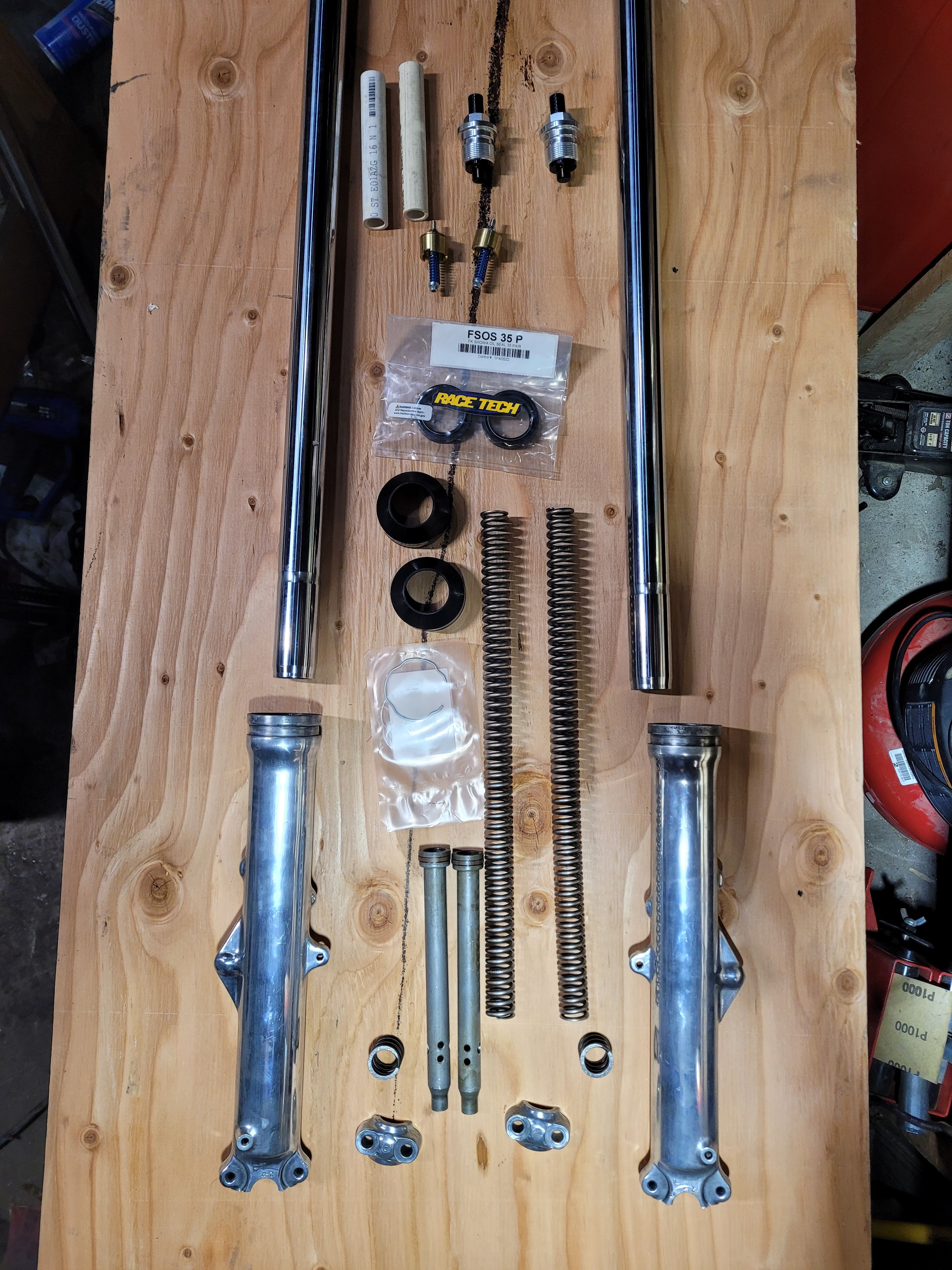

On to the forks. Every part is new except for the lower tubes and the damping rods. The brass thingies are Racetech cartridge emulators. They just sit on top of the damping rods and flow oil like modern cartridge forks. The only modification required is to drill a few additional holes in the damping rods. I'm also adding preload adjustable caps. They'll never perform as well as modern forks but they'll be a good as possible while keeping the stock look.

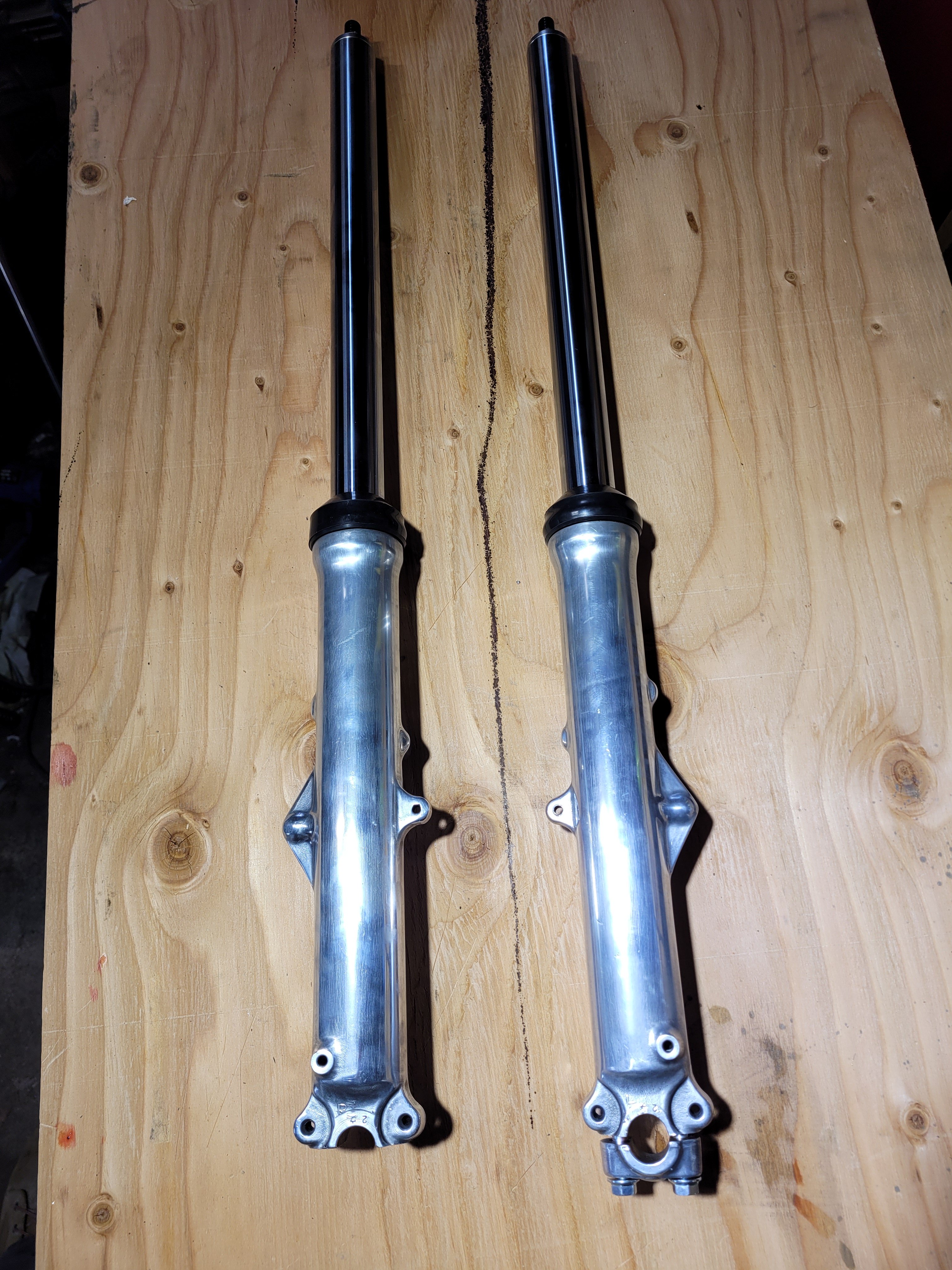

It took me 2 days to disassemble, clean and then sand and polish the lower tubes. It took me a little over an hour to put them together. The only reason I didn't finish is because I don't have the correct weight oil. Except for the caps, they look completely stock.
This is the picture of all of the components ready for assembly and a picture of the finished forks.

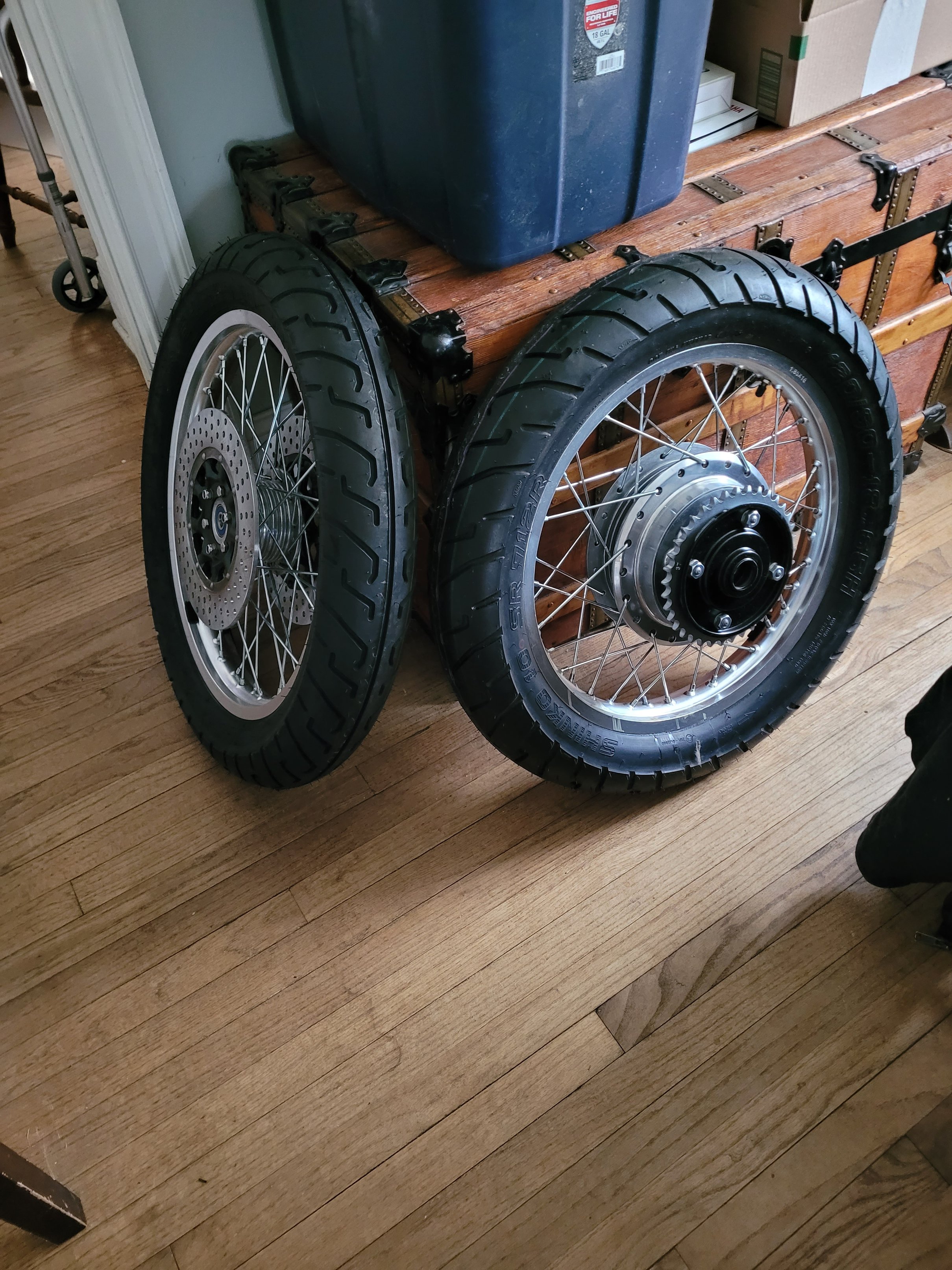

Hard to believe it was almost 2 months of weekends to get these done. I can't believe how much heavier they are in comparison to the huge wheels and tires on my MT10.

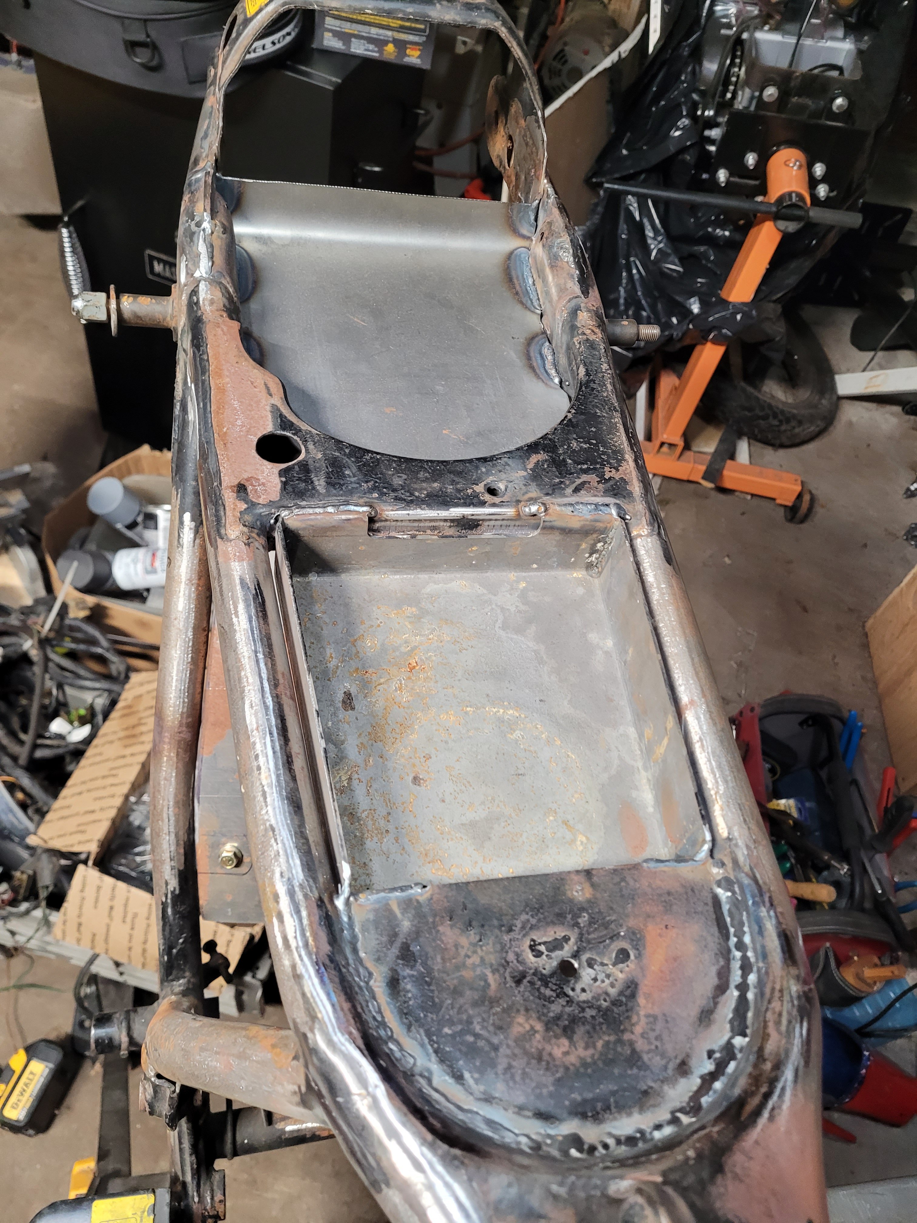

I've been busy doing work around the house but still have found time to keep working on this Honda. I've been bouncing around waiting on parts from machinist and powder coater. Since I decided to change this to tracker style, I had to cut off the nasty rear hoop that the previous owner fabricated and restore it to stock. I was able to test fit the seat and it it fits like it is stock with the rear frame restored. Since I'm deleting the rear fender, I wanted put a plate within the frame rails to keep water and debris getting on the pods. Not a lot of people do this but I saw a few and thought it was a great idea and looks pretty cool. I need to get it to the welder now.

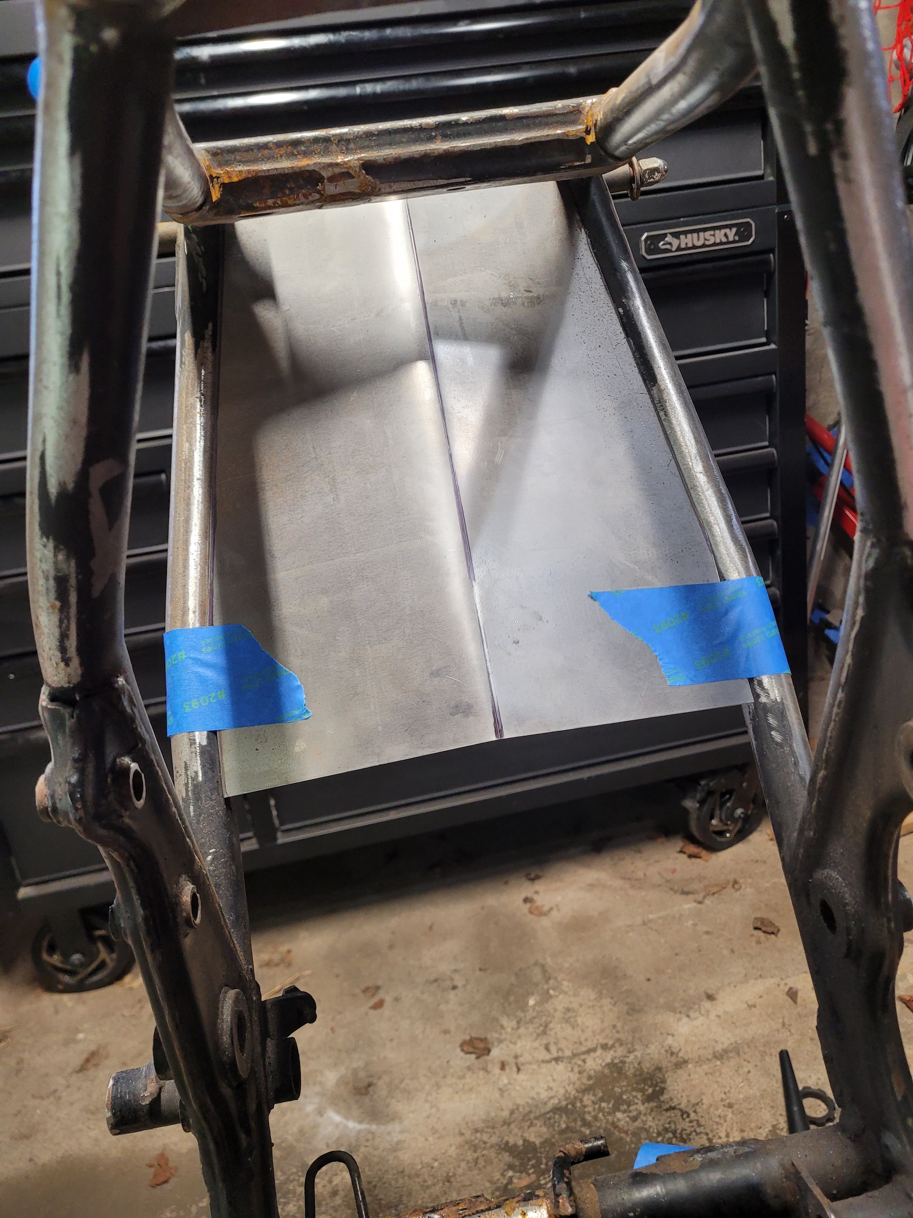

Here is the frame ready for finish sanding and then test assembly. It looks a little rough because it's unfinished but it's some nice fabrication. The tail section is restored back to stock to work with the tracker seat. All of the electronics and battery will fit in the trays which will leave the center section completely empty. I made a plate to go in the section where the lower fender would be. Not an original idea as I've seen it done on other builds. It will keep the pods dry if I get caught in the rain and it looks pretty cool.
