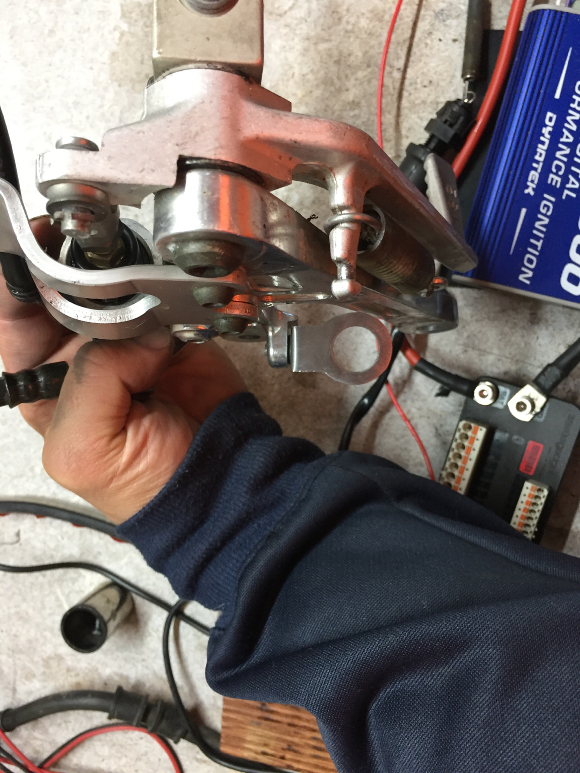

It’s amazing what a difference having all the right tools make. I wasn’t happy with my previous attempt at the rear brake switch bracket so I thought I’d have another go this time using dads drill press and bench grinder.
No one will ever see it except me, but the devil is in the detail after all.

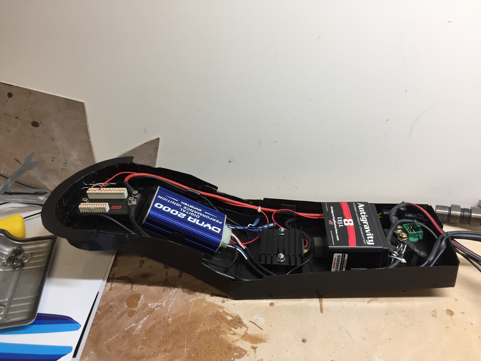

Well I painted up the battery tray and reinstalled the electrics.
The old man welded up a better bracket for the coils that will allow the tank to sit properly and also won’t break it’s a much thicker gauge of plate.

Looking good.
I'm in a bit late on this one, but you're not using the stock charging system, right?
Also, you can skip one of the ground cables on the M-Unit, if you wanted to save a bit more wiring space. Only one of them is needed.
Sonreir said:
Looking good.
No I’m using a cycle x upgrade, I think that extra black wire that looks like an earth is the wires for the LED tail light set up. I need to keep some length on it as the light will be housed within the tail section,but the wire will feed into the tray. So when I seperate the two I’ll need some wiggle room.

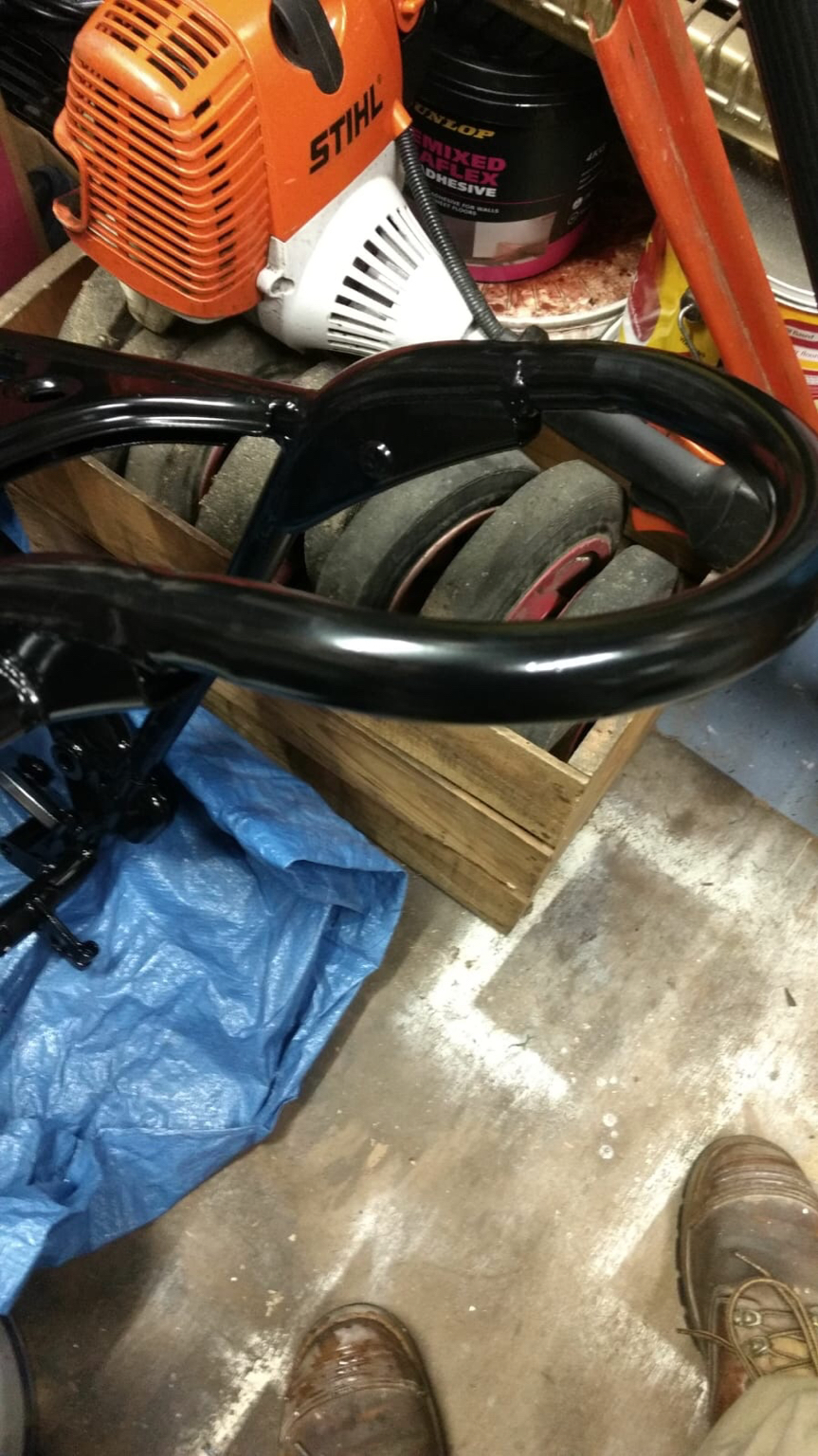

So the frame has come back from being sandblasted and powder coated
