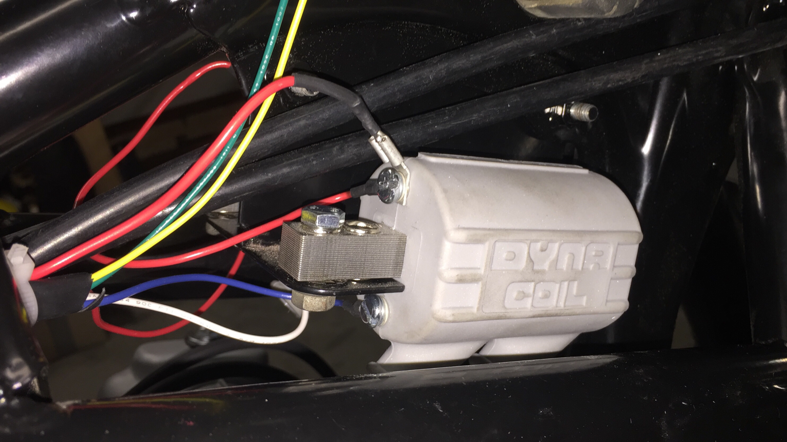

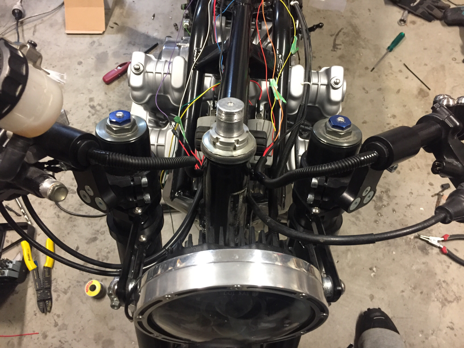

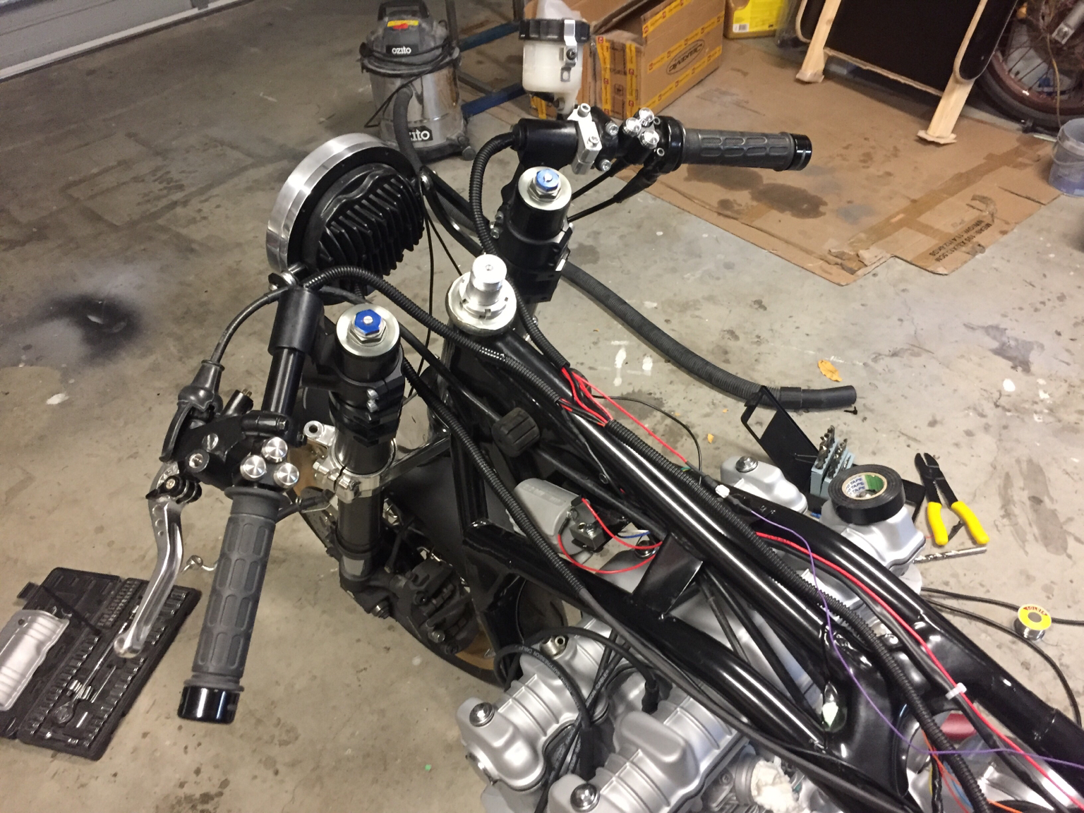

Had a little crack at the wiring and realised that I had labeled the Dyna ignition cables that run to the coils incorrectly.
After a refresher of the dyna and m unit manuals I was back on track. Once the wiring to the coils was complete I reinstalled the side stand. Now that the bike sits lower the bike is on too steep an angle, it’s looking like I’ll have to cut an re weld it slightly shorter (an adventure for next break)

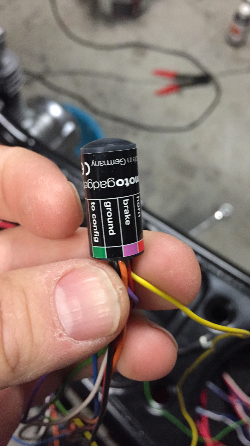

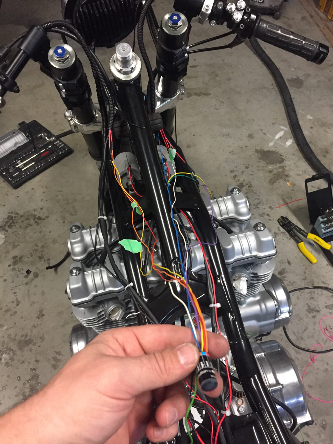

The buttons for to replace the ones I destroyed in the purpose built moto switch gear arrived, so I reattached the wires and ran it back through the handle bars. It was a lot easier and done to a much better standard second time around.
I then connected the m button up to its respective buttons on the handle bars, then I ran the wiring through some flexible conduit I purchased previously in an attempt to neaten everything up.

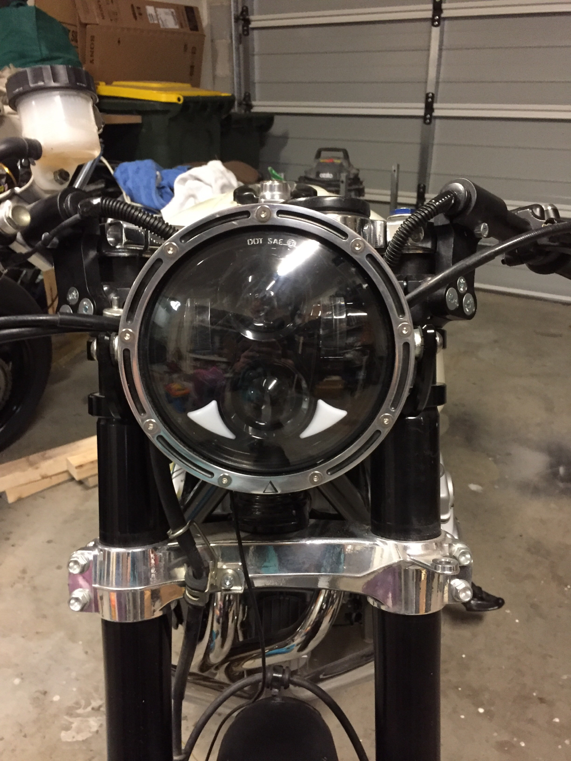

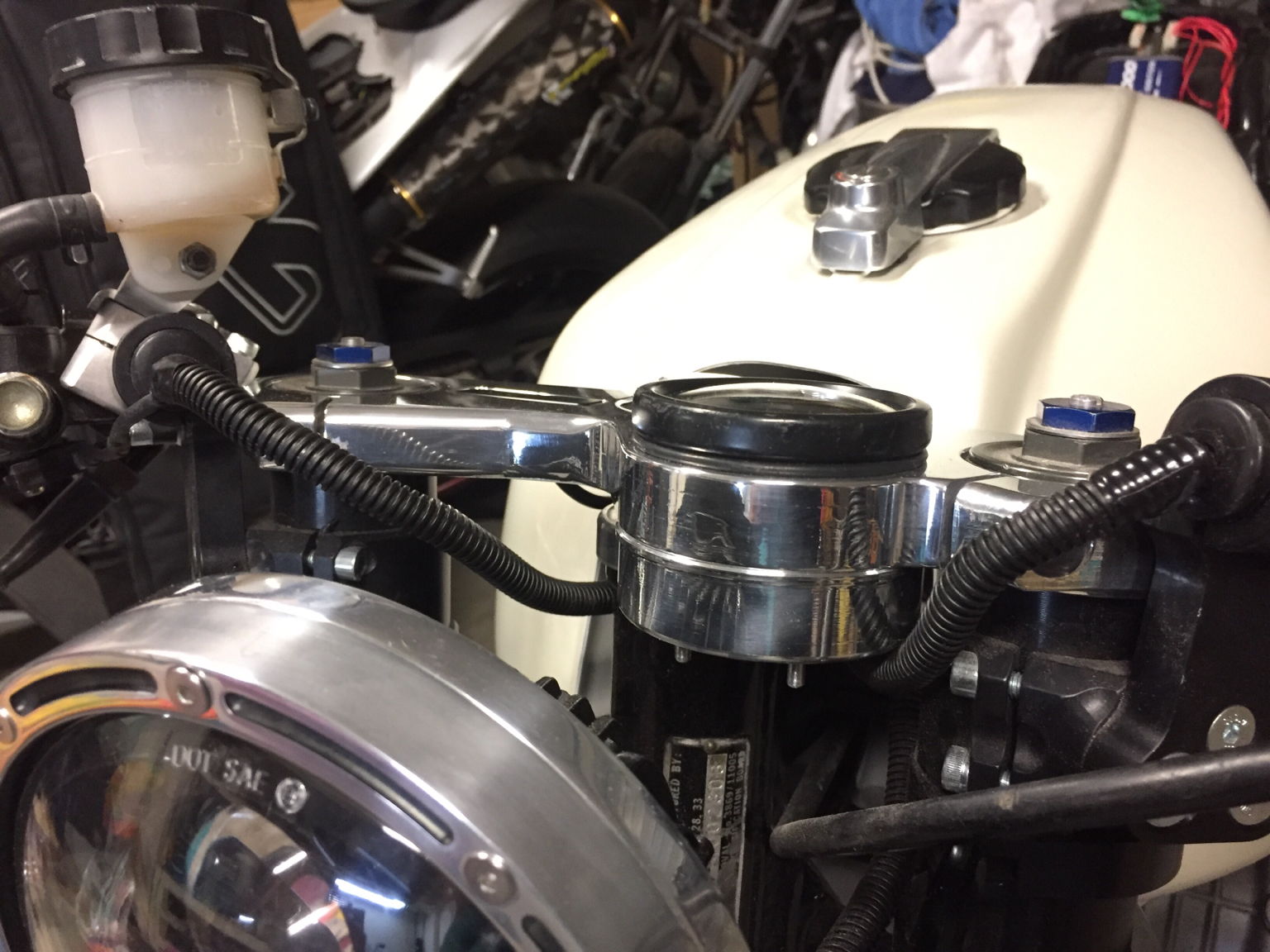

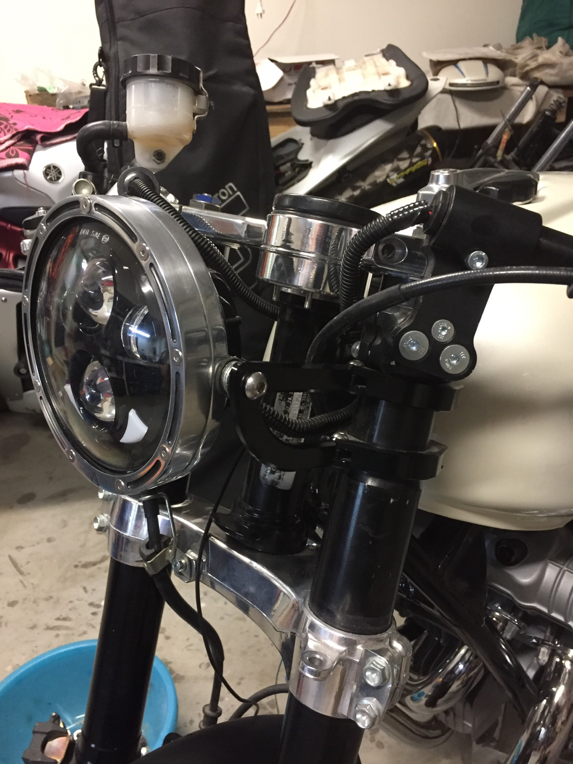

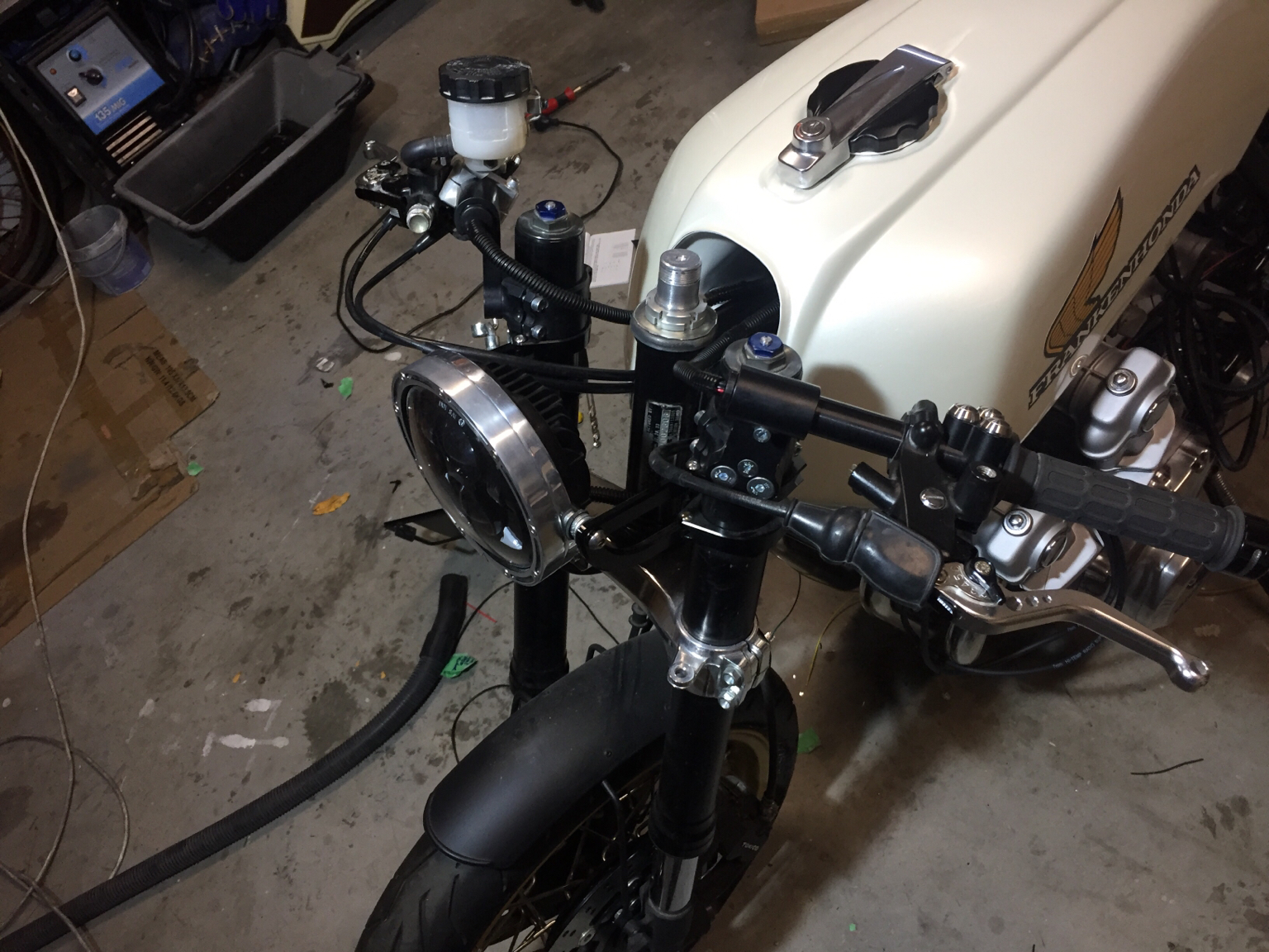

I then put the tank on just to see what it would look like.
You’ll probably note the top triple is missing, it’s getting tweaked at OMM’s shed along with the top bearing cap and the CR special carb adapters with need to be longer to allow for the oil delivery line that feeds the head.

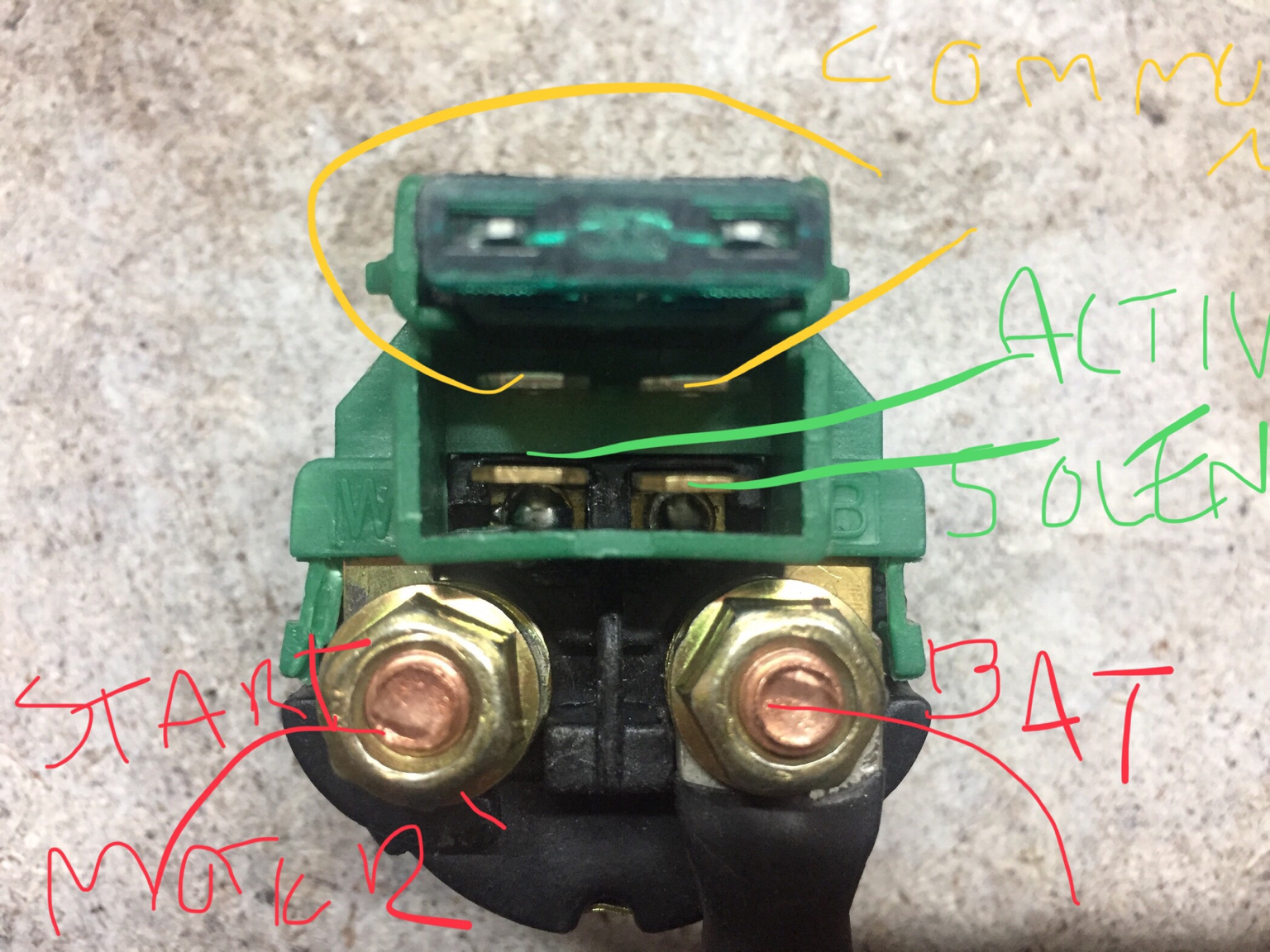

So the last photo is of the starter solenoid and it’s got me a bit baffled.
So you can see the two bolts, one for the battery, one to the starter motor which earths out through the frame. Then there are the two that activate the solenoid, then two that have continuity through them.
There are two power out puts for the starter from the m unit and I can’t work out what they go to on this solenoid. Historically I have not had a good track record with starter motors I cooked one in my Holden Torana when I first started to tinker with cars and I’m a little gun shy. I can work out what the fuse does, the two points that have continuity have it regardless of if the fuse is in or not.

The two that are common to the Bat terminal get red (ignition switch Bat terminal) and red/white (reg/rec output) on the stock Honda setup. They are both protected by the 30 amp fuse.
On the m unit wiring diagram the starter solenoid is connected to these two power output wires, which is all different to the stock wiring diagram this is where it all goes left handed Braille for me.
I think even how the reg/rec hooks up is different. Luckily I have 6 weeks to ponder it over.

Munit Bat terminal would replace the ignition switch Bat, and the other solenoid pin in question goes to the regulator output as shown. I'd use red and red/white wires to keep it like Honda. Maybe even run a yellow/white from Munit Start to the solenoid coil and green/red for solenoid coil ground. Mind, I've never used an Munit, but that is what their schematic indicates.

Well after coming back from work I’ve managed to get a few easy runs on the board

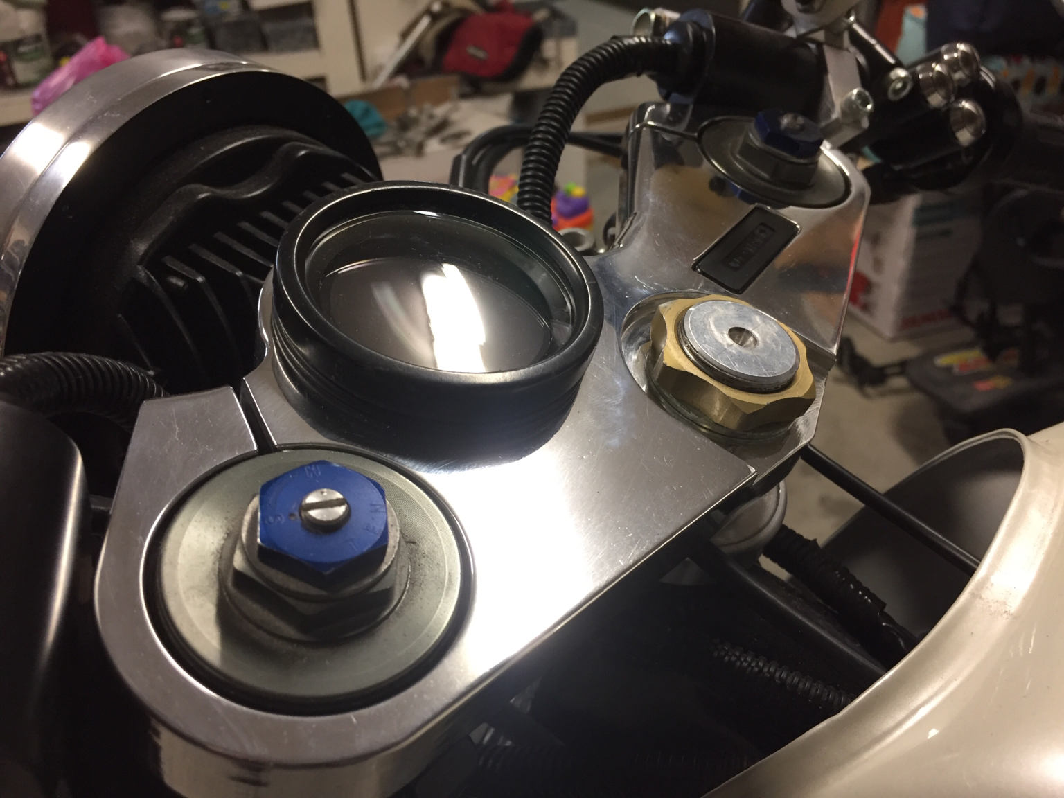

Old Man Murphy did a few last minute tweaks to the triple clamp, took the ID of bearing cap out to 31mm, he then recessed the hole on the underside of the triple in 4 mm deep and took the ID out to 31mm allowing it to go over the first few threads on the lower thread on the stem
Then it was up to me to give it a bit of a polish ended up coming up alright
I also connected the leads to the coils and filled the motor up with 4.5 L of oil, still no leaks which is promising.
I need to get my shit together with this wiring it’s definitely not the strong point of my game
