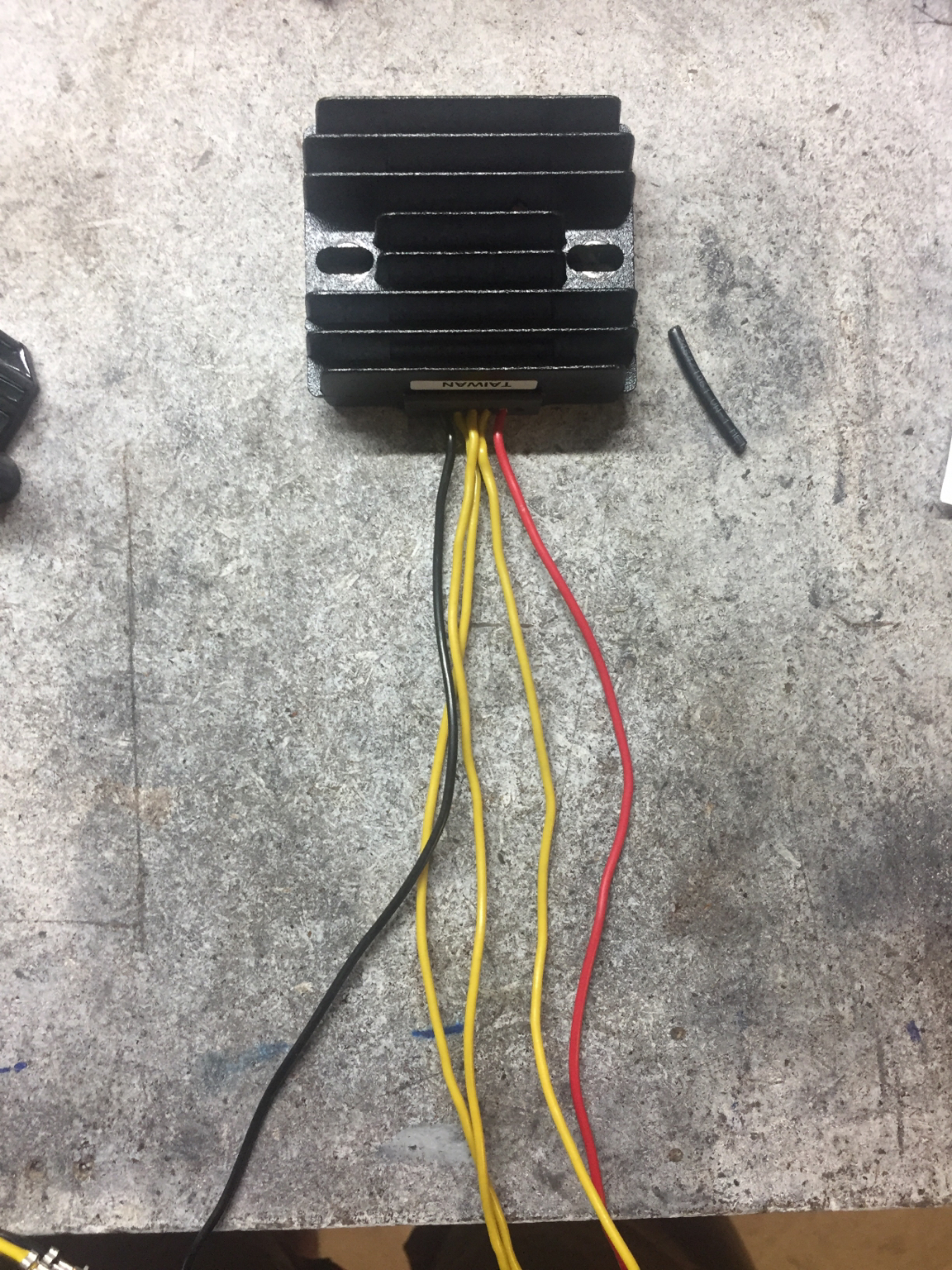

Right so I’m looking at the ricks Motorsport reg /rec and the wiring if different to the cycle x one I had which is pictured first. It has 3 yellow which got to the rotor stator and a red and a black which go to the battery.
My new reg/rec has 3 yellow , 2 black, 1 white , 1 green and 1 white with a red stripe on it. My wiring is all new using the m unit so I’m not really sure where these additional wires should go.

For sure.
All of the colors should match up to the stock setup.
Red/white -> Battery positive terminal
Green -> Ground
Black (in connector) -> Switched power. Needs 12V when ignition switch on and no power when ignition switch off
Yellow x3 -> Alternator (color should match)
Loose black -> Alternator (color should match)
White -> Alternator (color should match)

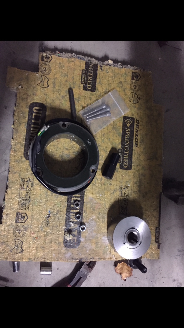

Unfortunately there is nothing stock in my wiring loom it’s all new, I’m running a m-unit, m-lock, dyna ignition and cycle x charging system

Aha! A Lucas alternator. That explains everything. All jokes aside, it's why the R/R must be matched to that alternator. Can Cycle X provide a wiring diagram and even better a system diagram or at least can they provide a matching Regulator and rectifier?

OK so that Podtronics reg/Rect is for the 3 phase stator. How many wires does your stator have and what color are they? The Cycle-X site says their stator is 16 amp three phase, so in theory the Podtronics R/R and Stator are a perfect match for each other.

The Ricks looks like it works on an OEm electro magnet system and Lucas/Cycle-x Podtronics is indeed permanent magnet, so those are not compatible.
After connecting the stator to the 5 wire R/R, I would expect there to be two wires left over, red to the battery feed and probably black or maybe green to ground (earth).
What wires are on the stator and what on the R/R? Both should have three yellow leads to connect to each other. And there should be a Red +12v and black ground on the r/r.
On the stock wiring harness you should have two wires that used to go from the stock OEM r/r to the oem field coils (electro magnet). In theory they are no longer connected to anything, but check your FSM wiring diagram. That appears to be why the NEW R?R has extra wires that will not work with your alternator.

The Pod Tronic reg/ rec came with the cycle x stator so the 3 wires that come out from it correspond perfectly.
The Ricks is perfect for the OEM wiring harness (which I no longer run) it has the 3 yellow wires which would still go to the stator
(there is also a black and a white wire that would have gone to the original OEM stator which are now redundant)
In addition to this there are 3 more wires white with red line that is meant to go to the starter relay a black to the ignition switch and a green that goes to earth.
Rick hasn’t responded to my email with an answer yet but the more I look at it the more I’m thinking I need a different reg / rec
So I’m thinking you’re right teazer she ain’t gonna work with the new stator
