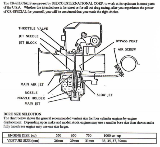

So on the carbs I've found the CR main Jet is 110 and the Main air jet is 240 i didn't check the slow jet, what I'm finding is the bike starts on full choke but and idles higher than 2000 rpm then without choke dies out. (I'm thinking initially I will just adjust the idle screw just so it doesn't stall and I can ride it to a mechanic to do the final tuning).
