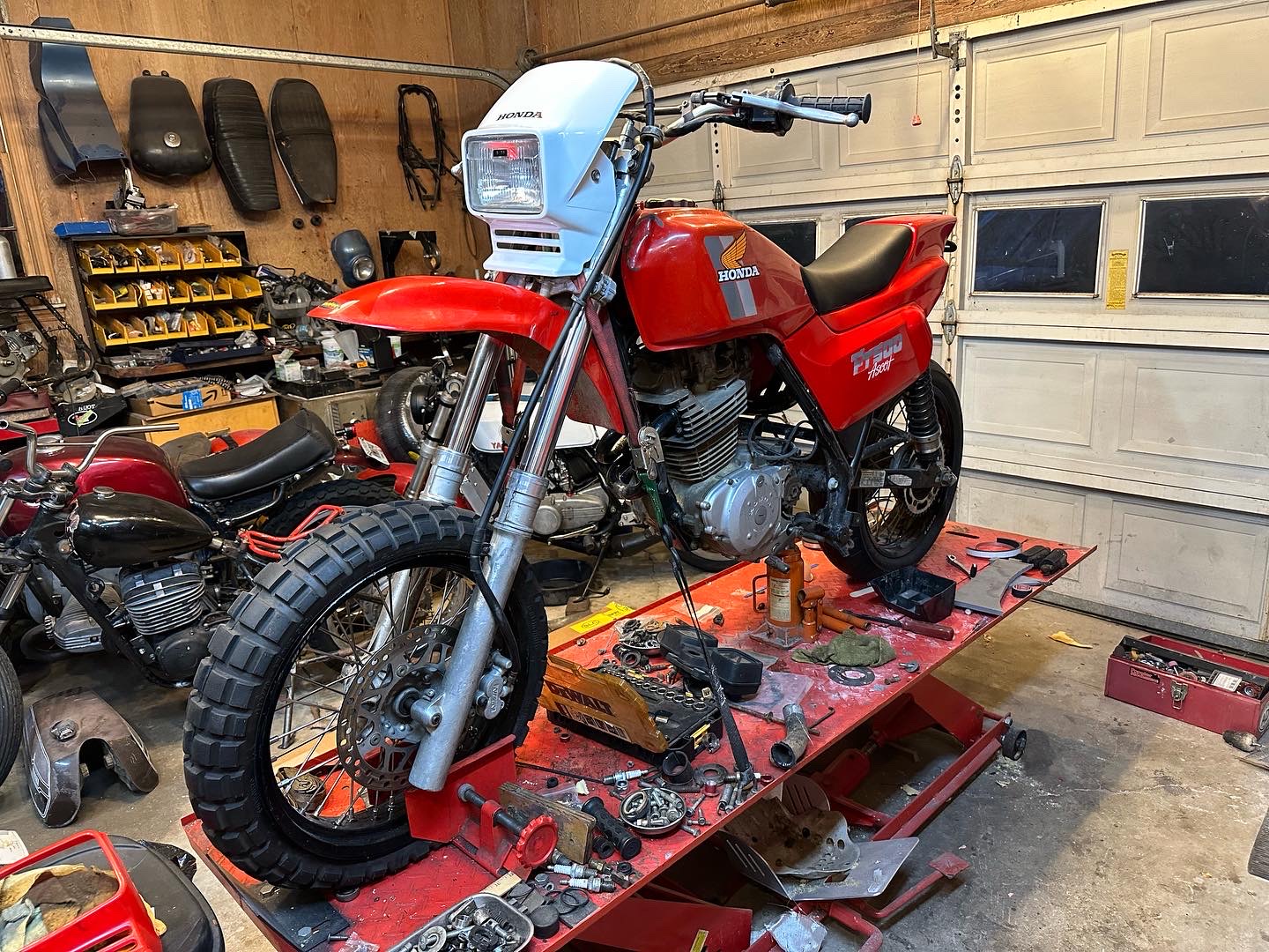

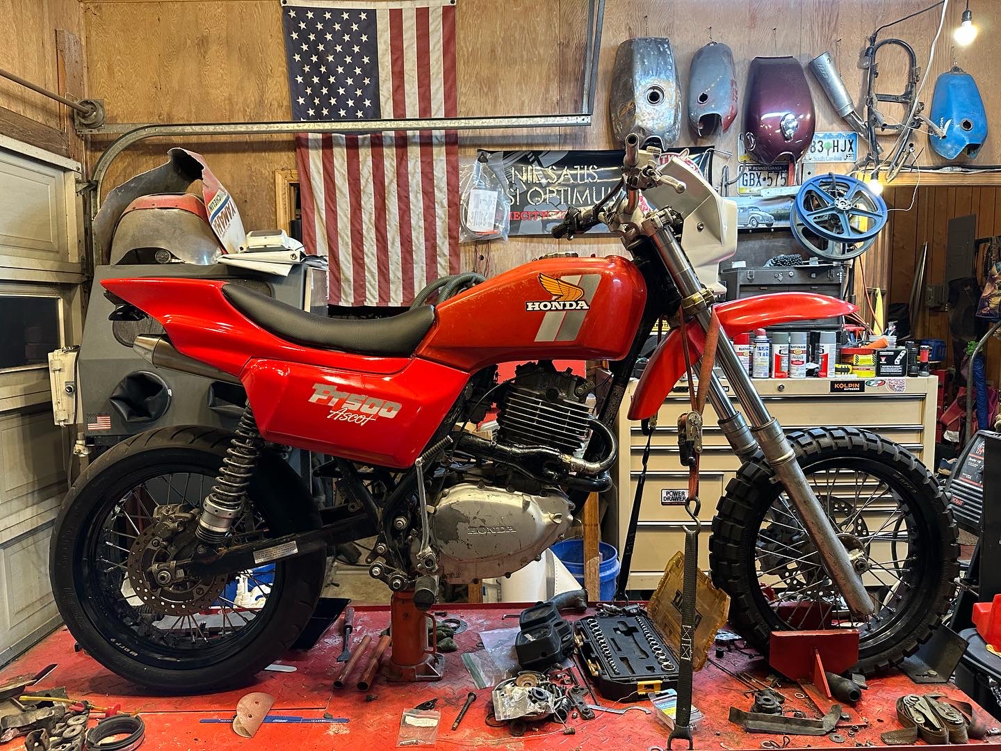

Tracking down the front shroud has not been as easy as I hoped. The red one I cut down continues to develop cracks, so it’s out. I bought an NOS white one that I don’t hate as white, but it will get matched or I will find a good enough red one.
Adapted to kick only and the DR350S rear wheel and brake. Nothing a little torch forging some 3/4” tubing and a CB650 brake arm couldn’t handle.

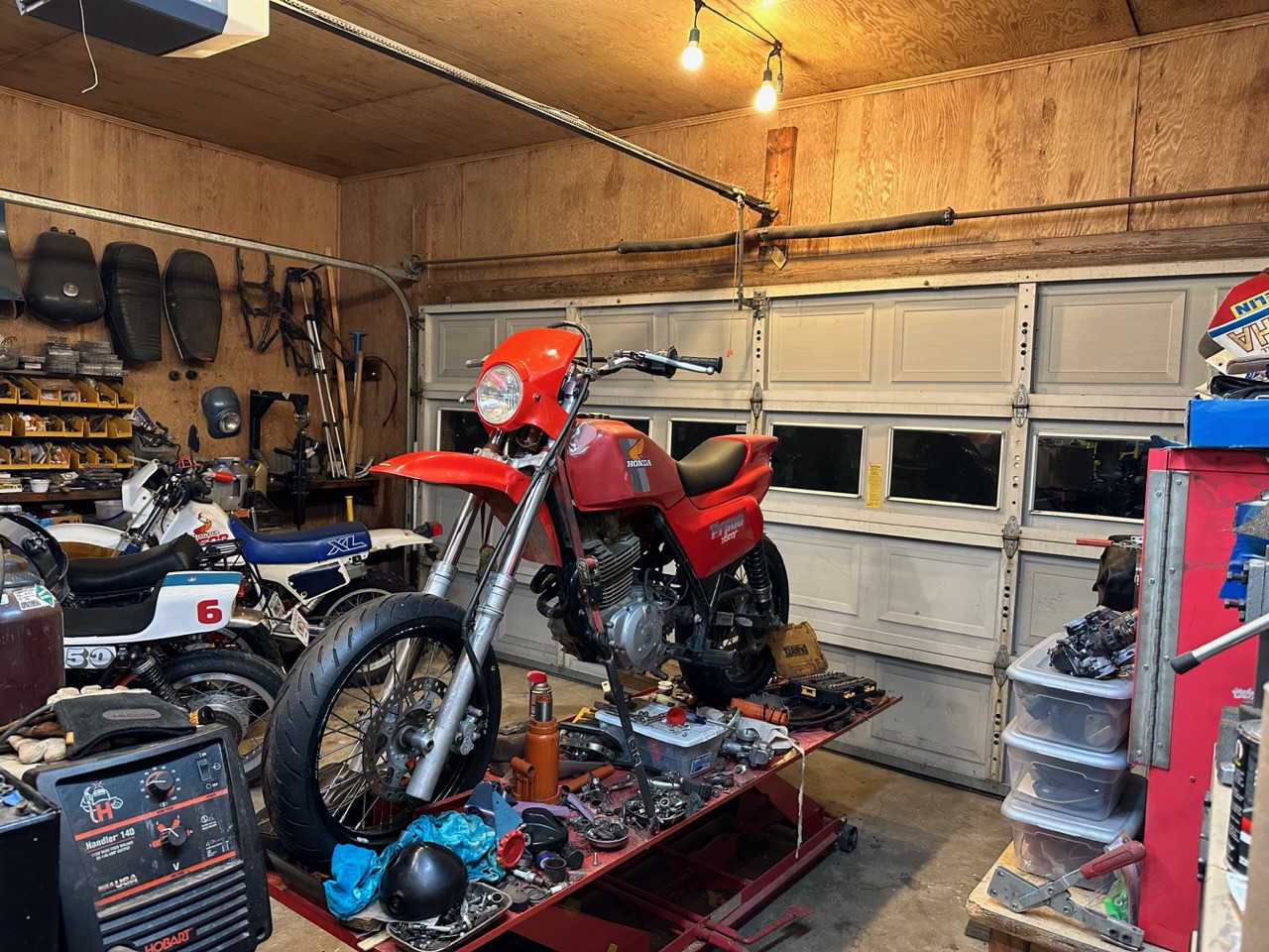

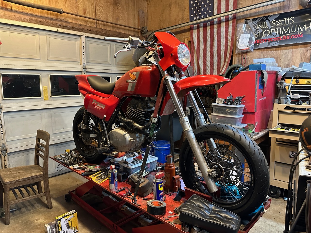

Been a while since I posted. The build stalled for a month, until I finally got the jug out to bore. 92mm JE piston installed to bring displacement to 530cc. 38mm Mikuni. Swapped for an non-American XL fairing modified for a light o had laying around.

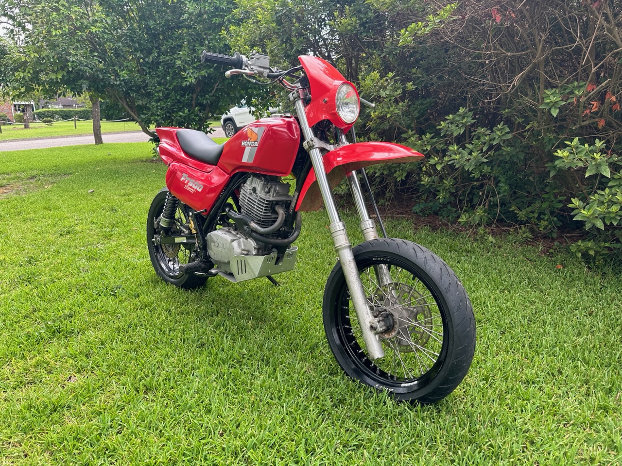

So much nicer with the round headlight and fairing! The whole "Rectangle Headlight Because We Can Thing" was an UGLY styling period with both cars AND bikes.
Took a few nicks to finish, but aside from a clear coat, we’re done and riding.
