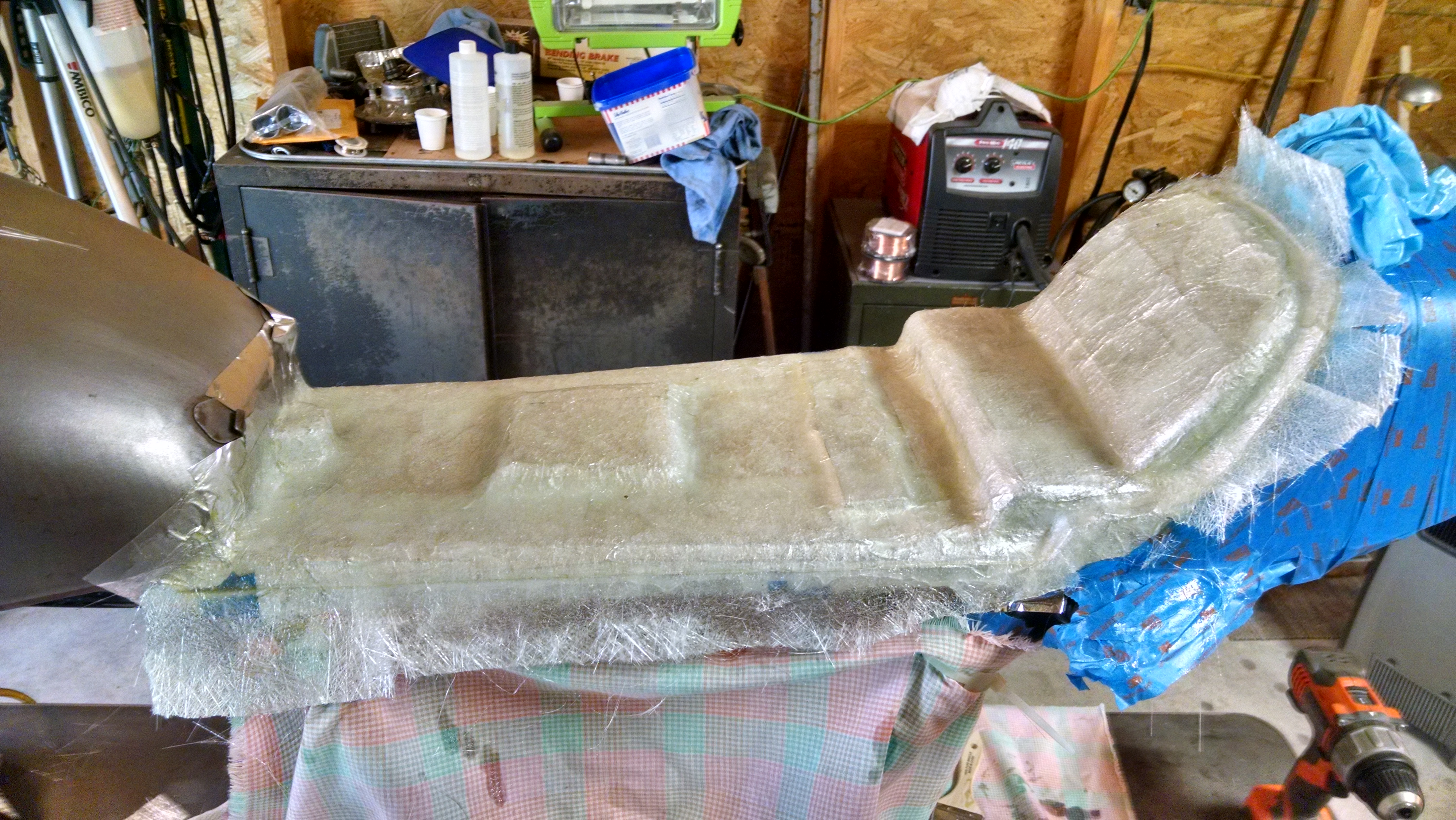

Glass seat pan attempt.

Masked and ready to drape and make a mess... whats the skinny on mixing epoxy in cold temps... is there a drop dead don't do it temp? it's 60deg F here and 35% humidity, I can use a space heater to blow warm air over the work if needed.
Go/No Go?

First (ever) layup done. may have too much resin in some low spots... hope it sets up.
