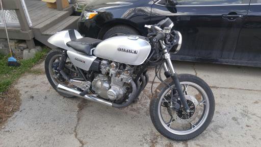

Hello anyone who is bored enough to read my post! I decided I wanted to build a cafe racer, had a few bucks laying around to do it and said what the hell. The bike I bought fell into my lap in a pretty good way. It is a 1981 Suzuki GS650E. It had the makings of a cool bike when I bought it, but it looked like a 3rd grader did it with a spray paint can. The first few picture were of the bike when I started. It was way to wide in the rear end, the front end looked clunky and bulky. The paint was crap and bike didn't run. Quick story about the bike not running. I show up to look at it, everything looks good, the guy says he rode it to his house and it sat for the past year and doesn't run anymore. I put the key in and hit the starter, cranks like a champ, sounds good but doesn't fire. He says its maybe the timing, I say ohhh yeah probably it doesn't sounds right (sounded fine). I tap the gas tank where there looked like a little bondo (there wasn't just really really crappy spray paint) sounds empty, and say, well with it not running, needing tires yadda yadda yadda, i'll buy it for X. I get it home, check the spark (looks great) put gas in the tank (which was bone dry) and it fires right up!!!! Thanks for the discount dude.
This bike is pretty much completed but I need to keep adding pictures. Read on!

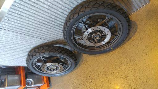

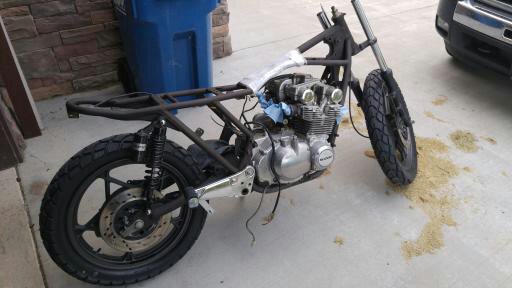

New rubber on powder coated wheels. I replaced the wheel bearings and tubes as well.

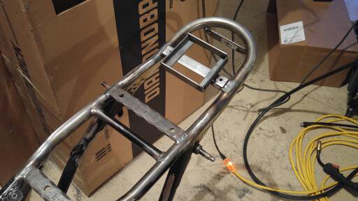

Cut the rear part of the frame to weld in a matching seat hoop. I had the metal and a custom car shop bent it in 10 minutes for 15$.

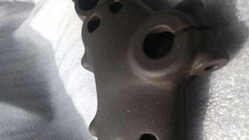

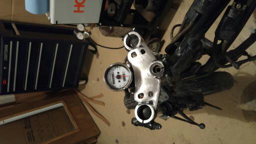

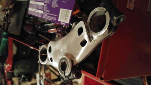

Sawed off the horns on the top triple tree clamp. Used a file to get it close then sand paper by hand. I started with 180 but got up 600grit.

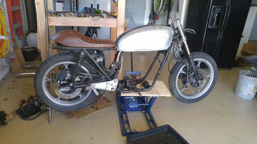

I got the frame back from powder coating and that night I had 2 friends come over to help me get the motor in. I think it was rolling like this within 2 hours of getting off work!

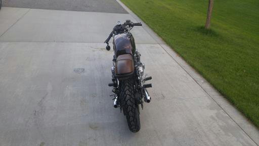

Another picture from last night. I need to finish the wiring and bolt the seat and tank down.

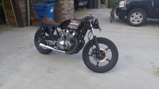

One more with it just about complete. Please ask any questions about what I did or didn't do. I took pictures about every day I worked on it. All told this project has been 5 weeks start to finish and has cost me about 2200$ including buying the bike! This has really been a budget build and almost everything on the bike (for accessories) is new.
