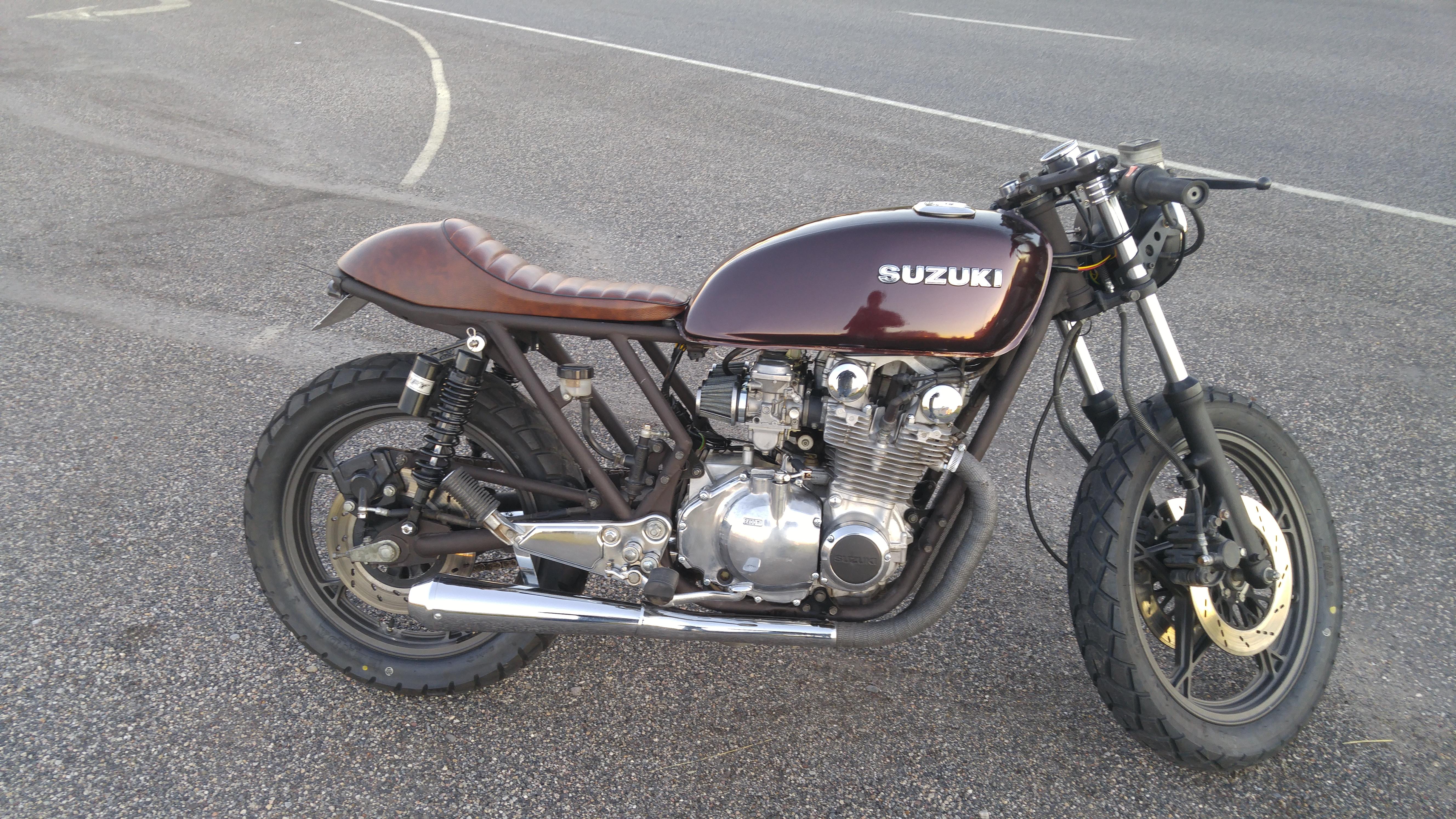

Looking good! Thanks for the larger picture. The tank looks pretty good for just a wrap. Although painting them yourself isn't very hard if you ever want to go that route.

Why did you cut the frame above the rear engine mounts?
Yeah, that looks questionable, doesn't it. There should be some gusseting at key points, I would think.
The frame had a notch cut out of one side when I purchased it. I decided to match sides and reinforced the part under the tank with an extra sheet of metal and welded around the entire thing, so it's not really concerning me.

like the way the colours blend from tank to seat to frame
black rose wrap is nice
what colour is the powdercoat? looks like its got a hint of something in the black from here..
cheers
Thanks! The frame is powder coated with something similar to Oiled Bronze. I had the company tweak it just a little. It has a little gold flek in it. I would have liked to do the entire frame the same as the wheels but they only had enough color to do the wheels.
