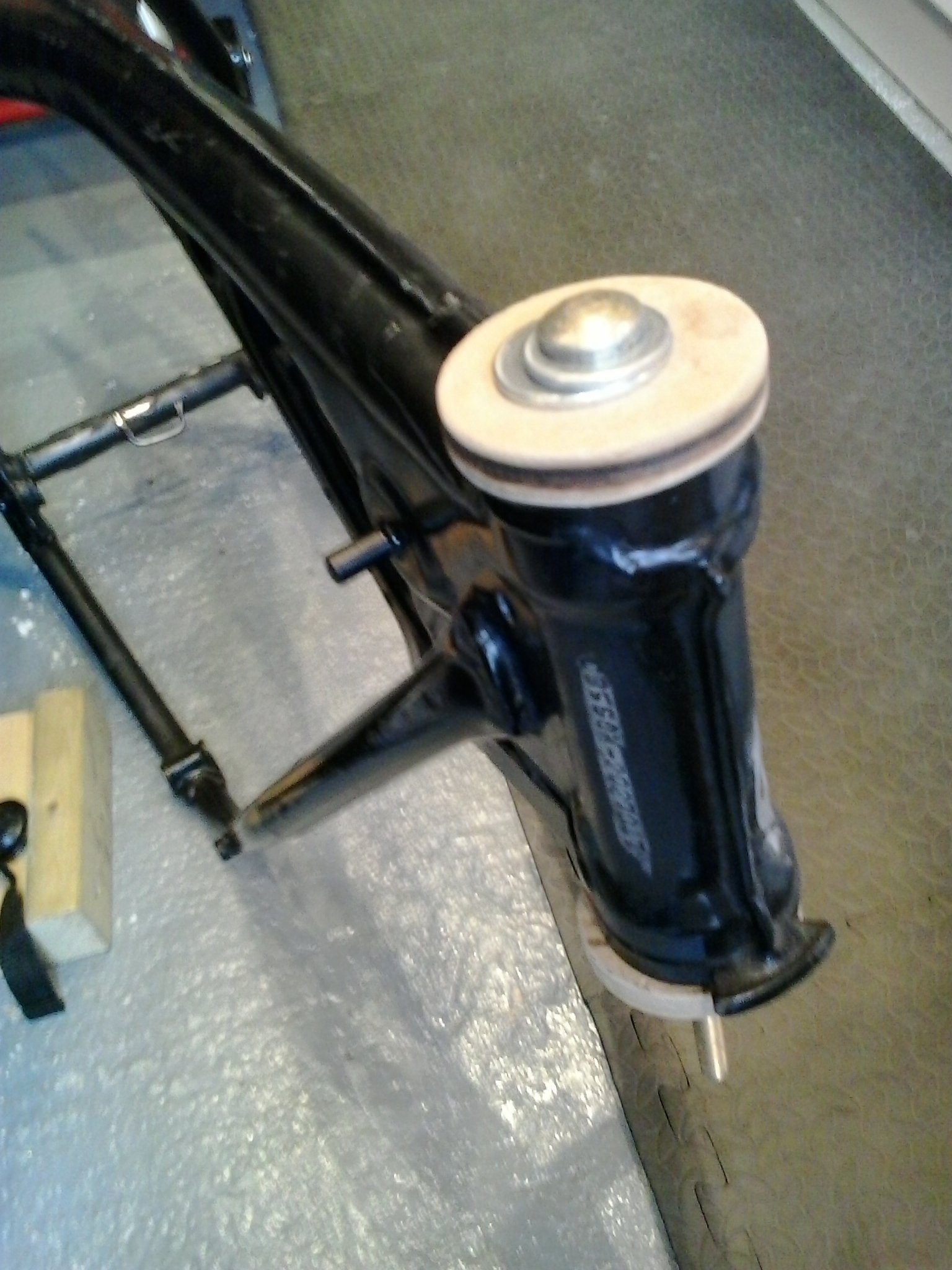

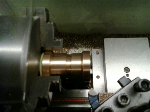

Got the rubber back on rear wheel nice classic tyre shame I nicked the new inner tube when I put it on lucky I had a spare cos a wool sock would have held more air than that tube haha :-[ ;D well got the spacers made up for rear wheel used bronze I had left over from the bushes for the brake side ::) then turned the original from sprocket side down so it fits inside oil seal to rear hub also the front spacers done :o so now can dismantle chassis and get frame finished up and off to powder coaters ;)

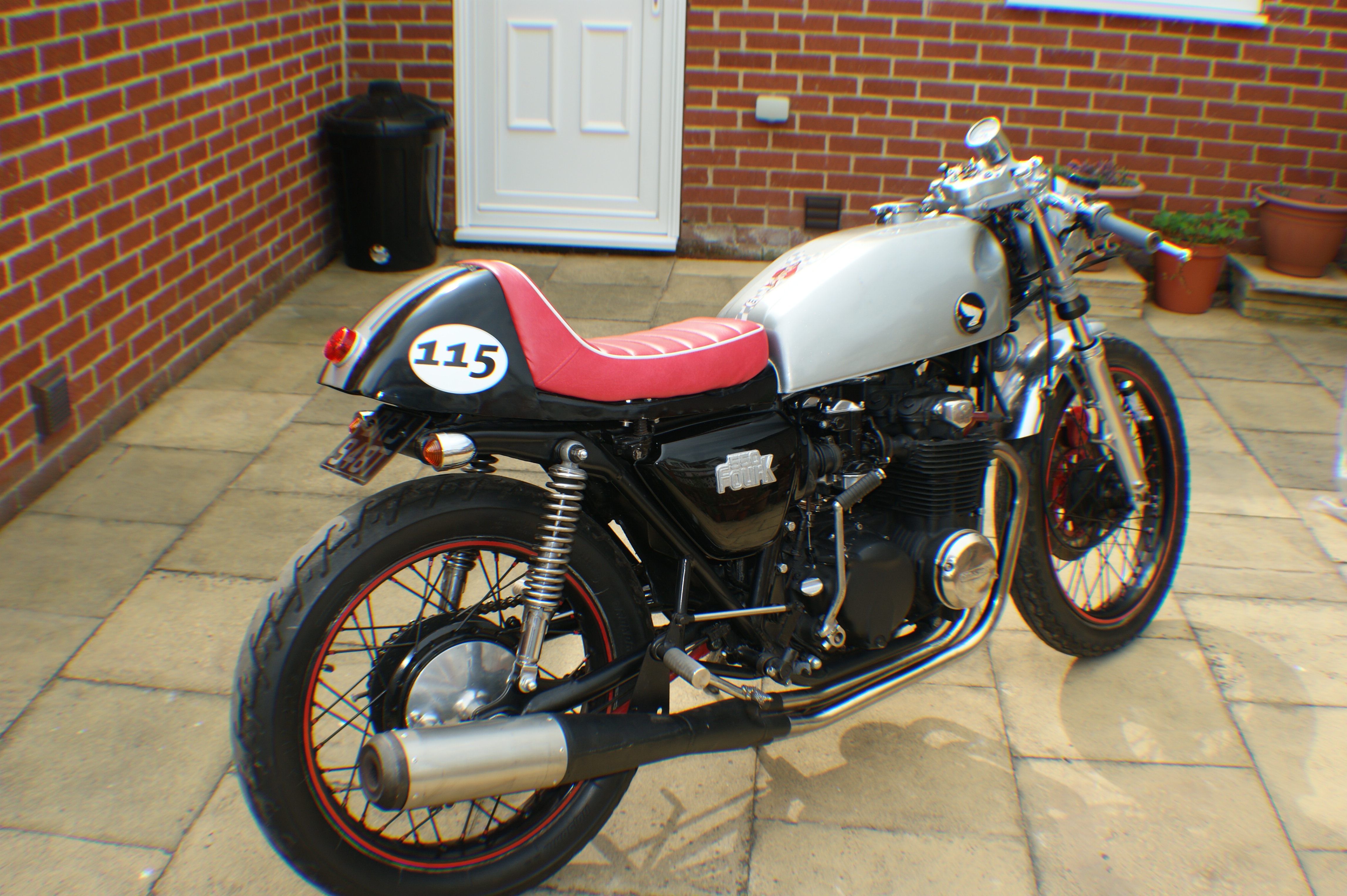

Cheers guys seems a long way off been finished yet :-\ want to keep it going so can get it to the TT for a bit of a ride round haha :o will be getting frame powder coated hoping to do everything else myself :o ??? thought ide put up a
few pictures of donor bike that ive ending using for my full on race rep :'(

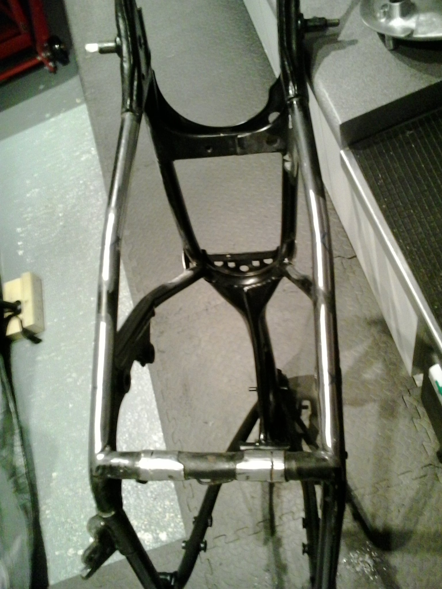

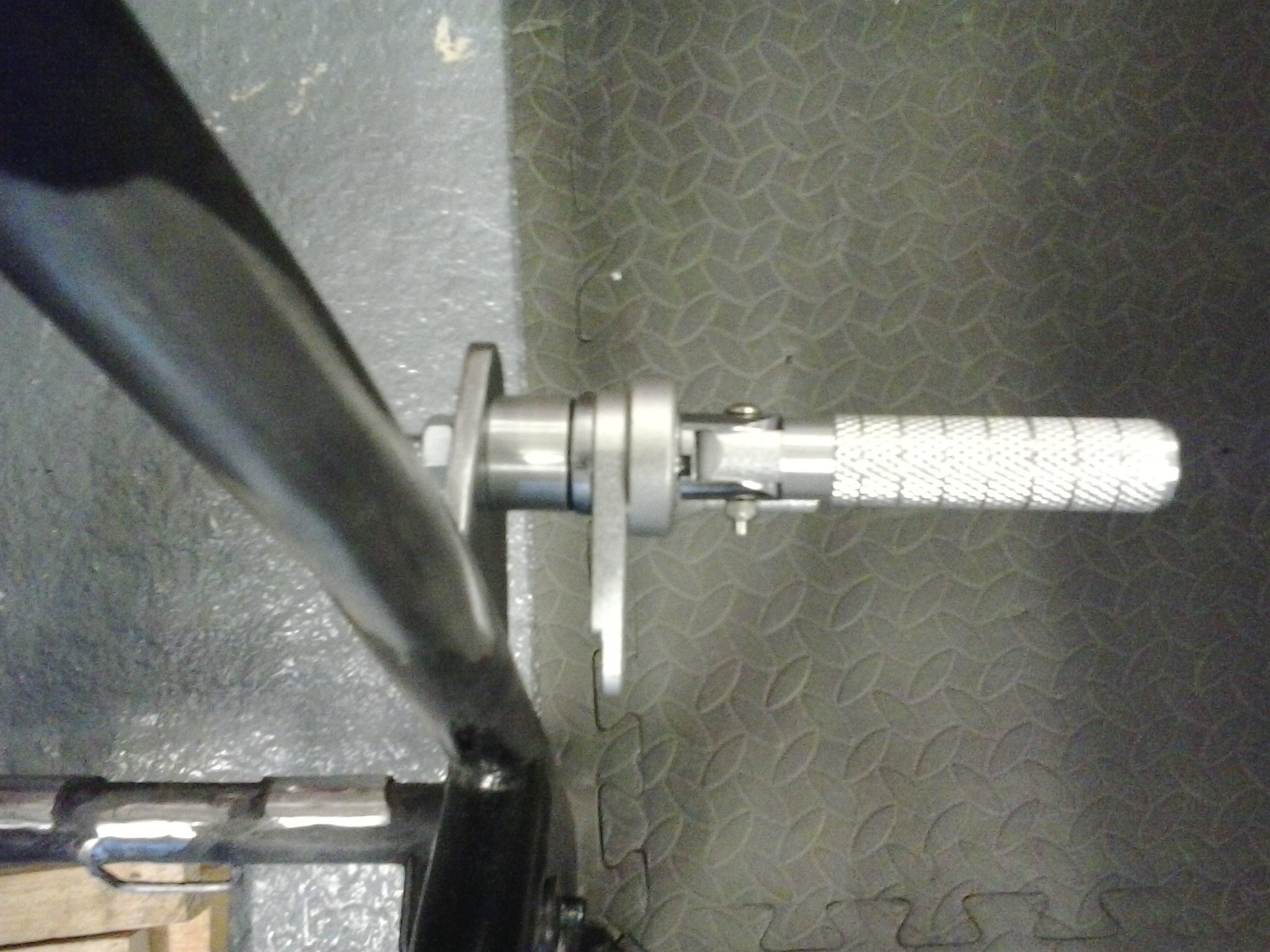

Another quick update :o at last frame de-tabbed and all grinding done :P hate that job :-[ went better than expected used the flap wheel more than grinding disk to clean up cuts better than putting grooves in the frame ::) welded up the rearset brackets and mocked up the pegs and spacers am happy so far :o got the hoop fitted too, got a nice pile of parts ready for powder coating at last feels like ime getting somewhere haha :-\ heres a few pics of wot ive been doin ;)

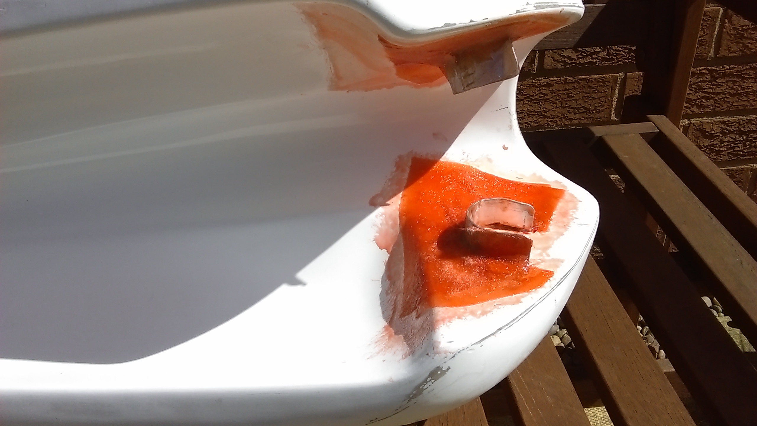

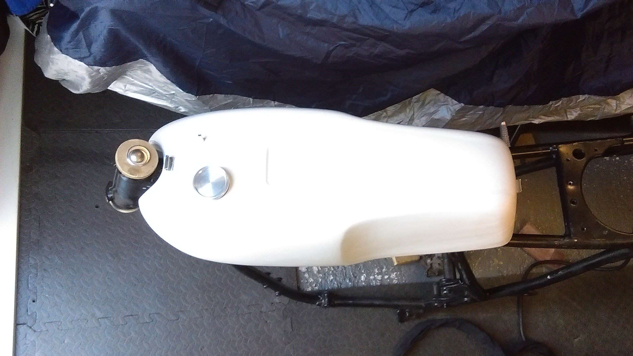

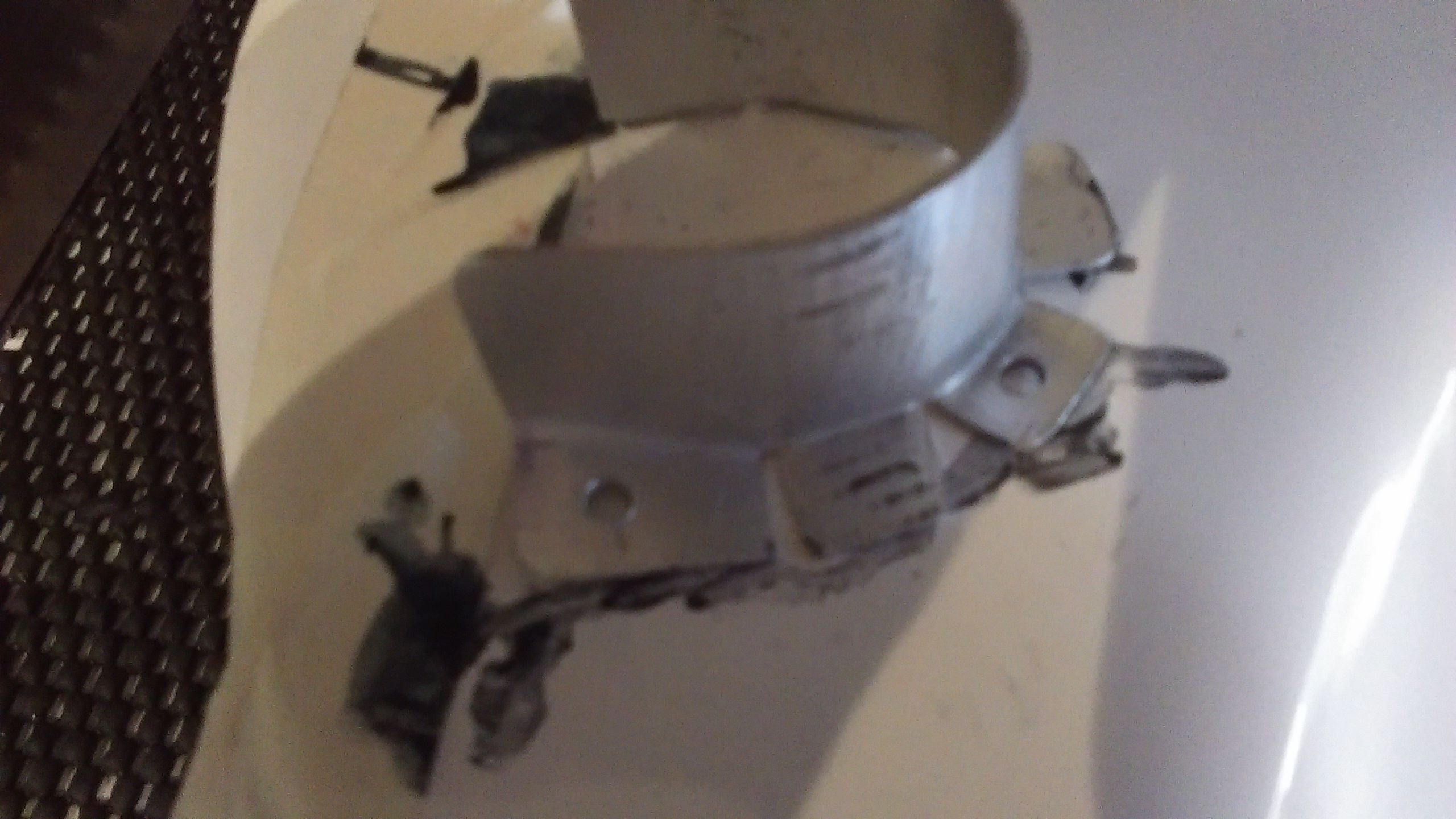

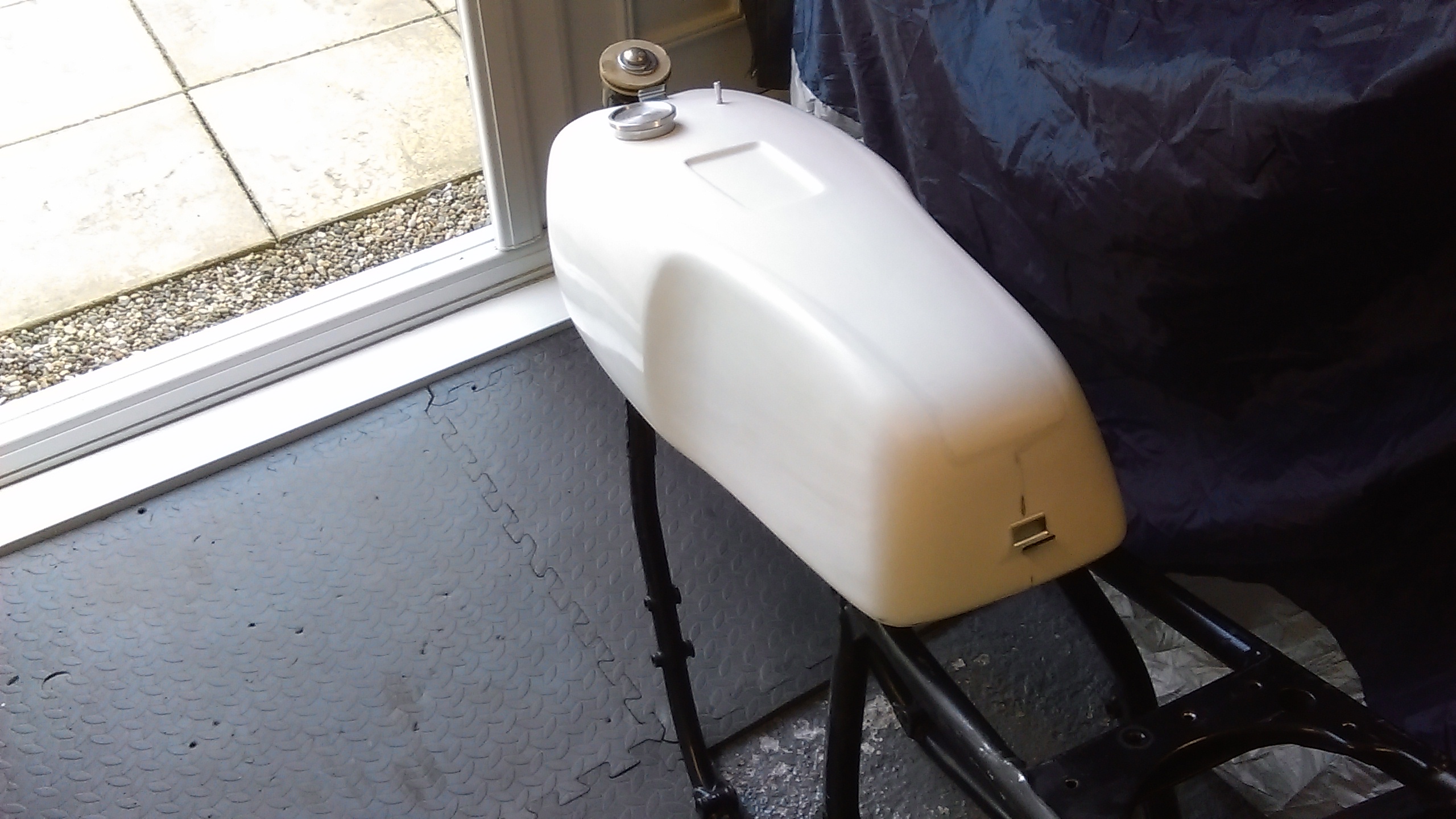

Hi gang progress so slow at the moment ::) sure its all gonna come together quicker at the final hurdle, :-\ using the original rubber mounts for front end of tank, rolled some 1mm aluminium to fit mounts cut n folded out fixing lugs then marked up tank while on frame, stuck down lugs onto tank then used fibreglass fine mat to bond to tank once dry flatted underneath of tank a layer of etch primer then couple of coats of red topcoat just to the underside ;) the pictures from my phone don't do the colour justice its a deep red in reality heres a couple of pics to show my slow progress ::)

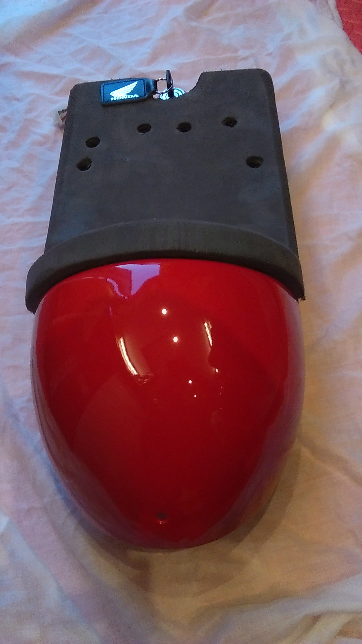

small update ??? moving slowly to finish :-[ hi gang managed to complete seat unit well just got to sew the suede cover extended it with a some flat sheet aluminium drilled out for fixings to frame , found a neat place for ignition between seat n tank :o yeah finally laid some paint down seat hump completed :P and first couple of coats onto tank (still cant get the picture colour right on phone but looks better in real life next lay some paint down on the full fairing that's gonna take a few rattle cans :o heres a few pics to show the slow progress haha

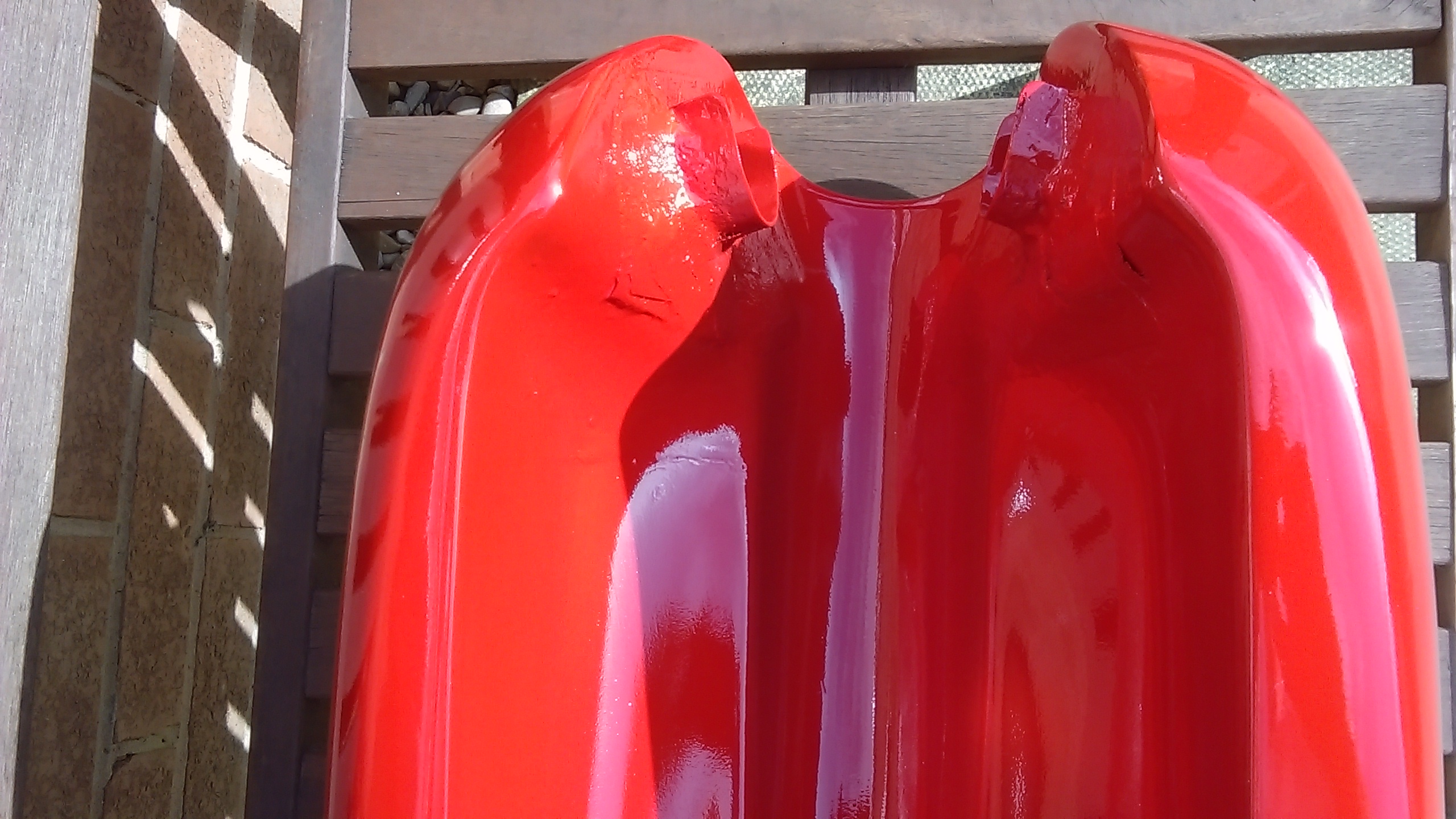

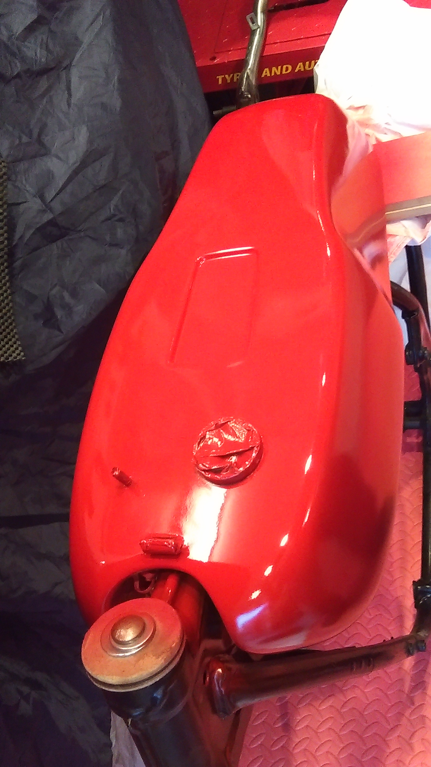

Cheers mate ime trying hard to get her done for the TT :-\ but in reality its gonna have to be the classic TT later in the year ::) still gonna have a big grin factor when she's done ;D just waiting for some more paint to come so I can finish tank off and start the fairing aint got a spray booth but parts come out pretty good for spraying outside in me yard haha :-[ always feel better when new paint starts been laid and parts been put back together ;D

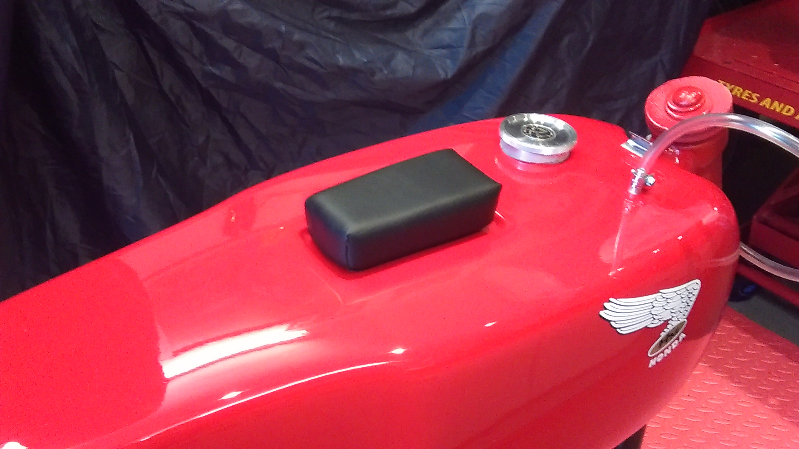

Should change my name to steady eddie :-[ haha at last got my tank painted up six coats of colour and gloss finish got the Honda decals on also a small pad top of the tank to rest ya chin on :o like the good ole days haa.Took the gas cap n turned a recess in it to take a Isle of Man coin with the famous three legs symbolic of the TT if nothing else looks kinda cool and finally primed fairing n laid first layer of silver paint yeah :o got a great finish to say ime still using rattle cans in my yard so glad it aint windy now I can see a finish line to this project ;D heres a few pics to show my slow progress still cant get my phone to show the poppin red colour of the tank she damn better in the flesh than these pics ime happy for a change ;)

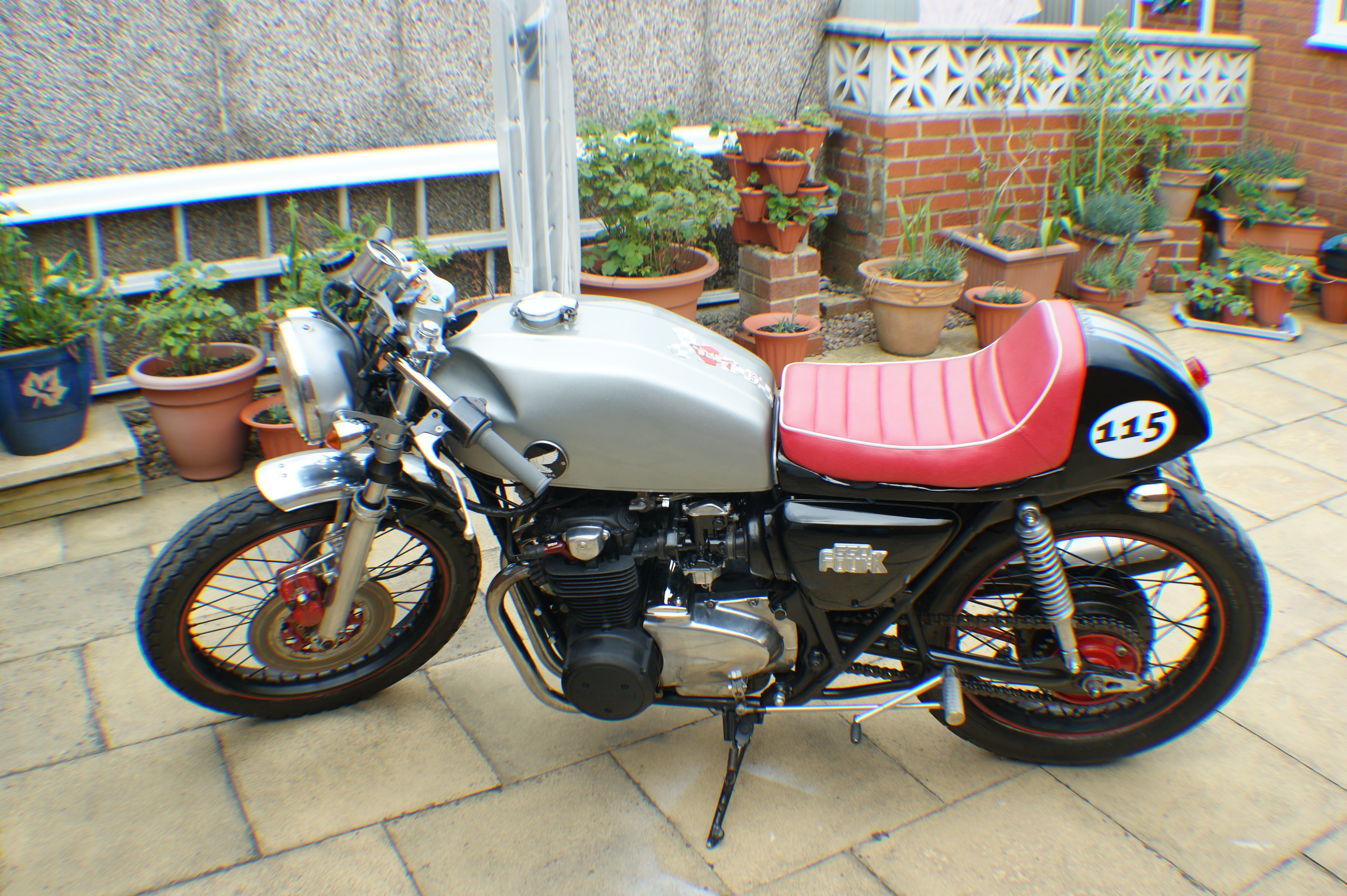

Awesome - one of my fave bikes of all time (my first bike was a CB750 and I desperately wanted it to look like this, but it was 1995 and I had no clue what I was doing).
Cheers mate must admit ime struggling got a couple of old pics from magazines to use as a reference and odd snaps on the web ime sure its gonna look the part next tough bit gonna be the fairing brackets especially round the front end and cutting the shaped screen :P
