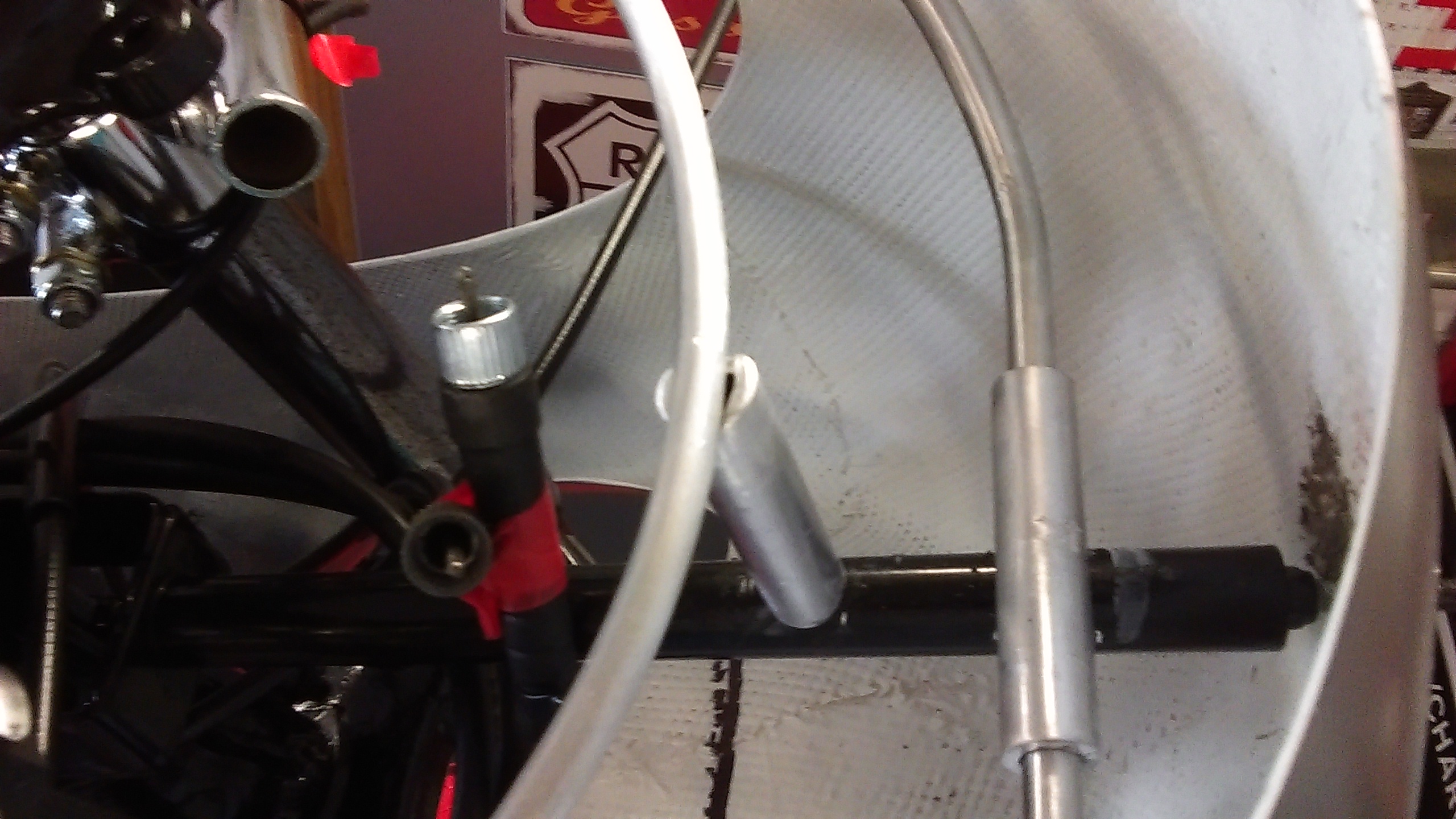

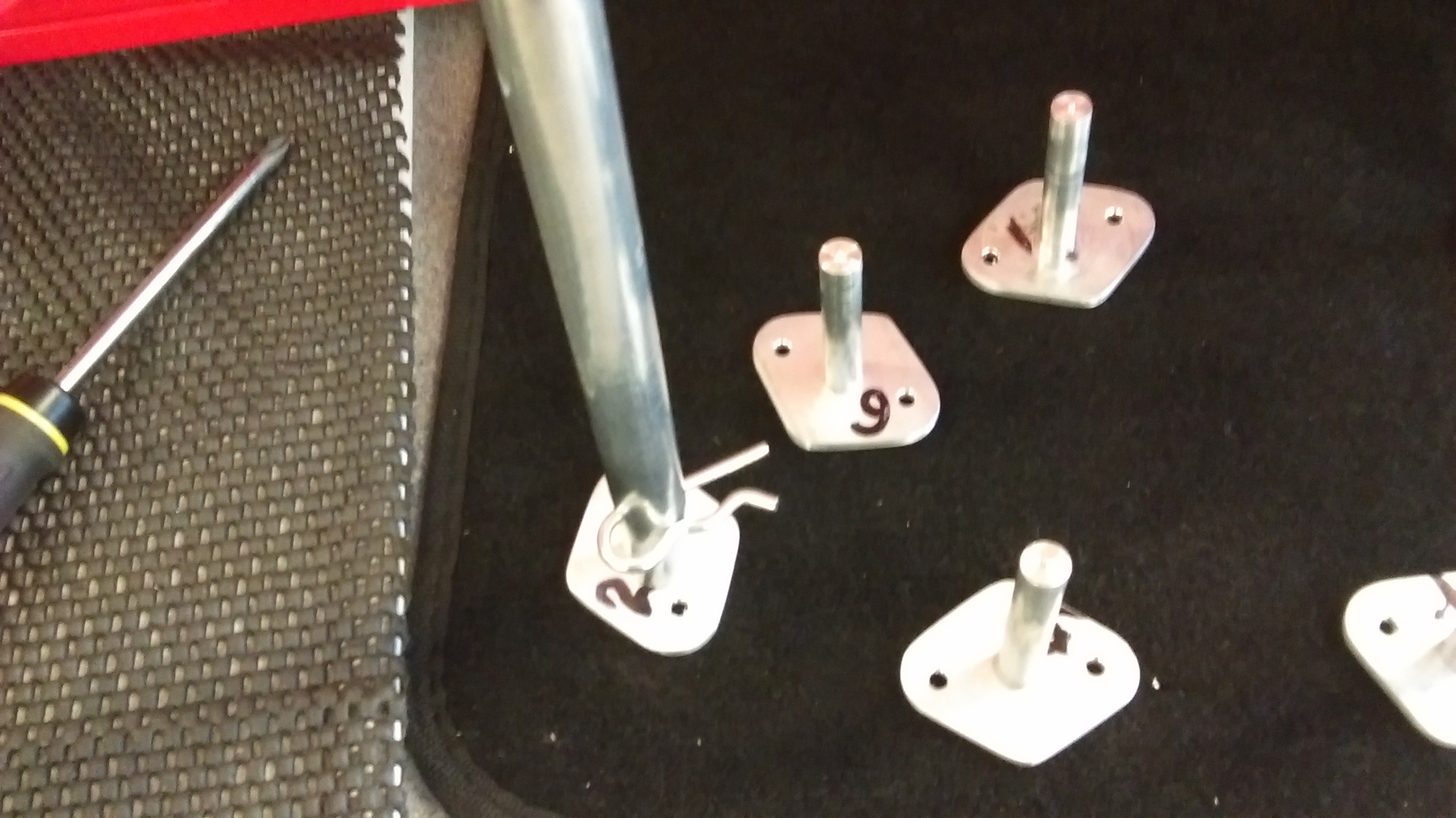

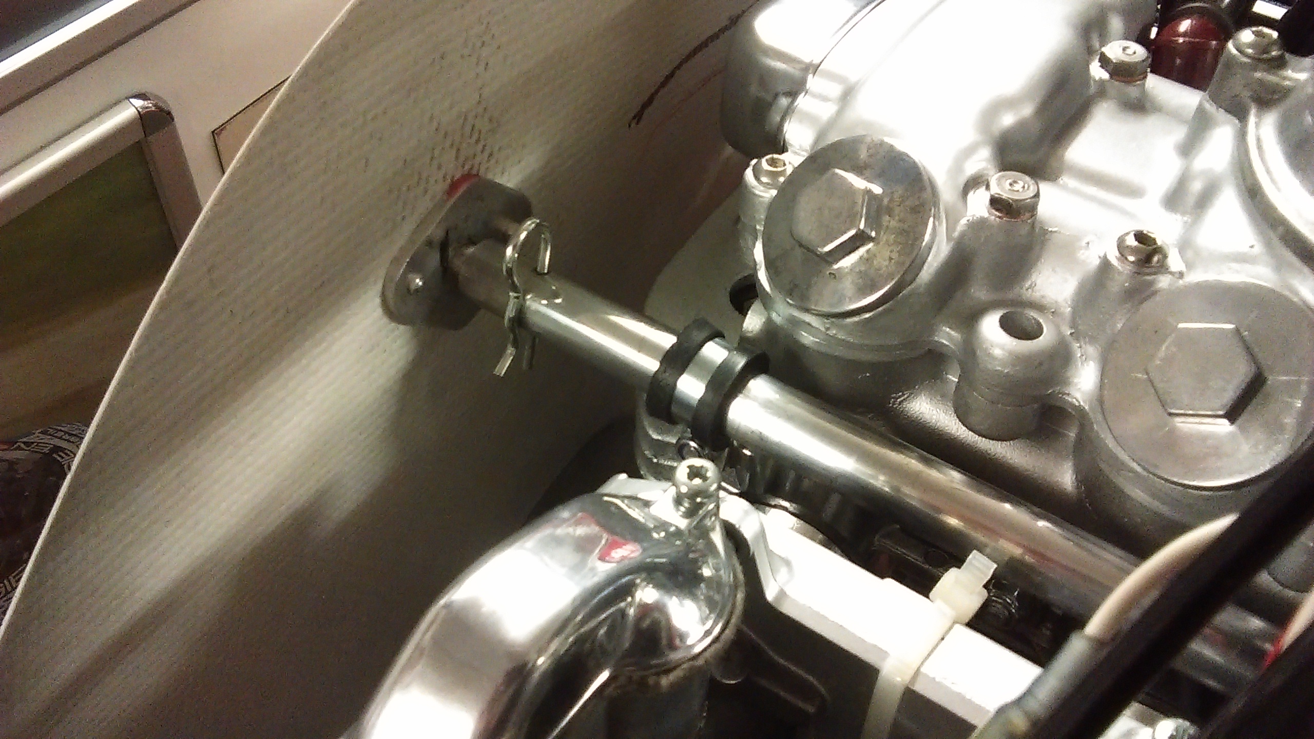

started making up the brackets and fairing fixings so I can get to finish the paintwork on the fairing and get her running good then fit the tub on haha using sprung cotter pins to hold the bracket stays on for quick release once the fairing is sandwiched between an outer and inner plate that will be riveted thru. tried to get me head round the wiring tonight but it ant sinking in ime fraggled ha ??? heres a few more updated pics for ya'll while I gets me a cold beer and colder shower cos its hot damn hot :P :P

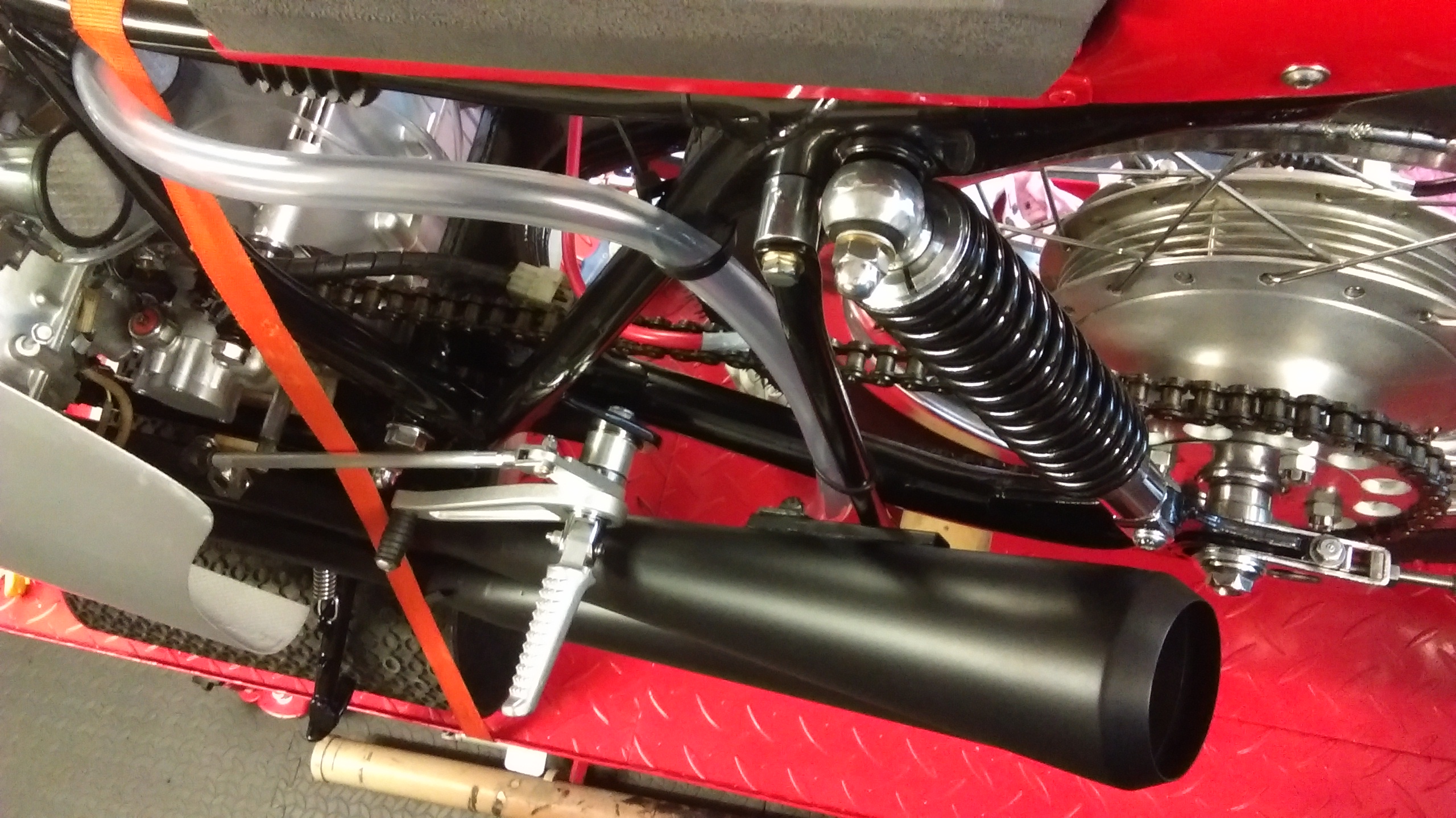

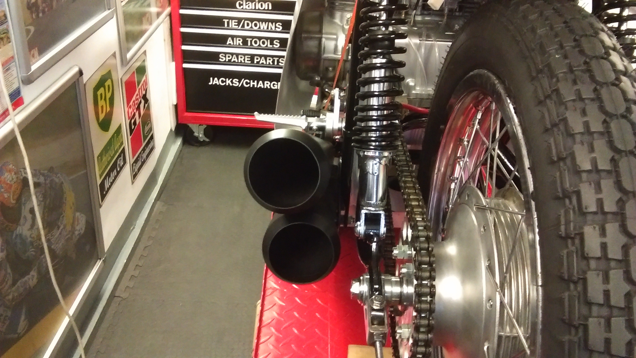

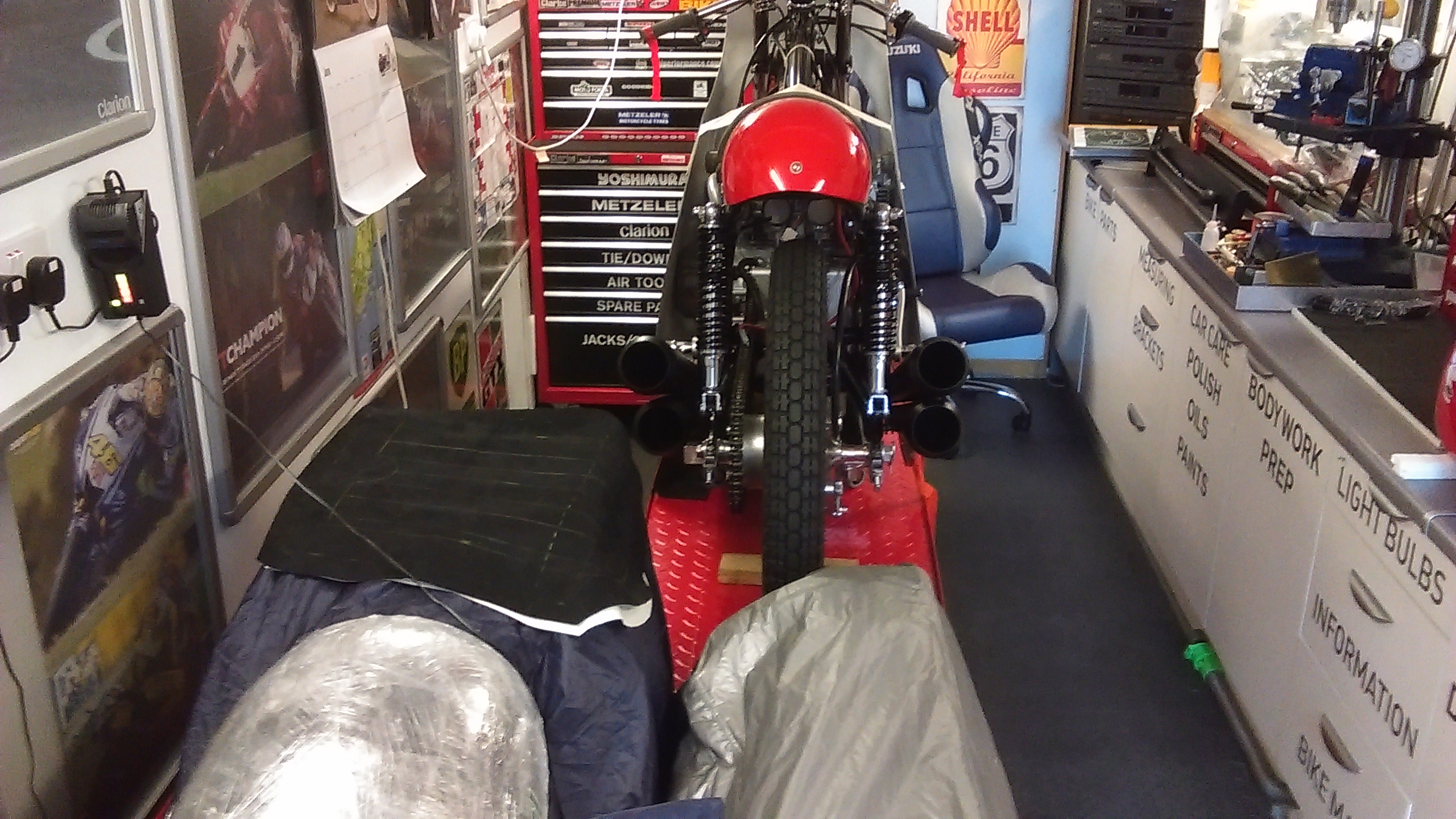

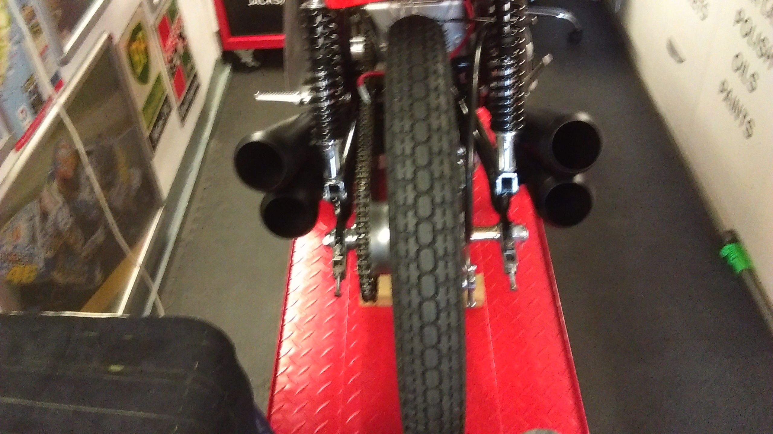

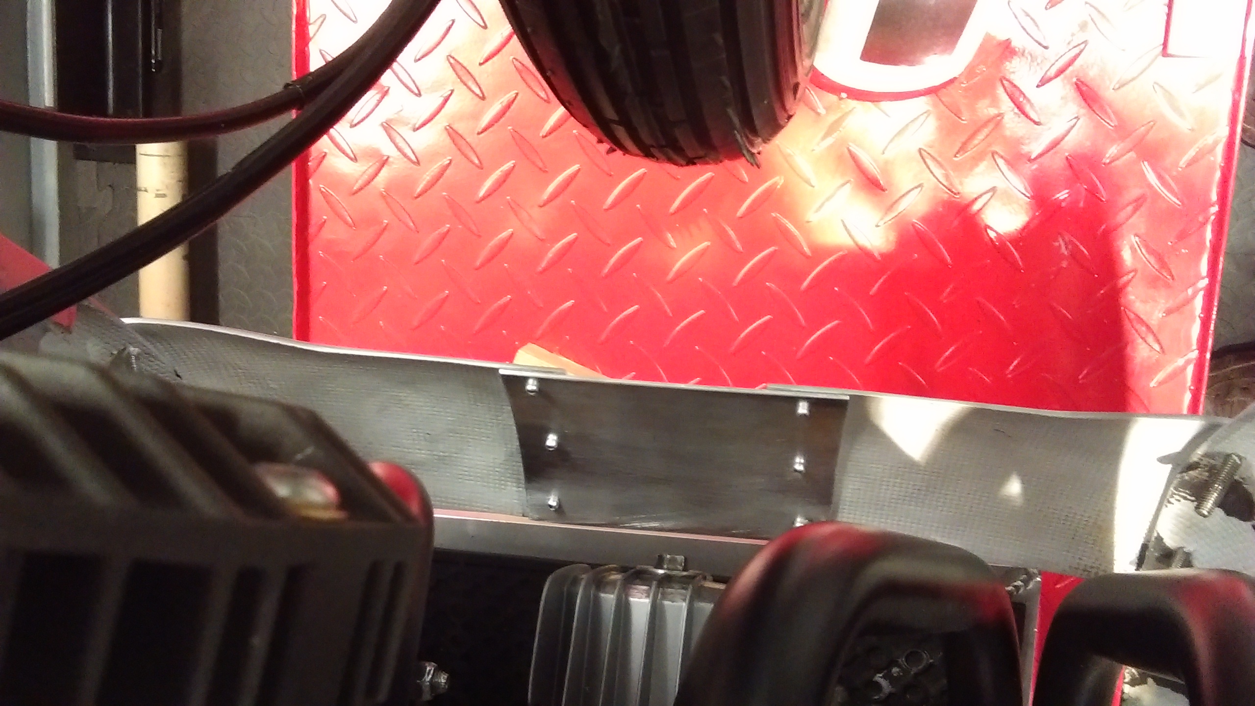

more pics of me slow progress everythings kinda tight bottom end of fairing with exhausts n covers might need to wrap part of exhaust gonna see when its all together

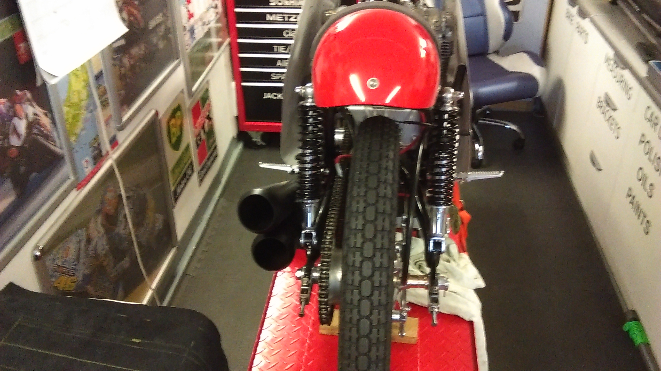

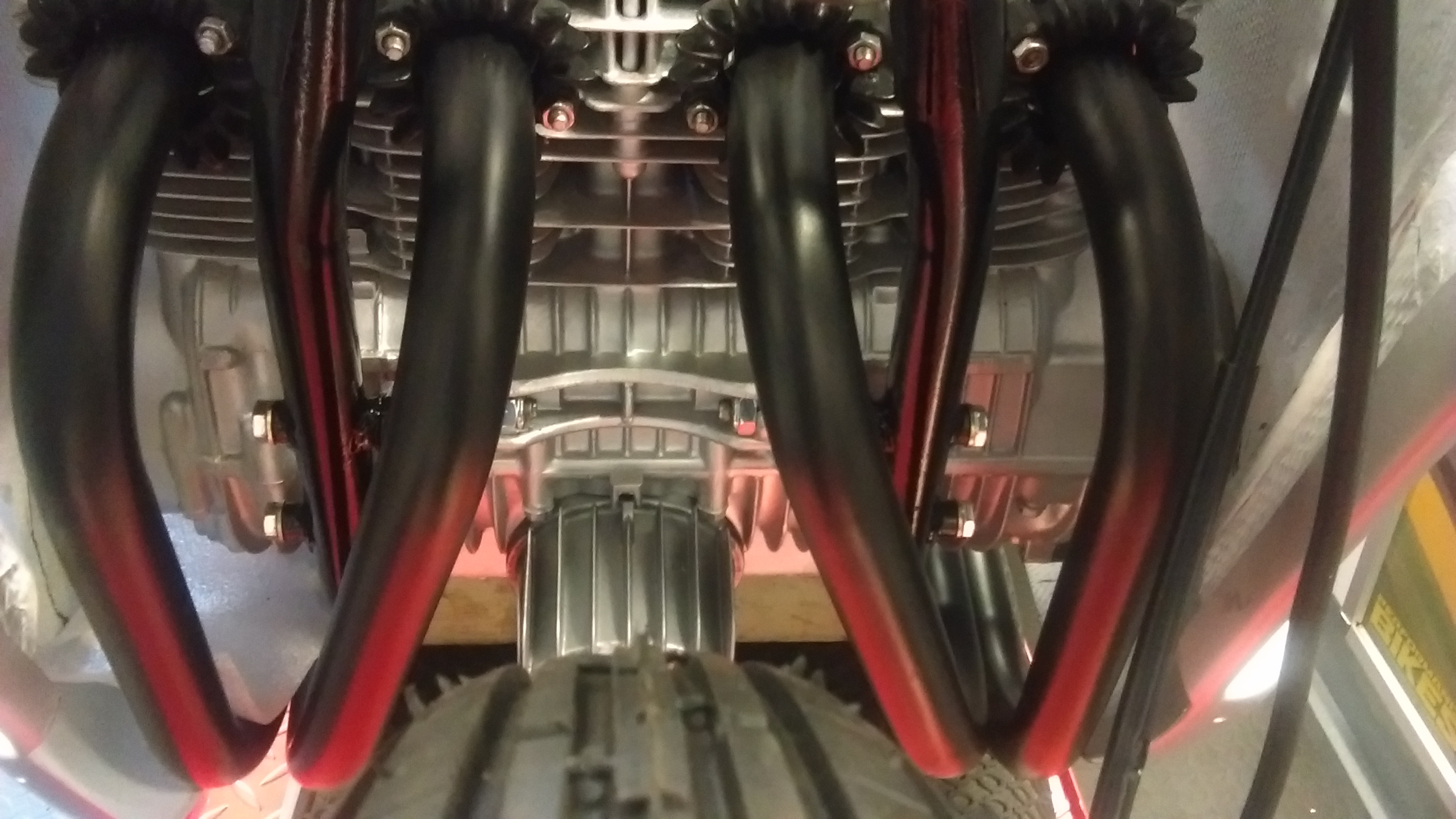

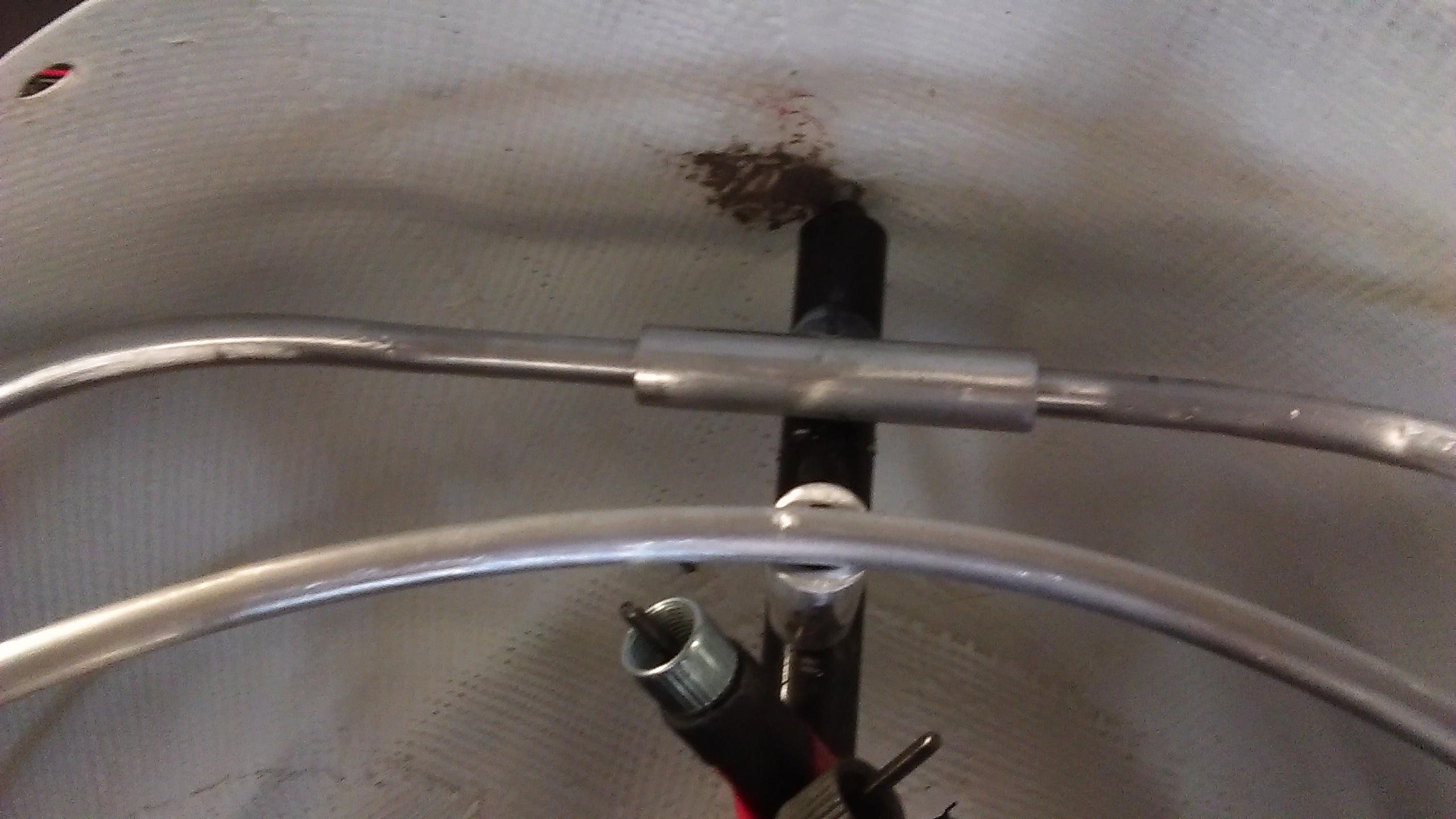

heres a couple more pics of my header pipes don't look too bad to say there made from a 4into 1 set :o also looks like ime gonna make up a new wiring loom :-\ think it will be easier than choppin up the old one ::) I aint runnin much electrical stuff ??? also gotta make my gauge holder and top fairing bracket guess the welding gear comin out again :P

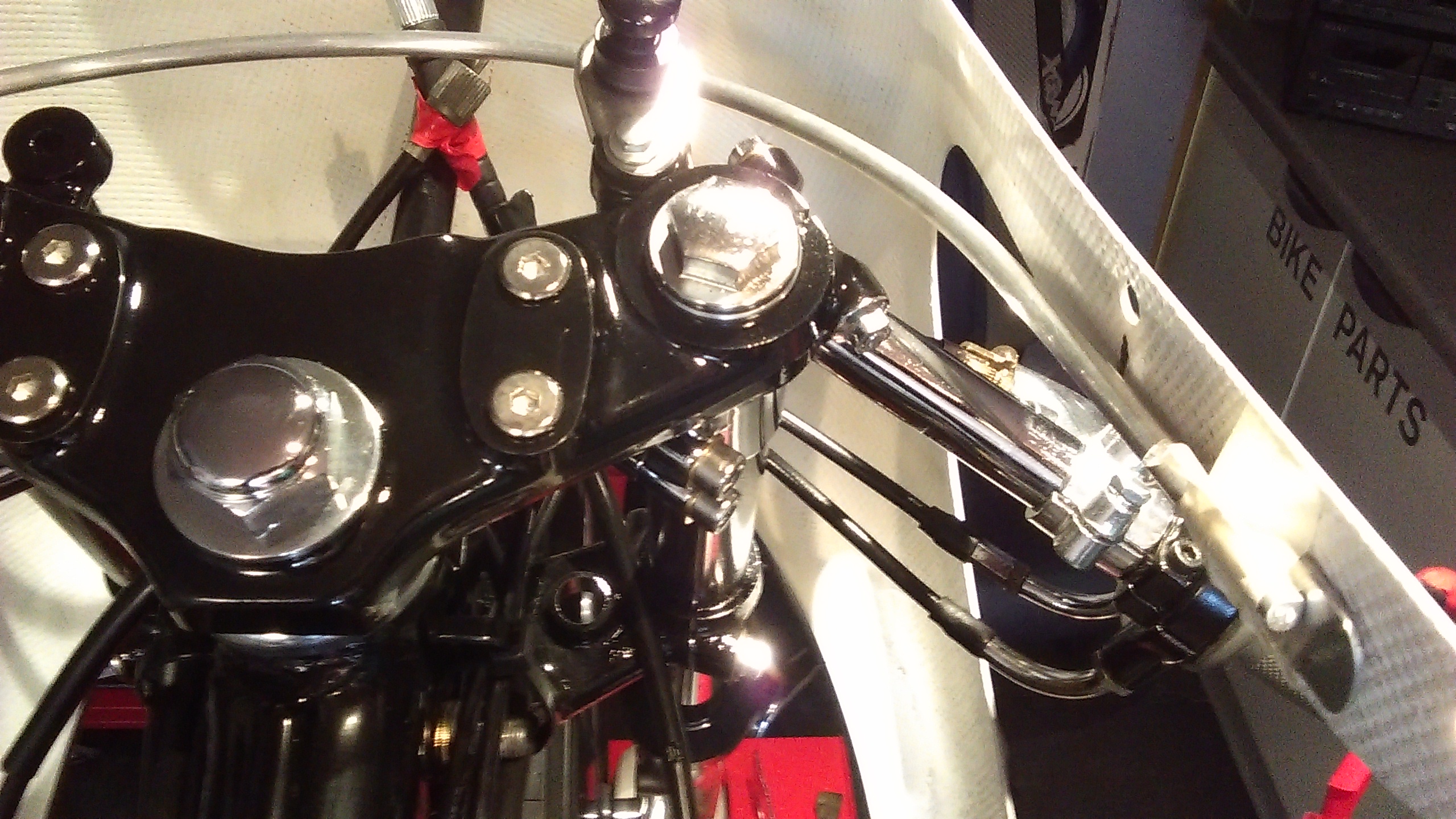

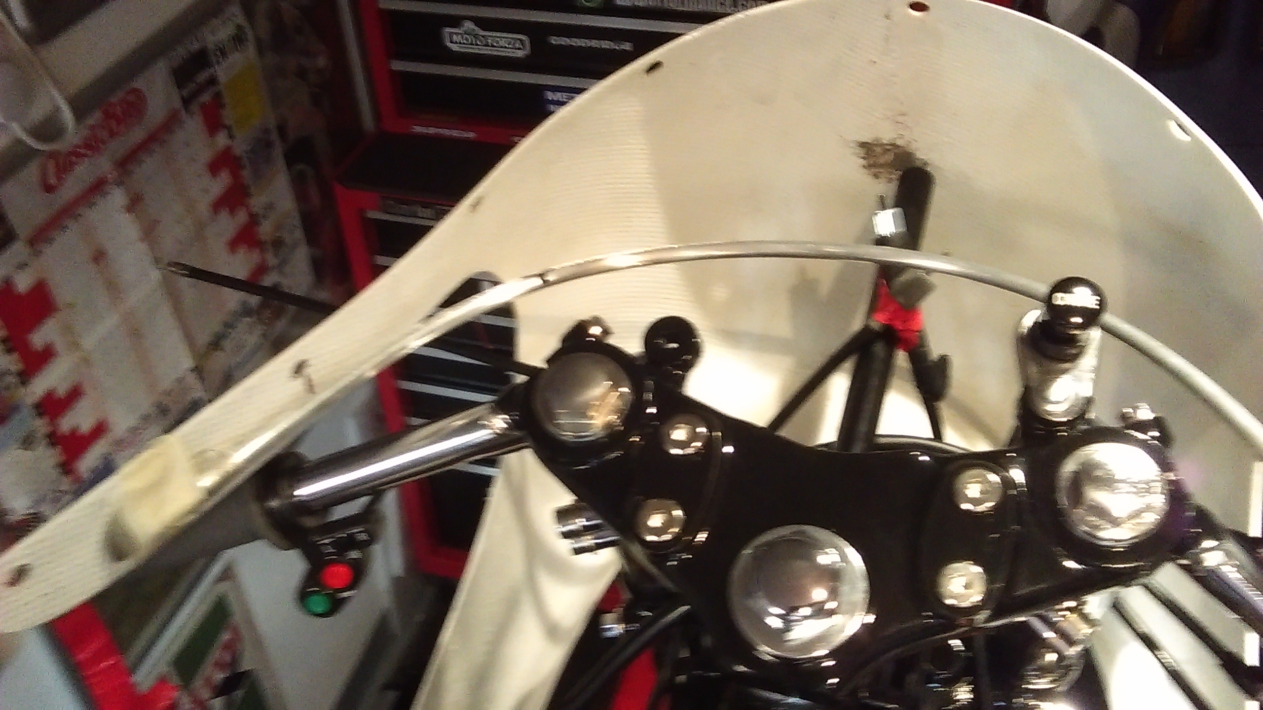

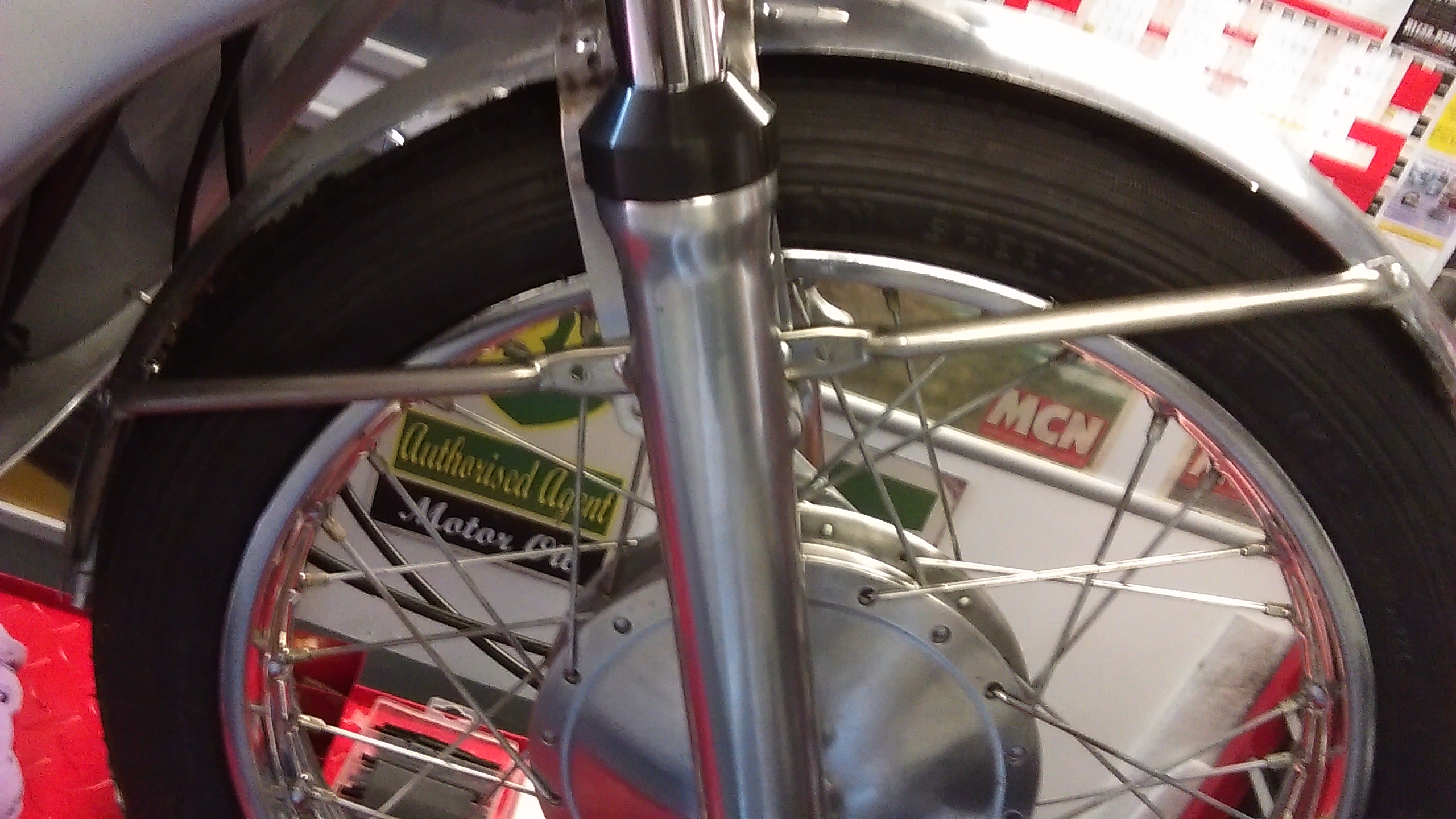

Hi all ;) what a mad couple of weeks since my last update been busy with my daughters graduation from Newcastle University ( 1st class Honours ) she got the brains haha then moving her into her new place in Middlesboro and the missus retired this week from 38years :o teaching in high school never mind a gold watch she should have got a medal for that Heres a few pics of what little progress ive made got the front fairing panel extended and riveted got it dry fit to check, looks ok will be better once painted with rest of fairing, made up front stays for fairing out of aluminium bar just need to weld em up that's gonna be a first welding that stuff but it will be painted up black along with inside of fairing

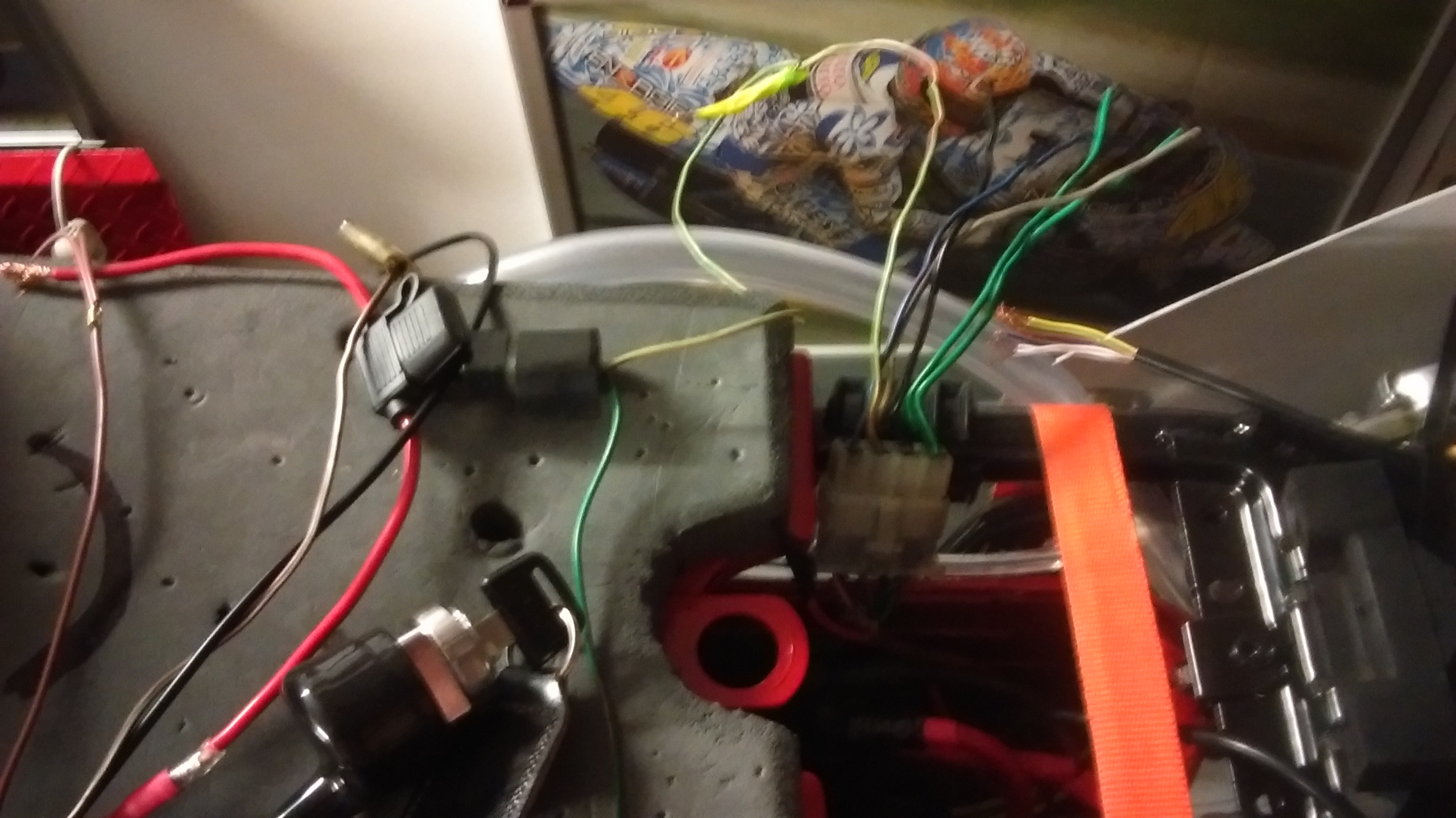

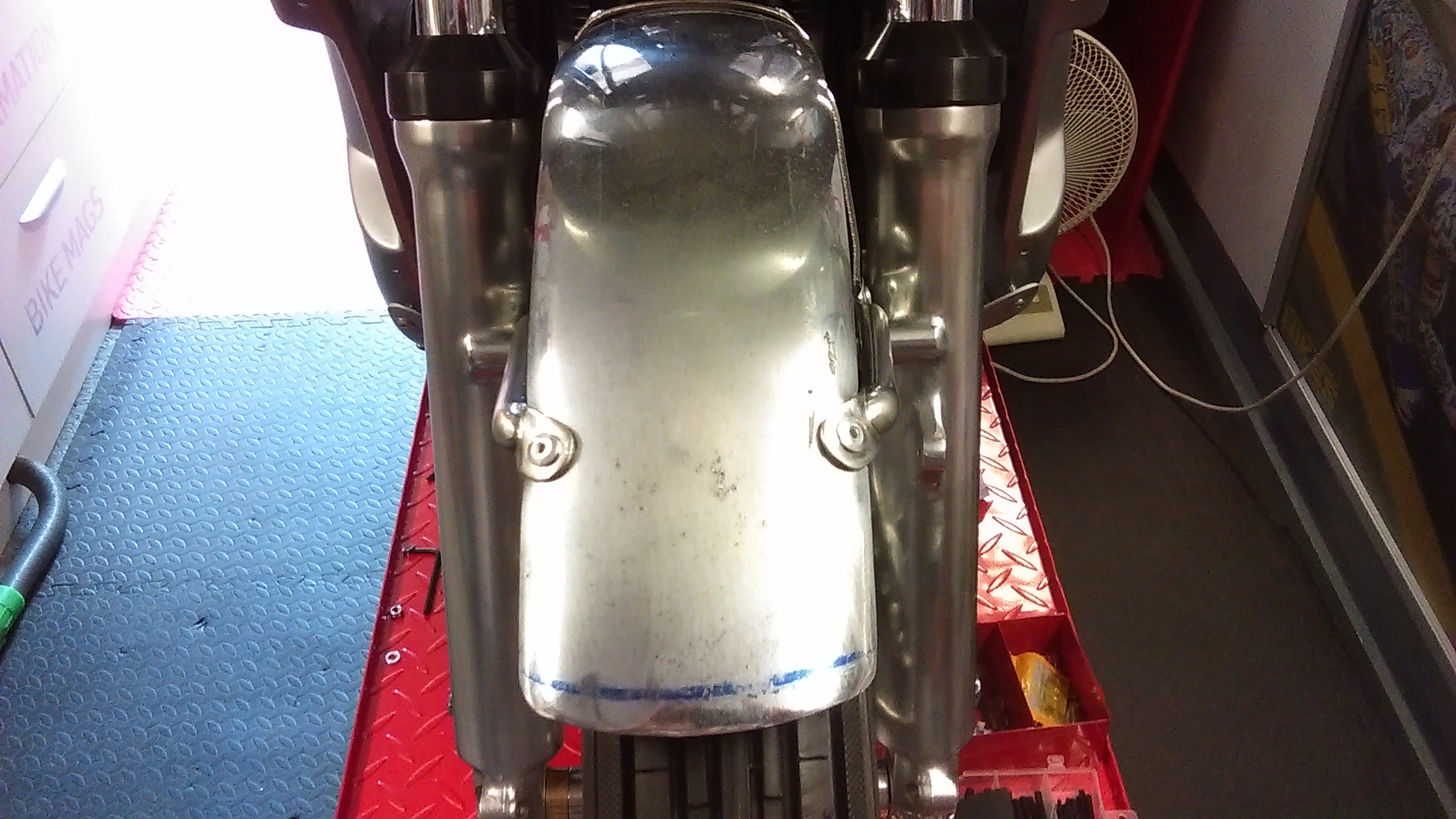

Cheers guys sorry its goin so slow like lots of others lifes been getting in the way :-[ progress slowed so I missed the classic TT at least for the bike, managed to take the wife instead but it aint the same on four wheels rather than two so onto what progress ive made :-\ fitted the electrics got a small tail/brake light & number plate for a daytime MOT fit a horn and electric start, oil n neutral light too they all up n running ;D but I ain't getting spark to my plugs from me coils :-\ wiring isn't my best point haha sure it will be something simple tho? started stitching seat pics to follow made my front fender goin to re-rivet the arms inside the main bracket as ive had to make some plates to attach it to the forks as the fitting holes don't line up soon as its ready gonna spray it up same finish as the fairing heres a couple of pics not much to show

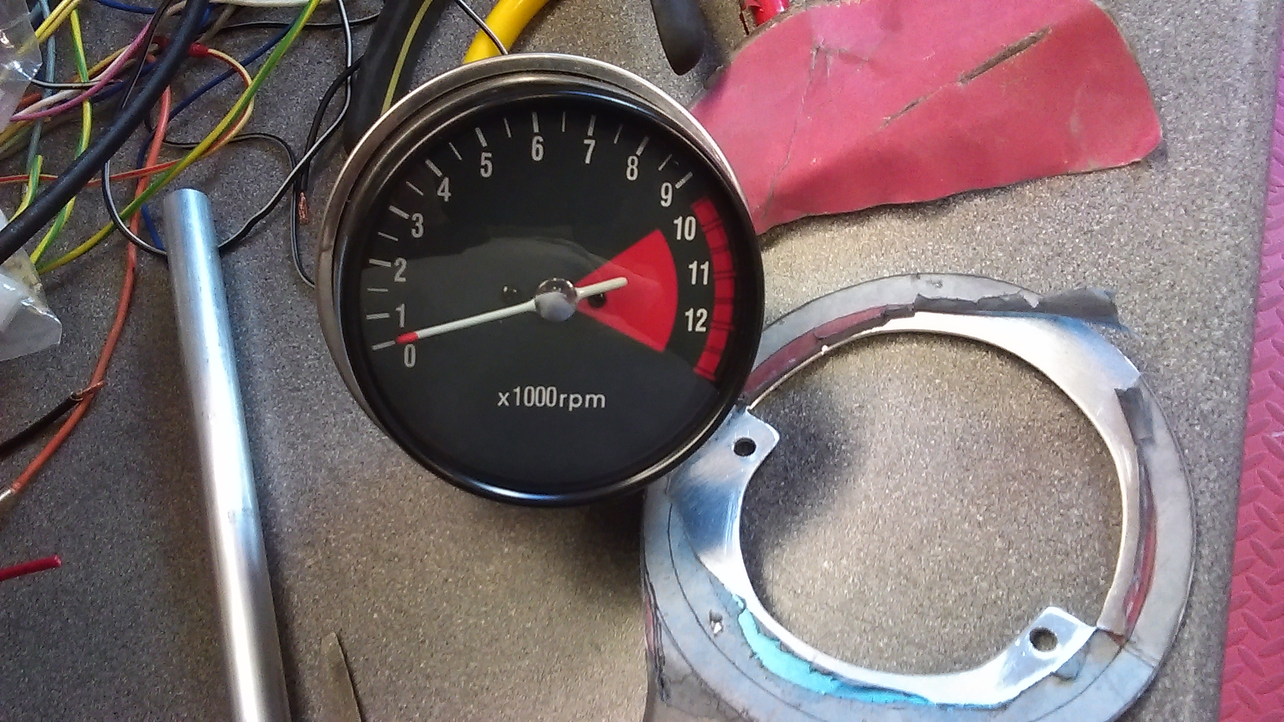

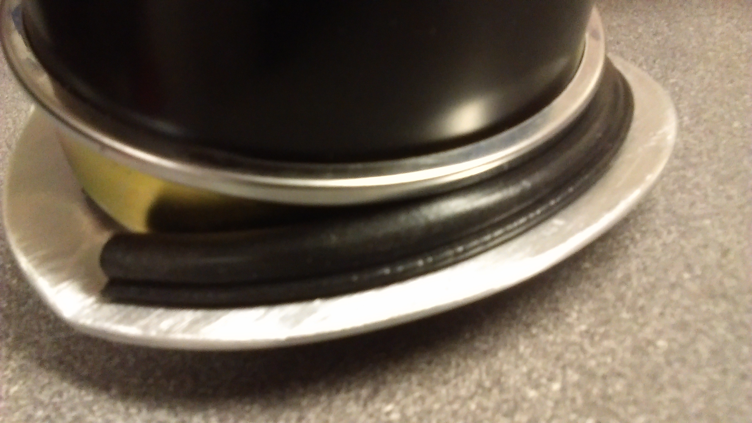

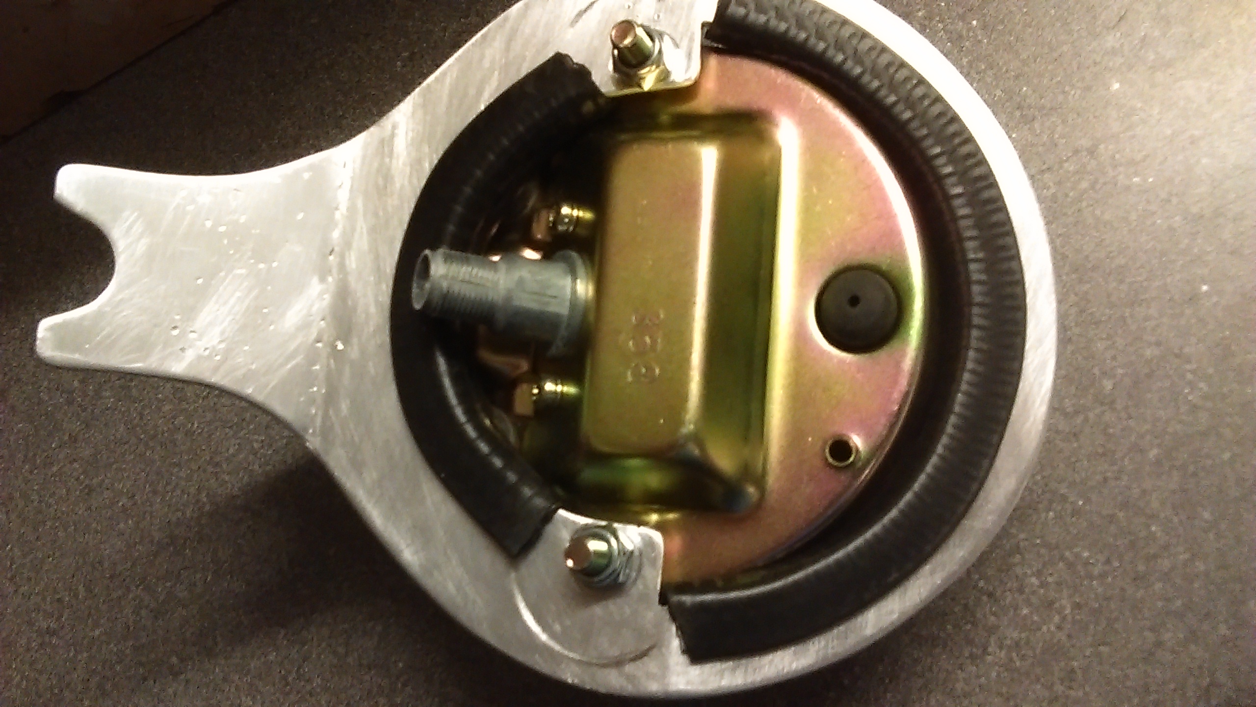

Got my rev counter so made up a gauge mount out of Aluminium used some VW door trim to help dampen any vibrations also waiting for a set of velocity stacks to come in from speedMoto.com found them on here bought a set for my cb350f well worth it 8) 8)

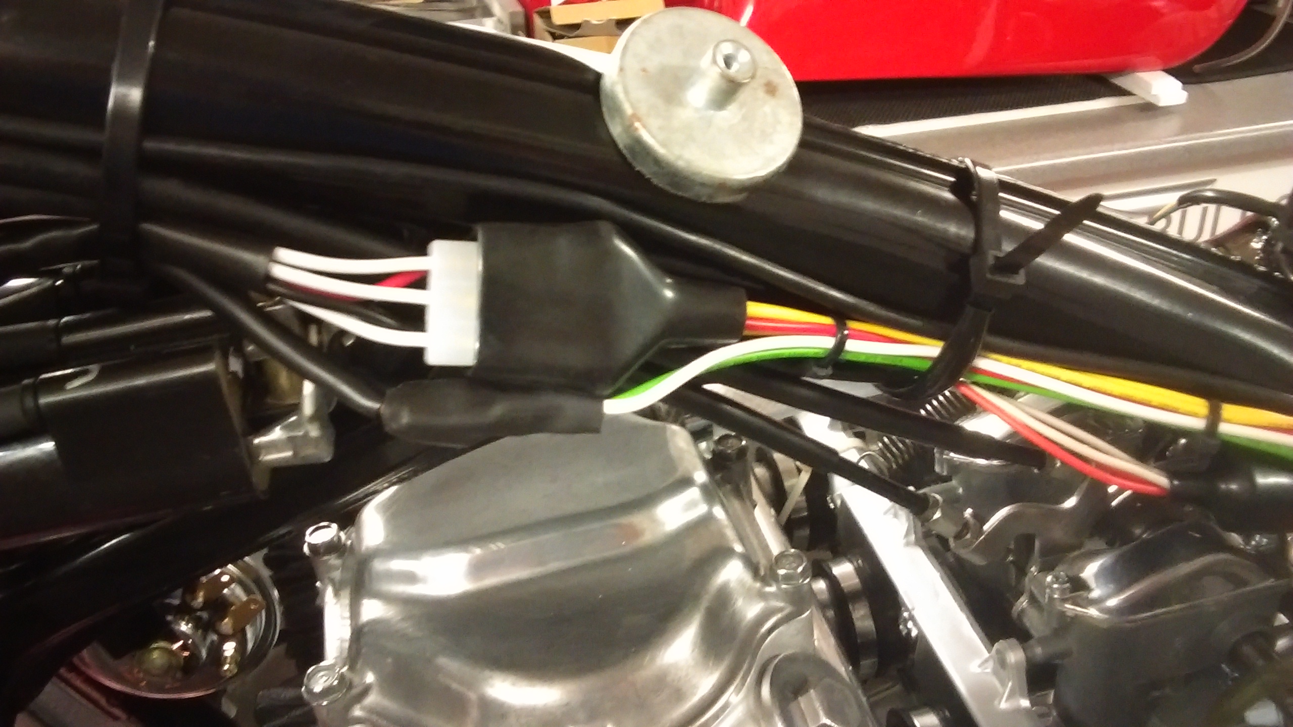

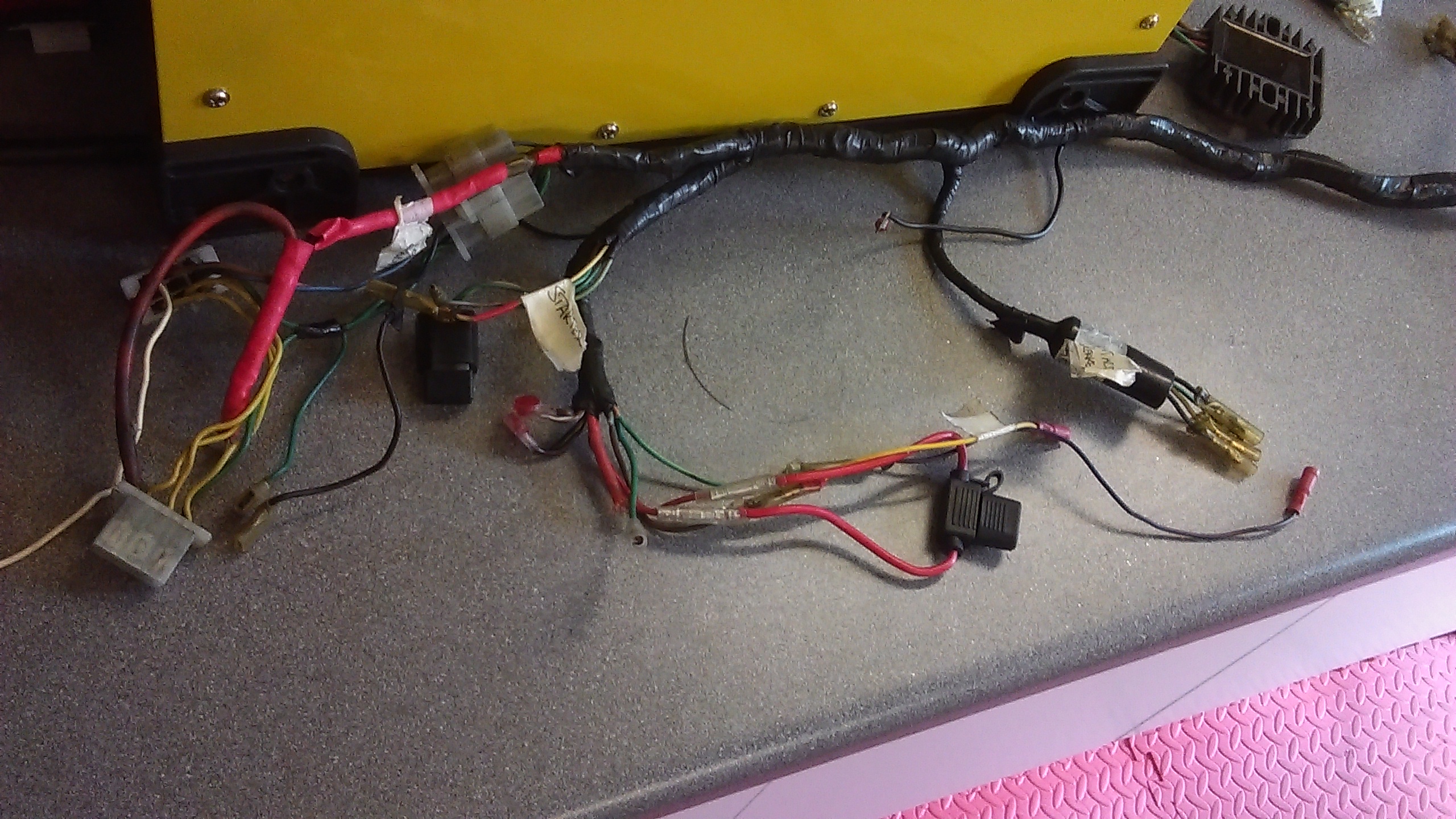

The rev counter bracket will actually weld to front fairing mount when I jump onto welding the aluminium up, ??? heres a couple of pics of my spaghetti of wiring :P it all fits into the modified airbox envy you guys that get neat electrics :o at least I can get to fuses haha
