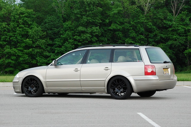

I've had excellent results with "Gunk". I do it with fresh cheap oil, then change it again instantly after doing the flush. I then will run seafoam through the intake via the brke booster hose. I've gotten some really good results. I use to have an 04.5 Passat as seen below :) Along with a few other Audi's and junk.
